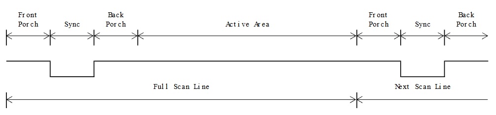

The Horizontal SYNC
Scanline Part Cycles Duration (μs)
Active Area 640 25.42
Front Porch 16 0.64
Sync Part 96 3.81
Back Porch 48 1.91
Scanline 800 31.78
HSYNC signal

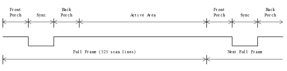

The Vertical SYNC
Frame Part Lines Count Duration (ms)
Active Area 480 15.25
Front Porch 10 0.32
Sync Part 2 0.06
Back Porch 33 1.05
Full Frame 525 16.68
VSYNC signal
