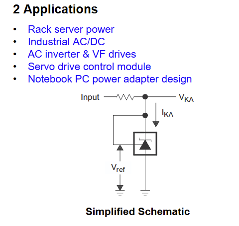

In fact, that is less than the cost of many transistors (to be fair, the price of "brand" devices is a bit higher). A typical use case is to provide a voltage reference of 2.5V. (From TIs datasheet)

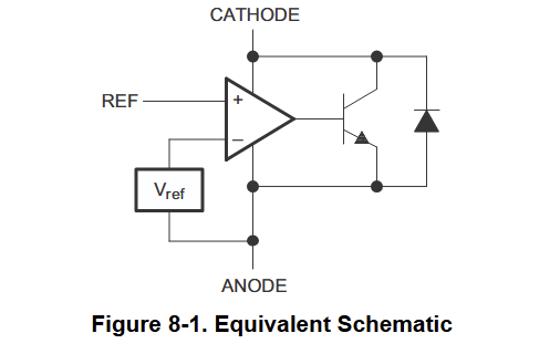

This three terminal component is essentially a small IC that compares the reference input to an internal reference of 2.5V and amplifies the difference on the  "Cathode". This IC is entirely self-powered and does not require an additional current supply. However, around 1 mA from "Cathode" to "Anode" are required for stable operation. (The odd pin naming is likely because this component was meant to emulate a zener diode)

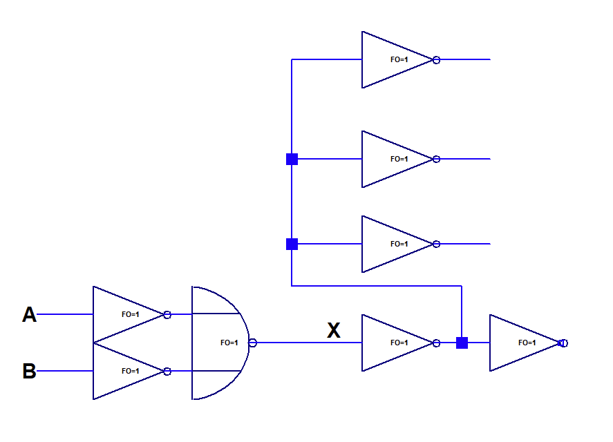

The basic primitive for this logic family is the NOR gate. There are two ways to build one.
  1. Connect the outputs of two TL431 inverters to the same pull up. (3xR + 2x TL431 per gate)
  2. Use a resistor devidier at the input. (3xR + 1x TL431 per gate)
Interestingly, option 2 (the simpler one), works with this logic family specifically due to the asymmetric logic levels. We can probably achieve up to NOR4 with this concept. (Consider what happens if 3 inputs are low and one high)
Above, you can see the schematics of the gate along with a test circuit.
Results of the test circuit simulation is shown below. NOR2 works nicely, which means we can build up a full logic family from it. Also the second inverter with a loading with 4 inverters nicely retains logic levels.
