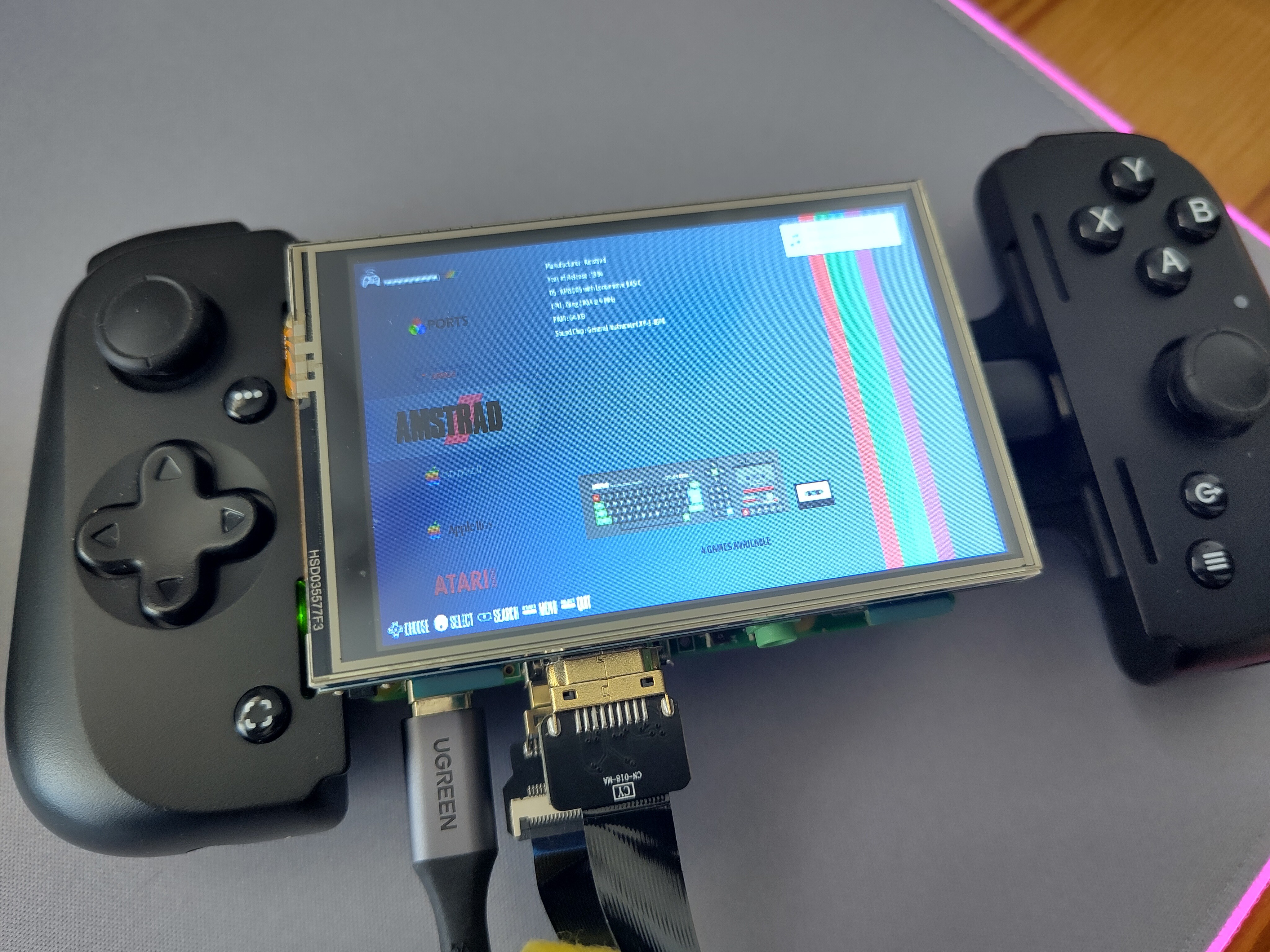

    One of the annoying hurdles in this build has been physical orientation. Because of the USB-C port placement on the Razer Kishi, I had to mount the Raspberry Pi 5 with the USB ports on the right-hand side. This left me with a perfect view of... an upside-down Recalbox menu.
    The Solution
    My search for a solution began with a few hours of googling with absolutely zero luck. Then I tried my luck with ChatGPT, and this is what it spat out:
    The Pi 5 uses the KMS (Kernel Mode Setting) video stack, which means the OS (Recalbox) takes control of the display orientation much later in the boot process than the firmware-level commands in config.txt.
    To fix this, you have to tell Recalbox's internal system manager how to handle the rotation at the software level.
    The Fix:

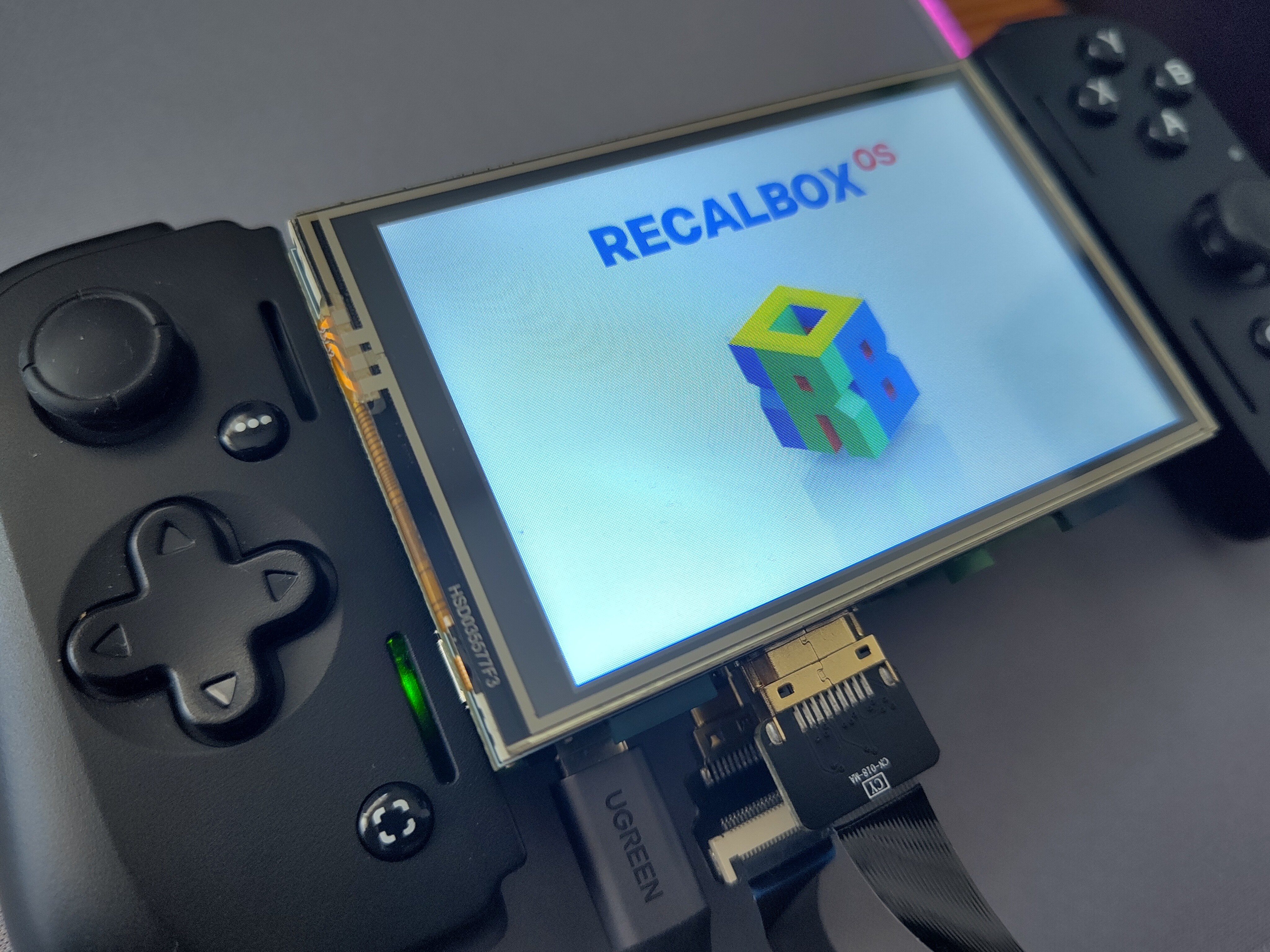

    1. Access the Filesystem: I threw the SD Card into the nearest computer.
    2. Locate the Config: Navigate to /recalbox/share/system/recalbox.conf.
    3. The Magic Line: Add (or find and edit) the following line to the configuration: system.kmsdrm.rotate=1(This rotated the screen 180 degrees for me)
    4. Save and Reboot.
    Results
    Success! The boot sequence still starts upside down (firmware), but as soon as the Recalbox splash hits, the KMS driver kicks in and flips the image to the correct orientation. I’ve not installed the drivers yet to enable touch screen, but I may ask for ChatGPTs help there, too.

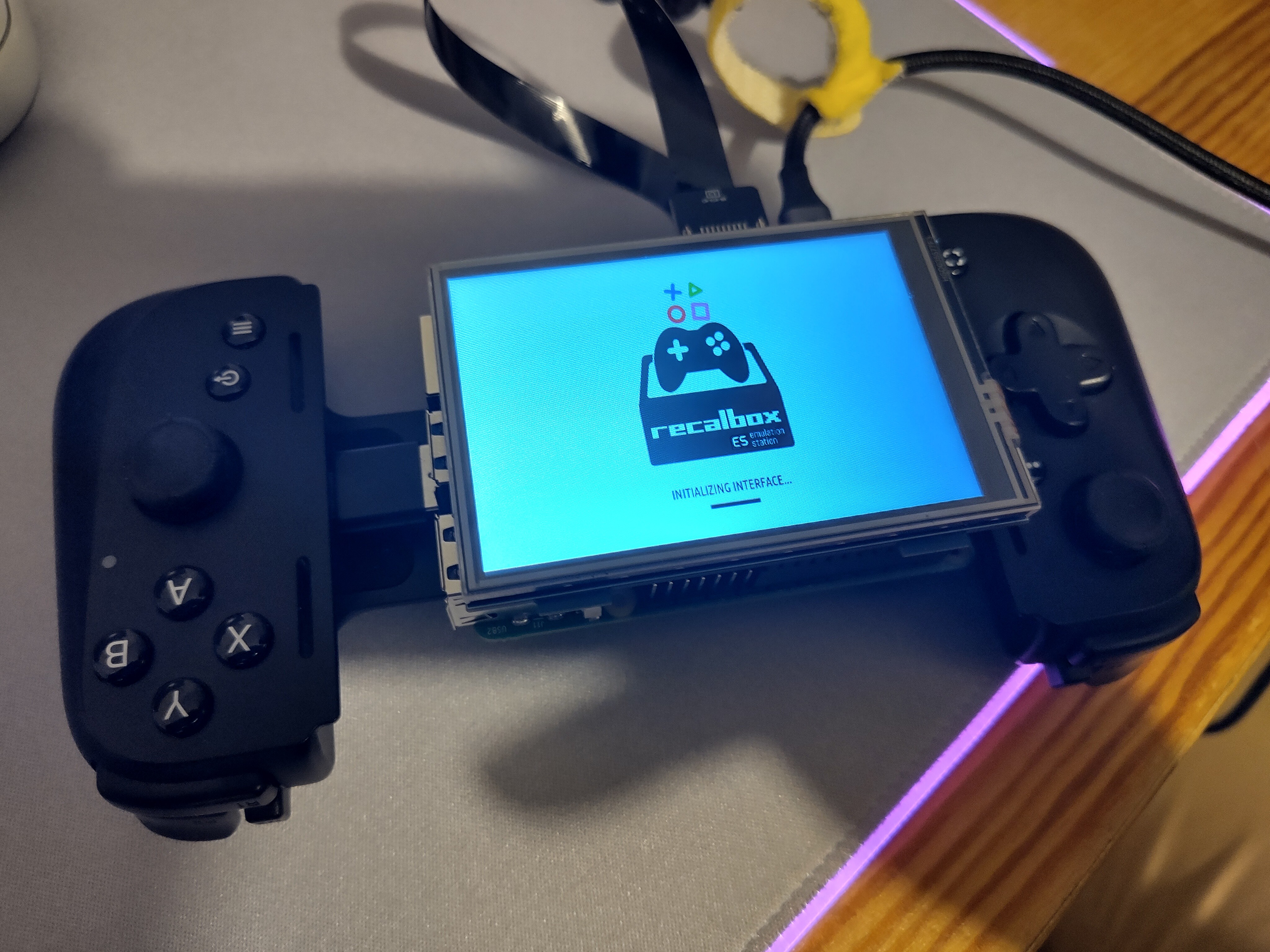

    Current Challenges
    • Screen Orientation: To align the USB ports with the Kishi controller, the Pi must be mounted upside down. Consequently, the screen image is inverted.
      • Issue: Editing config.txt to flip the screen isn't taking effect in Recalbox.
      • Trade-off: Using a cable extension corrects the orientation but wastes internal space needed for the case.
