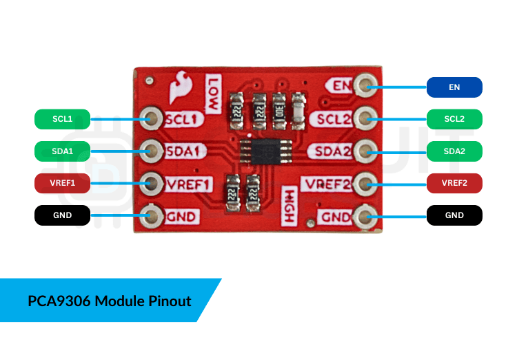

PCA9306 Module Pinout & Function
Here’s what each pin does:
  • VREF1 (Low Voltage Reference): Connects to your lower logic domain (e.g., 3.3 V)
  • VREF2 (High Voltage Reference): Connects to your higher logic domain (e.g., 5 V)
  • SCL1 / SDA1: I2C clock and data for the low-voltage side
  • SCL2 / SDA2: I2C clock and data for the high-voltage side
  • GND: Common ground between all devices
  • EN: Pull this high (to VREF2) to enable the translator
Tip: A common ground between both devices and the level shifter is essential; without it, voltage references float and the I2C bus can become unstable.

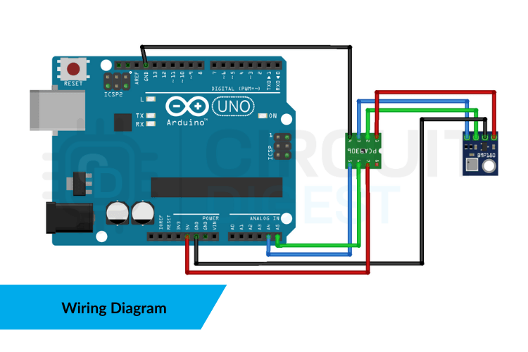

Step-by-Step Wiring Guide
This example shows how to connect an Arduino Uno to a 3.3 V I2C sensor (like a BMP180 or similar), using the PCA9306 board as a level translator:
  1. Power the Level Shifter
    • VREF1 → 3.3 V (sensor logic)
    • VREF2 → 5 V (Arduino logic)
  2. Connect I2C Lines
    • SDA1/SCL1 → Sensor SDA/SCL
    • SDA2 → Arduino A4 (SDA)
    • SCL2 → Arduino A5 (SCL)
  3. Tie Grounds Together
    • GND from Arduino, sensor, and PCA9306 must share a common reference.
  4. Enable the Module
    • Pull the EN pin high (usually tied to the voltage on VREF2).
With this setup in place, the PCA9306 handles level shifting automatically — no software configuration is required.

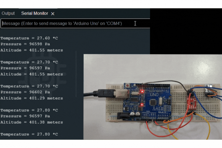

Example Arduino Code
Once your hardware is connected correctly, your Arduino sketch doesn’t need any special libraries or PCA9306-specific code. It simply performs I2C operations exactly as you would with a direct connection:
#include <Wire.h>
#include <Adafruit_BMP085.h>
Adafruit_BMP085 bmp;
void setup() {  Serial.begin(9600);  Wire.begin();  // start I2C  if (!bmp.begin()) {    Serial.println("Sensor not found. Check wiring!");    while (1);  }
void loop() {  Serial.print("Temp (°C): ");  Serial.println(bmp.readTemperature());
  Serial.print("Pressure (Pa): ");  Serial.println(bmp.readPressure());    delay(2000);
This sketch demonstrates retrieving temperature/pressure values from a BMP180 sensor through a PCA9306 level shifter, then printing those values to the Serial Monitor.
