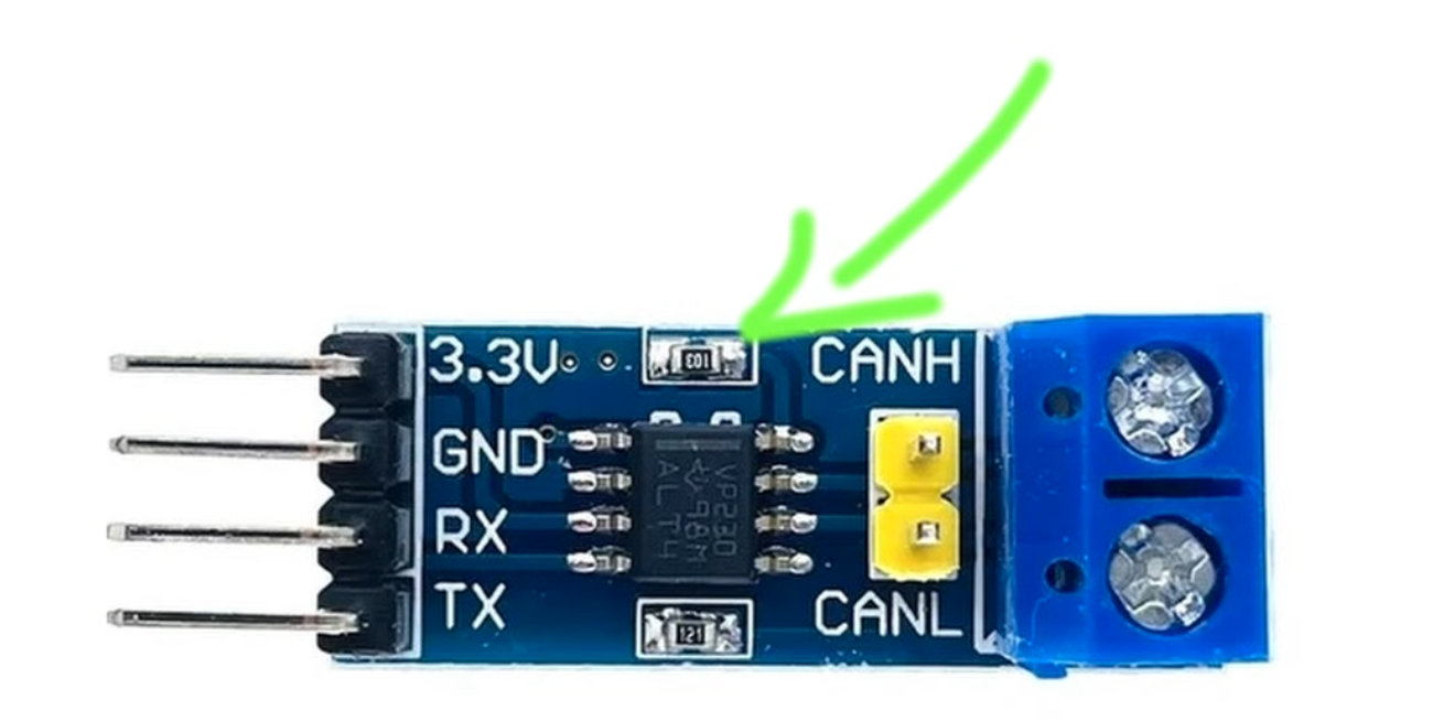

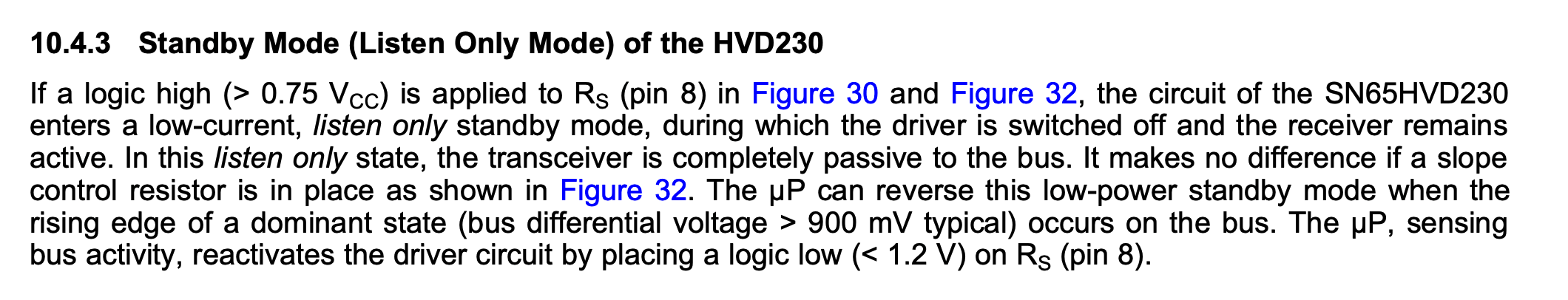

  • CAN Transceiver Fix: The popular SN65HVD230 CAN module used with these boards has a design flaw: the RS pin resistor value is too high, forcing the chip into "Listen Only" or standby mode. I desoldered this resistor and shorted the pads to 0 ohms, ensuring the transceiver stays active for two-way communication.

    Quick note how to fix SN65HVD230 can module:
    I waste hours trying to figure out why my CAN setup doesn't work and only after I read f$% datasheet and check all voltages with multimeter I found that standby pin voltage is above 0.75 volts, that means manufacturer mistake.
    After I short-circuit this resistor everything start working as it should, so if you have same module just desolder this resistor:
     and short the pads together
    I hope you reading this before hours of troubleshooting
