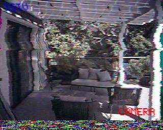

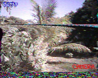

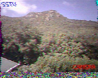

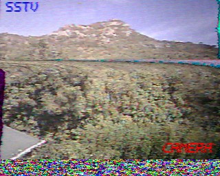

Small test video:
Picture recovery test with sound:
Some recovered test pictures from tape:

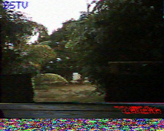

Some other tests done indoors:

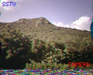

Some tests done at the beach after some optimizations:
