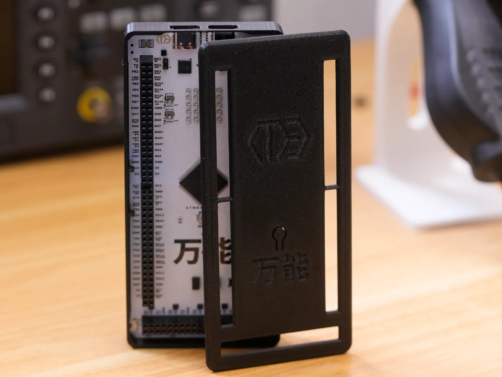

What if there was an Arduino that could do everything?...
I aimed to make the "Ultimate Ardiuno", the Arduino Bannou (万能 meaning "Eveything/multitool/all-purpose"). This board has the complexity of a high end development/research board while being able to be easily coded. This board aims to be an Everyday-carry PCB that can be used for whatever you need. The following features are implemented on this board:

3D&PCB Design files:
https://www.printables.com/model/1588457-arduino-bannou-case-pcb-design-files
