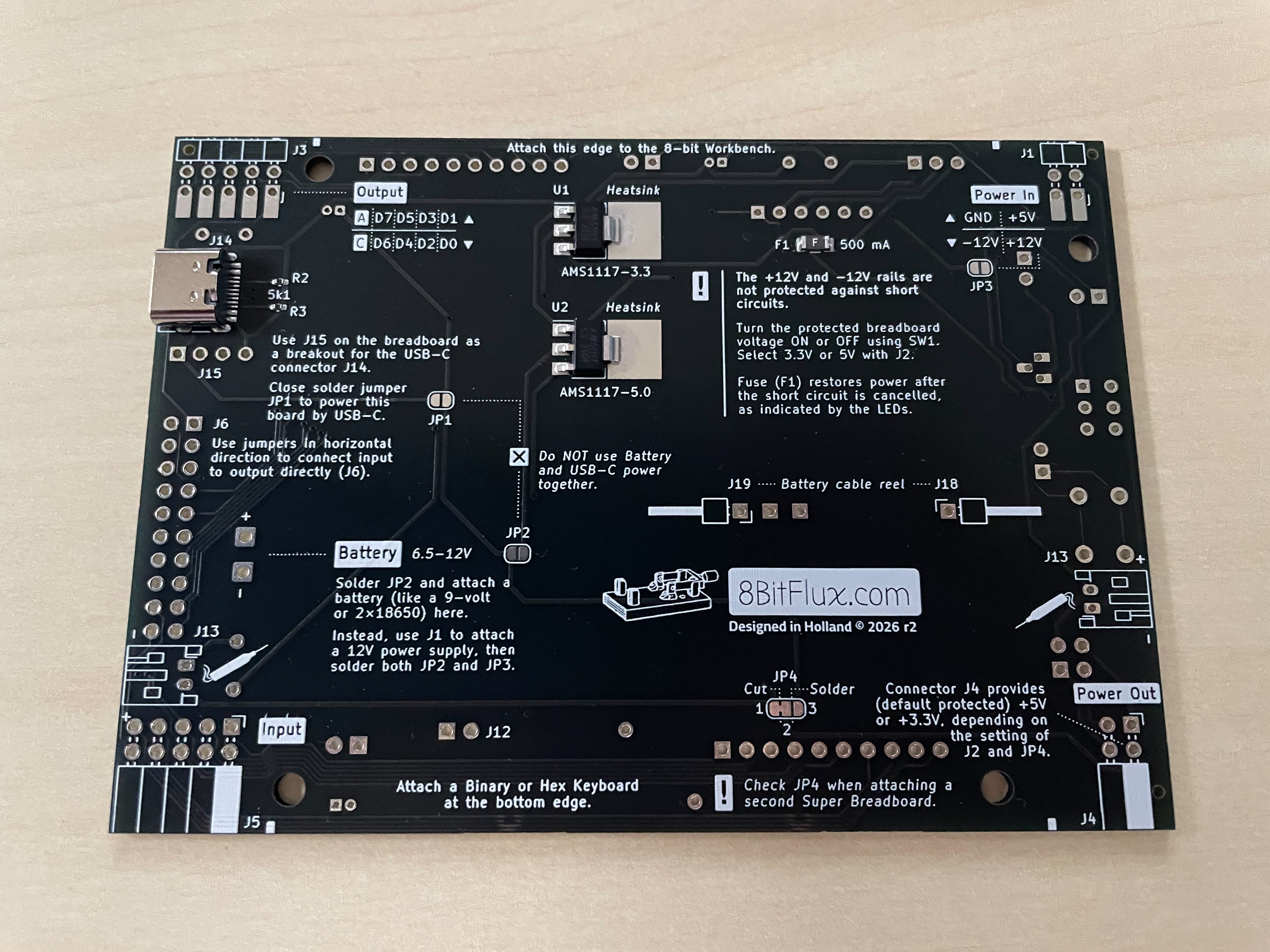

A prototyping board based on a standard 400 pin breadboard. Has multiple voltage rails (+5, +12 and -12V), 8-bit data input and output connectors, a Clock and Action line. It has 3.3V regulation on the board itself, based on the 5V input. The 5V and 3.3V lines are protected against short circuits, power is then cut off and this is indicated by a red LED.
Some other handy goodies are around the breadboard, including a mini USB B connector that can act as a breakout for a prototype, or it can supply 5V power (3.3V is derived) by using a power bank. A push button and LED (with resistor) are ready for use. All signals of the extension interface can be bridged using jumpers. For example: the four high-nibble input-bits can be tied to the output when they are not used on the breadboard.

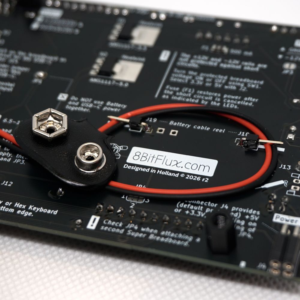

  • Battery cable reel
    Nijssenan hour ago 0 comments
    At the back side I created a cable reel out of two angled header pins, it works out pretty well. Makes it easy to store away the 9V battery cable when the Super Breadboard 2 is powered by USB-C (or by an attached 8-bit Workbench).
  • New prototype arrives
    Nijssen04/10/2026 at 08:00 0 comments
    The next-release prototype board arrived!
    Going to test the new features, like the USB-C connector, 9-volt battery input and logic probe support (left or right hand side connector). The new kits are going to be partly pre-assembled, all the small parts will be on the PCB already. Will try to keep the price close to (or the same as) the previous version.
  • Improvements
    Nijssen03/17/2026 at 08:18 0 comments
    Currently designing the following improvements:
    • Move to USB-C (still with breakout).
    • Logic Probe support (will be also available as a kit).
    • Power ON/OFF with a slide switch.
    • Support battery power (6.5 - 12 V).
    • All in the same compact form factor.
    Any ideas? Let me know!
