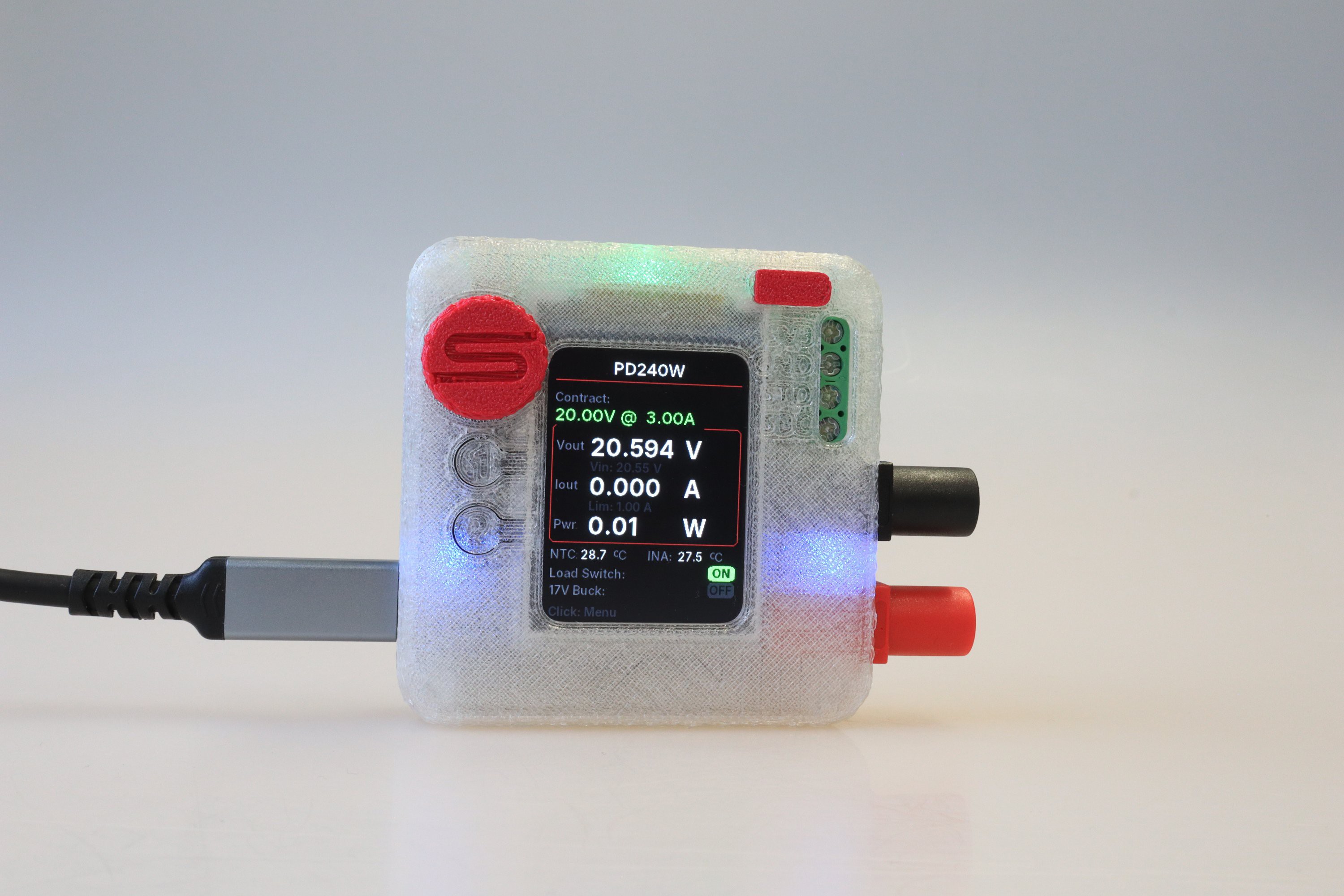

PD240W is an open-source, adjustable power supply designed to leverage the modern capabilities of USB-C Power Delivery (PD 3.2). While it fits in the palm of your hand, it is capable of negotiating up to 48V at 5A (240W), effectively turning high-power GaN chargers into fully programmable laboratory bench power supplies.
Built around the Raspberry Pi Pico (RP2040), this device bridges the gap between smart USB chargers and raw DC power requirements. While originally designed for testing motor drives in the field, it serves as an excellent general-purpose portable lab supply.
Key Features:
  • High Power Capability: Supports the Power Delivery standard up to 3.2 with EPR (Extended Power Range), allowing negotiation of Fixed, PPS (Programmable Power Supply), and AVS (Adjustable Voltage Supply) profiles up to 48V.
  • Precision Control: Adjustable current limiting (10mA - 5A) with software-based constant-current (CC) regulation, and fine voltage tuning via a rotary encoder. A closed-loop tuner trims PPS and AVS requests to compensate for cable drop and charger inaccuracy.
  • Rich UI: Features a 240x320 IPS display with anti-aliased fonts, providing real-time feedback on voltage, current, power, and thermal status.
  • Safety First: Includes hardware overcurrent protection, overtemperature monitoring (NTC + internal sensors), and interrupt-based safety cutoffs.
  • Motor Drive Specialized: Features a dedicated 17V Buck Output to simulate STO/SBC (Safe Torque Off) voltages for motor controller testing.

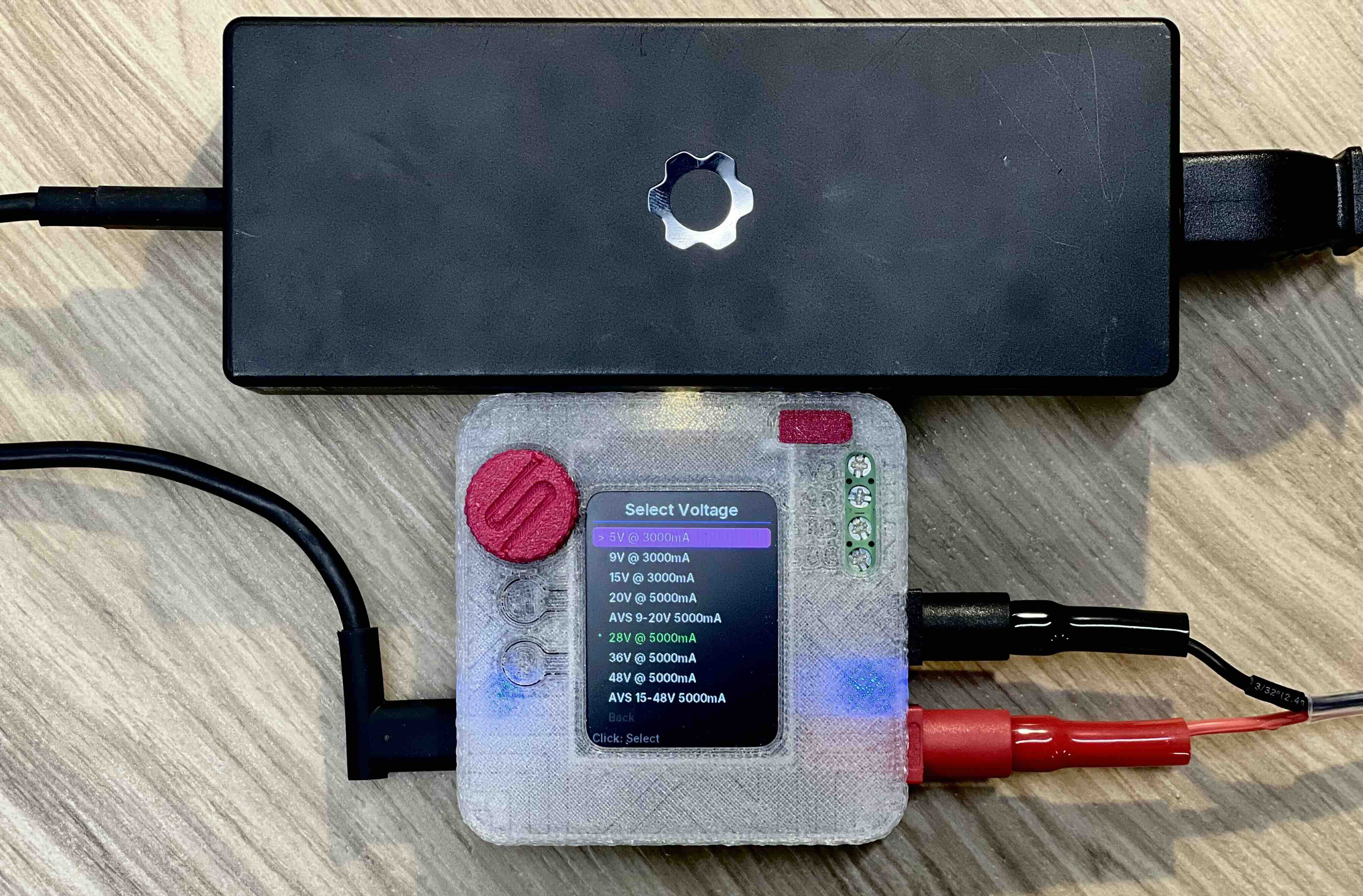

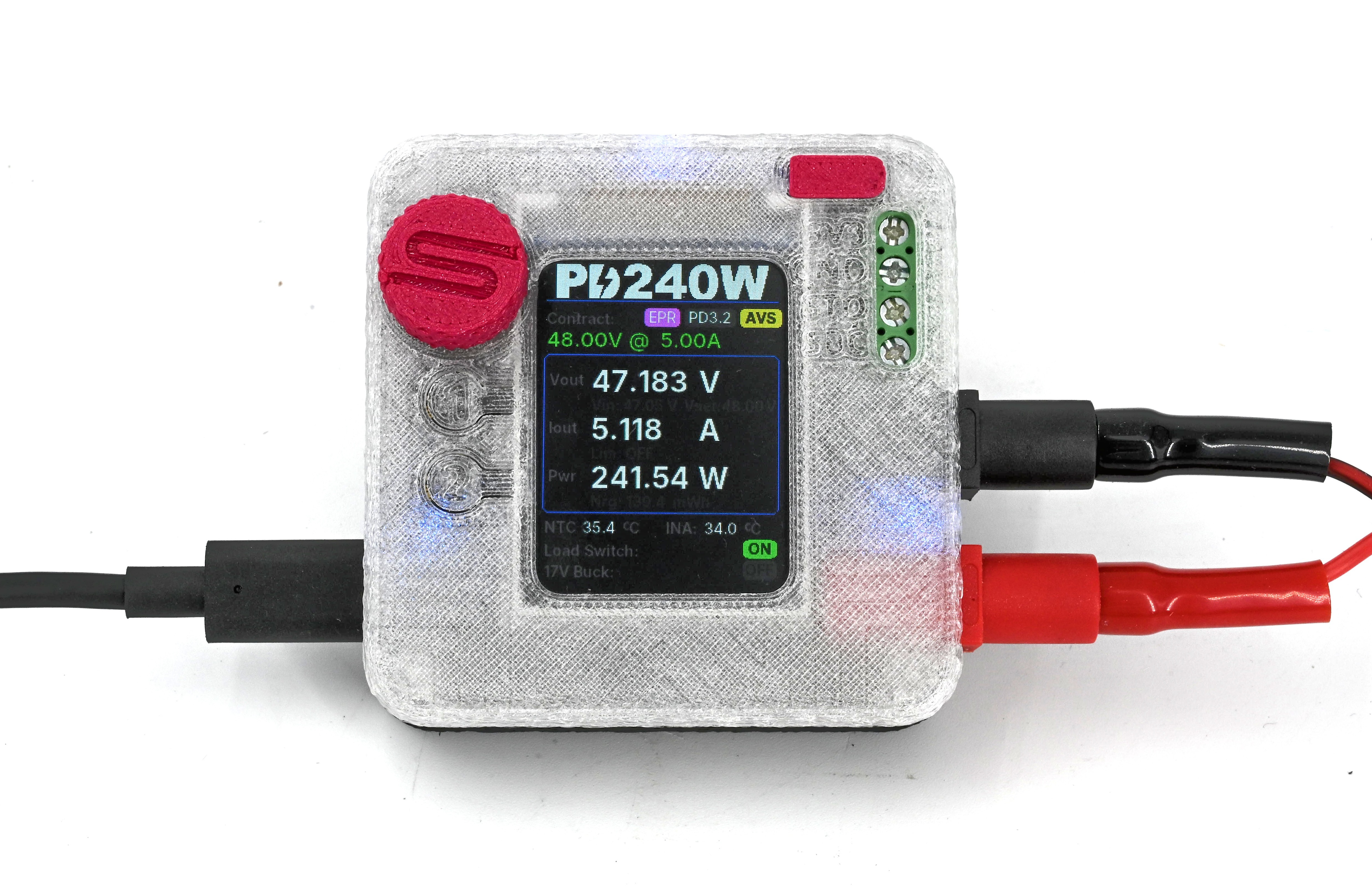

    Remember that Framework 240W PD3.2 charger I ordered at the end of the last log? It showed up, and I finally got to push PD240W to the power it was named after. Firmware 2.0.0 is the result of evenings and evenings of software development and testing. USB-PD 3.1/3.2 is officially supported, and many new features have been added.
    The headline is full AVS and EPR negotiation, so the board now climbs to 48V instead of topping out in the SPR range. Getting there was quite a journey. When I received the Framework charger, I immediately plugged it in, with a mix of hope and excitement. To my surprise, on the first try, I got a 48V reading on my screen from the INA228, and I thought that this was victory, and that in 30mins I would be done with EPR contracts. Oh boy was I wrong.
    The first half of 2.0.0 was about EPR, AVS, and USB-PD 3.2, and almost all of the pain lived in one place: getting out of an EPR contract. Climbing up to 48V is the easy direction; coming back down is where the problems start. The USB-PD spec says that when you leave the EPR range you have to step the voltage down to 5V within a tight time window. Request a big drop directly, say 48V straight to 5V, and a spec-compliant charger without active discharge will simply reset the port, and the board reboots.
    What worked is a three-step exit sequence. Instead of jumping straight to the target, I first use an EPR AVS APDO to slide the voltage down to the lowest voltage possible while still inside an EPR contract, then request 5V Fixed to cleanly exit EPR, and only then ask for the real SPR target. The catch is that this trick requires a source advertising an usable AVS APDO, and not every charger does.
    There's also a limit to how much the software can do about the timing. Meeting that step-down-to-5V deadline means actually pulling the bus voltage down fast, and from 48V that only happens quickly if something is sinking the rail, which you can't count on. My small bleed resistor wasn't enough. It was sized small on purpose to avoid wasting power. So for the next hardware iteration I'm thinking of adding an active discharge path: a switched load the firmware can fire to yank VBUS down on command, so the board can hit the deadline on its own instead of hoping the charger and the attached load cooperate.
    SPR AVS was the other rabbit hole, and the one that hurt the most relative to how small the fix turned out to be. SPR AVS is brand new in USB-PD 3.2, and just discovering it in the source's advertised PDOs was quite a challenge. SPR AVS nominally covers 9–20V, but on my hardware I can only reliably land it between 15 and 20V. Request anything below 15V and the contract collapses back to a 9V fixed rail. My current suspicion is the TPS26750 itself: the silicon was designed before PD3.2, and its AVS-enable bit is really the EPR AVS-enable bit, which the controller enforces down to a hard 15V floor, so sub-15V requests fall back to 9V.
