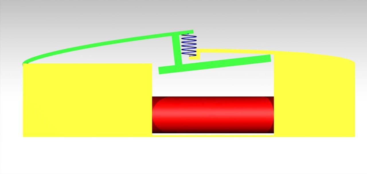

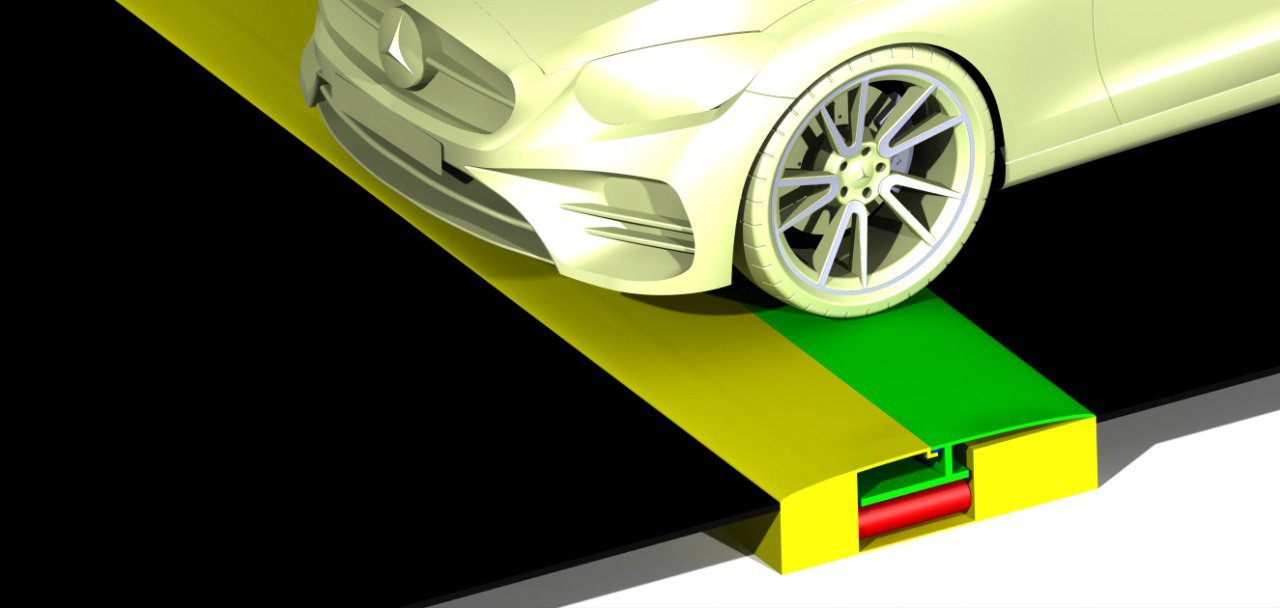

The proposed system is installed across a roadway in a similar manner to a conventional speed bump. It consists of a reinforced upper crushing plate connected to a hinge mechanism on one side and supported by a return spring system. Beneath the plate lies a closed loop structural frame containing a crushing chamber and a rotating roller that guides crushed bottles toward a secondary collection bin. The entire structure is embedded in the road surface and designed to withstand repeated vehicle loads.
The operation of the system is simple and automatic. Plastic bottles are deposited by users into an intake bin located at one side of the structure. From the bin bottles move into a horizontal crushing channel positioned beneath the hinged upper plate. When a vehicle drives over the speed breaker the wheel applies downward force to the plate. This force causes the plate to pivot around the hinge compressing the bottles against the lower crushing surface. The compression flattens the bottles and significantly reduces their volume.
During the crushing process the bottles come into contact with a cylindrical roller located within the chamber. Due to the shear force created by the downward motion of the plate and the movement of the bottle material the roller rotates. This rotating action helps guide the crushed bottles toward the opposite side of the system. The crushed bottles are then collected in a second storage bin where they can later be removed for recycling.
After the vehicle passes over the device the return springs expand and lift the crushing plate back to its original position. This resets the mechanism and prepares it for the next cycle of operation. Because the system relies solely on the mechanical energy generated by vehicle weight it can operate continuously without electricity, sensors or electronic components. This makes the design especially suitable for areas with limited infrastructure or unreliable power supply.

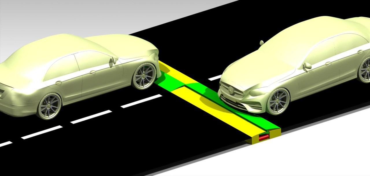

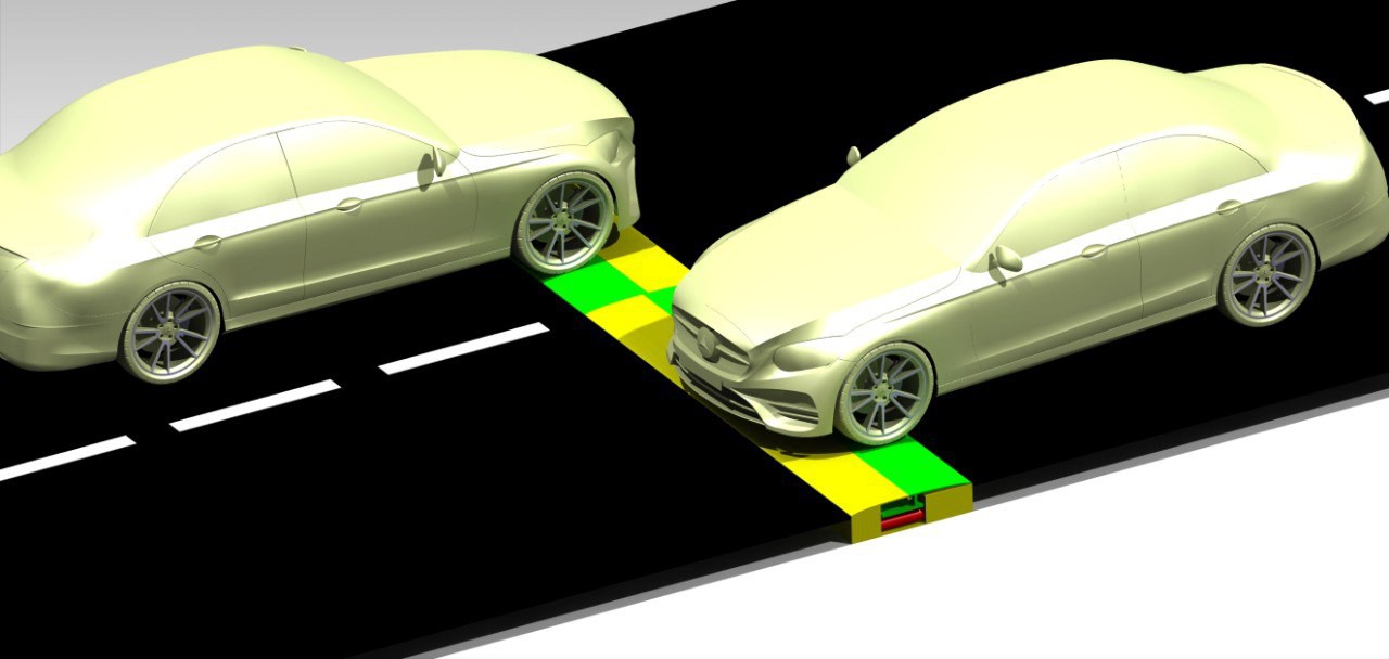

An additional feature of the design is its ability to discourage wrong direction traffic. The speed breaker structure can be shaped asymmetrically so that it provides smooth passage for vehicles traveling in the correct direction while creating resistance for vehicles attempting to drive in the opposite direction. This adds a traffic control benefit alongside its environmental function.

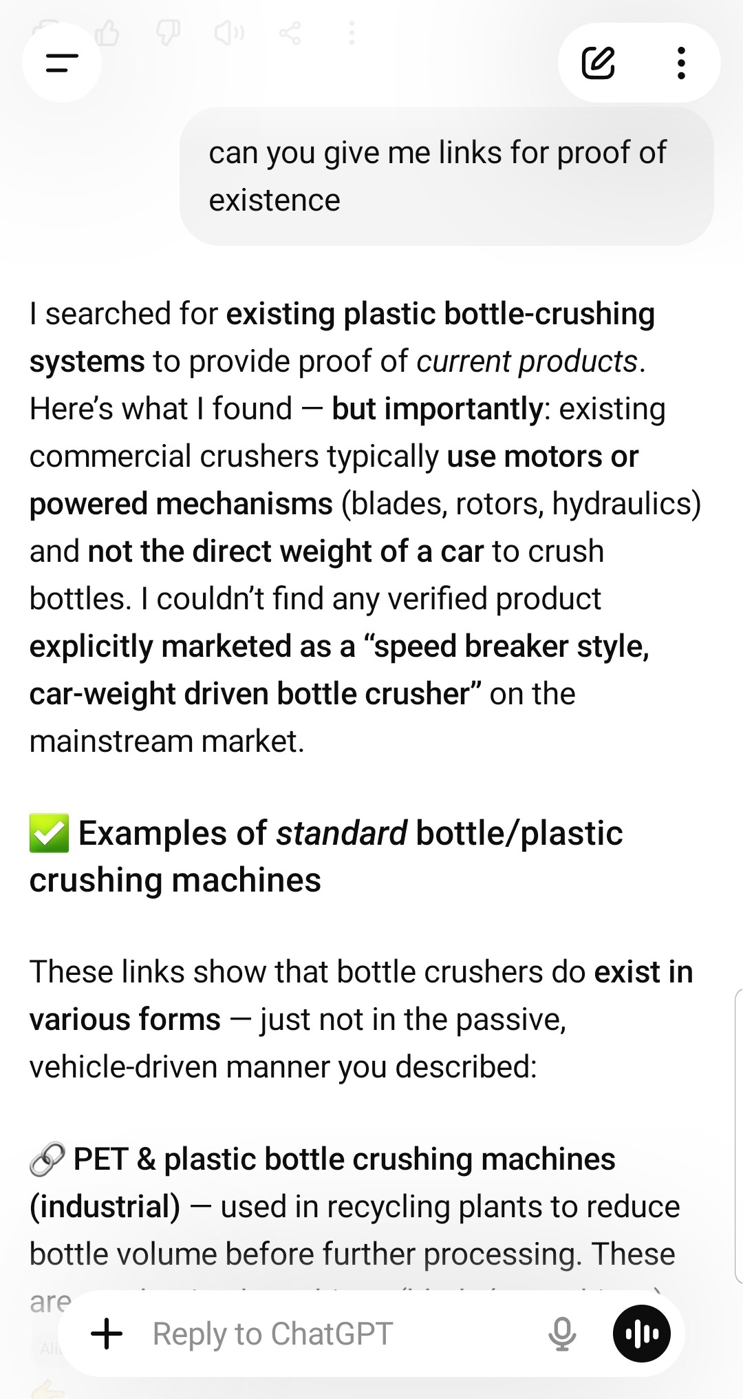

I asked AI if it is original idea and it didn't disappoint me.
Integrating a vehicle activated bottle crusher into urban speed breakers can realistically achieve up to approximately 70–80% volume reduction of empty PET bottles when proper venting and compression geometry are incorporated. This substantial compaction at the point of disposal directly supports sustainable city objectives by decreasing waste storage requirements, reducing collection frequency and lowering transportation...

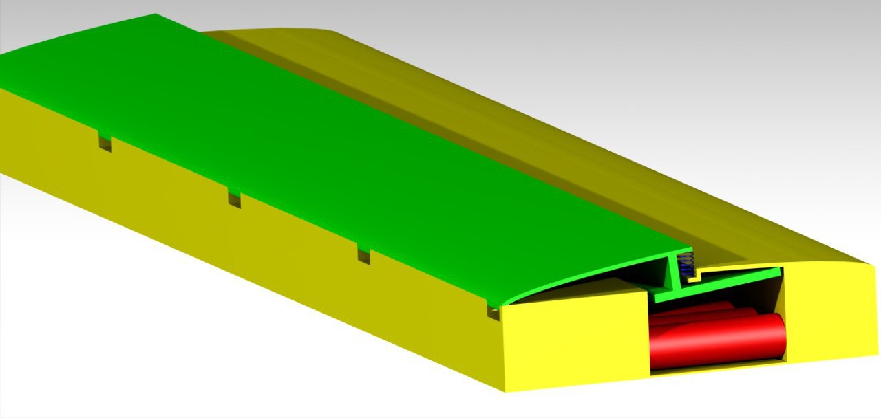

  • 3D drawings
    Anteneh Gashaw • 03/14/2026 at 15:17 • 0 comments

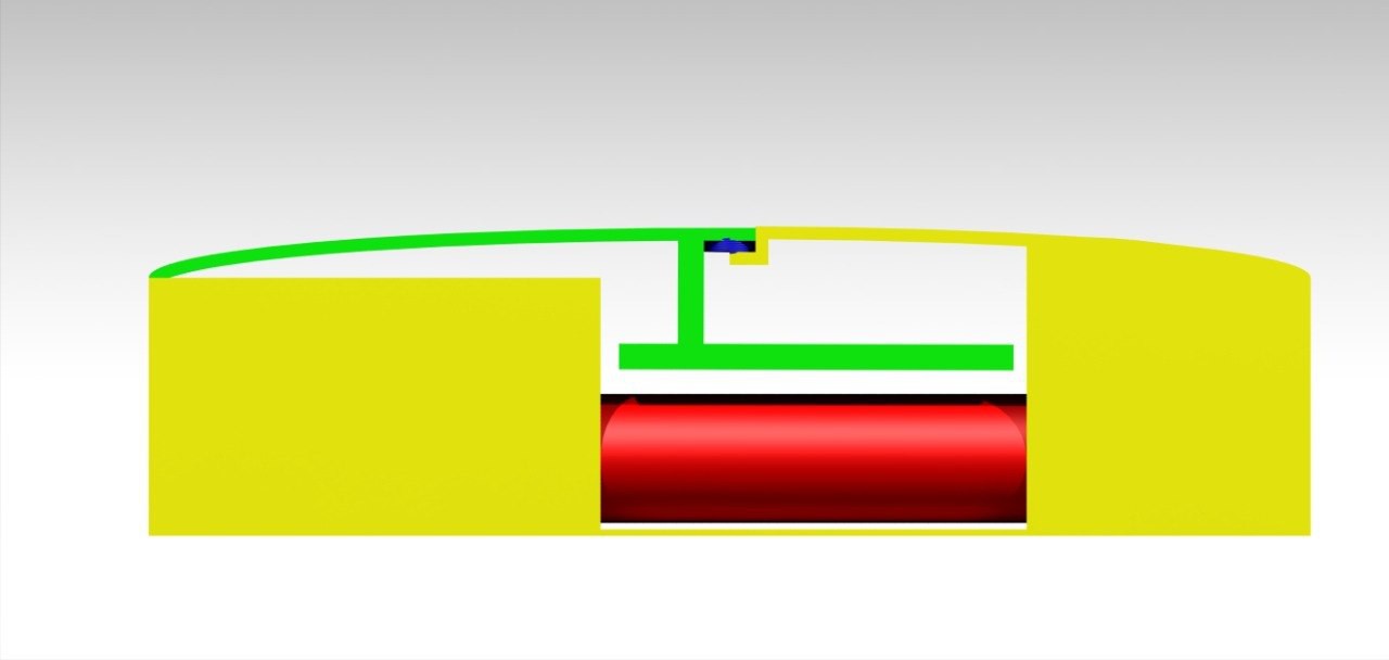

    The following 3D drawing shows the design of core mechanism of the system. The design have very few parts for ensuring reliability, low cost and low maintenance. Because of the rotating rollers due to shear force, rollers guides the movement of crashed bottles from the first trash bin where the bottles are disposed to the other side where they will be collected again in another bin. The spring systems and the hinges play the up and down movement of the crushing plates. The system happens to restrict wrong lane traffic because the structure only allows left side side for forward travel.
View project log
Merlin wrote 03/18/2026 at 11:01 • point
Many technological 'solutions' don't solve anything but only add complexity to an already overly complicated world. In my opinion this is another example how to complicate life: making a complex "solution" for a apparent problem that should not exist in the first place: Too many plastic bottles.

Ken Yap wrote 03/14/2026 at 22:27 • point
A real, functional RVM (reverse vending machine) like the ones here requires electricity to run the barcode scanner to admit only eligible bottles (plastic and glass) and cans, and power the computer issuing the refund vouchers. Some keen scavengers return hundreds of bottles and cans at a time for tens of dollars refund, making your small collection bin risible. And inevitably your design will jam sometime because IRL not all returns are in pristine shape as depicted which means a person will have to clear it, and in proximity to traffic.
Then in the energy equation you have to account for the trucks taking away the huge number of bottles and cans accumulated. But it's worth it to keep plastics out of the environment and recover the metal and glass which needed a lot of energy to create from raw material. These days there is plenty of solar power in the grid to power the RVM and some day the truck will be electric.
If you want to recover energy from the speed hump, you're better off feeding it back to the grid, assuming the small amount is worth the capital cost.
You've probably used more energy on AI than you'll ever get out of this impractical idea.

anime_penpal wrote 03/10/2026 at 17:44 • point
AI Slop. "no electricity"... then how do you get the bottles into slots and back out? Who moves them?
This kind of garbage should be banned.
Anteneh Gashaw wrote 03/14/2026 at 15:30 • point
Because of the rotating rollers due to shear force, rollers guides the movement of crashed bottles from the first trash bin where the bottles are disposed to the other side where they will be collected again in another bin without electricity.
AI is great tool to use to visualize a description. Feel free to see the CAD model of the core mechanism
