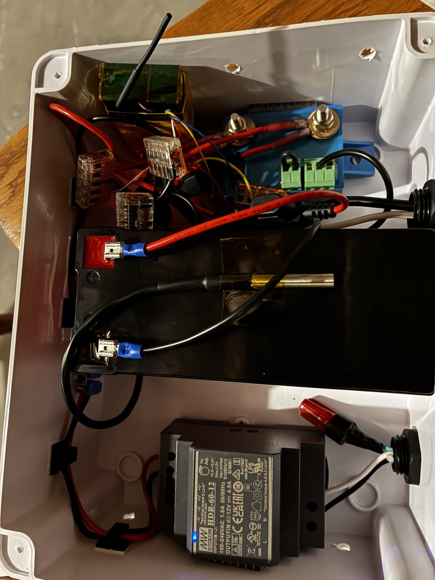

DIY 12V LiFePO4 UPS for Home Assistant Green and Xfinity XB7 modem. Victron BP-65 LVD, MOSFET ideal diode, 13.3V float, Shelly Plus Uni
System Overview
AC grid powers a Mean Well HDR-60-12 PSU set to 13.3V float, which charges a 12V 10Ah LiFePO4 battery through a MOSFET ideal diode. On grid failure, loads switch directly to battery in under 1ms. A Victron BatteryProtect BP-65 disconnects loads at 11.8V to prevent over-discharge. A Shelly Plus Uni reports battery voltage and temperature to Home Assistant.
DIY UPS for Home Assistant Green → N100DC-ITX & Xfinity XB7 Modem
A 12V LiFePO4-based uninterruptible power supply for keeping a Home Assistant Green and Xfinity XB7 cable modem running during grid outages. Built into an IP65 enclosure with Home Assistant monitoring via Shelly Plus Uni.
Honest context: A $85 APC BE600M1 provides comparable backup capability. This build costs roughly the same over 10 years as that option (based on battery replacements and electricity usage). The engineering rationale — longer battery life, faster switchover, direct HA integration, no DC-DC converter voltage regulation — is documented in design-rationale.md. Build this if those tradeoffs matter to you.

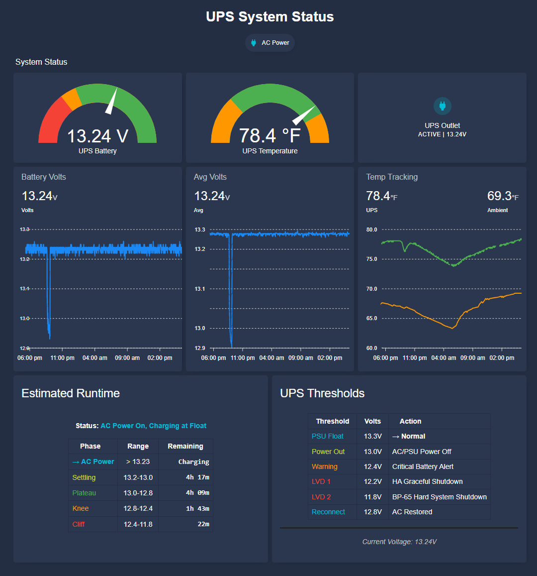

PHASE 2 UPDATE: 18V Boost Integration — 2026-08-29
TL;DR: Upgraded the HA Green to an Asrock N100DC-ITX PC and integrated onto the UPS via a Pololu U3V70A boost @ 18.0V. Load 14.9W → 26.80W DC[M]. Runtime 3.6h → 128min to LVD. Every threshold held, zero false on-battery in 26,413 samples. The scaling model we published for phase durations was falsified same night — plateau 85min projected → 43min measured[M]. One operational gap remains: EN/FET not fitted, so unattended recovery only guaranteed for outages deep enough to reach BP-65 LVD
QuantityBefore Boost (May 2026)After Boost (Aug 2026)
DC bus load steady14.9W / 1.18A26.80W / 2.089
Peak observed~1.29A2.533A / 32.48W
AC at UPS outlet16.832W30.554W
Net conversion penalty+1.21W at wall
Bus float mean13.2325V13.1970V (-35.5mV)
Margin to 13.15V on-battery trip73.0mV23.3mV
BMS 10A rating headroom21% steady, 25% peak
Validated runtime — energy still there, voltage thresholds move: The pack still delivers 53.3Wh / 4.18Ah [M] May 6. At new load: 53.3Wh ÷ 26.80W = 119 min, ÷ 25.97W measured mean = 123 min to LVD.
Boost Subsystem Design — Why This Way
Full spec: UPS-Monitor/boost-subsystem-design.md BOOST-DS-r1 (2026-07-20)
Requirement: regulated ~18V rail from UPS 12V bus replacing HA Green's direct feed, without degrading four-tier ladder or endangering XB7.
Unattended moment (design cornerstone): AC outage with nobody home. Must (a) carry host through switchover inside 17.1-20.9V window, (b) hold clean until 12.2V graceful-shutdown tier completes, (c) permit monitor-commanded shed after shutdown, (d) clean non-damaging re-energization when AC returns so BIOS auto-boots. "Working" defined at those four instants.

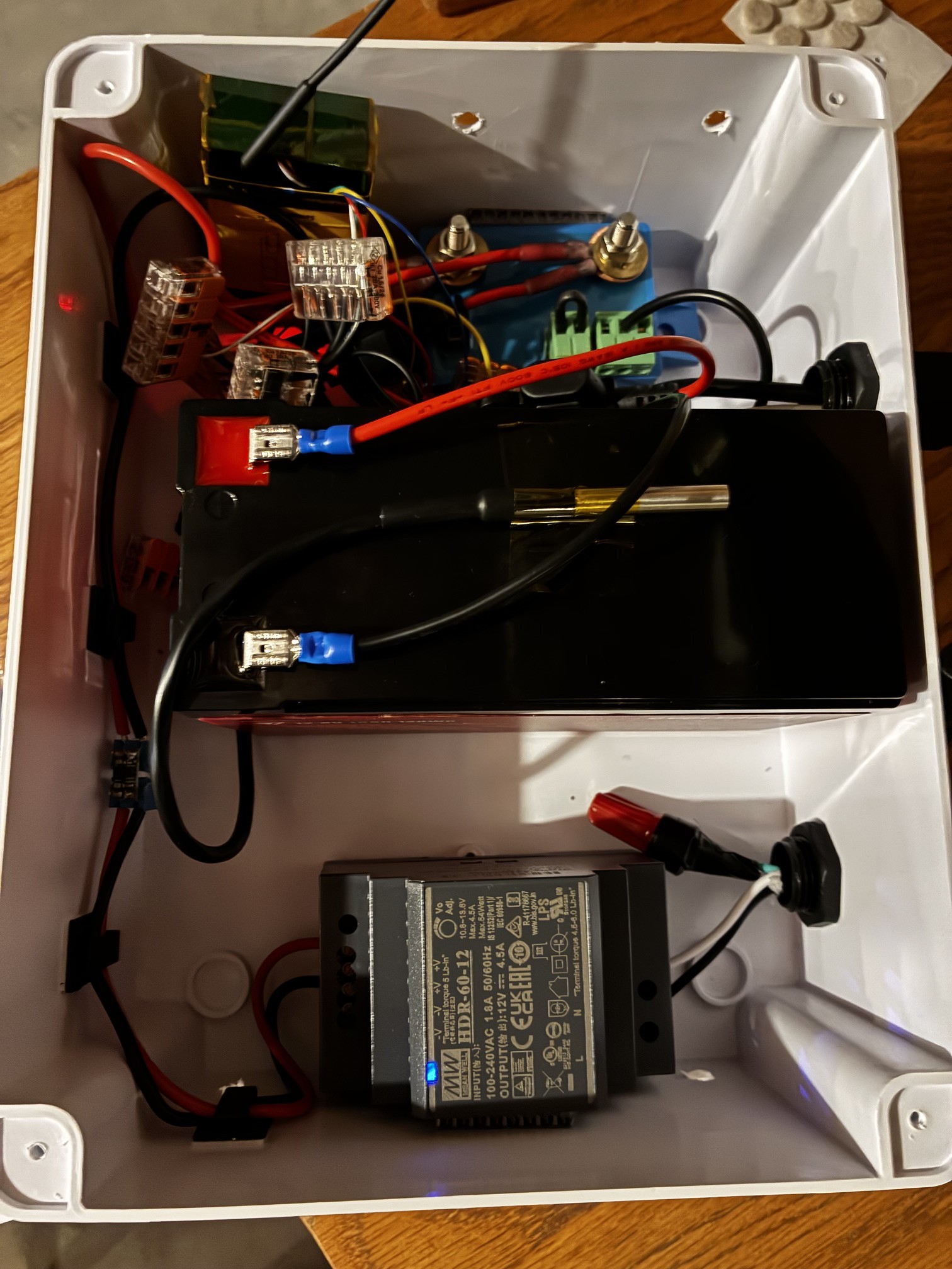

AC grid → Mean Well HDR-60-12 (13.3V float, lacquered)
        → MOSFET ideal diode ─┐Cyclenbatt 12V 10Ah LiFePO4 (10A BMS)
        | 12V bus │
        ├─ Xfinity XB7 (~12.2W DC) |
        ├─ Monitor: XIAO ESP32-C3 + INA260 + DS18B20 via D24V7F3 (~30-40mA)|
        └─ [NEW] Pololu U3V70A Boost Subsystem → 18V → N100DC-ITX |
        | Vin carrier: 220uF/50V KEMET hybrid + 10uF X7R |
        | Vout carrier: 100uF/50V Panasonic EEH-AZA1H101B + 10uF X7R |
        |Lead: 2ft 22AWG twisted, 5A fuse, 64.6mΩ RT|
        |Plug: Tensility 10-02937 5.5x2.5mm |
        |EN: broken out to header + testpoint, pulled to VIN (~12.5V) — GPIO FET planned
        Integration works electrically. Load nearly doubled and every threshold held.
        No false on-battery, no BMS pressure, no XB7 disturbance, modem stayed online through test,
        pack Ri unchanged.
Performance Summary — Validated May 6 2026 (INA260)
Validated Runtime: ∼3.6 hours to hardware LVD (11.8V) under sustained 14.9W load. INA260 coulomb-counted 4.18 Ah / 53.3 Wh.

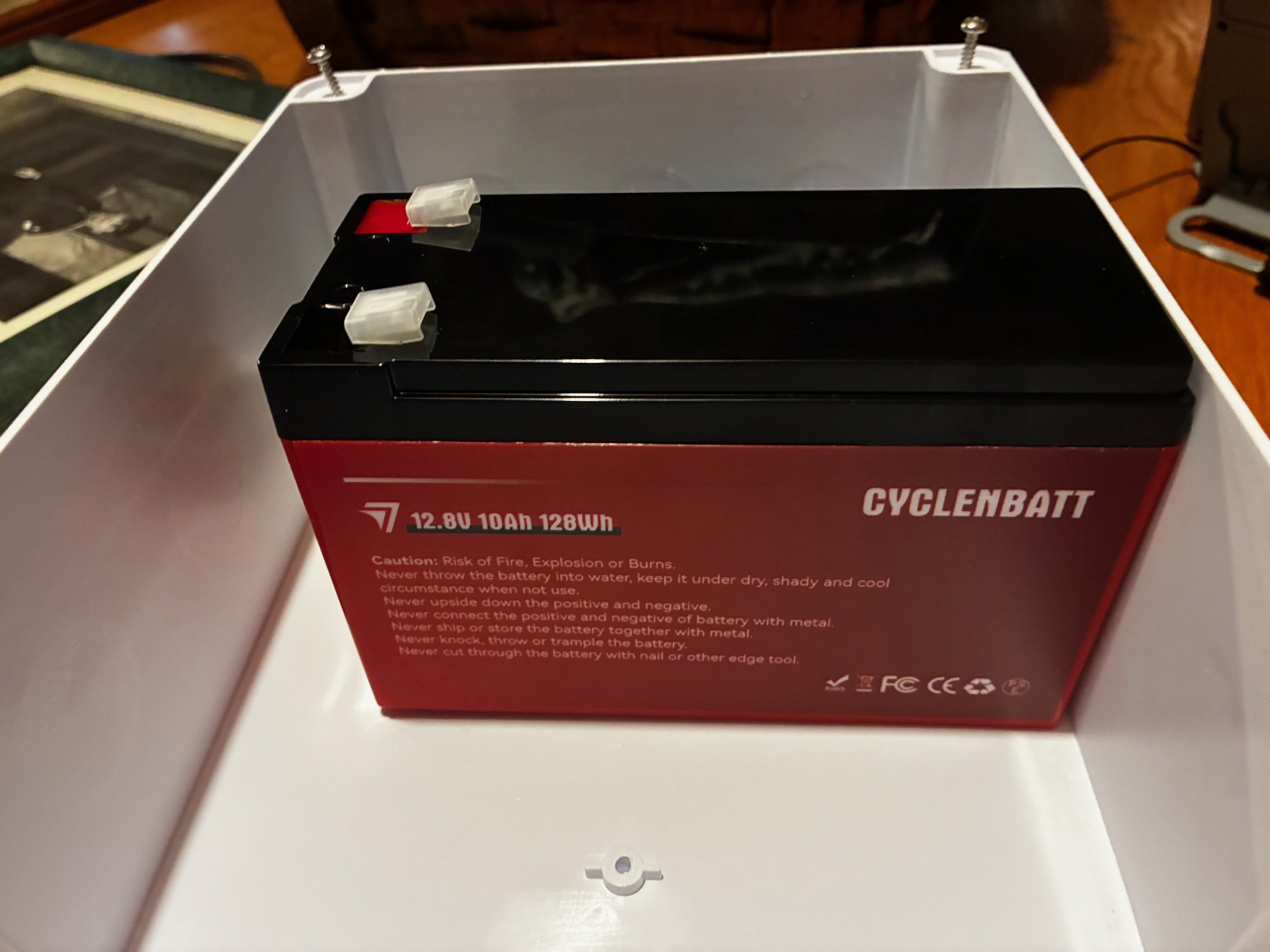

  • 1 × Mean Well HDR-60-12 PSU
  • 1 × Cyclenbatt 12V 10Ah LiFePO4 Battery

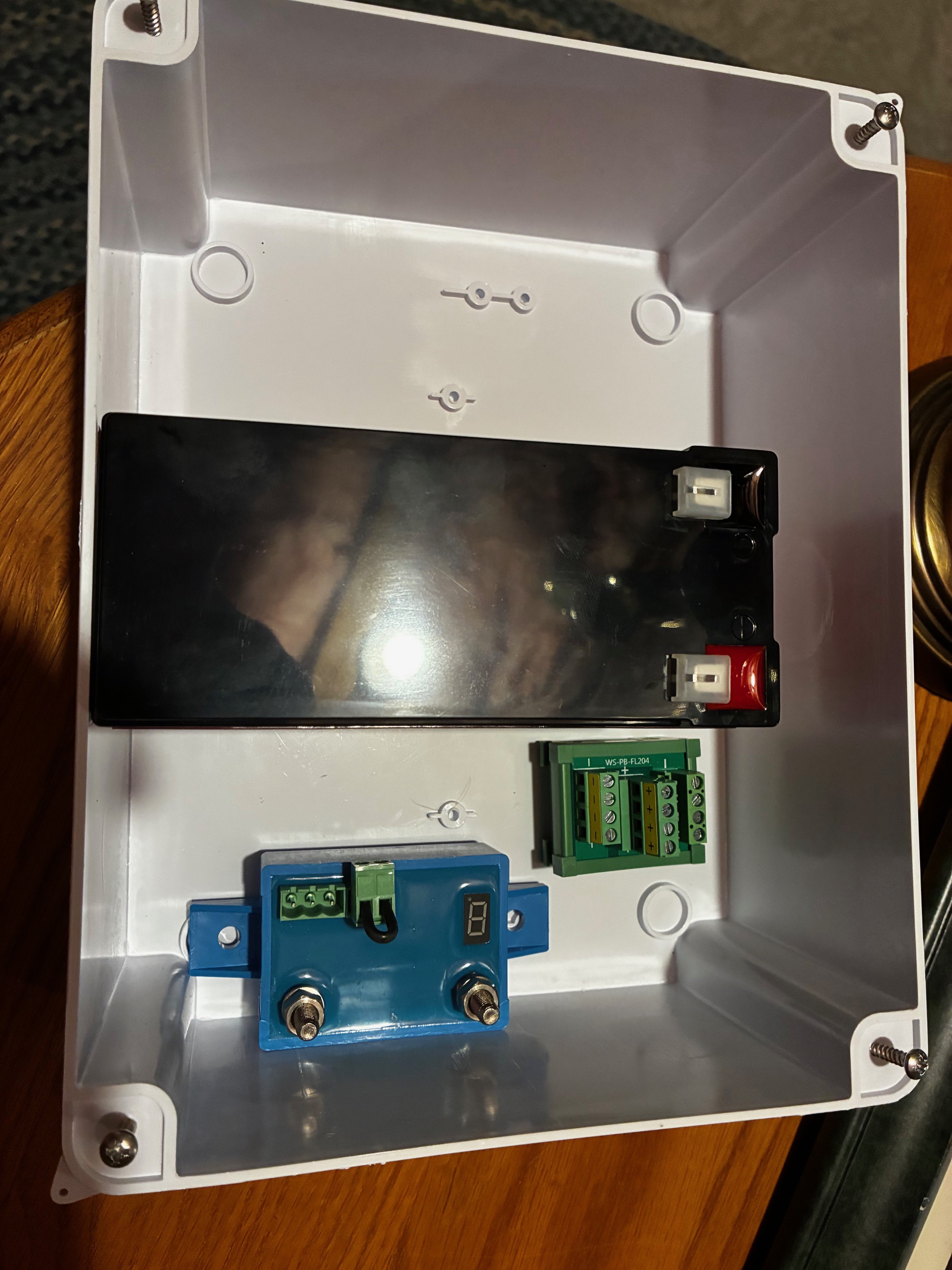

    Component Mounting
    ComponentMounting Method
    Mean Well HDR-60-12 PSUVelcro to enclosure base, stabilize to wall
    Victron BatteryProtect BP-65Velcro to enclosure base
    Pololu Ideal DiodeFloat — secure with wire ties
    Shelly Plus UniFloat — secure with wire ties
    Lever NutsFloat — secure with wire ties
    WiringCable clips as needed for strain relief

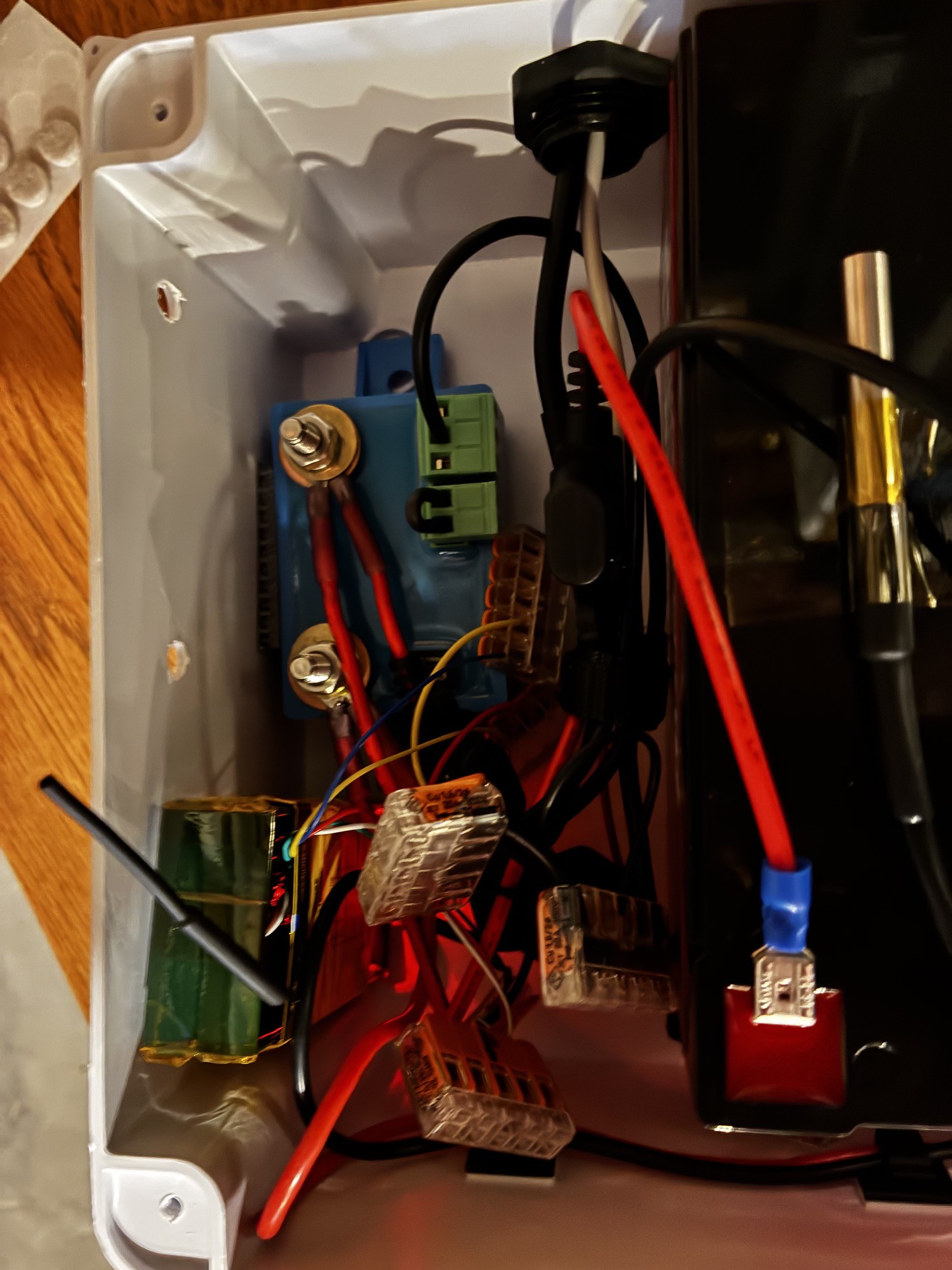

    Wiring Connections — From/To Reference
    AC Input → PSU
    FromToNotes
    Power Cord — Black (Hot)PSU Pin 1 AC/L
    Power Cord — White (Neutral)PSU Pin 2 AC/N
    Power Cord — Green (Ground)N/Agreen ground is cut back, capped with a wire nut, and taped, because the HDR-60-12 is a Class II double-insulated
    PSU → Ideal Diode
    FromToNotes
    PSU Pin 4/5 DC Output V−Ideal Diode GND (V−)
    PSU Pin 6/7 DC Output V+Ideal Diode VIN (V+)Via F1 (10A)
    Ideal Diode → Terminal Block
    FromToNotes
    Ideal Diode GND (V−)Input 2 (−)Terminal Block has 2 inputs
    Ideal Diode VOUT (V+)Input 2 (+)Terminal Block has 2 inputs
    Battery → Terminal Block
    FromToNotes
    Battery (V−)Input 1 (−)Terminal Block has 2 inputs
    Battery (V+)Input 1 (+)Via F2 (10A)
    Terminal Block → Victron BatteryProtect BP-65
    FromToNotes
    Terminal Block +BP-65 IN terminal
    Terminal Block −BP-65 GND terminalUse included 1.5mm² wire
    Victron BP-65 OUT → Loads
    FromToNotes
    BP-65 OUT terminalF3 input (2A)HA Green load circuit
    F3 outputHA Green barrel plug (center +)5.5mm × 2.1mm, center-positive
    BP-65 OUT terminalF4 input (5A)Xfinity Modem load circuit
    F4 outputXB7 Modem barrel plug (center +)5.5mm × 2.1mm, center-positive
    Terminal Block −HA Green barrel plug (sleeve)Common return
    Terminal Block −XB7 Modem barrel plug (sleeve)Common return

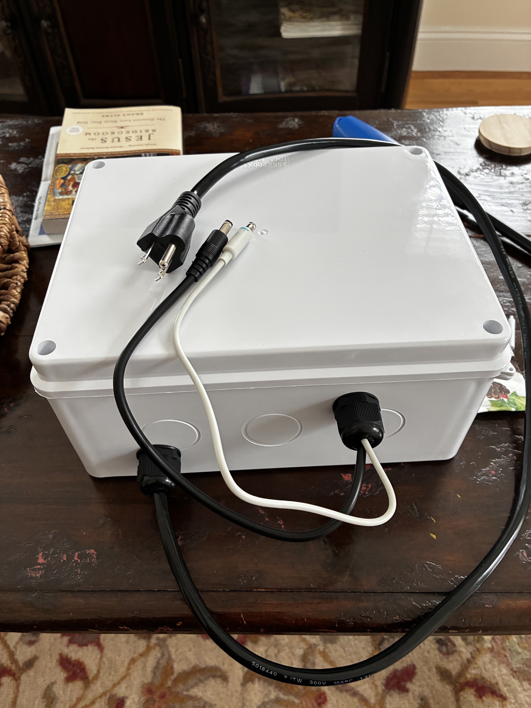

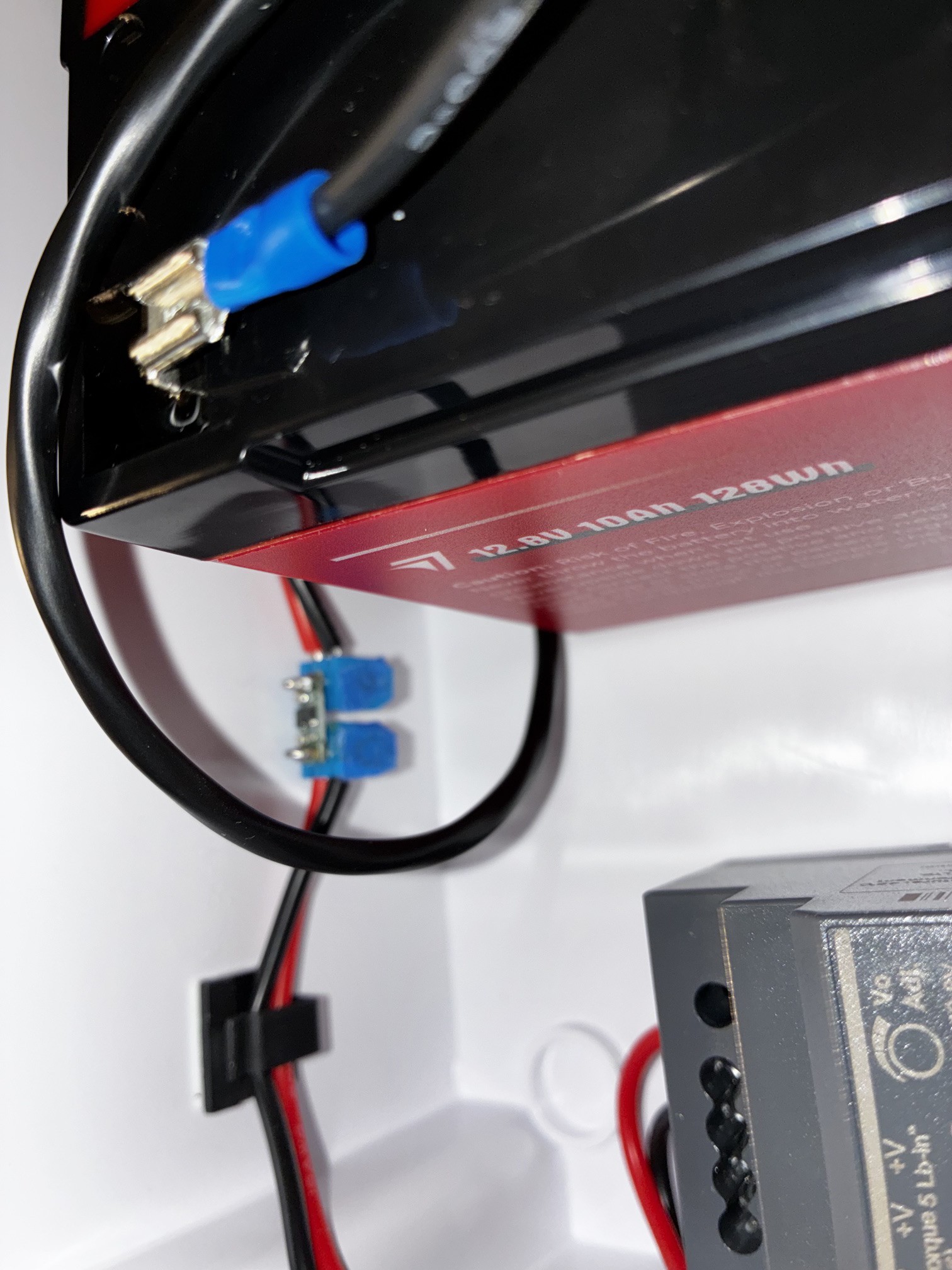

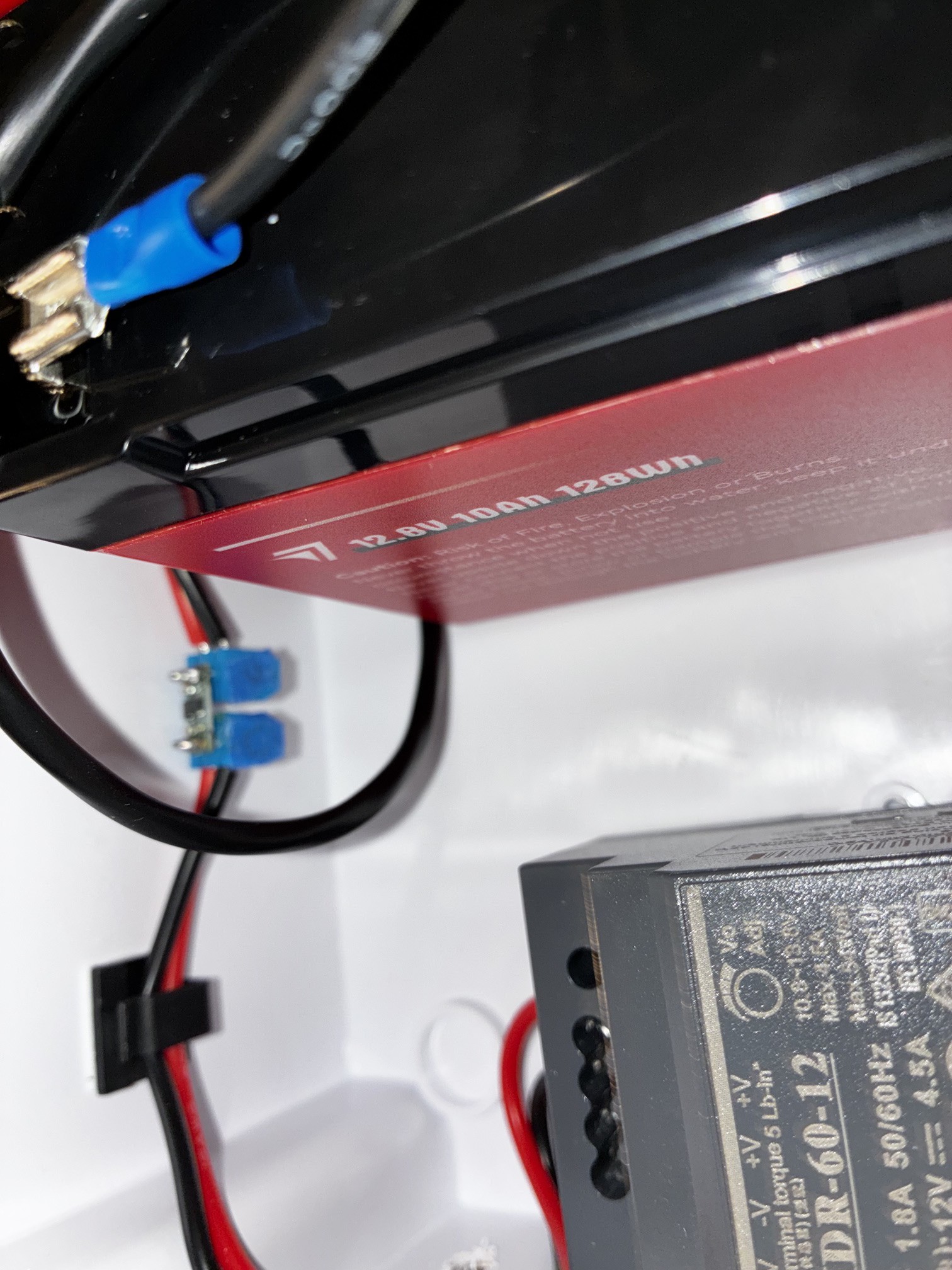

    Enclosure Layout
    See https://github.com/wkcollis1-eng/DIY-LiFePO4-UPS/blob/main/assets/UPS_Layout_with_12_Volt_Regulator.png for the assembly drawing image.
    The enclosure is a LeMotech IP65 ABS junction box (9.6″×7.6″×4.5″ interior). Key layout decisions:
    • PSU occupies the left side; battery occupies the center. Physical separation provides AC/DC segregation and reduces EMI coupling.
    • Cable glands (1/2" NPT) on the bottom face: AC input on the left, DC output barrel jacks on the right.
    • Victron BP-65 mounts on the right side wall. Terminal block sits between battery and BP-65.
    • Shelly and ideal diode float above the battery, secured with wire ties.
    • All 16AWG runs are kept to approximately 6" segments to hold voltage drop 41mV at typical load and 63mV at peak.
