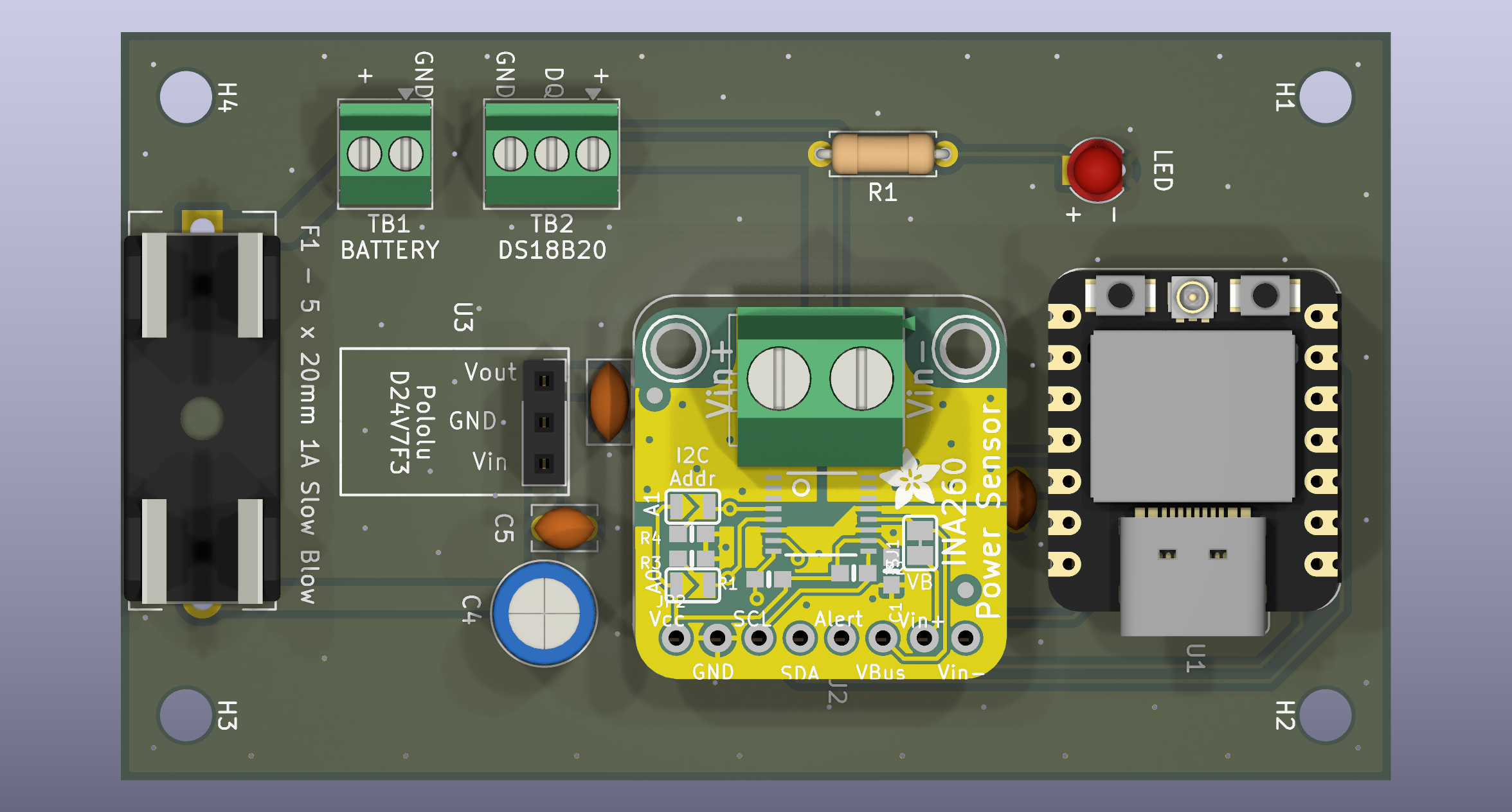

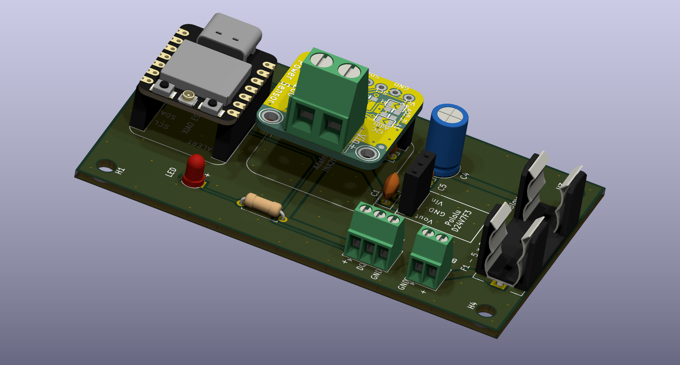

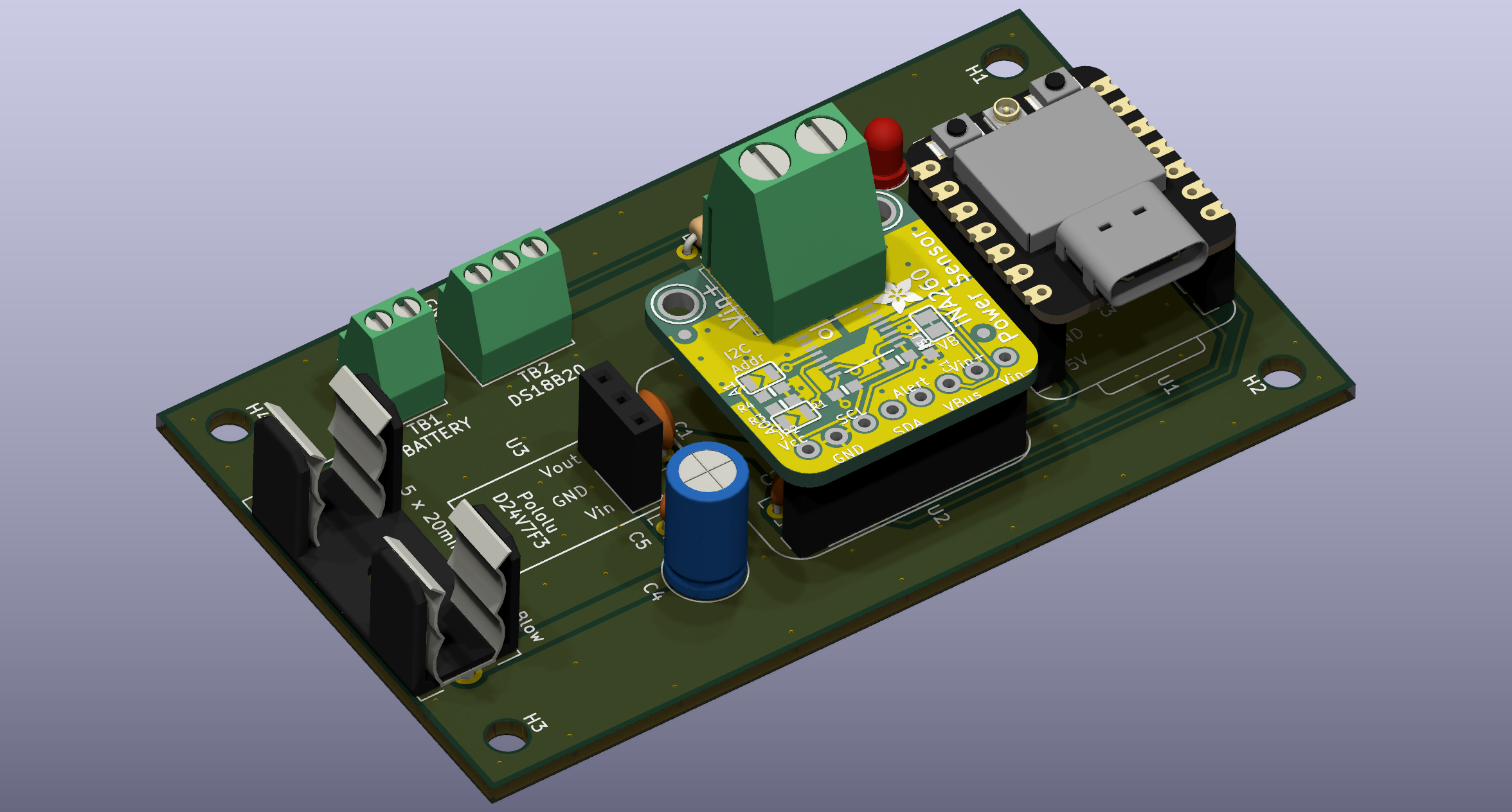

Monitoring upgrade: Shelly Plus Uni replaced April 2026 by ESPHome XIAO ESP32-C3 + Adafruit INA260 + DS18B20. All capacity figures below are now coulomb-counted, not inferred from voltage.

AC grid → Mean Well HDR-60-12 PSU set to 13.3V float (trimmer lacquered, drift 3–5 mV/year) → MOSFET ideal diode → 12V 10Ah Cyclenbatt LiFePO4 → Victron BatteryProtect BP-65 disconnects at 11.8V after 90s hold-off. On grid failure, loads switch to battery in <1ms. ESPHome XIAO ESP32-C3 + INA260 + DS18B20 reports voltage, current, power, accumulated Ah/Wh to HA via Pololu D24V7F3 3.3V regulator (30–40 mA draw).
