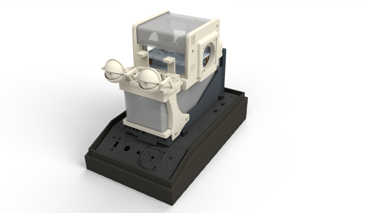

To make the robot portable, I wanted it to be in as compact a form as possible. This was a challenge given the size and shape of the original CRT and boards, as well as the battery and other components. The other aspect that influenced the design of the robot was the desire for it to feel like a product. I wanted it to feel commercial, like you could have bought it at a store. Something along the techno-futuristic style of Fallout. I wanted it to have a semblance of a body, and framed this around the pop-up housing taken from the original TV. The "brain" and electronics would sit on top.

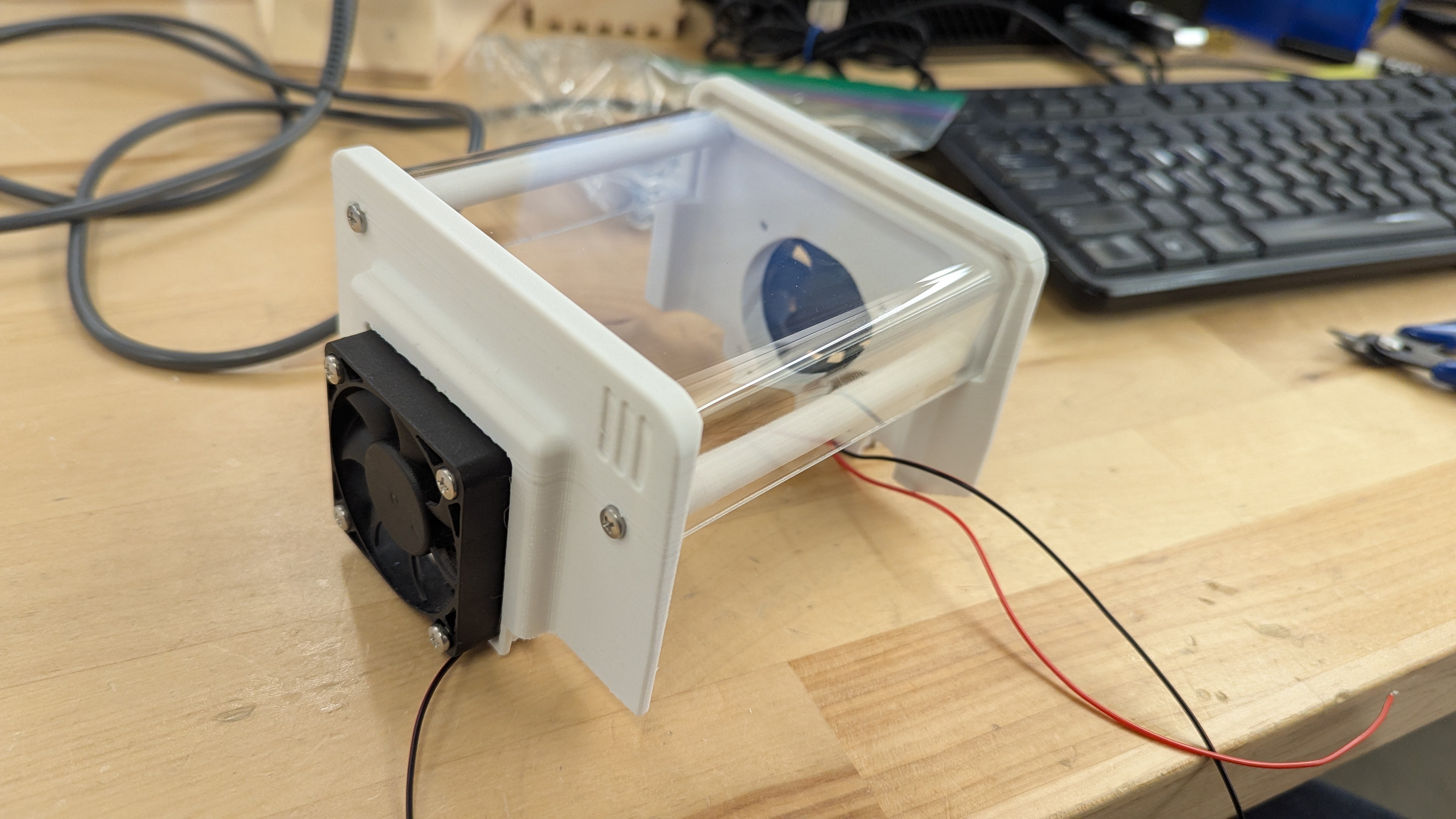

- The majority of parts were 3D-printed out of PETG or PLA.
- The clear covers used 3 mm acrylic
- Part of the enclosure utilized the pop-up housing taken from the original TV
All 3D printing files attached below as well as available on Printables here.
The entire CAD model is publicly available on OnShape here.
The top of the robot was made to be removable, to allow easy access to the "brains". This removable top also houses the cooling fans. This section is held in place by 4 magnets, and re-purposed battery contacts provide power for the fans.

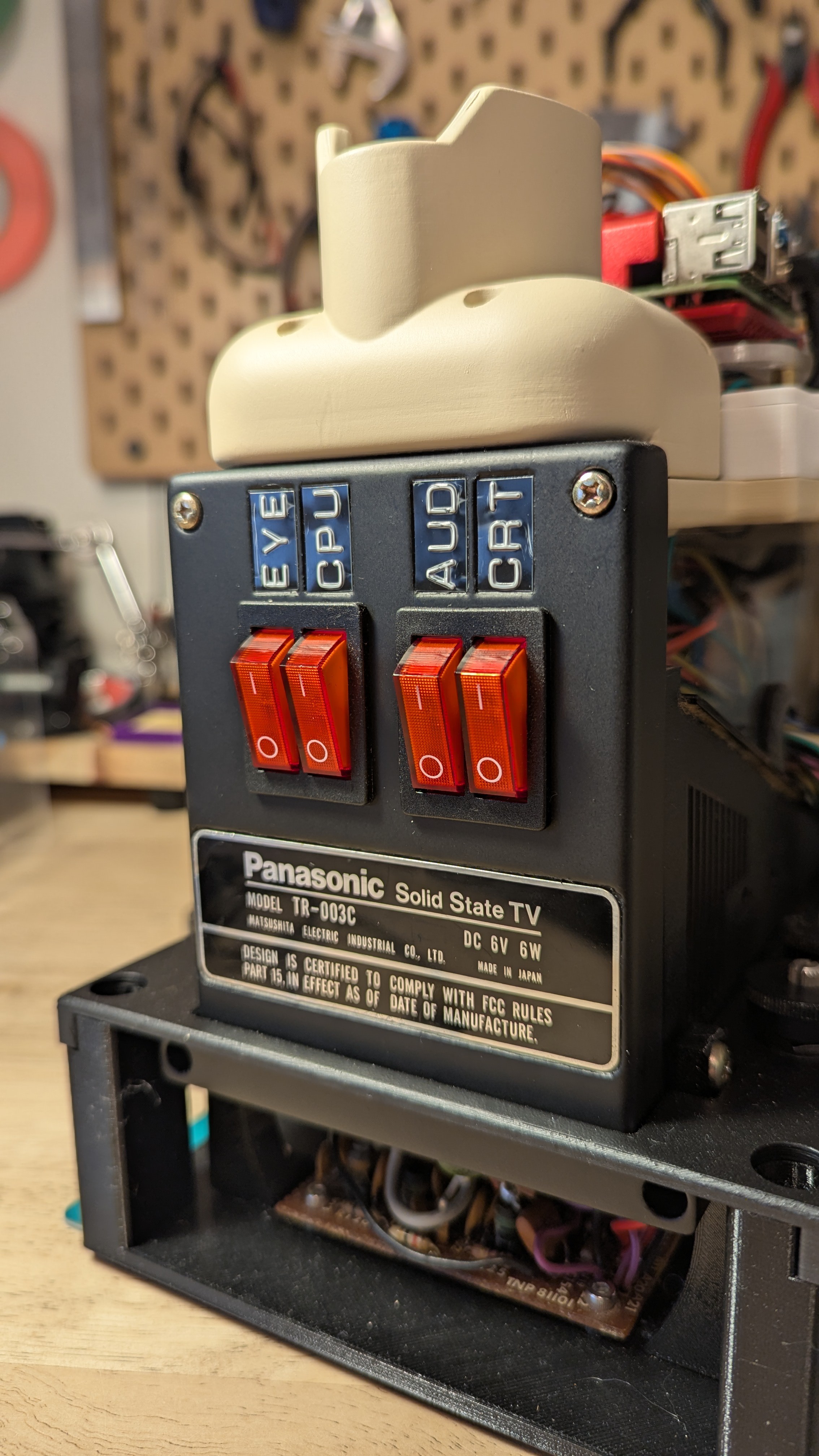

The rear of the robot has panel of labelled switches, so individual systems can be switched off and on. This area also allowed me to include one of the original Panasonic TR-003 C labels. See the Power and Wiring section for more details.

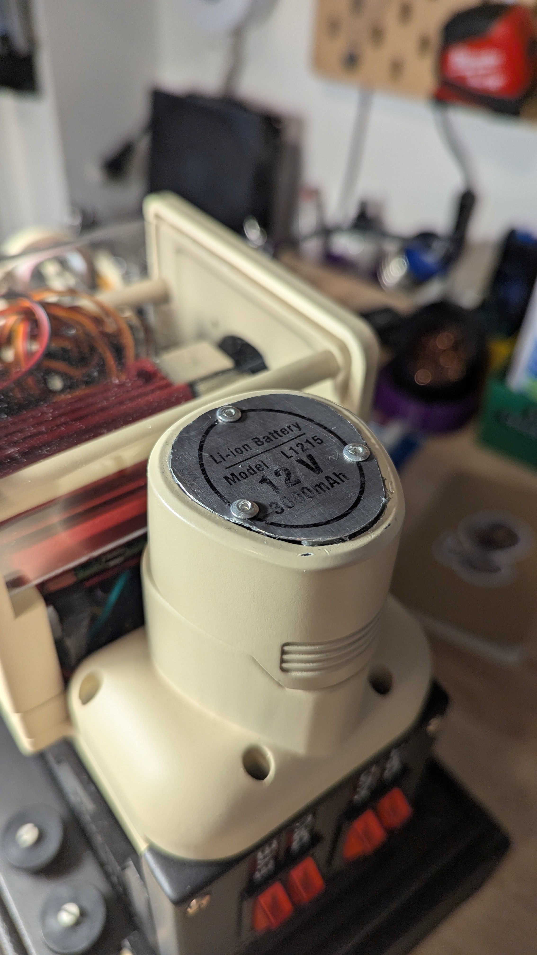

I felt that a removable battery fit the aesthetic of this build. I liked the idea of being able to unplug/plug in a battery, and swap out replacements. I chose a 12V Rigid battery, since I already had a charger for these. I added a metal label plate on the top, to keep it inline with the overall look of the robot.

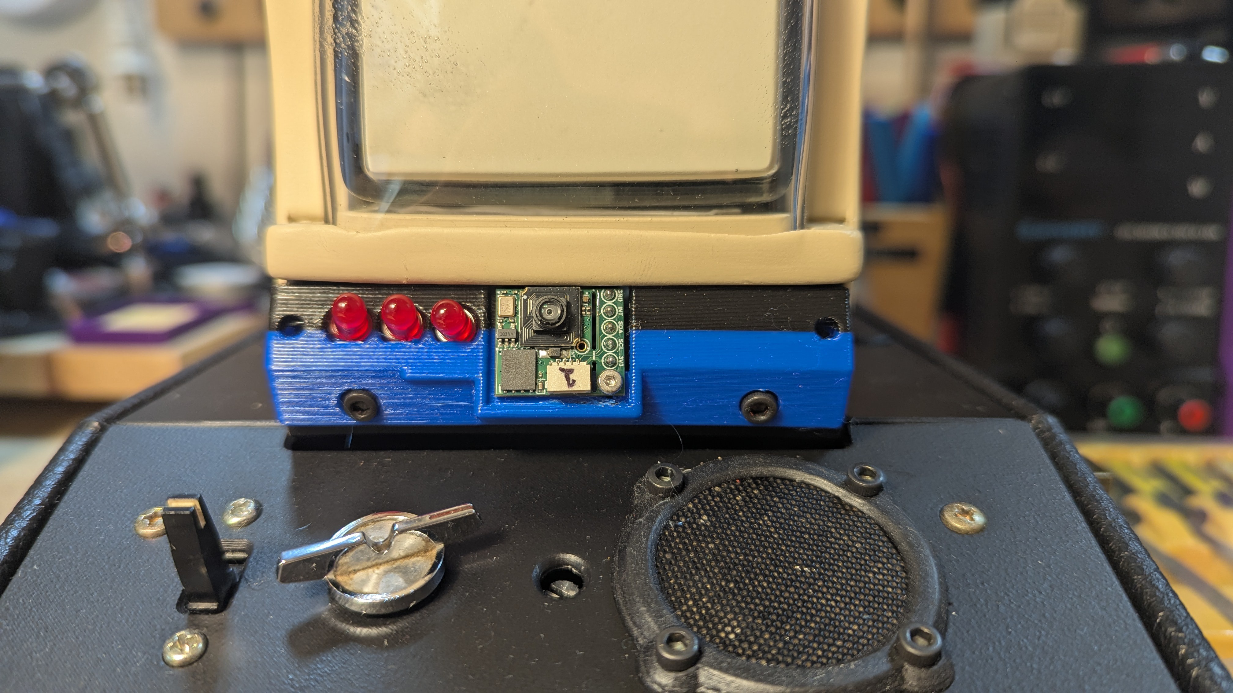

Finally, the front panel of the robot has the main ON/OFF switch, a dial for speaker volume, and a mesh cover for the microphone. The person sensor, which is used for facial tracking, is concealed above the front panel next to a row of LEDs. These are currently unpowered. I hid the person sensor here because I didn't want it to be an obvious camera. I wanted the user to see the robots eyes and believe that was how it was seeing the world.

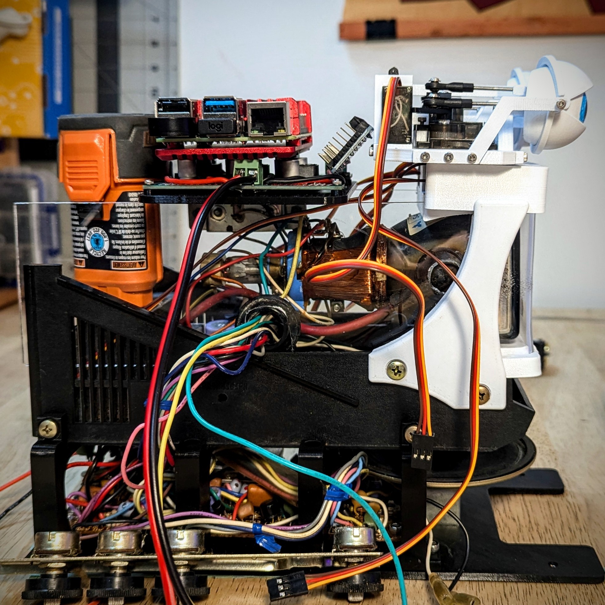

3. Animatronic Eyes
The animatronic eyes in this video use Will Cogley's Advanced Eye Mechanism. Will Cogley is a maker who has designed a wide range of animatronics....
