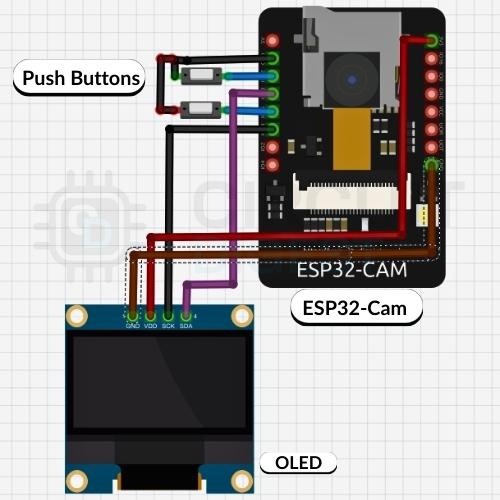

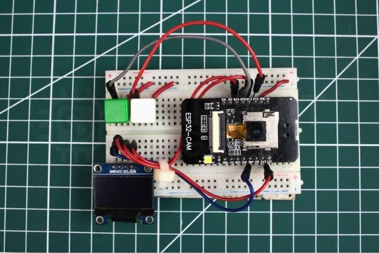

Power & Setup:
Connect the ESP32-CAM, OLED display, and buttons on a breadboard. Set the I2C pins for the OLED and assign GPIOs for the buttons. -

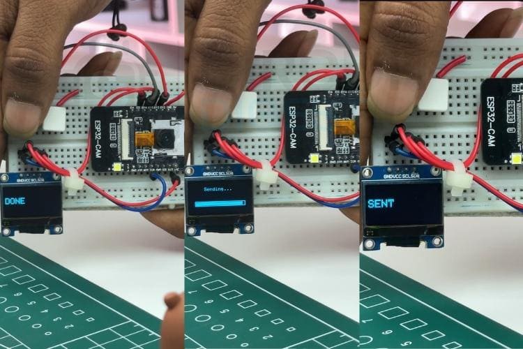

Button A — Capture:
When pressed, the camera module snaps a photo. The OLED displays a flash animation and a “Done” message when the image is stored in memory. -
Button B — Send:
After capturing, press the second button. The ESP32 CAM connects to your Wi-Fi and sends the stored image to a cloud API endpoint. This API relays the photo to your registered email. -

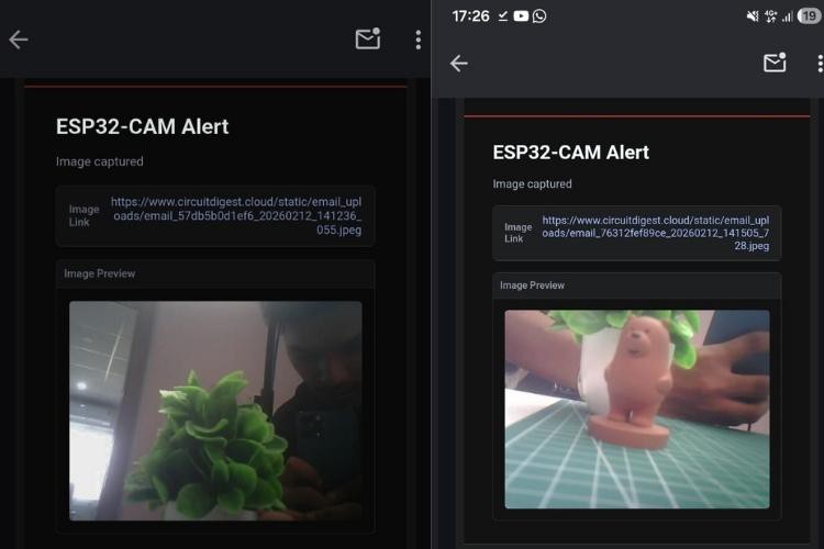

Email Delivery:
The email arrives with the photo attached, letting you view or download it immediately.
