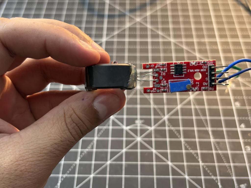

I built a DC ammeter using a toroidal ferrite core and a Hall Effect sensor (WSH130NL). The idea is, when current flows through a wire wound around a toroidal core, it creates a magnetic field inside the core. For AC measurements we can just use a secondary winding and get a pretty good step down transformer producing an effective voltage which can be converted into current values. But with a DC steady signal we have to measure the magnetic flux in a different manner.
By cutting a gap in the toroidal core and placing a Hall Effect sensor in that gap. With this we can measure the magnetic flux density, which is directly proportional to the current flowing through the windings. I know this is the same thing which is used in clamp meters and that’s how the idea comes to my mind. Overall now with this approach we get an isolated, non-invasive current measurement. And by choosing the right number of windings, you can adjust the sensitivity and resolution of your ammeter to suit your needs. The same can be converted later with the help of a PCB provided by JLCPCB. As I got my MCU dev board fabricated from there in a $2 price.

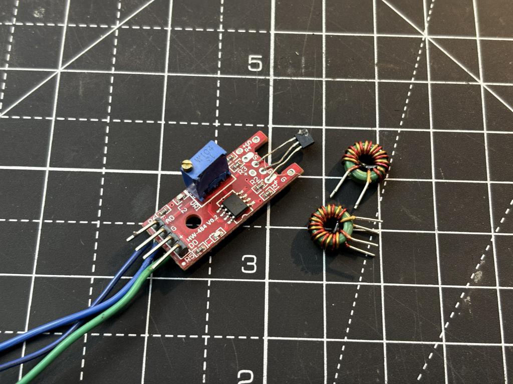

WSH130NL Sensor:
Better the sensor more linear will be the output with good resolution. I am using this breadkout module board which is available in the same price of the sensor.
  • Wide supply voltage range (2.4V-26V)
  • Temperature compensation
  • Small TO-92S package
  • Fast response - sub-microsecond switching times
  • Low power consumption - only 2mA typical
The sensor includes on-chip temperature compensation, so as temperature changes can shift the magnetic characteristics of both the ferrite core and the sensor itself.

  • WSH130NL Hall Effect Sensor
  • Toroidal Ferrite Core

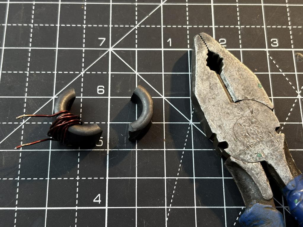

Cutting the Air Gap:
This is the most critical and tricky step. We need to cut a small gap in the toroid where the Hall sensor will sit. Let me tell you what I did, I just took a plier and broke it into two pieces. This may be non ideal but I can later glue the parts to fix it. You can use a Dremel with a thin cutting disc or a fine hacksaw blade. Cut slowly and steadily. After...
