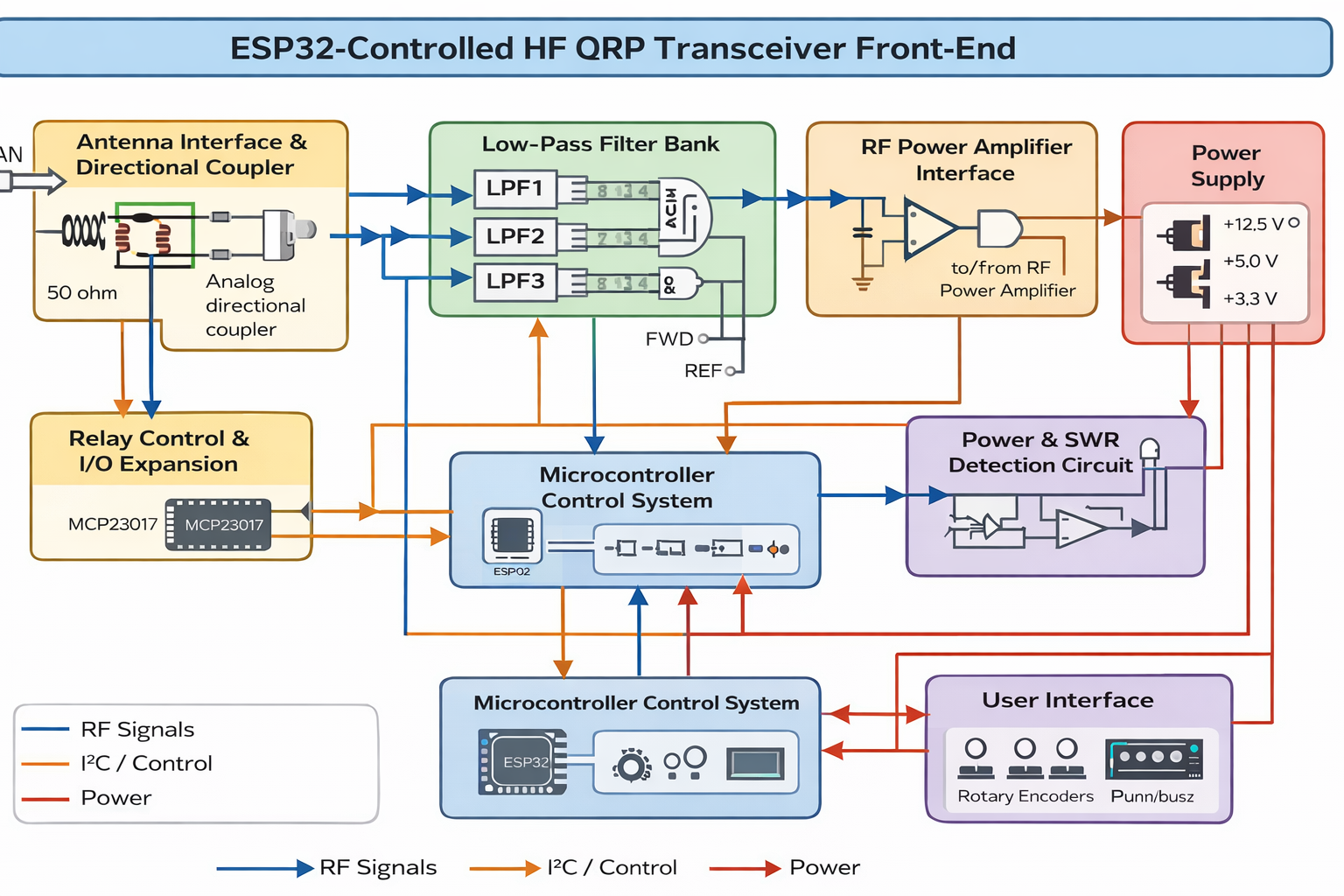

Overall Architecture
The design combines four key subsystems:
  1. RX: RF signal conditioning (Low pass filters and Tayloe QSD demodulator)
  2. TX: Power Amplifier, SWR and Power RF measurement
  3. digital control (ESP32 + MCP23017 filters switching + MAX98357 audio out)
  4. operator interface (encoders, display, buzzer)
Together these blocks form the front-end control and monitoring infrastructure of a modern QRP HF transceiver platform
1. Power and SWR Detection Circuit
The antenna port feeds a directional coupler built around a binocular ferrite core (BN43-202).
This block samples the RF energy traveling in both directions on the transmission line.
Main functions:
  • Sense forward power delivered to the antenna.
  • Sense reflected power caused by impedance mismatch.
  • Provide low-level RF samples for the measurement circuitry.
Two secondary windings on the binocular core couple a small fraction of the RF current from the transmission line. The resulting signals are rectified by detector diodes and converted to DC voltages proportional to the RF power.
2. Low-Pass Filter Bank
The RF signal passes through a bank of relay-selected low-pass filters (LPF) designed to suppress harmonic emissions during transmission.
The filters cover the HF spectrum using three bands:
FilterHam Bands CoverageFrequency Range
LPF11.8 – 3.5 MHz0.1 - 5 MHz
LPF25 – 7 – 14 MHz5.1 - 10 MHz
LPF321 – 28 MHz10.1 - 30 MHz
Each filter is a 7 poles Chebishev LC network built with toroidal inductors and RF capacitors.
Functions:
  • Suppress transmitter harmonics
  • Maintain regulatory spectral purity
  • Provide good impedance matching in the passband
Latch Relays route the RF signal through the correct filter depending on the operating frequency selected by the controller.
The relay bank is driven by an I²C GPIO expander, the MCP23017.
This device expands the number of digital outputs available to the controller and performs several tasks:
  • Drives filter-selection relays
  • Controls RX/TX switching relays
  • Simplifies wiring by using the I²C bus
Using an expander allows the microcontroller to manage many control lines while using only two pins (SDA and SCL).

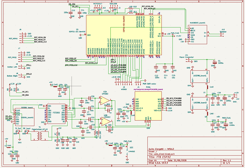

4. Microcontroller Control System
The central controller is an ESP32 microcontroller board.
It manages:
  • the RF control logic
  • the Digital Signal processing
  • the user interface
  • WiFi or Ethernet communication
Responsibilities include:
  • Selecting the appropriate low-pass filter
  • Reading SWR and power measurements
  • Managing RX/TX switching
  • Driving the display
  • Handling user input from rotary encoders and buttons
The ESP32-S3 provides significant processing capability and built-in peripherals, making it well suited for digital control of RF equipment.

YD-ESP32-S3-SCH-V1.4 (1).pdf
ESP32-S3 board Schematic
Adobe Portable Document Format - 419.02 kB - 06/28/2026 at 13:19

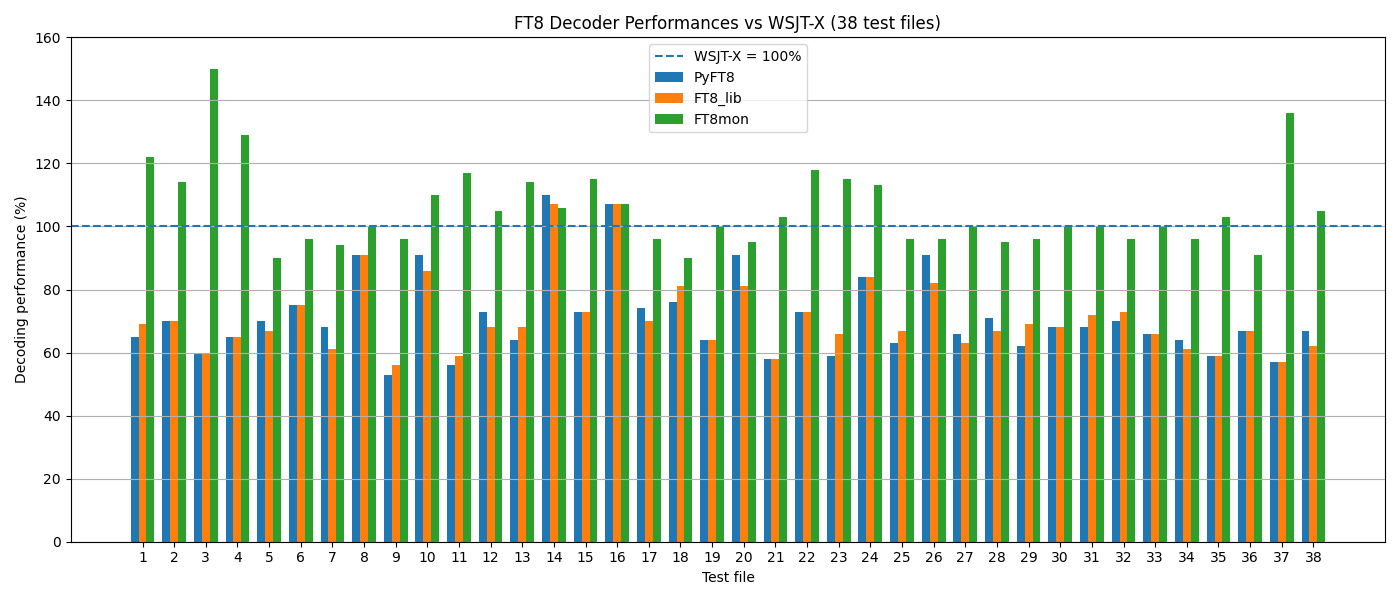

  • New FT8MON decoder
    Guido - IW5ALZ07/27/2026 at 08:08 0 comments
    I forked and modified https://github.com/guido57/ft8mon (by Robert Morris, AB1HL) to obtain a C++ program with reduced memory and processing needs.
    My aim is to port it to ESP32-S3 to substitute the actually working decode based on ft8lib.
    The testing results on linux (see below) are very encouraging as it performs the same (or slightly better) of WSJT-X.

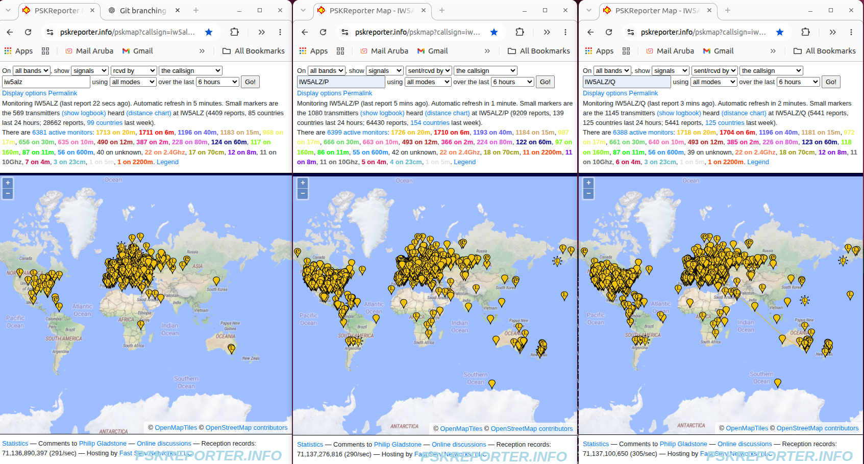

    TEST: 6 hours on 20m band
    • On the left: ft8lib on ESP32-S3 decoded 569 transmitters received in 6 hours
    • On the middle: wsjt-x on Linux (receiving the audio stream from ESP32-S3 decoded 1080 transmitters
    • On the right: ft8mon on Linux (receiving the audio stream from ESP32-S3 decoded  1145 transmitters
    Benchmark WSJT-X vs PyFT8 vs FT8lib vs FT8mon
    using https://github.com/kgoba/ft8_lib/tree/master/test/wav/20m_busy wav test flies
