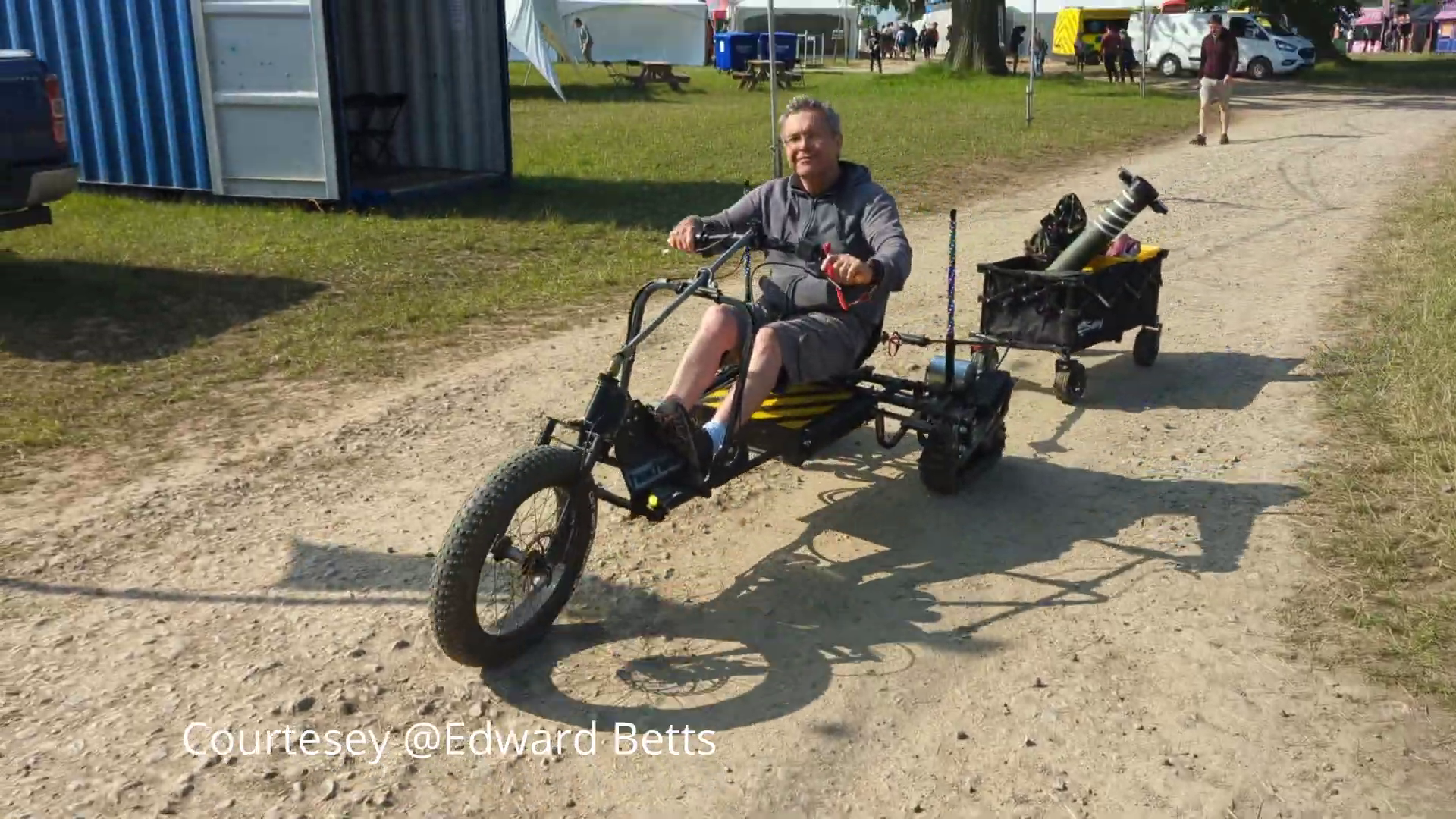

  • Finally got it to EMF camp
    Tony Goacher • 04/22/2026 at 15:59 • 0 comments
    After the motor controllers failing 2 weeks before EMF camp things weren't looking too good. But, I managed to find a UK source of the VESC 75100 controllers (at £88 each!) and get them delivered with a couple of days to spare.
    With these fitted and the new, larger track sprockets (seen here with the old silver one for comparison)
    everything looked OK and off to EMF camp I went.
    As usual , we had an amazing time and TrakTrike worked perfectly. Mission accomplished........

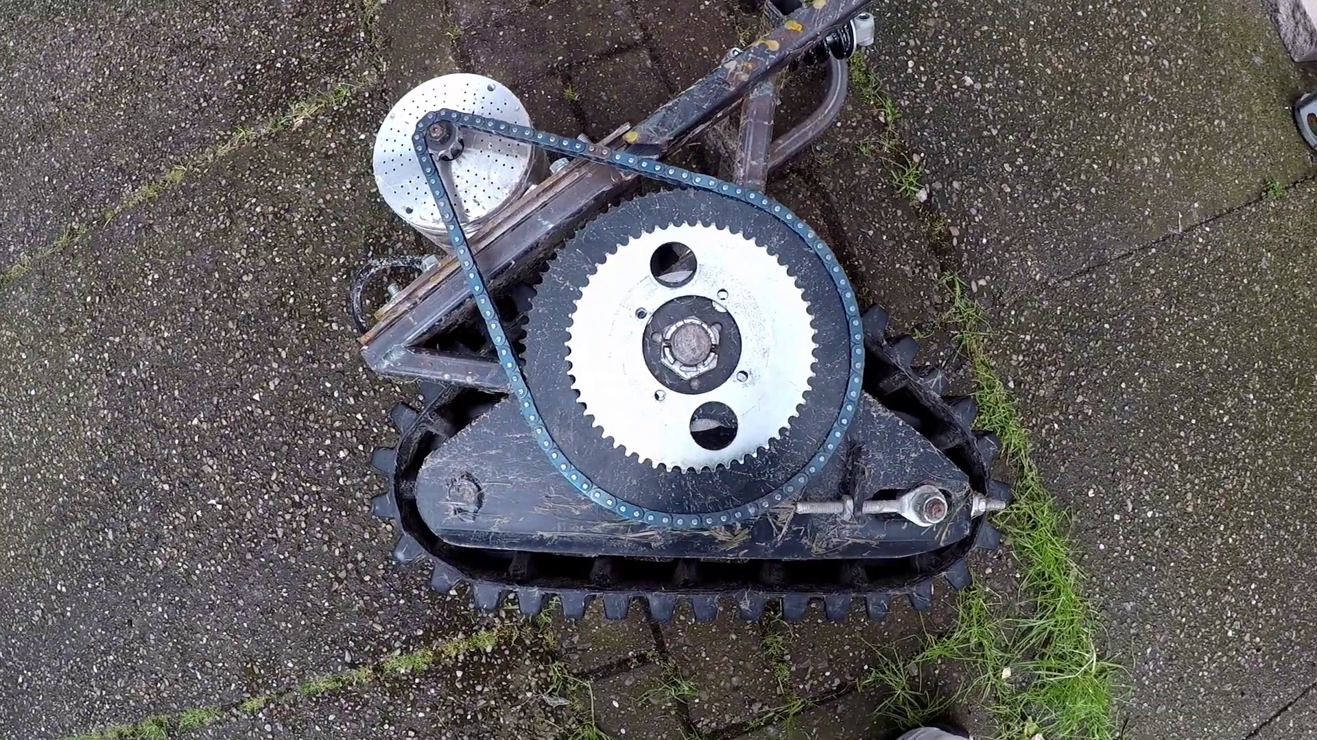

    In 2025 I took TrakTrike to WHY 2025 in the Netherlands.....and it failed on the first day. Both motor controllers failed. I managed to disassemble it and get the site guys with a vehicle to take the parts back to my car.
    Some of the Hacky Racers guys were there and having a chat with them, they recommended 'any BDLC controller on Aliexpress for over £30'.
    So I bought a couple of 2kW units and fitted them. I got rid of all the dual channel electronics that I'd spent so much time with and just wired the throttle straight into both controllers.
    Now it's working....but, the slow speed on these controllers is notoriously bad. Even a slight twist of the throttle sets you off at a pace unacceptable for maneuvering.

    In an attempt to improve starting I swapped out the stock motor controller for more sophisticated VESC 75100 clone. These have a serial PC interface that allows acceleration and power settings to be configured.
    And so with these changes it was time for another test.
    Stability was massively improved and starting seemed better, but still not quite right. I definitely had fun during the test though.
    I'll just tweak the motor controller settings a little. And that was it. Both controllers failed. Didn't even show up as a serial port in the configuration software.

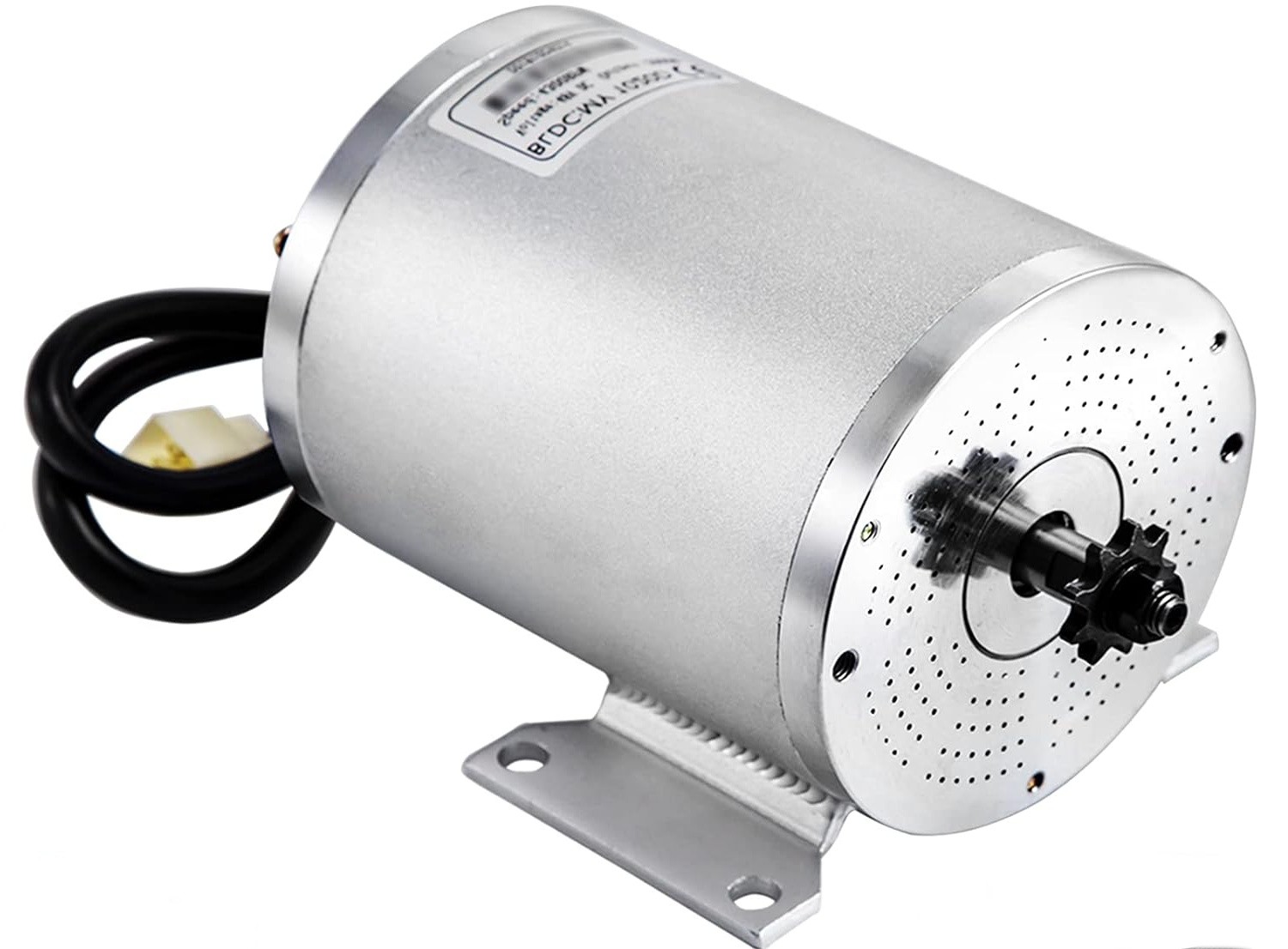

    The TrakTrike is driven by 2 x 2kW BDLC motors, one for each track. I planned to control speed with a handlebar twist grip. To enable me to trim the speed of each motor I decided to use an Arduino Nano to sample the throttle position , and then split this off to set the value of two digital potentiometers. Using this method I can adjust the speed value to each side individually. For motor controllers I'm using the stock devices supplied with the motor itself.
    I'm also adding a LCD display and a rotary encoder/switch combo to allow me to navigate through various functions.

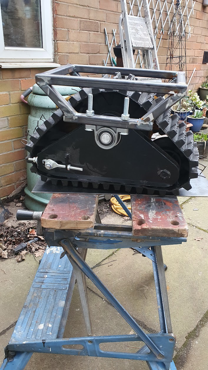

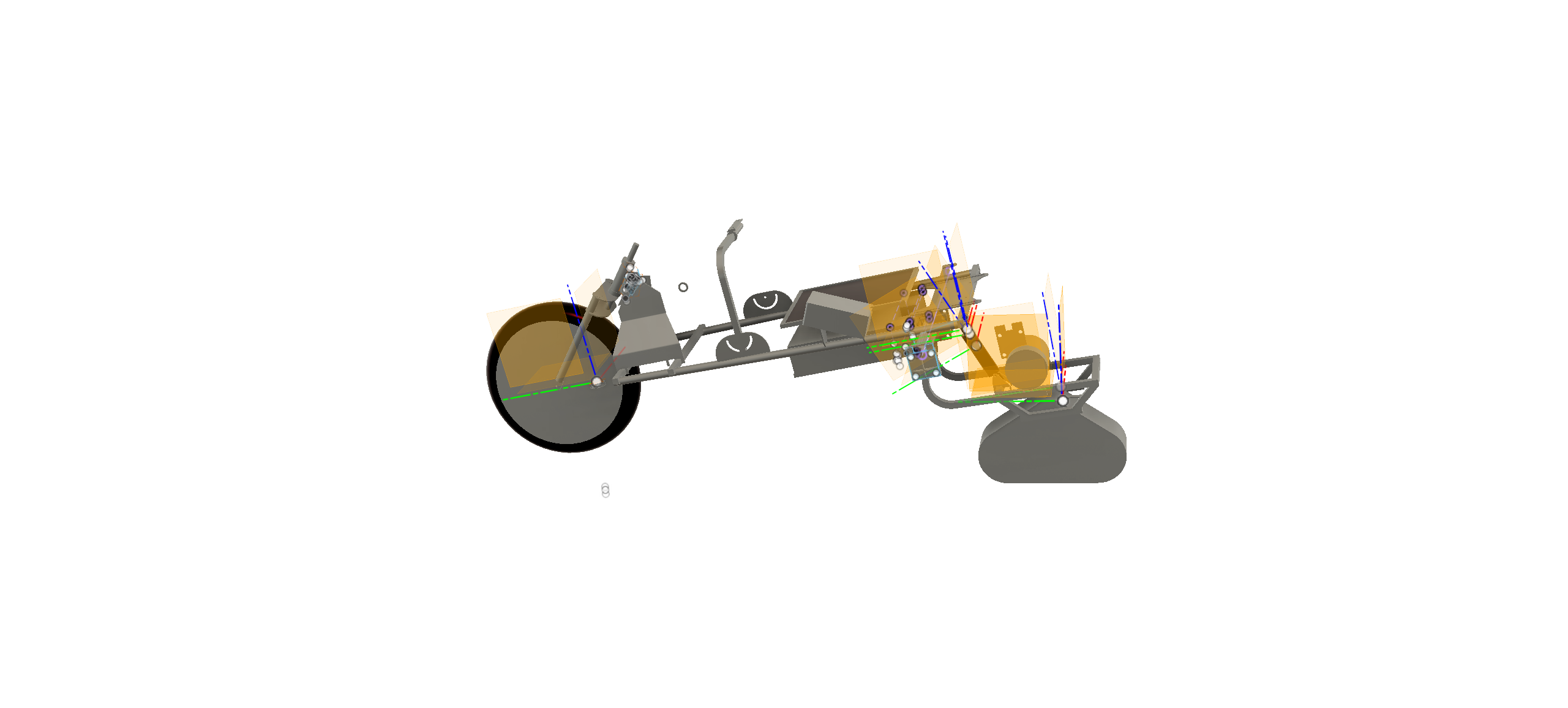

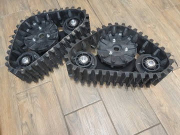

  • Snowblower tracks: Can I drive them?
    Tony Goacher • 03/16/2026 at 19:14 • 0 comments
    Before I could do anything, I needed to know if I could actually get tracks to move under electric power. So off to Aliexpress and I bought a 2kW brushless motor and controller, and some snowblower tracks.
    I created a CAD model of what I thought would be an acceptable mount for the tracks in Fusion360:

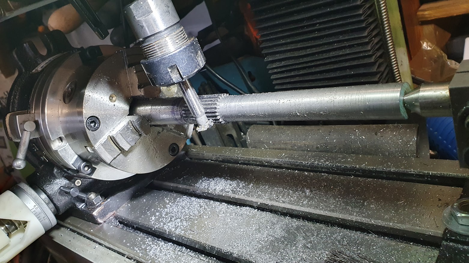

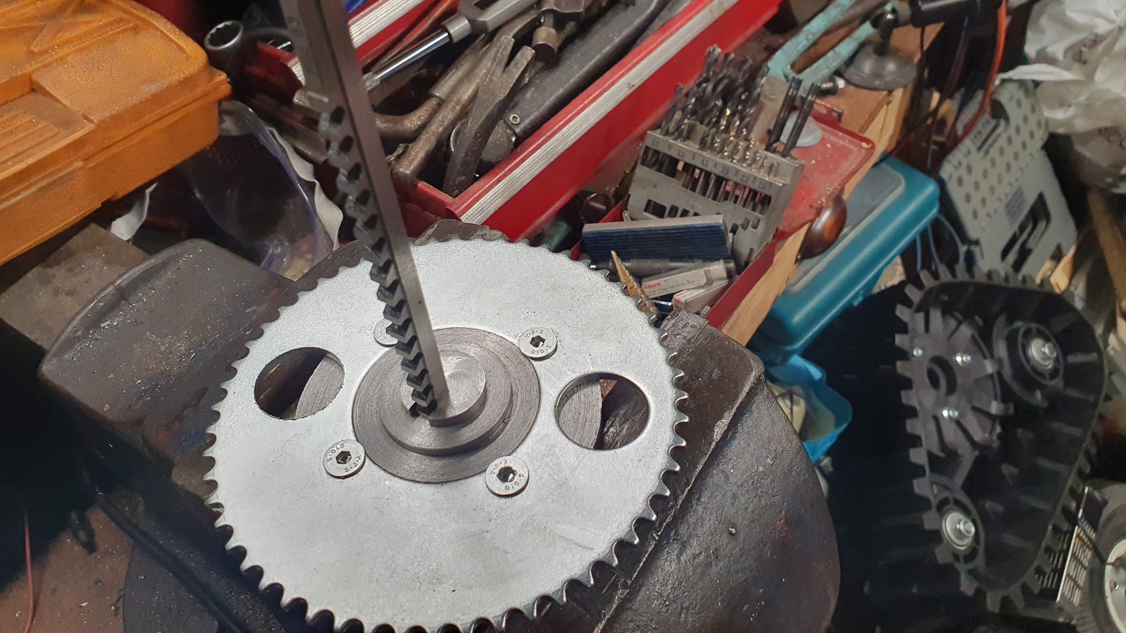

     The tracks require a splined drive shaft and this is a custom build I was going to have to make my own.  With the correct  drive shaft dimensions, I started to consider how I might make the shaft. Without this, the project was dead.
    The only way I could cut splines like this was on the mill. I have a Vertex rotary table and this seemed the best route thoughI had no experience of using it. Having some embedded software experience I created the 'Rotary Table Buddy' which allows me to drive the table electronically..I just tell it how many splines I need. This was a project in itself and is documented here.
    Using the RTB, I first created a test piece in Delrin. This fitted the track splines perfectly. I turned a drive shaft on the lathe, then transferred it to my small mill and proceeded to cut the splines. Each spline took about 15 mins to cut with a triangular profile cutter as I had to reduce the depth of cut as the spline became deeper and wider.
    The drive shaft was to be mounted on 20mm pillow block bearings with a sprocket from a 50cc moped attached to the drive shaft and chain driven. I created an adapter plate to connect the sproce to the shaft using a keyway which I cut with a broaching bar.
    The motor mount frame was created from welded 20mm box section steel. I also created a motor mounting plate with mounting slots that allowed the motor to be adjusted in x and y allowing for sprocket alignment and chain tightening.
    I stole the battery from my son's e-scooter for the first test with everthing in place.
    There's a video blog of the track units here
