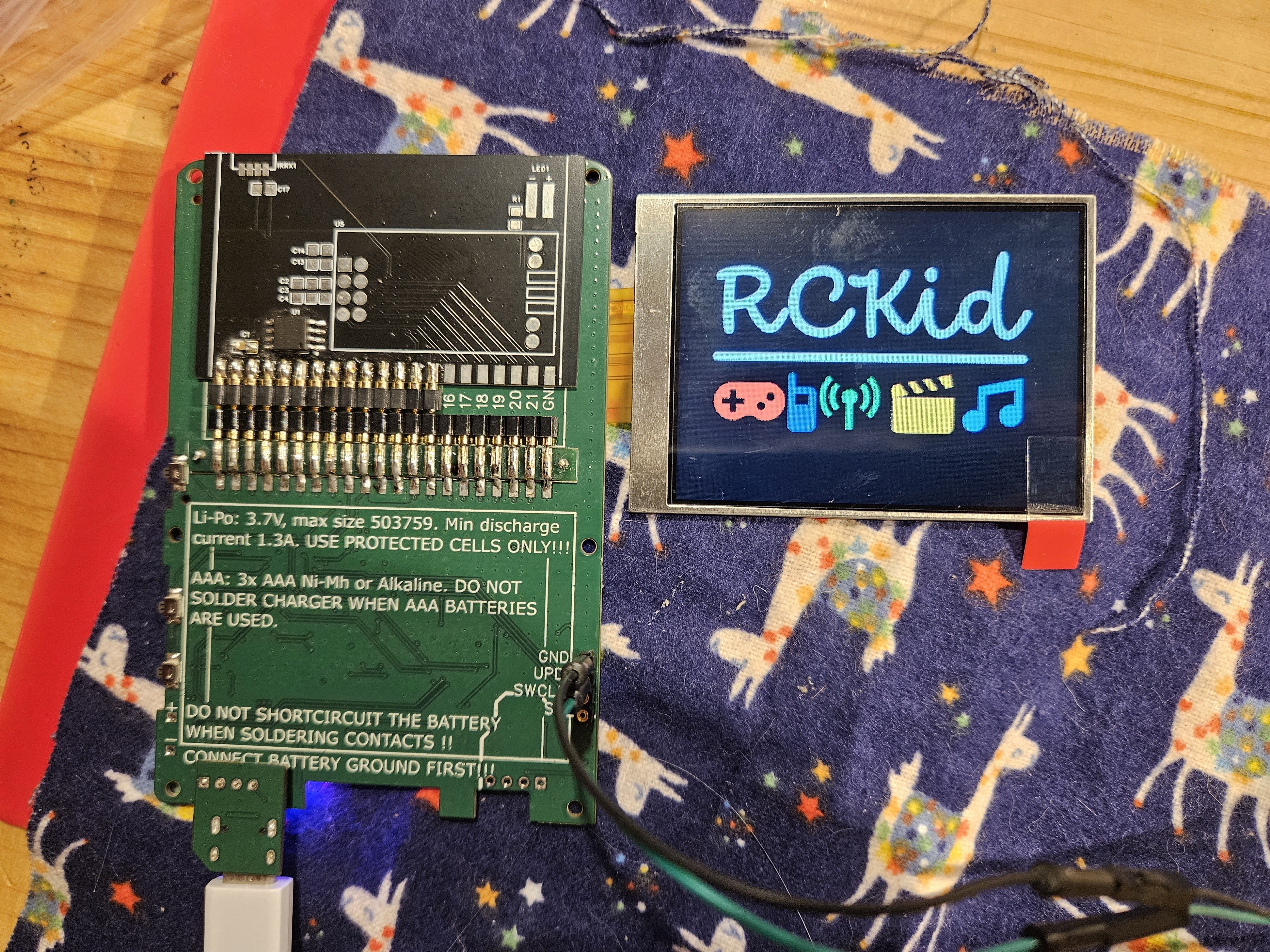

And so cartridges become part of RCKid's identity: the base hardware is simple, the flash for RP2040 and whatever else you might want to have sits in the cartridge and can be swapped in & out. At this time I used the precision machined pins for a really reliable contact and the mkII was born (pictured here with the backside showing the cartridge connector, unpopulated NRF and working display from front):
This is, sadly, still heavily abridged. The mkII went through great many PCB iterations. Mostly to deal with coil whine (unsuccessfully), added RGB lights everywhere, and power management - after watching some youtube videos, I am really scared of LiIon batteries:) Then xmas 2024 came and I had 2 devices ready for my betatesters. This is important, I had exactly two working devices ready. At this point the device did the following:
- 320x240 IPS display connected via 8bit 8080 interface and controlled by PIO on RP2040 (oh-so-satisfying:)
- PWM sound - I essentially copied the sound output of early raspberries with a Schmitt trigger and a filter. I then spent months poking around it with oscilloscope and multimeter trying to figure out why my sound sounds so horribly bad, only to realize that the circuit was right and this is just the nature of 8bit audio. Updated my PWN to 12bit and was happy.
- accelerometer, light sensor, PDM microphone, the cartridge of course:)
- C++ SDK where I implemented a few games (tetris, space invaders, sokoban, pong, 15 puzzle), mp3 player and a few utilities (clock, data sync).
- SD card inside for data storage
One thing that deserves special mention is the absolute ease of use with which the RP2040 can be reflashed from any computer via the UF2 bootloader - absolutely amazing!
