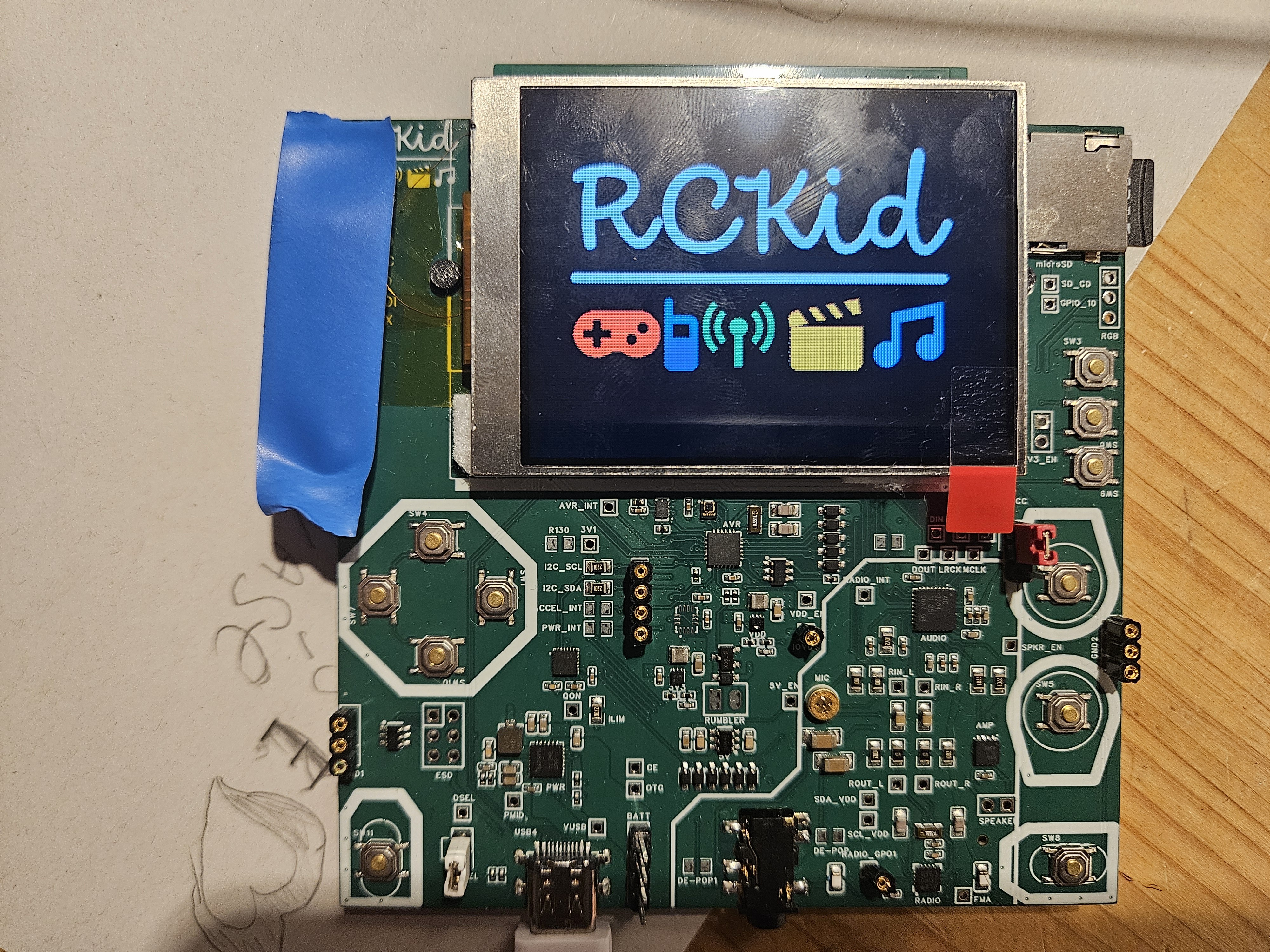

Or really verify semantics & PCB 5 times, do automated assembly once. I have also realized that the three revisions I did in with the mkII version were completely unnecessary if only I had a board that I can solder and desolder things myself with enough test points. I could not do this - the device is small, and all the passives were 0402, way too small for me to handle. So this time, instead of going to the desired form factor first, I have created a 10x10cm development board that had everything I wanted to have in mkIII surrounded by redundant traces, test points and large 0805 components that I knew from mark I with RPi Zero are at the edge of my skill.
Except of *all* the connections, I completely forgot to use RUN pin of the RP2350 in the schematics, hence DRC did not pick it up, and this enormously vital pin (if left unconnected, RP2350 will not boot basically) was left without even a testpoint. Luckily I know a guy who is next level in soldering and he attached a teeny tiny wire to the barely visible QFN pad on the side without bridging the rest. I had my dev board!
Don't trust components with multiple datasheets
At least if you are amateur like me. Turned out that the PMIC chip did not do what I wanted from it (won't regulate VSYS when powered from batt), and the audio codec did not work with the microphone - I went again into overdrive and added not just one microphone, but a second one via the headphone jack as well because why not. 2 microphones sharing same micbias driver, bad idea. Both components came with multiple hudndred+ page datasheets, which I did read, but missed this vital information.
But now the devboard with its many testpoints paid off. I have ordered simple breadboard converters populated with NAU88C22 audio coded that I found, which looked much better - worse audio, but integrated speaker driver as well. Most importantly the datasheet looked simple.

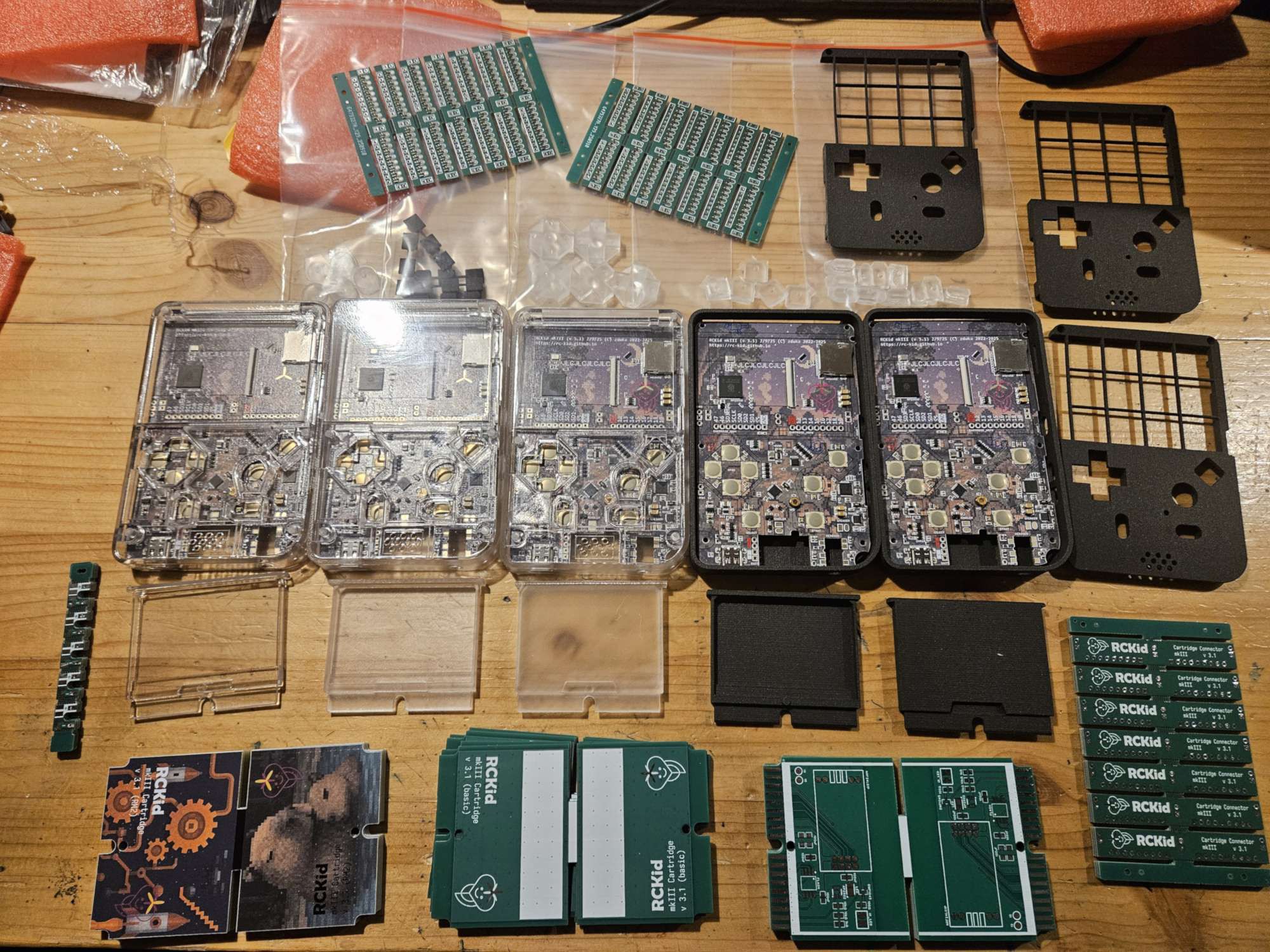

And it worked! This time I had 4 devices for xmas:-) I have also tried 3d printing services, mainly because the Internet said that transparent cases can be made this way and I saw my son being so very excited about a see-through xbox controller he saw in a shop. I have also experimented with full color silkscreens. For normal use they are rather expensive by my standards, but I got some for free, thanks to JLCPCB. I must admit the cases turned out amazingly well:
In the end, I do not think I will keep them for the main case - it is mostly obscured by the components, battery and display and I do not need the ENIG surface they require. On the other hand, the cartridges with full color silk-screen look absolutely amazing - and they can use the ENIG finish for the cartridge connector.
