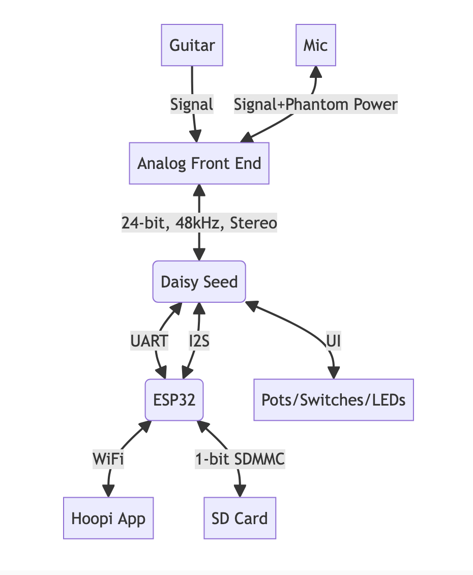

    Our Hoopi Pedal uses a Daisy Seed (STM32H7) for audio DSP and an ESP32 for WiFi connectivity.
    We have the ability to update the audio effects by changing the Daisy's firmware, using over-the-air (OTA) updates.
    Over-the-air updates work by:
    1. Hoopi App checks cloud for updates and downloads firmware
    2. Hoopi App sends firmware to ESP32 via HTTP
    3. ESP32 sends firmware to Daisy via UART
    4. Daisy writes to QSPI flash staging area
    5. Daisy copies from staging to active area and reboots
    The initial implementation took 228 seconds for a 294KB firmware update. Users were waiting nearly 4 minutes, and the "critical window" (where power loss could soft-brick the device) was over 60 seconds.
