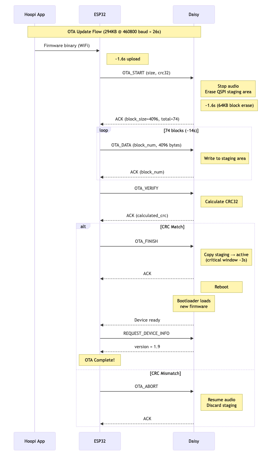

We have the ability to update the audio effects by changing the Daisy's firmware, using over-the-air (OTA) updates.
Over-the-air updates work by:
- Hoopi App checks cloud for updates and downloads firmware
- Hoopi App sends firmware to ESP32 via HTTP
- ESP32 sends firmware to Daisy via UART
- Daisy writes to QSPI flash staging area
- Daisy copies from staging to active area and reboots
The initial implementation took 228 seconds for a 294KB firmware update. Users were waiting nearly 4 minutes, and the "critical window" (where power loss could soft-brick the device) was over 60 seconds.
Note: you might be wondering why we are doing all this inside the application and not in the Daisy's bootloader, which would eliminate the critical section by using staging and active partitions that are swapped using a flag. The Daisy's bootloader is not opensource. We tried implementing our own bootloader but ran into issues with timer/HAL/system initialization that would lock up the app.

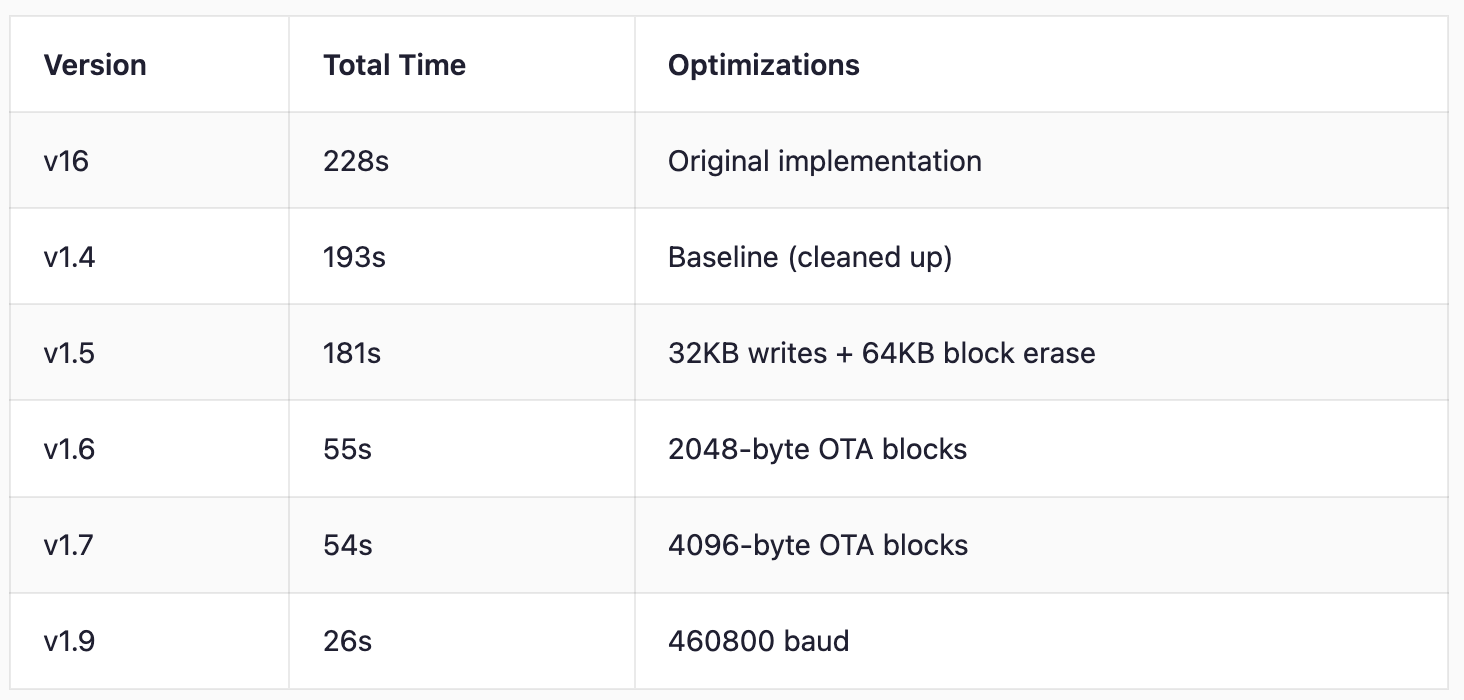

Final Results
Timing Breakdown (v1.9)
Phase Duration ──────────────────────────────────── WiFi upload ~1.6s QSPI erase ~1.6s UART transfer (74 blocks) ~14s CRC verification ~0.1s Copy to active (critical) ~2.8s Reboot + confirm ~4s ──────────────────────────────────── Total ~26s

Key Takeaways
- Build a test harness first - Creating isolated QSPI benchmarks with
StartLog(true)gave us instant feedback without running full OTA cycles. This turned a 4-minute test loop into seconds. - Batch operations - Larger chunks reduce per-operation overhead dramatically (1,177 packets → 74 packets)
- Test incrementally - Each optimization was tested independently before combining, making it easy to isolate regressions
The final result: 8.8x faster updates with a 20x smaller critical window.
Final sequence chart
