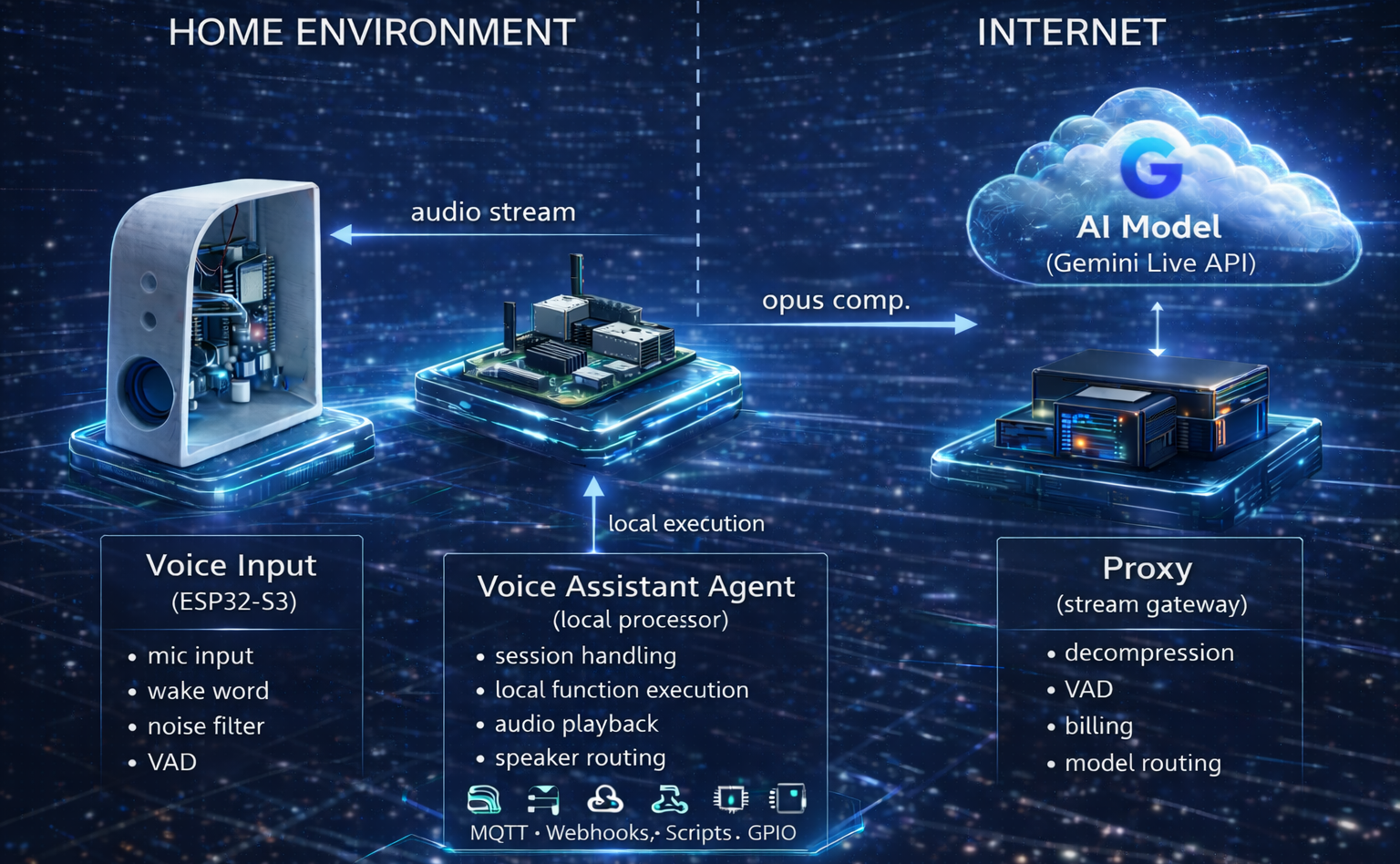

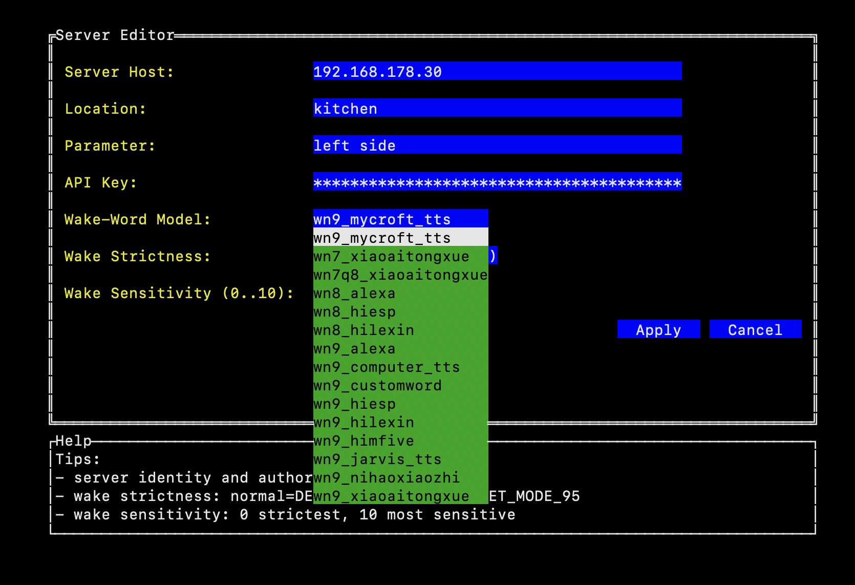

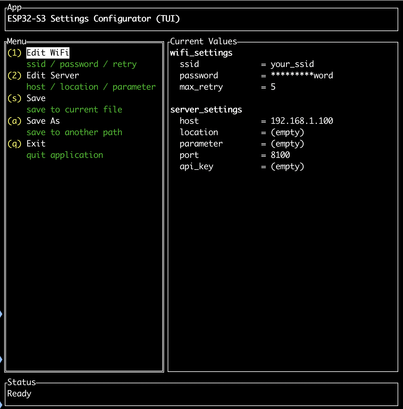

ESP32-S3 voice frontend that connects to live AI m Gallery
