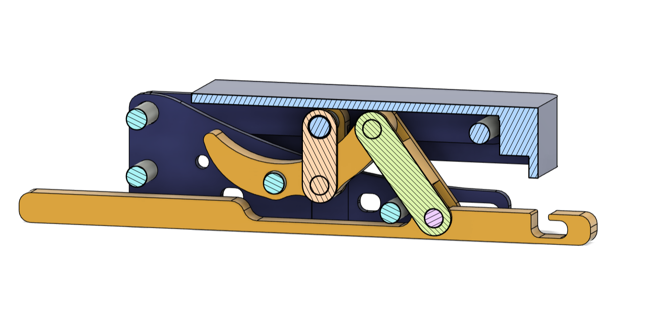

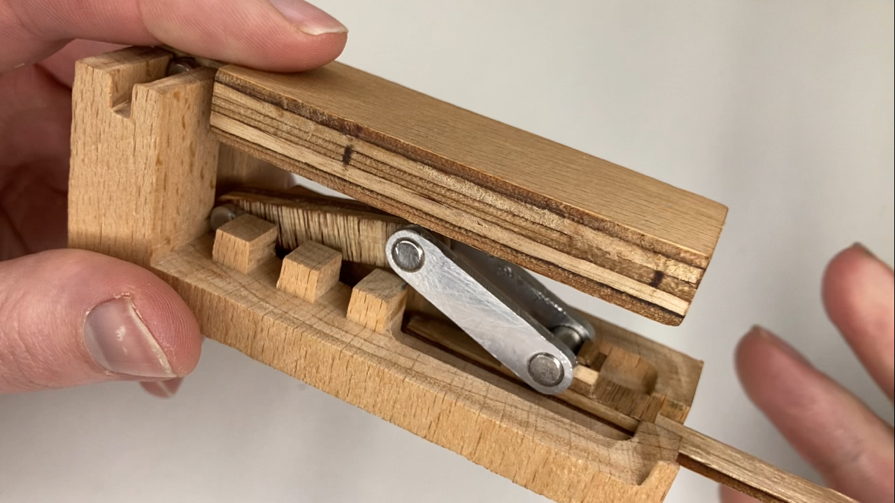

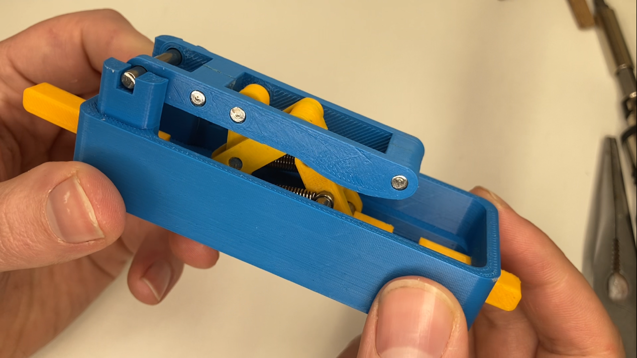

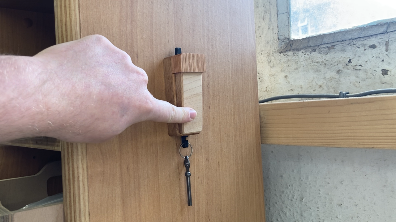

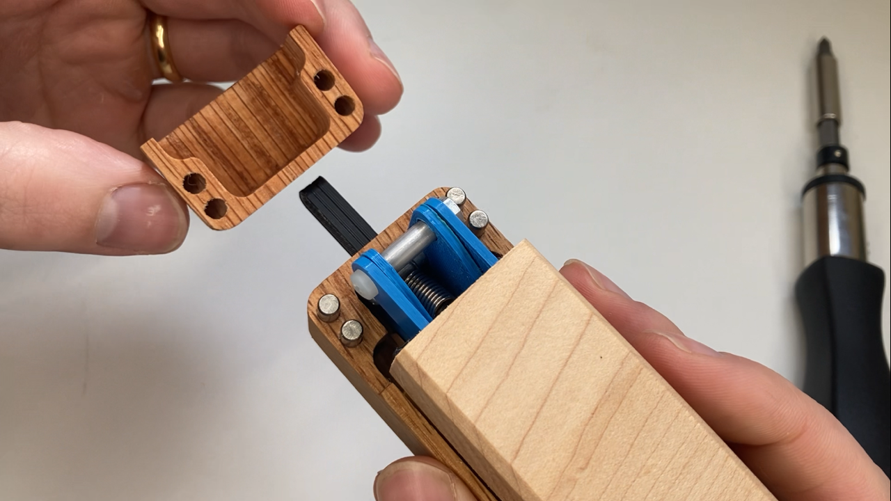

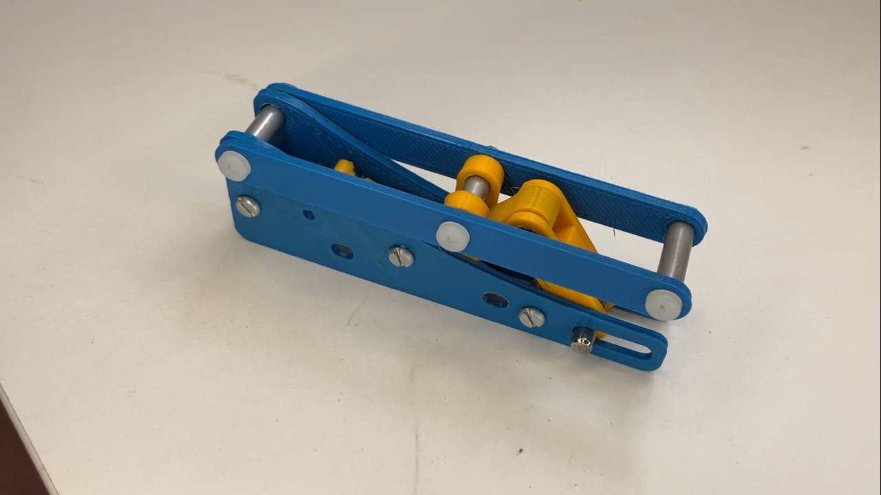

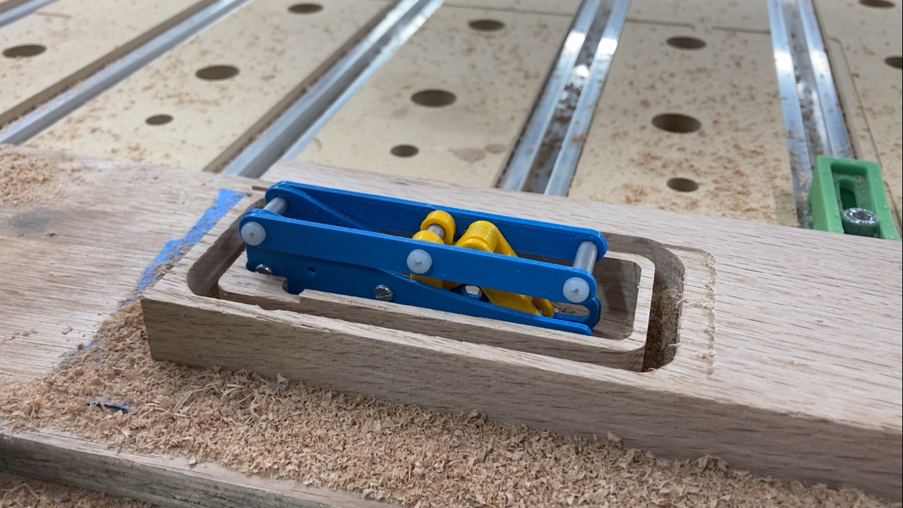

Watch the video for 8 minutes of mechnical fun!
Project Write-Up
My first step was to prototype the mechanism, which is where this rough wooden version came from.
Although it looked good, I needed something much more refined as the wooden version just proved the concept.
After many hours of CAD and simulation, my next iteration looked like this:
This really brought the project to life but I realised I had made a crucial mistake by trying to design both the casing, and the mechanism at the same time. At that point, I designed a standalone mechanism that could be assembled completely separately from the base.
With that successfully designed and 3D printed, I went on to CNC machine a base and cap. It turned out rather nicely!
Now we have a working single mechanism, in my next video, I will scale this up to a full piano octave!
Inventive Robin
Greg Zumwalt
Alessio Fabrizio
ProgressTH
Kudos on this, I'm a fan. I very much want this in my home. Should I start to tinker with the implementation based on approximations or do you share specs?
