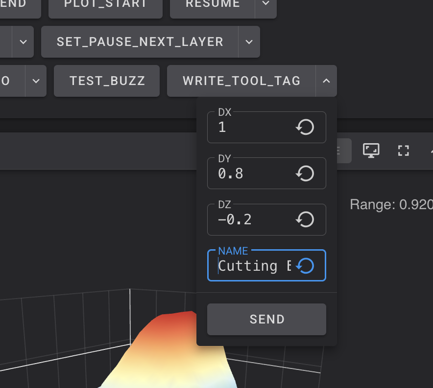

4. Writing/updating tool parameters
The rfid script is a typer cli, so we can simply call it from a Gcode macro to update tool info. The macro auto homes to correct location where the tag can be read, and echoes the written data back to the user.
I discovered a neat trick in klipper here. If we use dot notation (params.dx) to access the parameter (instead of index notation, eg. params['dx']), fluidd would auto generate a mini UI to input the values:
It's quite handy!
