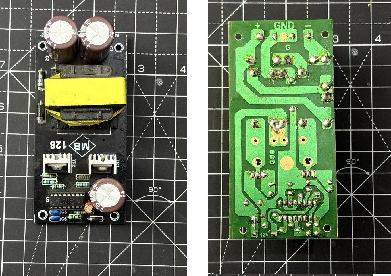

That's exactly what this module does. It's a pre-built push-pull DC-DC converter board that takes 12V DC in and outputs 24-0-24V (that's +24V and -24V with a centre-tap ground) at over 5A. I picked one up for an amplifier project, and I thought it was worth breaking down how it actually works. The controller IC running the show is the KA3525A, a classic SMPS controller that has been around for decades. I will show here how the push-pull topology works, and how to wire it up safely. For real-world power-on and load testing.

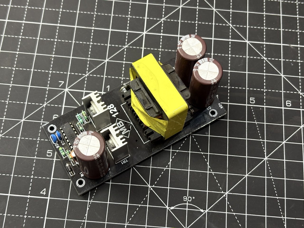

What Is This Module?
This is a compact PCB module designed for converting a single 12V DC input into a dual-rail +/-24V DC output. The target application is audio amplifiers and car audio systems. The board uses a push-pull converter topology built around the KA3525A SMPS controller IC and two IRFZ44N N-channel power MOSFETs. There's a centre-tapped transformer wound on a core mounted directly to the PCB, rectifier diodes on the secondary side, and electrolytic filter caps for the DC output.

- Controller IC: KA3525A (Fairchild Semiconductor, 16-DIP)
- Power switches: 2x IRFZ44N N-channel MOSFETs
- Topology: Push-pull DC-DC converter

Each output of the KA3525A drives the gate of an IRFZ44N N-channel MOSFET. These are rated for 49A drain current, 55V drain-source voltage, and just 17.5 milliohms of RDS(on). Massive overkill for this application. When OUTPUT A goes high, MOSFET A turns on and pulls one end of the transformer primary winding to ground. When OUTPUT B goes high, MOSFET B pulls the other end to ground. The centre-tap of the primary is connected to the 12V input....
