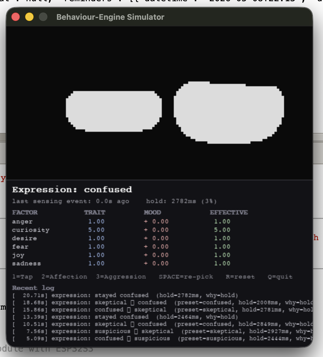

Touch inputs drive the behavioral engine which models personality across six factors: Curiosity, Fear, Joy, Anger, Sadness, Desire. Each interaction affects these factors over time, making the robot's responses feel shaped by its history with you rather than pre-scripted. Every unit develops subtly differently.
Two months in. Hardware foundation complete. Behavioral engine being designed now. One month from a first finished version.

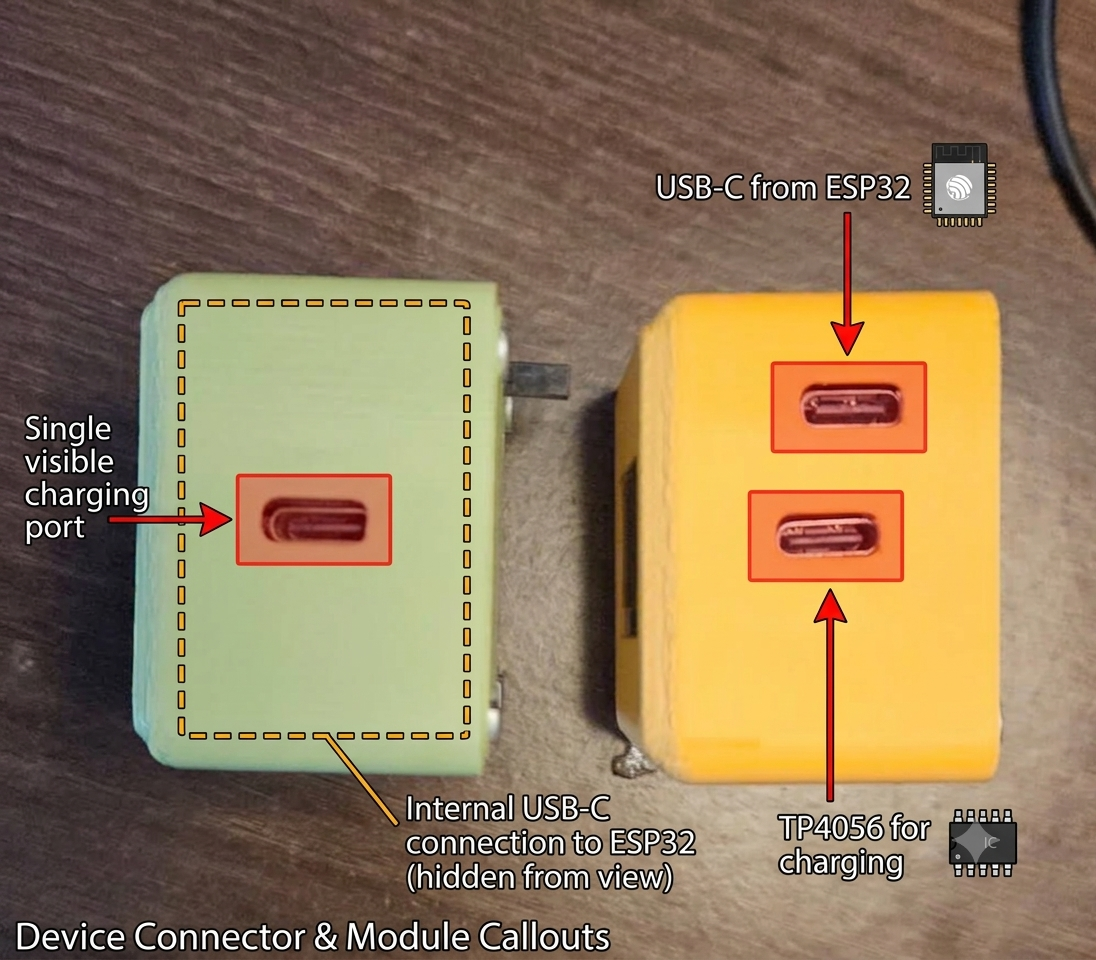

    In the current build I have used external TP4056 module and exposed Type-C for charging the battery, but given that esp32-s3 supermini already has that capability with some caveats. Exposing USB port of the board would give the options to tinkerer like me. This would also help me reduce the size of build slightly which I want to do so badly.
    > Giving two type-c port is unnecessary and would only confuse people, hence the decision to make it hidden and OTA would allow software updates anyway was my first thought.

    • Battery being used in the earlier build even though cheap, showed that it was not even 40% of what it was rated. This is tested during building of battery monitoring system
    • Upgrade OLED from 0.96 to 1.3 inch as I feel that would make it look much better
    • Make it thinner, right now it is fat.

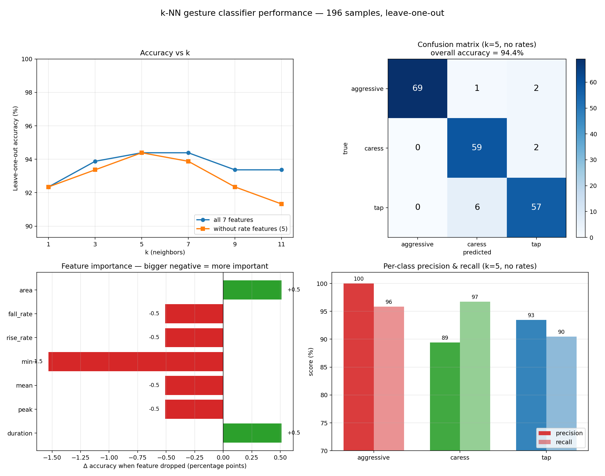

    When I first built the touch classifier, I trained the kNN on data recorded from the very first device. It worked well on that one unit.
    Then I started building the others, in different housings, and the model fell apart. It took me a while to see why. The touch area is copper tape, and on every build the tape ends up sitting a little differently. Slightly different placement, slightly different contact, and the capacitance signal shifts just enough that the data from the first device doesn't hold for the next one.
    I can't sit with every unit, hook it to a laptop, and recollect and retrain by hand. That doesn't scale, and it isn't how I wanted this to work anyway.
    So the last thing I built for this version is on-device touch tuning. You record a few of your own sample touches right on the device, and the kNN improves from them. No laptop, no reflashing. Each MiniSoul calibrates to its own hardware, and to the hand that holds it.

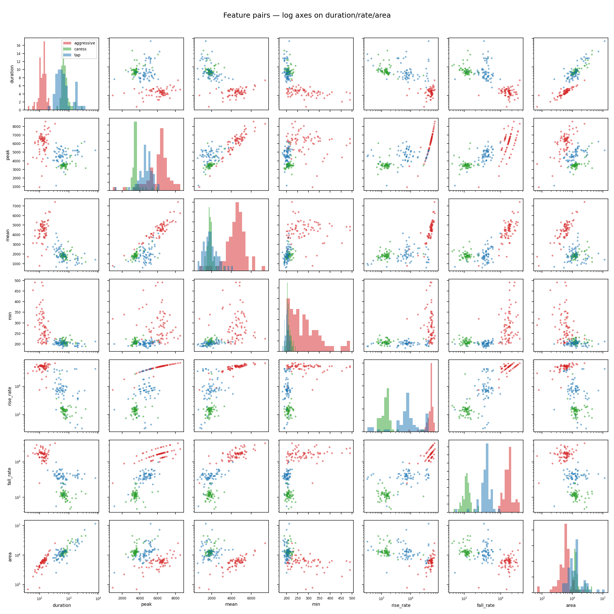

  • Sensing classifier with single input
    Sritabh Priyadarshi • 05/12/2026 at 17:56 • 0 comments
    Aggressive tapping, a gentle caress, a deliberate tap. These are emotionally distinct interactions and I wanted the robot to respond to them differently.
    The question was: how much hardware does that actually require?
    I started with the simplest possible input, a single capacitive touch sensor. One sensing point. One time series of capacitance values.
    Then I extracted basic features from each touch event: duration, peak value, mean, minimum, rise rate, fall rate, and area under the curve.
    What I didn't expect was this
    The three touch classes aggressive, caress, tap, separate cleanly in feature space. Especially on rise_rate and fall_rate (log scale). The information was always encoded in the shape of the signal. How fast the capacitance climbs. How fast it falls. How long it lingers.
    A caress is slow in both directions. An aggressive touch hits hard and releases sharply. A tap is brief and decisive.

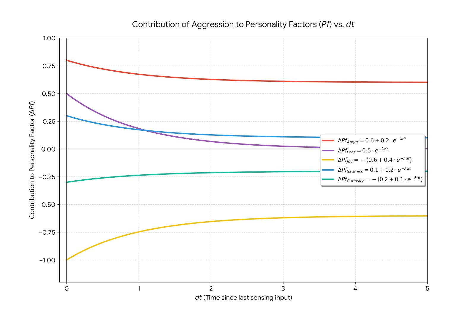

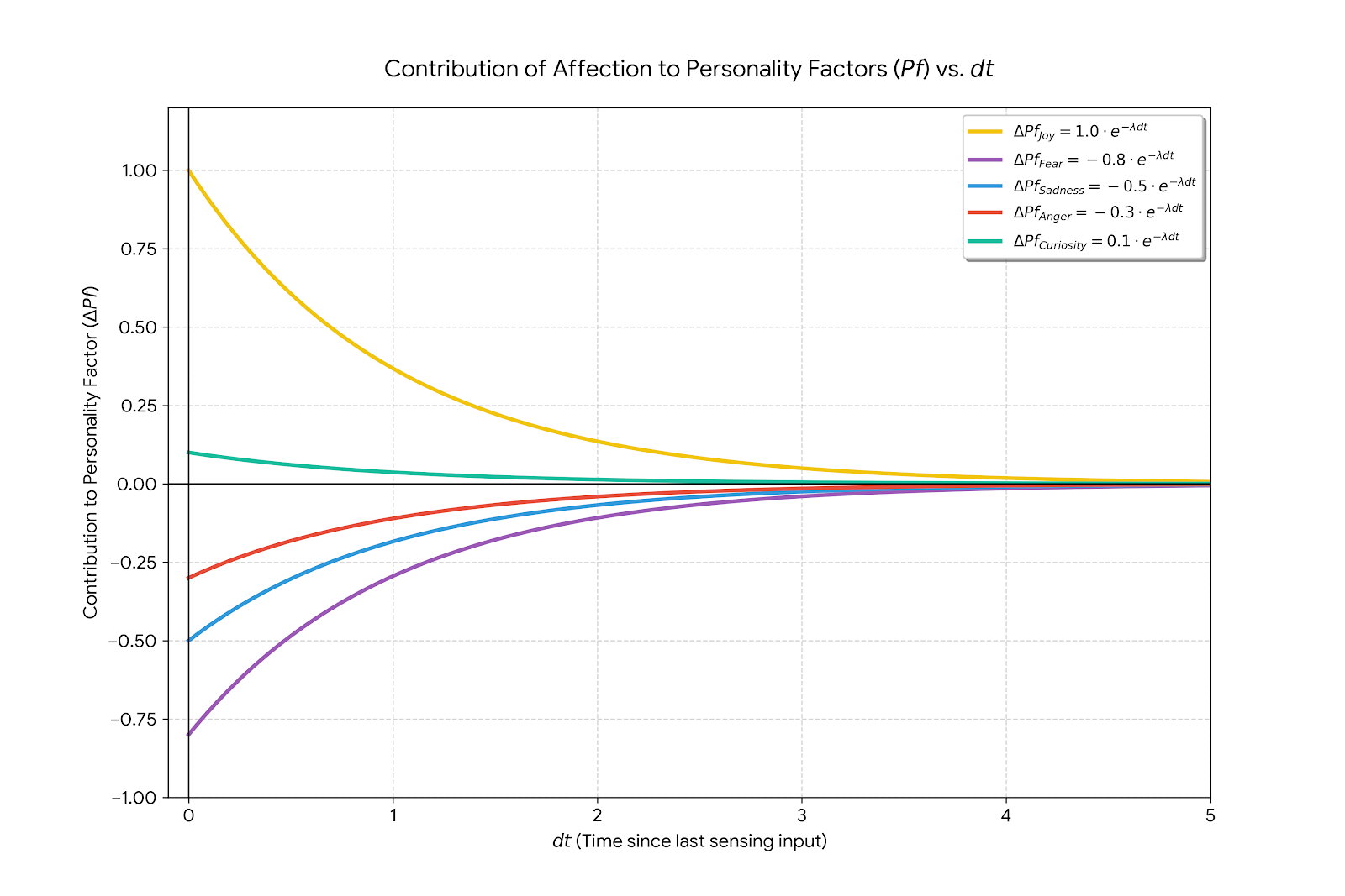

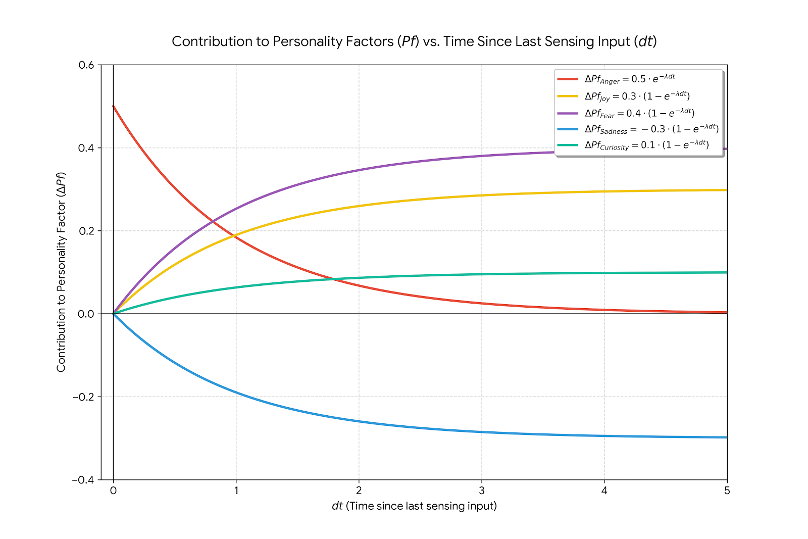

  • Behavioural Engine Algo design
    Sritabh Priyadarshi • 05/09/2026 at 07:01 • 0 comments
    Defined how the behaviour should affect the personality factors and how the mood would be changed
    Interaction definition affecting personality factors
    For tap
    For Affection
    For Aggression
    Next thing to work on is classifying interaction using KNN along with some refactoring.
