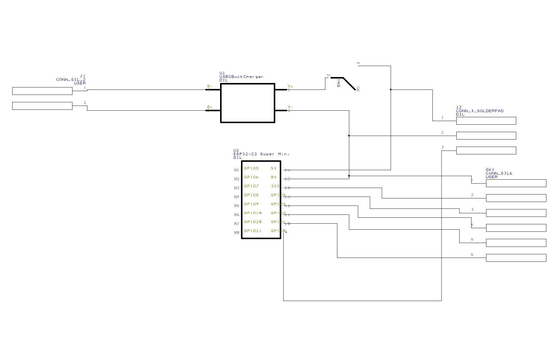

Our design is simple. A wearable badge that sychronises lighting effects. I used an ESP32 C3 combined with a LiPo BMS and a WS2812 LED ring. Plus of course a 3D printed badge mount.

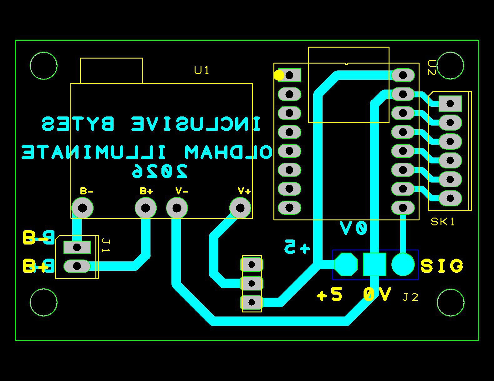

I designed a schematic and PCB in Design Spark

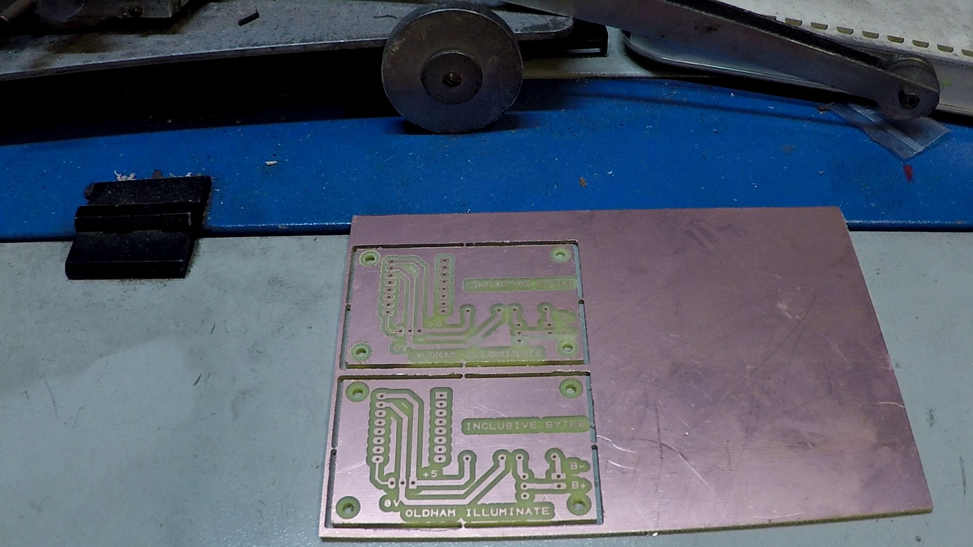

and CNC routed the PCB
The intention was to make about 10 of these, but I knocked a couple out initially so I could get the software working.

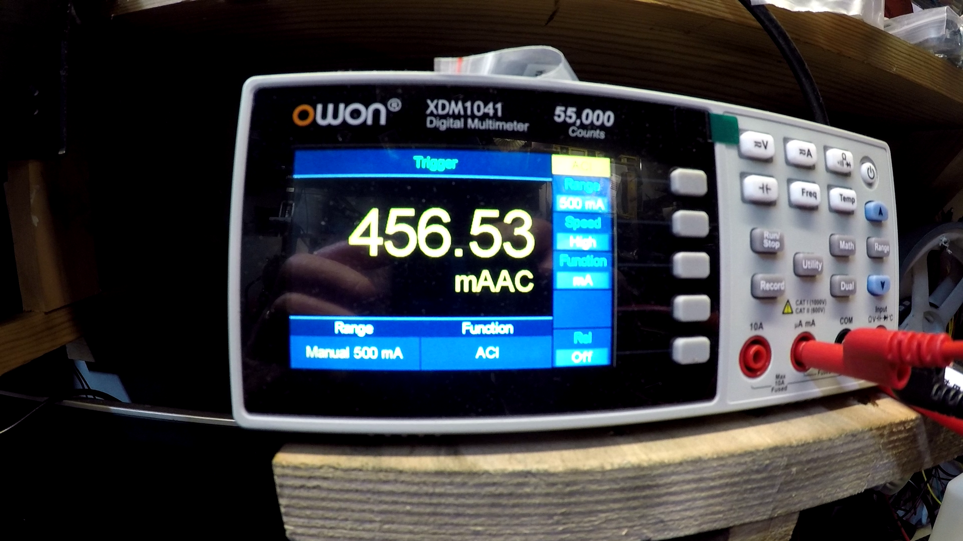

A quick check of the hardware showed the current varying between 100-500mA. With a 1000mAh lipo battery that's about 2 hours worst case, which is fine for this application.

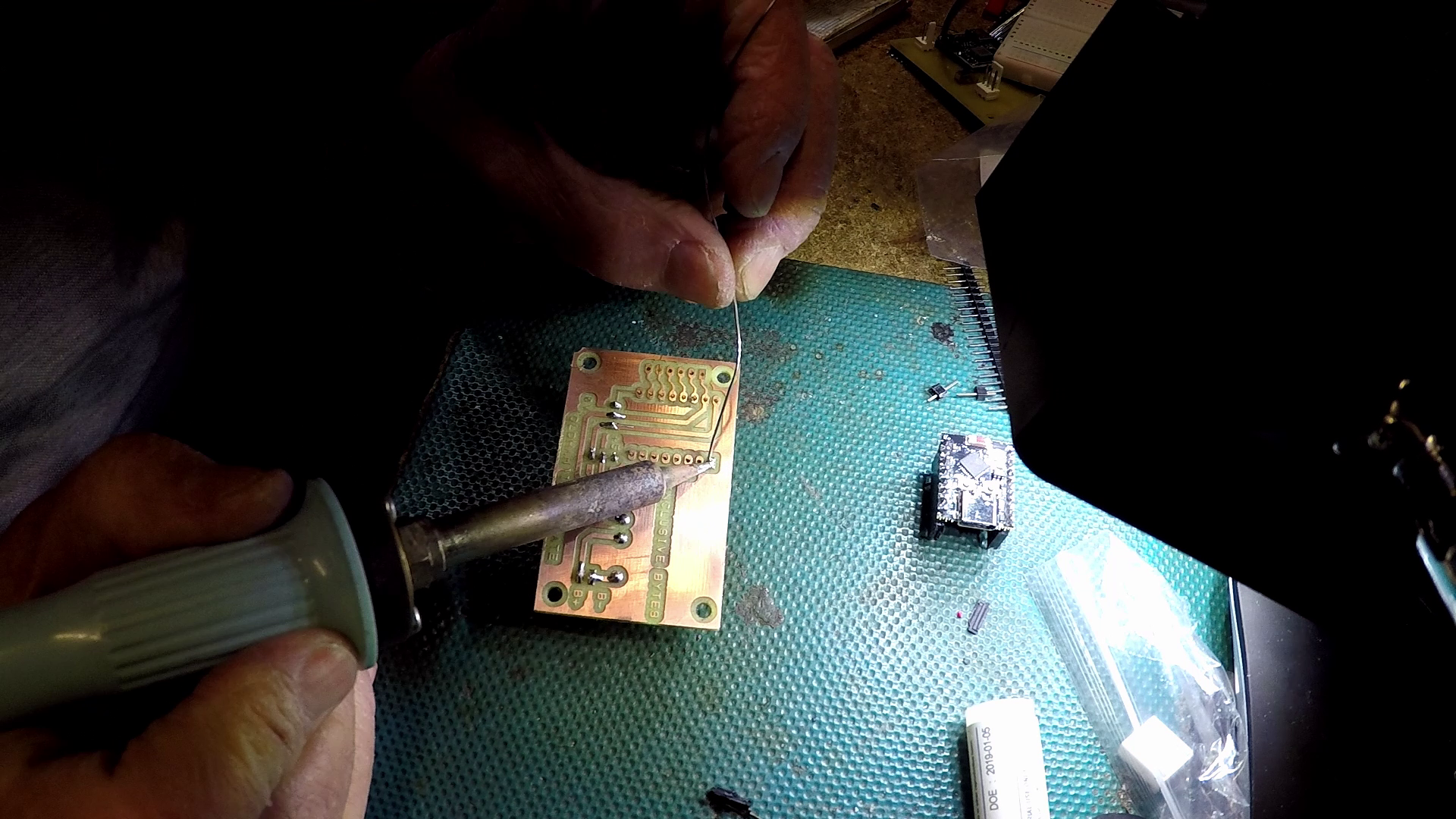

Once happy with the design, we got some of the young people at Inclusive Bytes to get some soldering practice in to make the remaining badges.

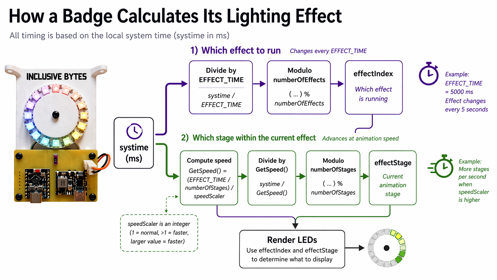

All badges run the same software, and as time become synched across the group, the badges use their local time to calculate the effect and the effect state.
Time is further quantised to 50ms to further reduce timing errors.
effectTimeSlot = 5000  // Each effect runs for 5s
effectTime =  ( millis() - (millis() % 50 ))
currentEffect = (effectTime / effectTimeSlot)  % NumberOfEffects
effectStage =  effectTime % numberOfStages // There is a time prescaler in here too, omitted for clarity

    Rendering  uses 50ms quantisation of the effet time to further absorb any timing differences:
    MILLIS_PER_EFFECT = 5000 // 5 seconds for each effect
    effectTime = t - (t % 50)
    effectId = (effectTime / MILLIS_PER_EFFECT)  % numEffects
    effectStage = t % numEffectStages
    So as soon as two badges agree on time, they produce identical output.
    There’s no history to repair, no frames to catch up — just the current tick.
