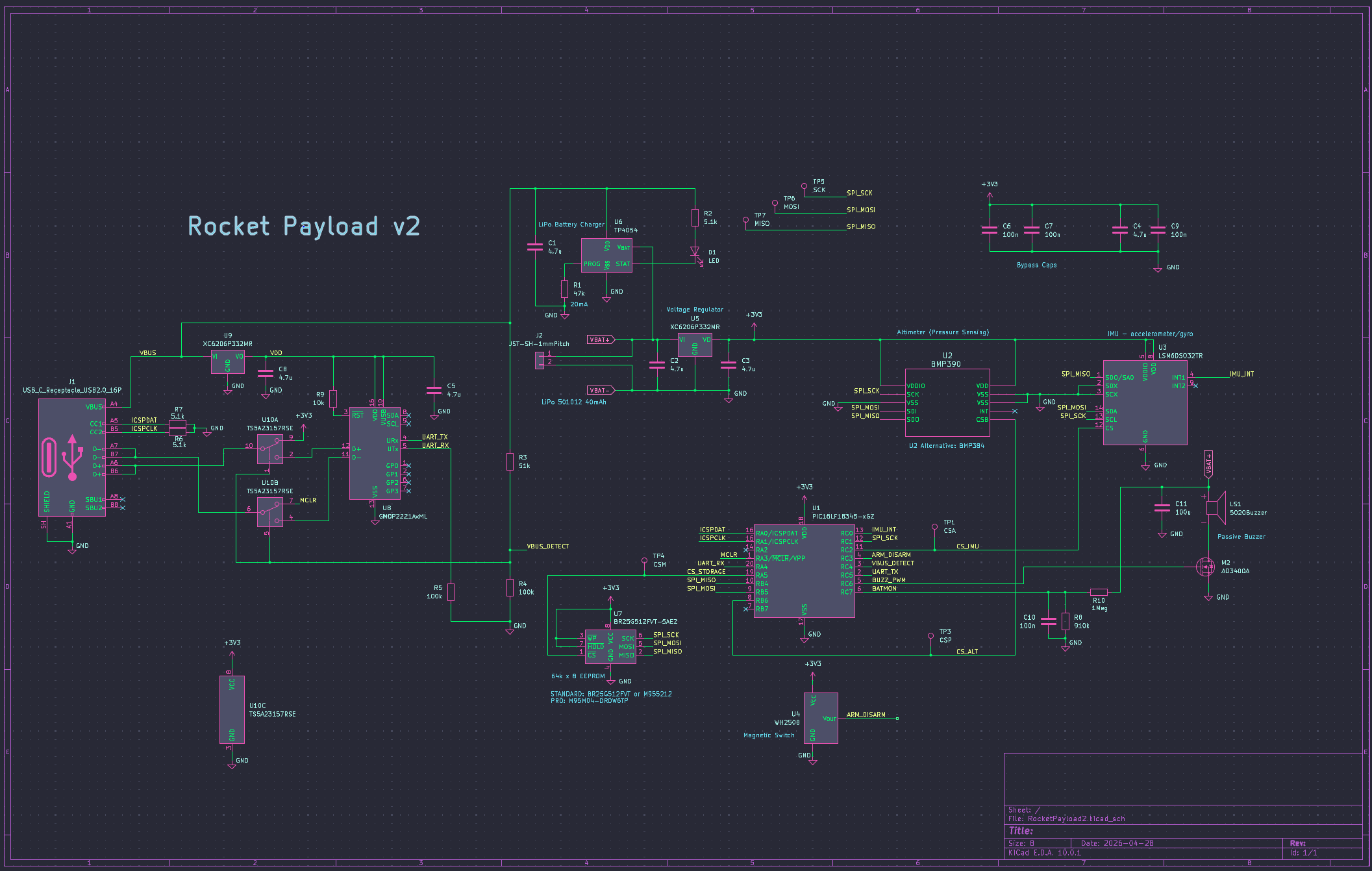

Latest Schematic (v2) [as of 2026-07-06]:
It is surprisingly simple, given the complexity of operation. Claude and I chose a PIC16LF18345 for the micro-controller. I have a PICKit4 programmer that keeps me in the Microchip camp for now. [2026-11-07: I just found...

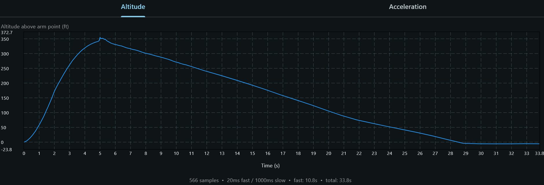

    Bud Bennett • 06/20/2026 at 16:57 • 0 comments
    I bought a cheap Estes launch kit for $22. It included the launch pad, ignition box and a simple kit called the Tazer. The Tazer is 17 inches (43.2cm) long with a 1 inch (25mm) diameter. I also purchased a few rocket motors (B-4-4 and B-6-4) and wadding. After building the rocket I drilled 3 1/16" (1.5mm) holes to vent the body were the payload would reside. There is no payload section so I folded the chute, attached the payload to the cleat at the bottom of the nose cone, and shoved the payload into the space between the cone and the chute. Launch day winds were light -- 2-5mph -- so I launched it true vertical. I pushed the button on the ignition box and lost sight of it immediately, wondering where it was until I heard the chute deploy and caught site of the parachute. It drifted about 500 feet from the launch site. I disarmed it upon recovery. Here's the page of the app showing the plot of altitude and the flight stats:
    I expected that big discontinuity when the chute deployed (a bit early), but the pressure sensor recovered very quickly. Quickly enough that you can easily interpolate from the missing data. I also expected there to be a large step function when the Payload was ejected into ambient air. That didn't happen, which leads me to believe that the three small vent holes are adequate to allow reasonable tracking of pressure or altitude. Note also that there is a bit of a jog at burnout -- I did not expect that to be visible in the altitude data.
    That flat spot at the transition from fast sampling to slow sampling looks like a bug. I think the Payload substituted the last fast sample data for the first slow sample data point. I'll take that issue up with Claude.

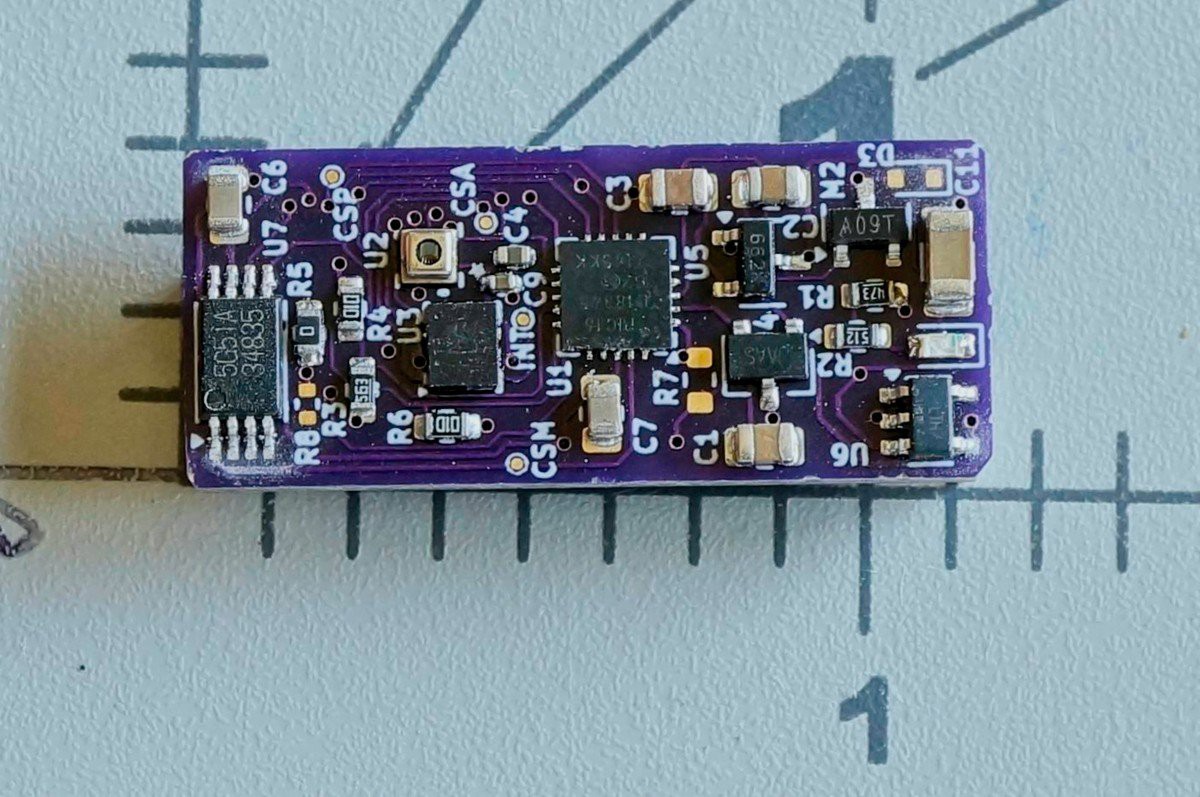

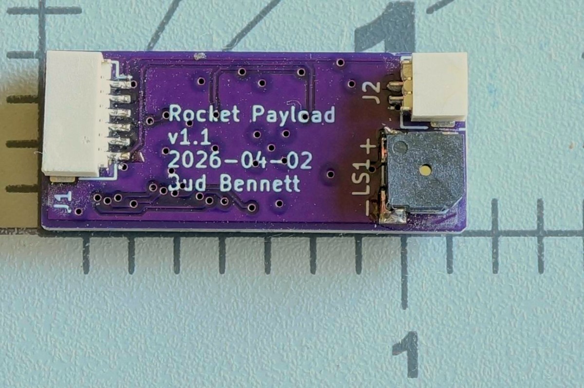

    v1.1 Prototypes:

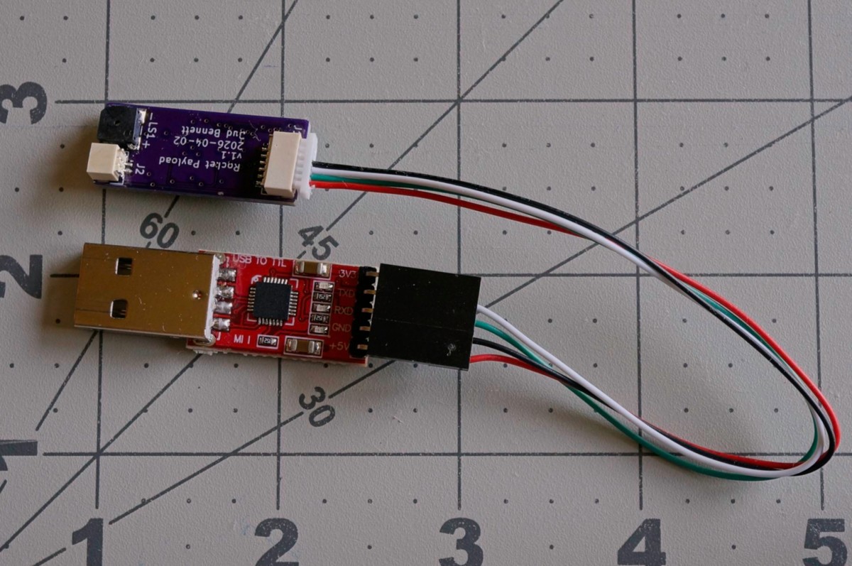

    I built three v1.1 prototypes. These are roughly 12.5mm x 30mm (2 layer PCB) and weigh 2.0g. Pretty small and light for what they do. That BMP384 pressure sensor (the metal can with the hole in the top) is only 2mm x 2mm, with 10 pads underneath. It is nearly impossible to solder -- I must create solder bumps on both the BMP384 and the PCB, then slather gooey solder flux over the PCB pads to keep the part in place while I heat it with the hot air gun. That part, and the LSM6DSO32, are the first parts soldered onto the PCB. I then test the connection by verifying the input protection diodes exist between GND and the pads before moving on to soldering the rest of the components. This method is tried and true for me, but is time consuming.
    At first, I thought that it would be simpler/easier to purchase a CP2102 USB-to-UART adapter board to interface from the computer/phone. Adding the CP2102N component was expensive, and big, so I outboarded it. A CP2102 breakout board is relatively cheap and available (<$7 at Amazon.) I regretted this decision the moment I saw a potential user attempt to get the Win11 drivers installed on his laptop. The CP2102 adapter was listed as "Other" in the device list and we couldn't get it properly located as a PORT.
    The other issue is that it required a custom harness that wasn't exactly pretty:
