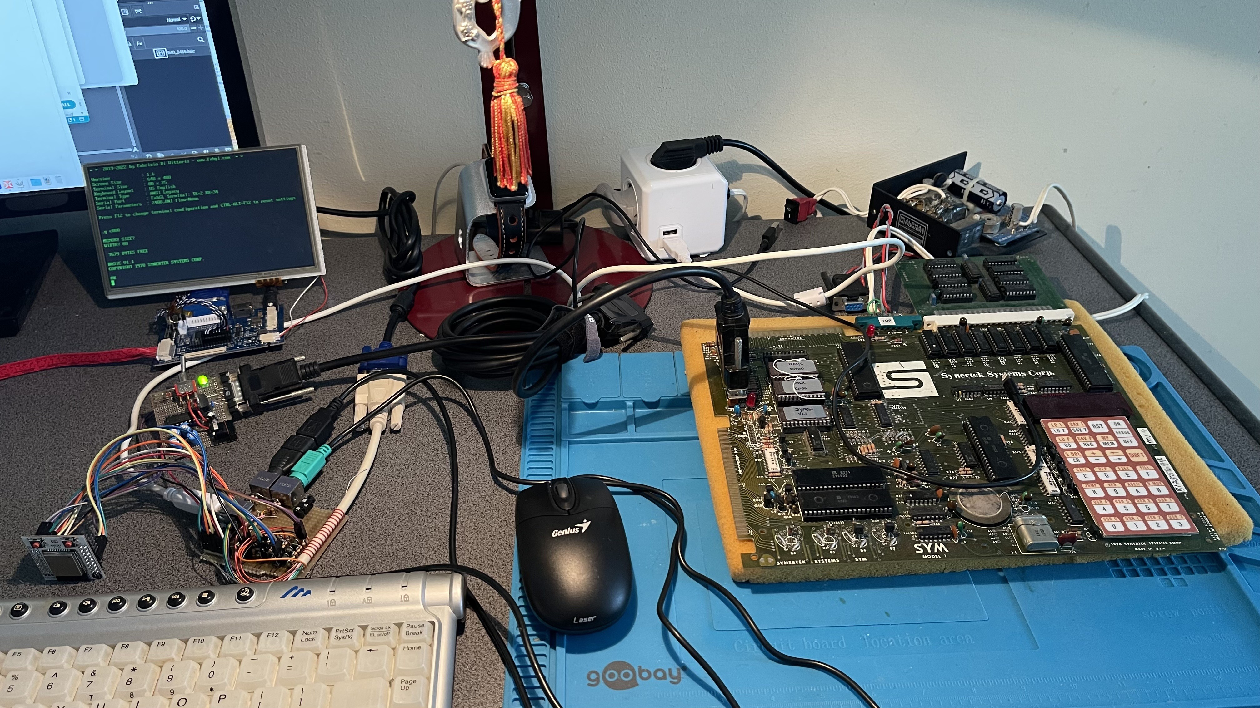

Some time ago I was working on a Minato 1866 Eprom Programmer, and a SYM-1 single-board computer. Both can only communicate with the operator through a keypad and 6 digits of LED displays.
Or... RS-232 V24.
I found myself having either one laptop connected to it and annoyingly having to switch back and forth between a terminal emulator and the web browser, or two laptops where one was talking to the device and the other showing docs. Not optimal. So I started thinking if there was something better.
After looking around, I found out about the uTerm2-S and FabGL. That looked exactly what I was looking for, and I almost bought a uTerm2-S board.

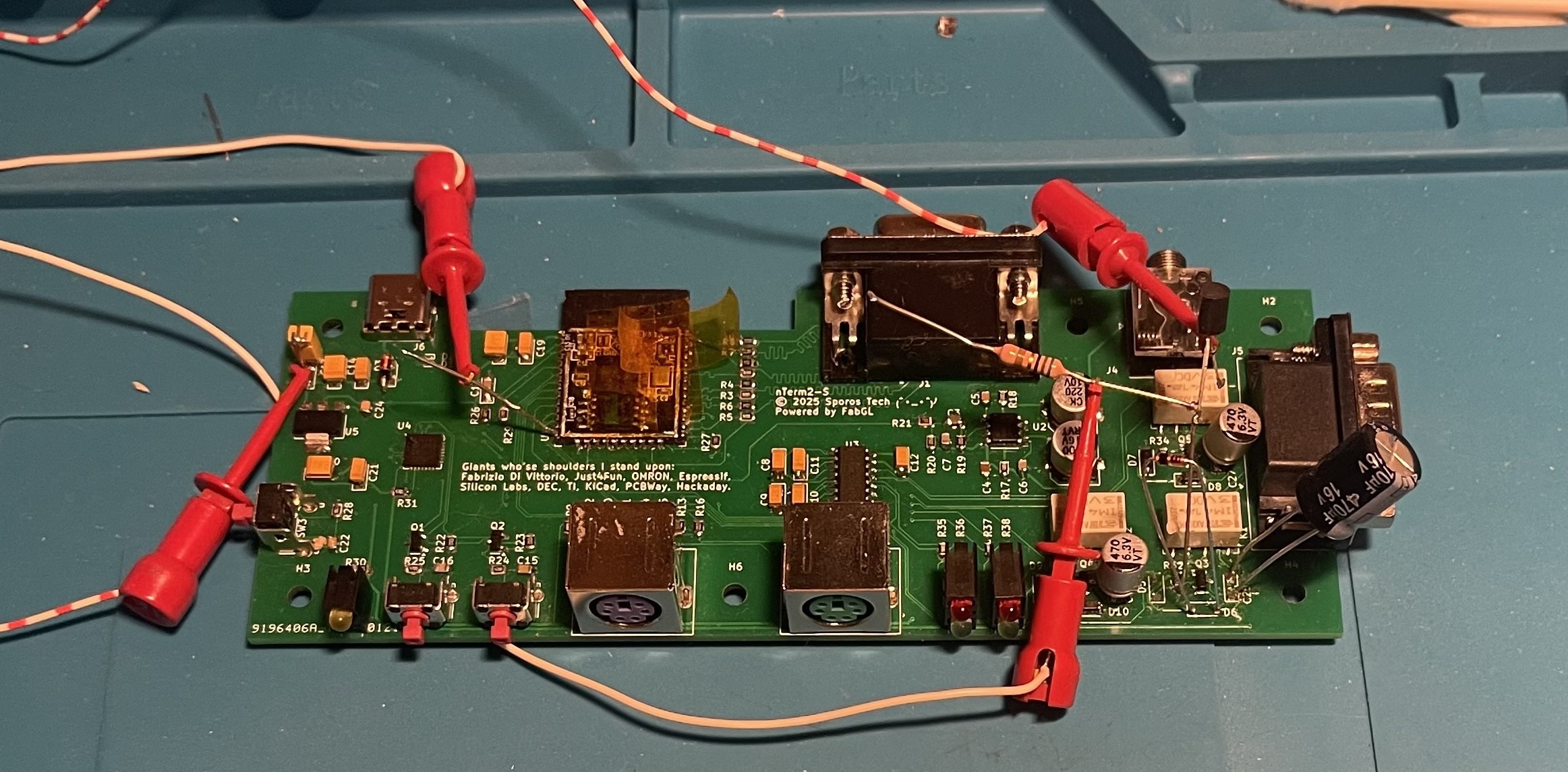

    With my requirements and stretch goals set out, I fired up Kicad and started to pull in components until I had basically more or less replicated a mix between the FabGL Serial Terminal and the uTerm2-S. However, I wanted to have a way of switching the serial connection between normal and null-modem.
    I found that real crossbar ICs that could handle 12V were extremely expensive. I considered the venerable 4066 analog switch, and other analog switches. But then stumbled on a post that was talking about a circuit controlling a bistable relay with only one GPIO port. That was interesting enough for me to try out, and after buying some relays and prototyping, I got it working quite stable within parameters. The relays were surprisingly cheap, and I was up for experimenting. So I chose to use relays.
    But relays use a lot of current when they are being powered. So I chose to use latching relays. But that had yet another problem. The small ones are single-coil latching relays and are set one way by applying a pules with a specific polarity, while they are set the other way by applying a similar pulse, but with reverse polarity. That requires two GPIO pins, and I did not have enough.
    Another option would be to use a circuit built around two comparators, and use one GPIO pin in tristate mode.
    But then I stumbled upon a really simple circuit, once patented by Omron, that could do the same with one GPIO pin, but not using tristate mode, built around a transistor, two diodes, a resistor and a large capacitor. It can be seen here on page 12, section 2.2.24.
    I started experimenting with the circuit on the breadboard, and it worked fine. I measured currents, and it all seemed within specs of the ESP32's GPIO port, so I went for it.
    I designed the PCB fully, and sent it off to JLCPCB for the ridiculously low price of €11.01.
    After a few days the boards arrived, and I started soldering! Everything went smooth, except for soldering that pesky CP2102 . USB worked, I could program the firmware, got VGA out, keyboard and mouse were working, and after programming some lines to switch the relays... No clicks, no switching.
    So that led to taking out the oscilloscope and trying to find out what was the problem. That is described in the Github entry of the nTerm2-S, and I would refer you to there if it interests you.
    After a while, my beautiful board turned into a Frankenstein. Not helped by the fact that I only had ESP32s that were soldered onto a carrier board, decided to desolder one, ripped of an important pad, and had to perform microsurgery to solder a wire onto it :D).
    In any case, a few more redesign steps had to be taken, and at some point I reached v0.6.

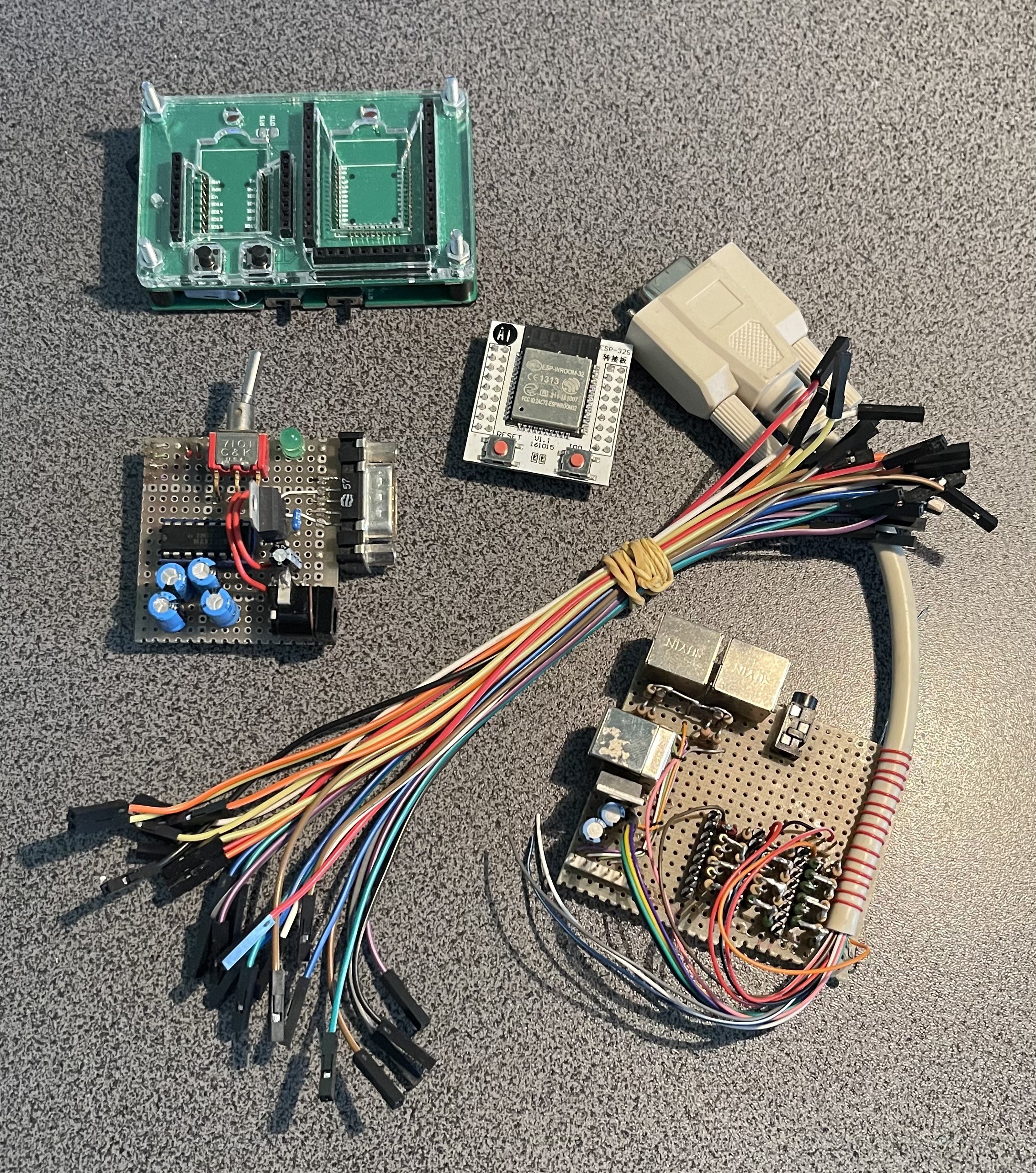

    Everything began with the first prototype I made. In the previous post I mentioned that many of my projects stranded in the phase where everything was held together with strings. Well, this prototype is one of those. As far as 'being held together with strings', while still doing its work, is something to be proud of, I am extremely proud of this one! Let me show you. ;)
    The parts.
    The result. Working!
    That it was actually speaking with my SYM-1 was motivating enough to dive headlong into the project.
