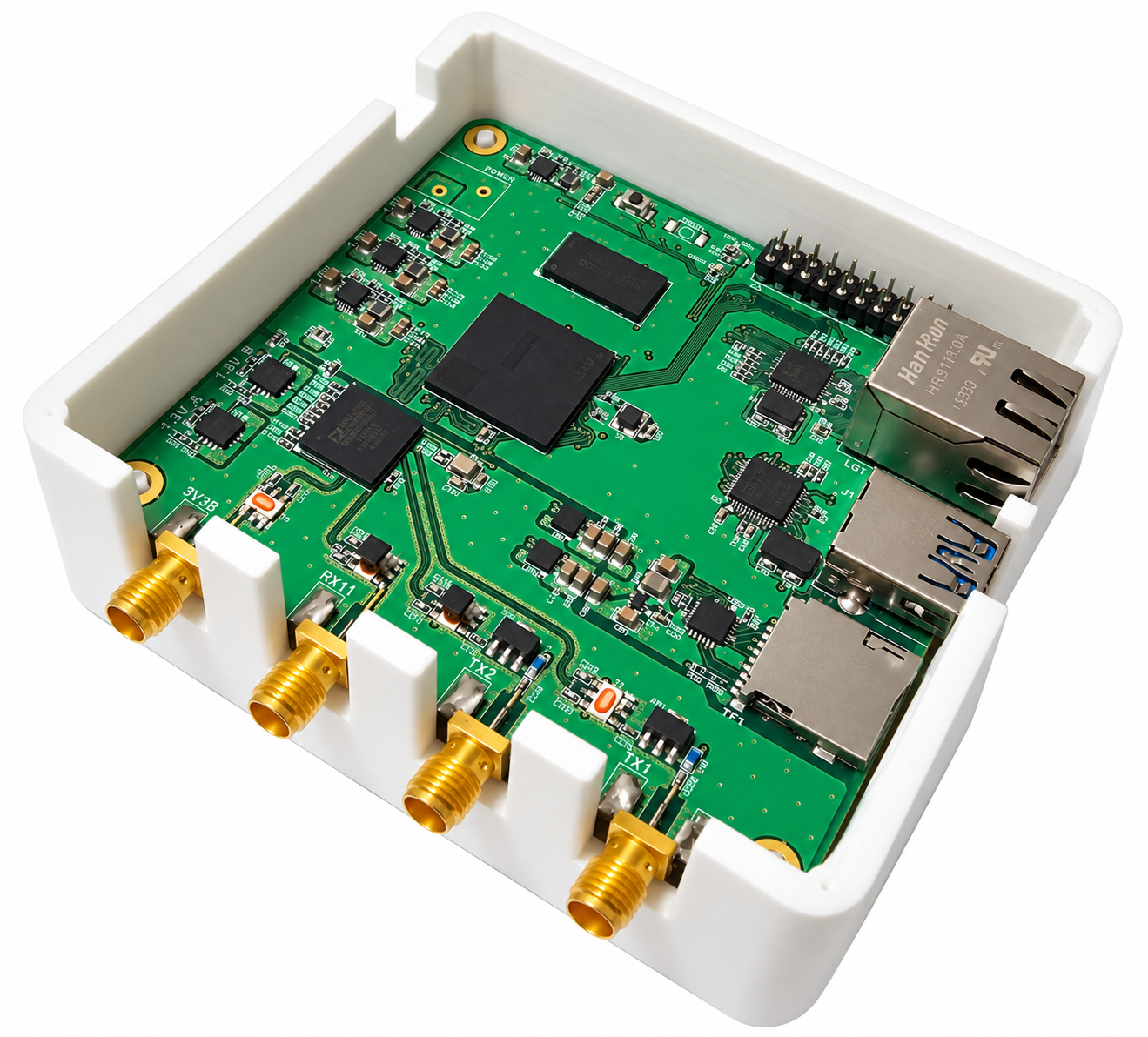

Figure 1. Integrive-100, the SDR development platform we built during this project.

Integrive-100 provides an FPGA-based PHY implementation in the Programmable Logic (PL), together with an ARM-based Processing System (PS) running Linux. During algorithm development, a selected PHY function can be implemented in software on the PS, while the remaining PHY functions continue to execute in the PL.
This creates a practical development model:
Develop the PHY function you want to investigate in the PS. Let the existing PL implementation handle the rest of the communication chain.
What makes this particularly useful is that the algorithm can be evaluated as part of an operating PHY chain rather than only against previously captured data. PHY processing can be handled at the symbol level, allowing developers to observe and evaluate how their algorithms behave while the communication system is running under real RF conditions.
