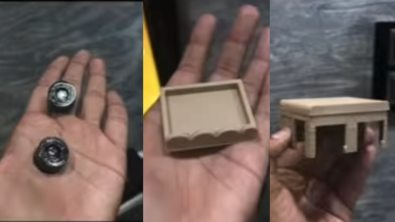

The truck body was custom designed and then 3D printed using JUSTWAY.
The reason I chose professional printing instead of printing locally was because:
  • Better surface finish
  • Cleaner detailing
  • More accurate fitment
  • Less post-processing
Since the enclosure has multiple sections for displays, LEDs, and speaker mounting, dimensional accuracy mattered a lot.

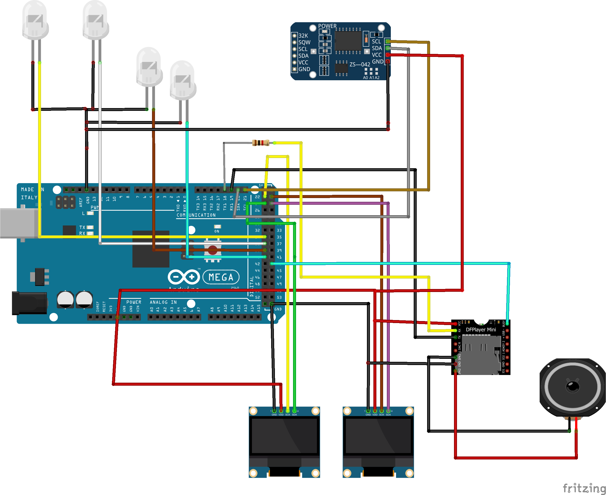

The system uses the DS3231 RTC module to continuously track the current time.
When the preset alarm time is reached:
  1. The DFPlayer Mini plays a truck startup sound
  2. LEDs begin blinking
  3. Engine idle and horn sounds loop continuously
  4. The alarm runs for 5 minutes
  5. A truck shutdown sound plays
  6. Everything turns off automatically
Meanwhile, the OLED displays continuously show:
  • Left OLED → Hours
  • Right OLED → Minutes
This split-display design makes the clock look much more futuristic and dashboard-like.
Circuit Explanation
The Arduino UNO controls all modules:
  • RTC provides accurate time
  • DFPlayer handles audio playback
  • OLEDs display the time
  • LEDs simulate truck lights
The BUSY pin from the DFPlayer is used to detect when an audio track finishes playing. This allows the Arduino to automatically start the next sound file without delays or manual timing.
That small detail made the startup and looping sequence feel much smoother.
[Insert wiring diagram here]
Design Process
The enclosure design took multiple iterations.
At first, I tried making the truck shape too realistic, but it became difficult to fit:
  • OLED displays
  • Speaker
  • Wiring
  • Arduino board
So I simplified the structure while keeping the recognizable Indian truck styling.
The OLED displays were separated intentionally so the clock resembles a vehicle dashboard.
Another challenge was speaker placement because enclosed audio can sound muffled inside 3D printed bodies. I had to experiment with vent placement to improve sound clarity.
