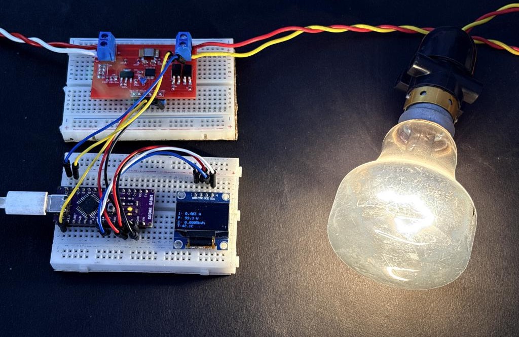

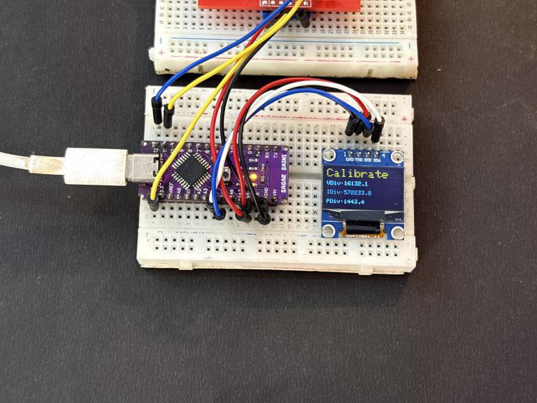

Calibration using Load:

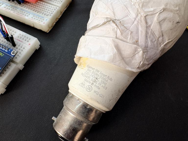

The SEL pin must be tied to VDD (3.3V) for SPI mode. Now use a 100W bulb, note down the socket voltage current and compute power manually using multimeter. Then feed the values inside the code like this:

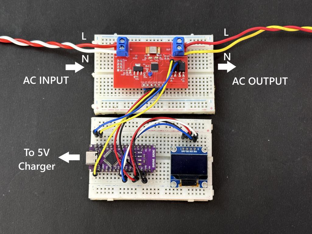

Make the onboard circuit as given here, you have to use the OLED, do not use laptop serial monitor when the IC is plugged in 220V. Laptop is only used to upload the program in the Arduino.

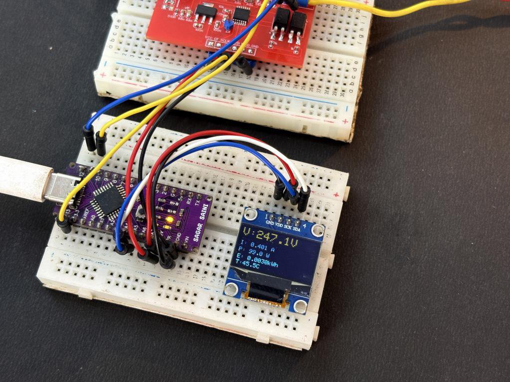

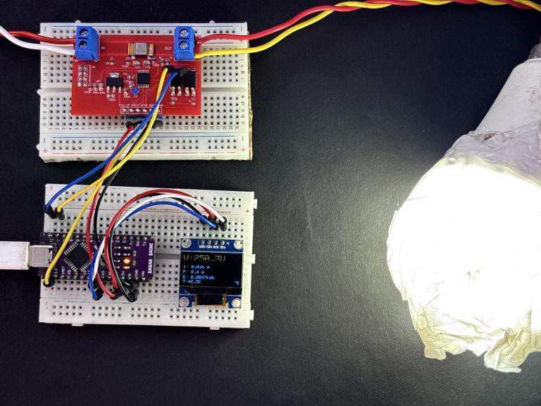

After upload connect the 5V power charger and load as given here, and note down the coefficients that are displayed on the OLED. Note them down and copy in the main working code for calibration.
Working Code:
Here is the main working code after uploading the calibration coefficients see how the reading changes.

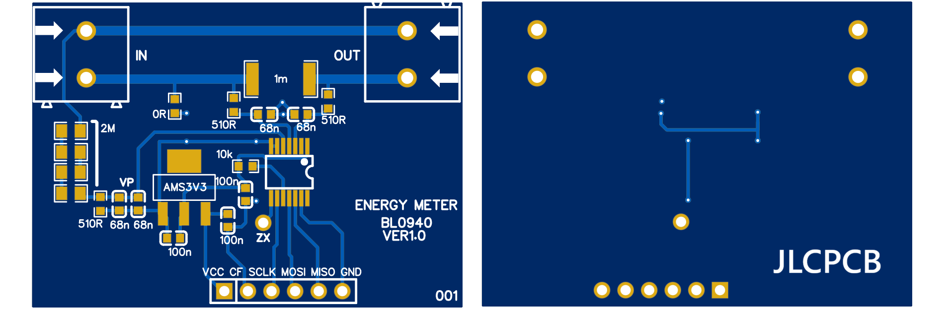

PCB Overview:
I have kept the PCB minimal and easy to plug, It is kind of breakout board which contain the main IC and supporting electronics, you can plug it with any microcontroller in order to make it working, For now I am using Arduino Nano.
The PCB is simple yet it works, and I have tested it fully, keep in mind the LIVE and NEUTRAL connections, be careful when working with the AC voltage. You can download the files from here, with the working code. I have designed this in EasyEDA and fabricated using JLCPCB, I took me around an hour of soldering work to make it work in real life. If you want a proper soldered solution that works in the first go, I will recommend to go with JLCPCB PCB assembly services, you try them out in lowest prices from here.
