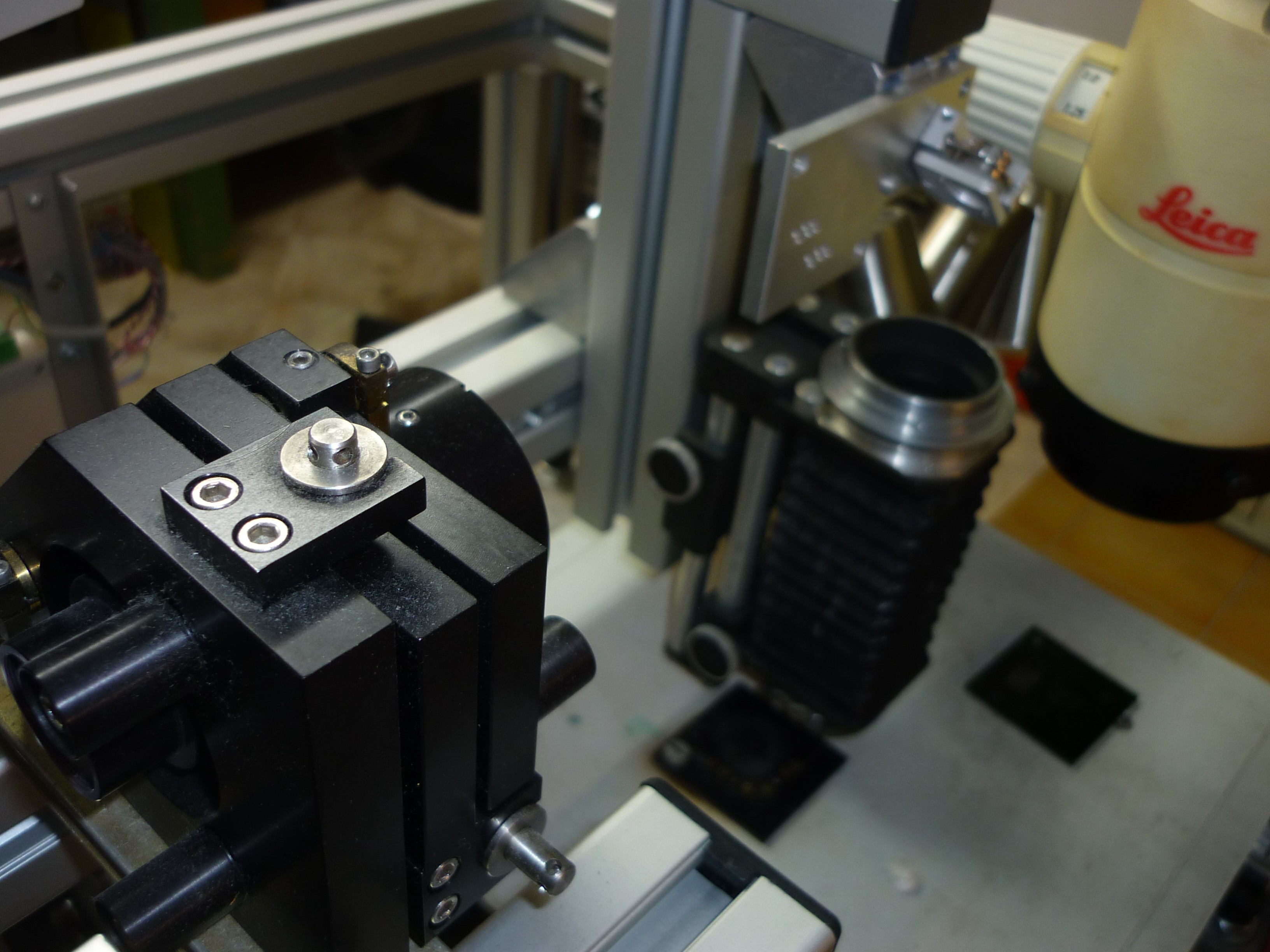

The xy-stage is of very high precision.

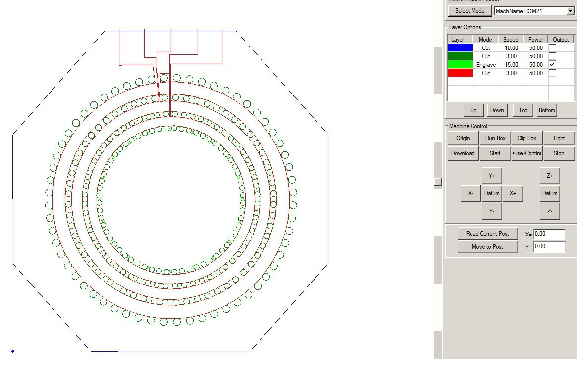

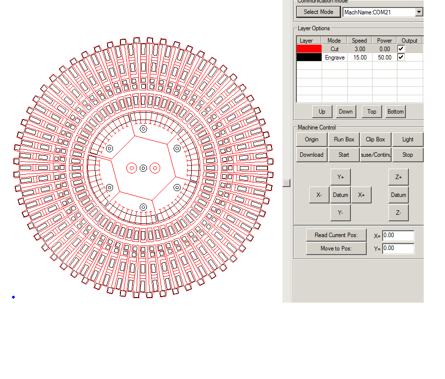

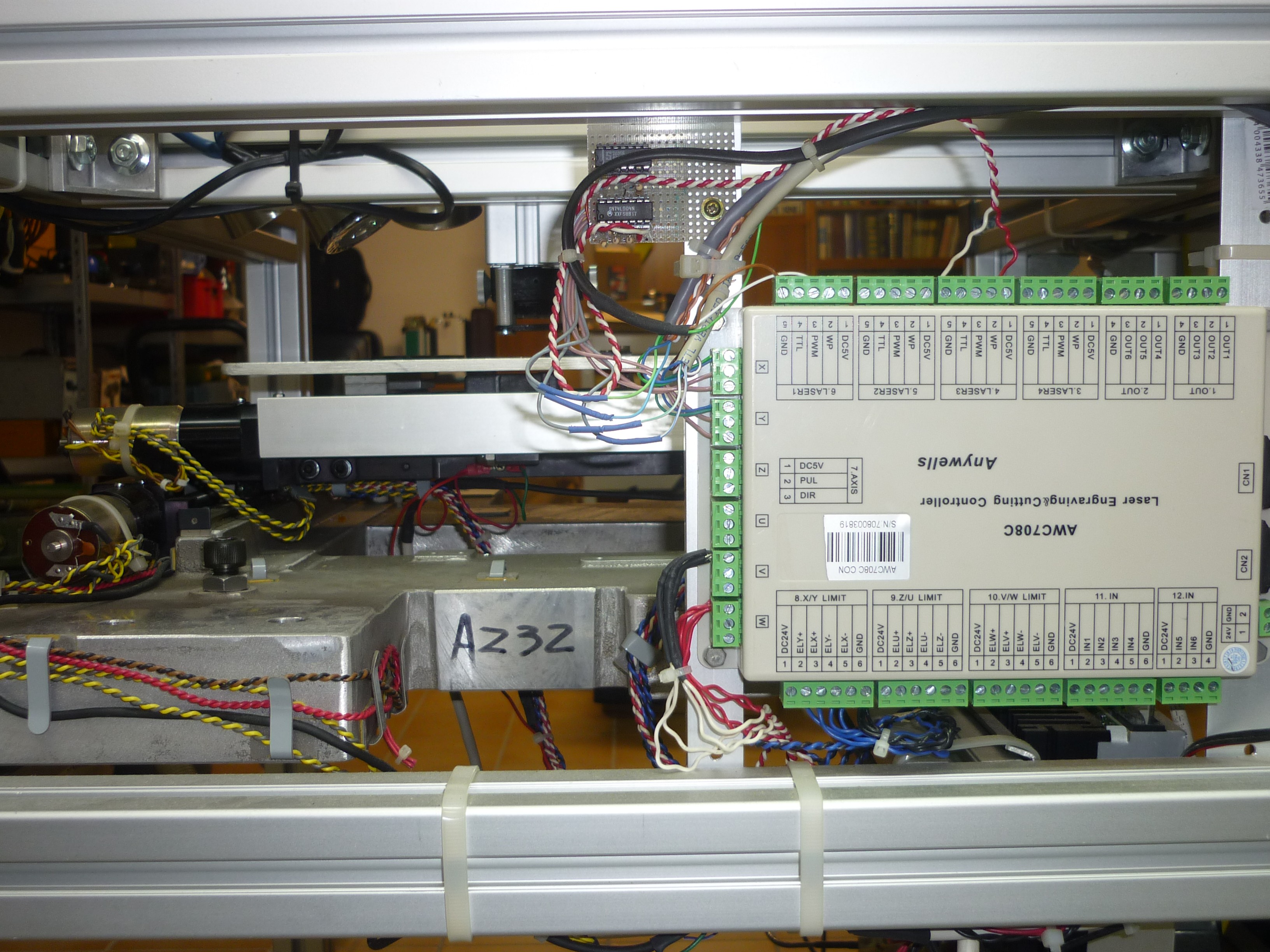

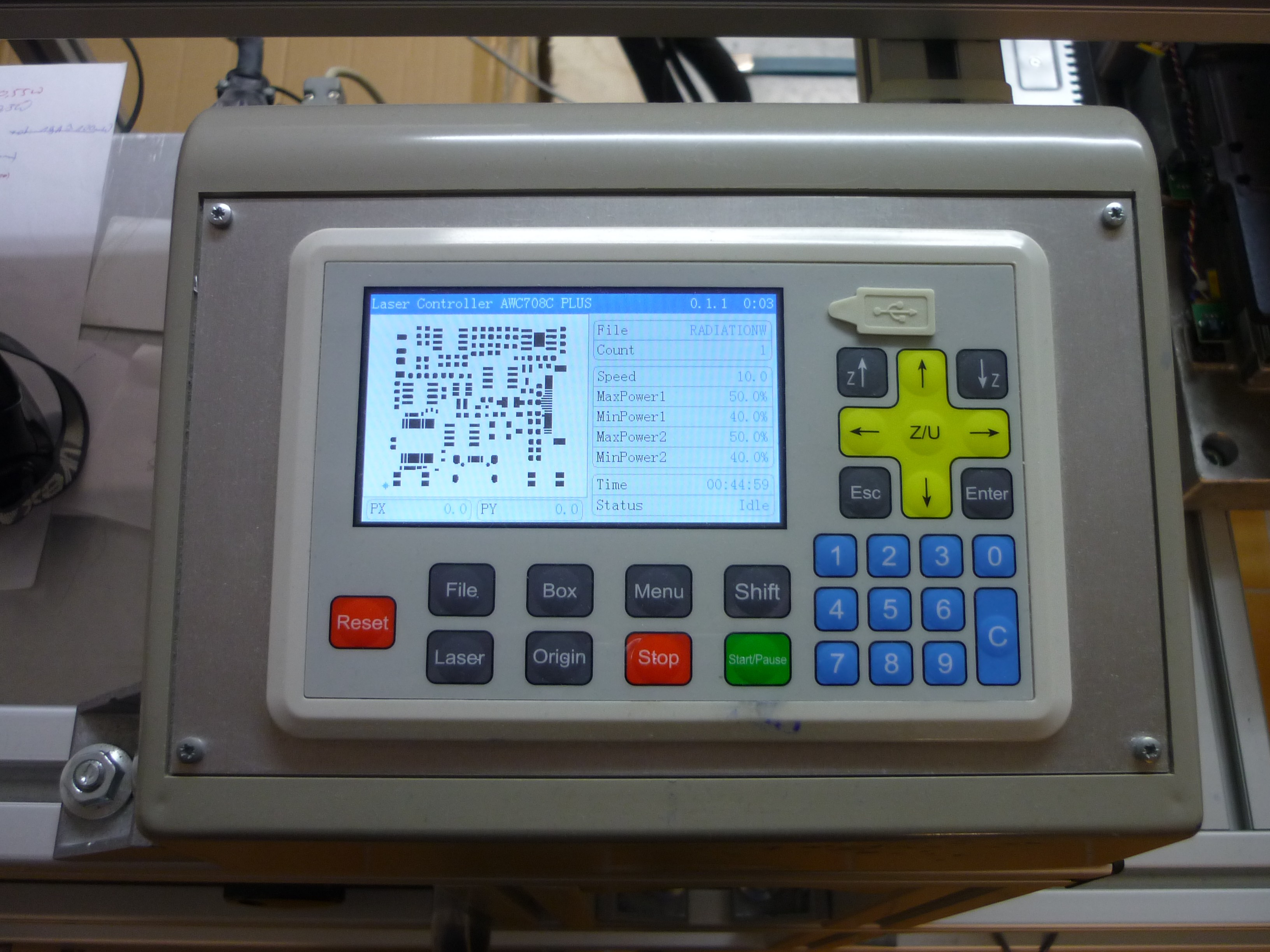

The machine is controlled by a Trocen Anywell AWC708C laser controller, designed for CO2 lasers, which I had to modify for usage in combination with the Nd:YAG laser. It's a stand alone controller. The software LaserCAD allows communication between the computer and the controller and to draw geometry, add text and images, although I primarily use LibreCAD under linux for these tasks.

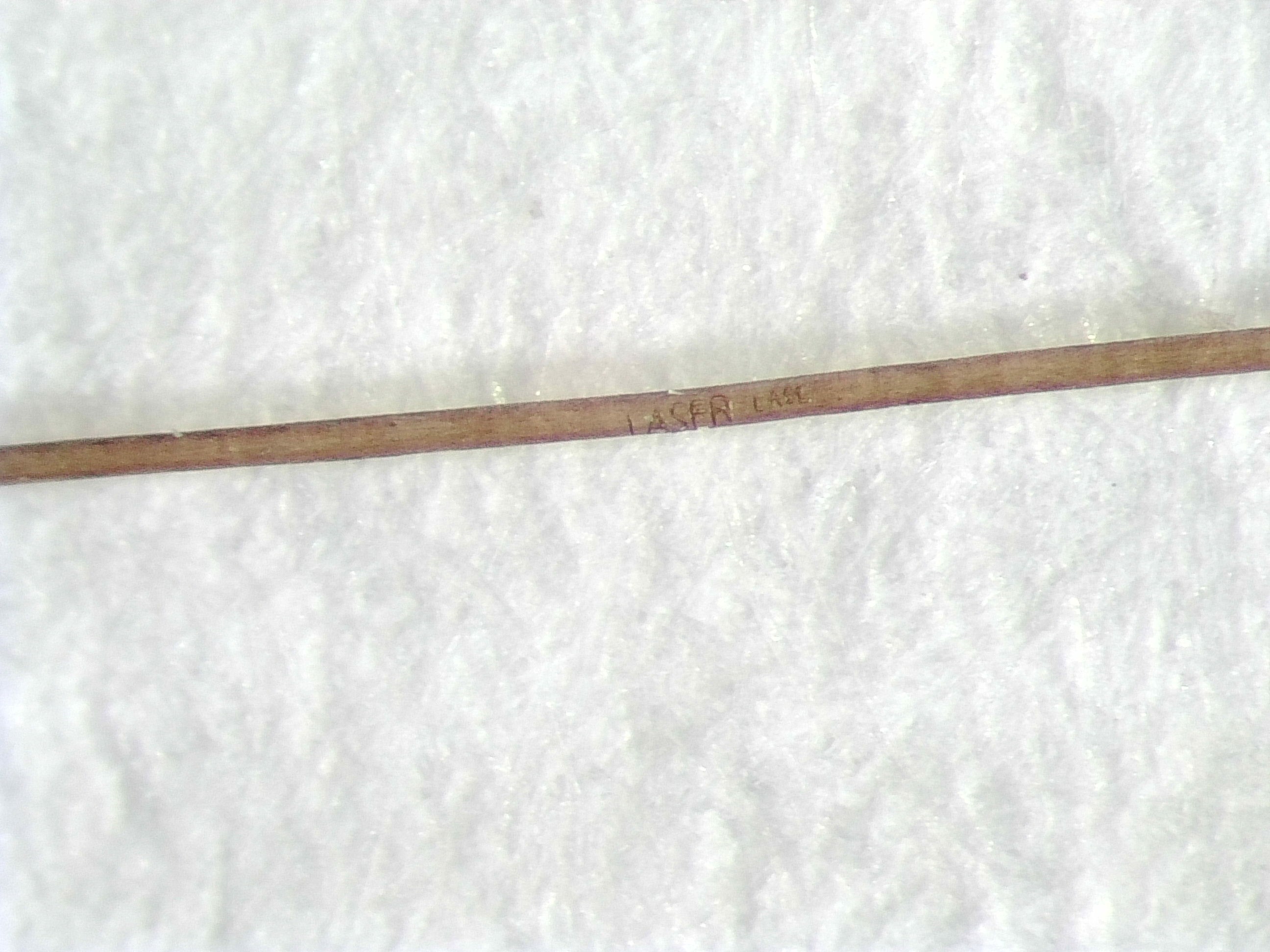

The letters LASE on the picture above have half the height of a hairs diameter: ~ 30 µm

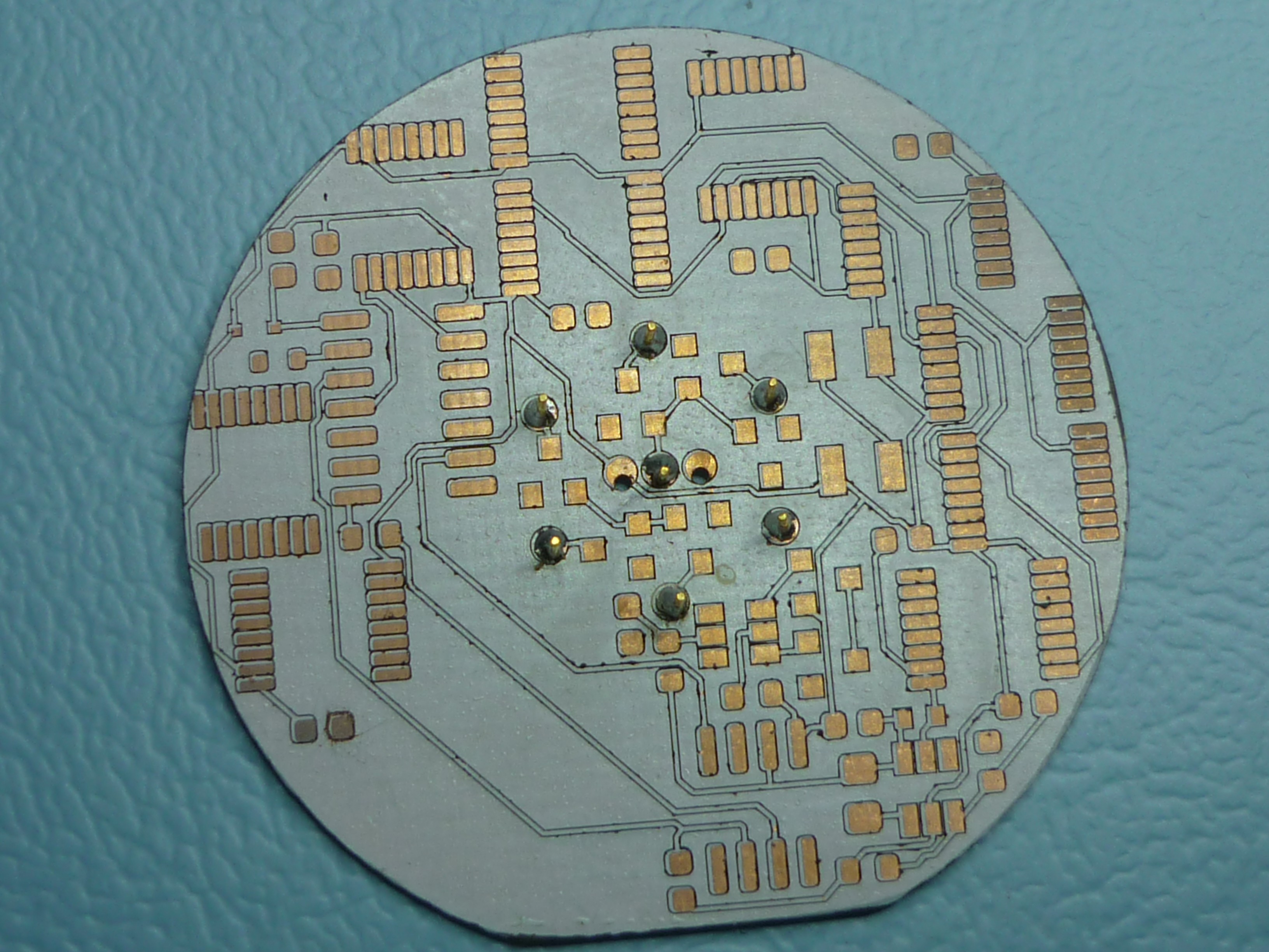

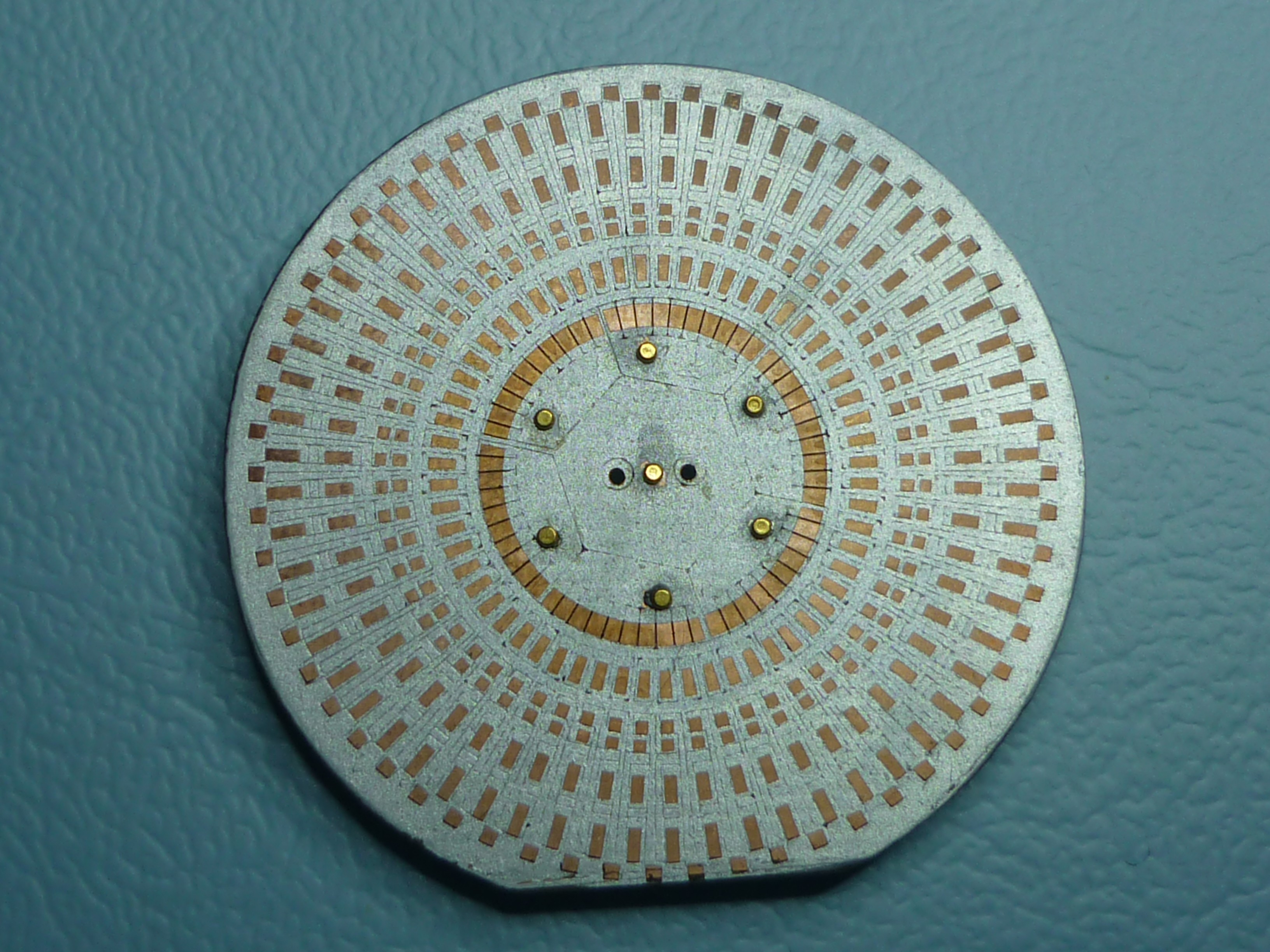

https://www.dropletwatch.com/circuit-pcb
If you scroll down, you'll find a description of how I make PCBs with the laser

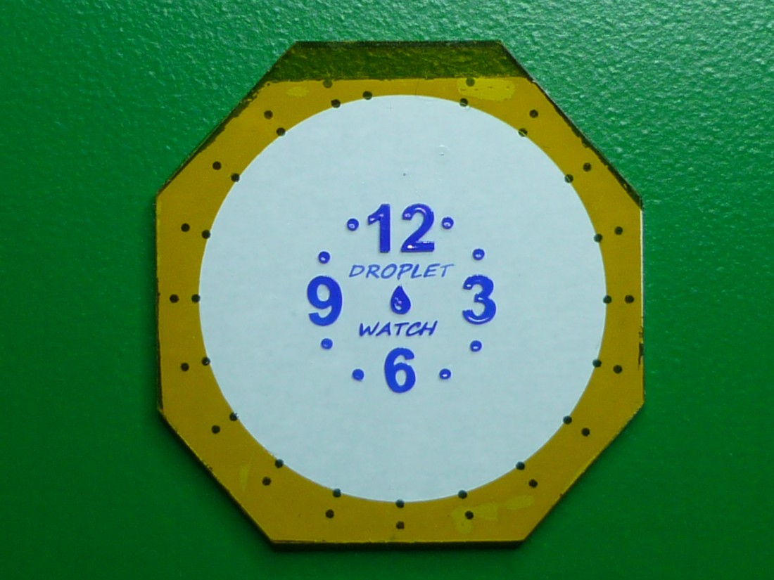

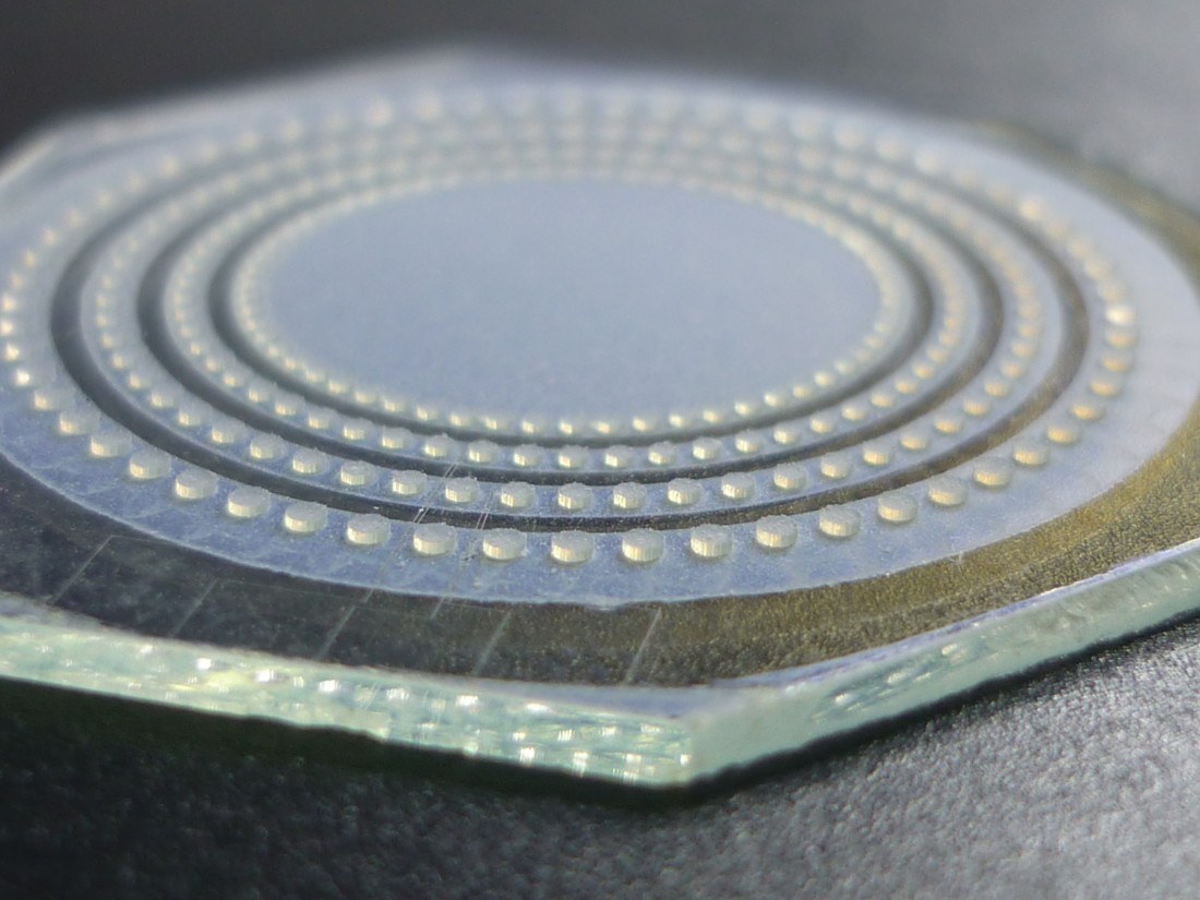

https://www.dropletwatch.com/display
Here you will find a description of how ITO is structured and how photosensitive epoxy is exposed

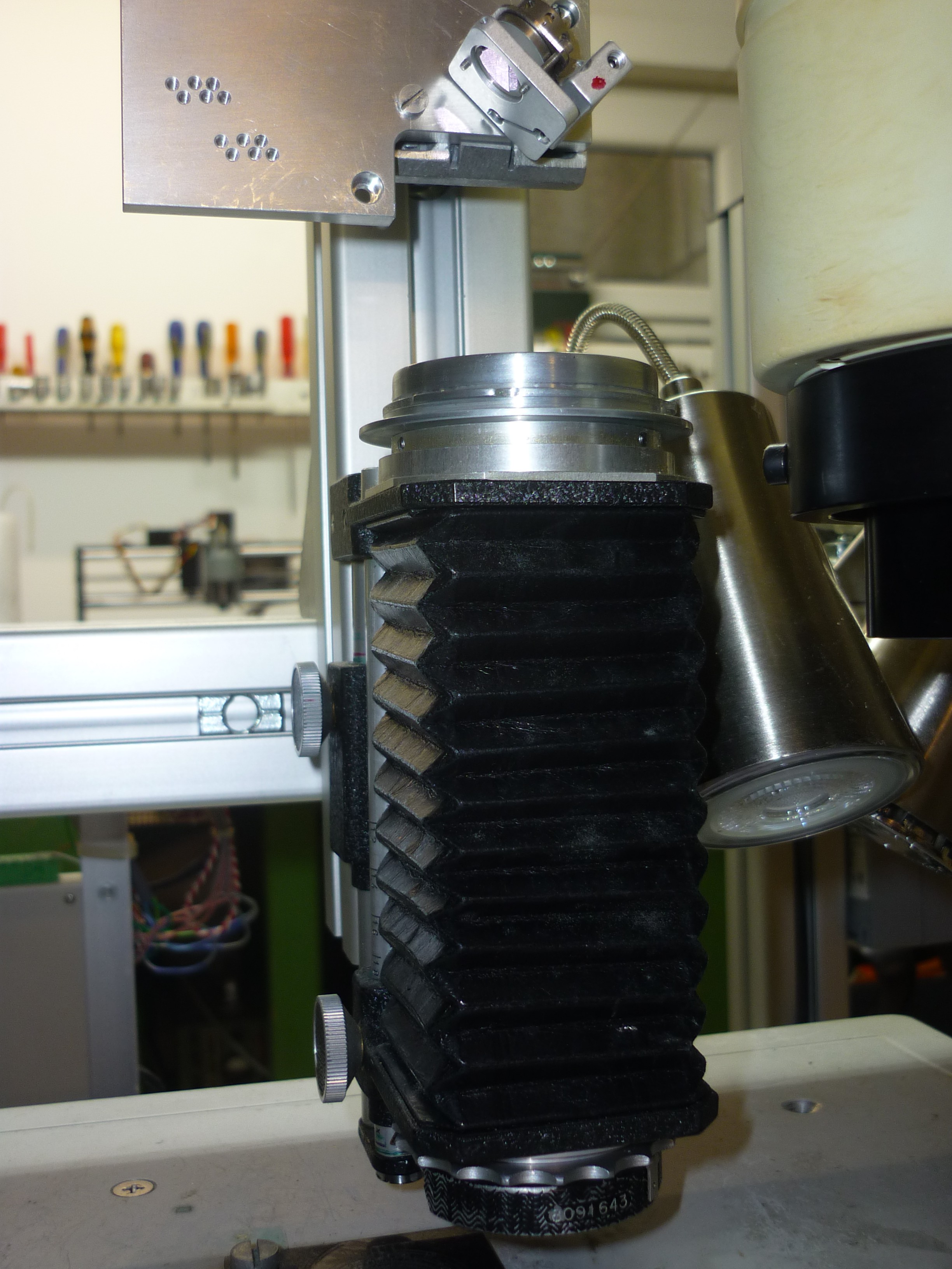

the focusing unit, featuring parts from the 1960s and a deflection mirror
on the left the upcollimator
laser controller and linear stage

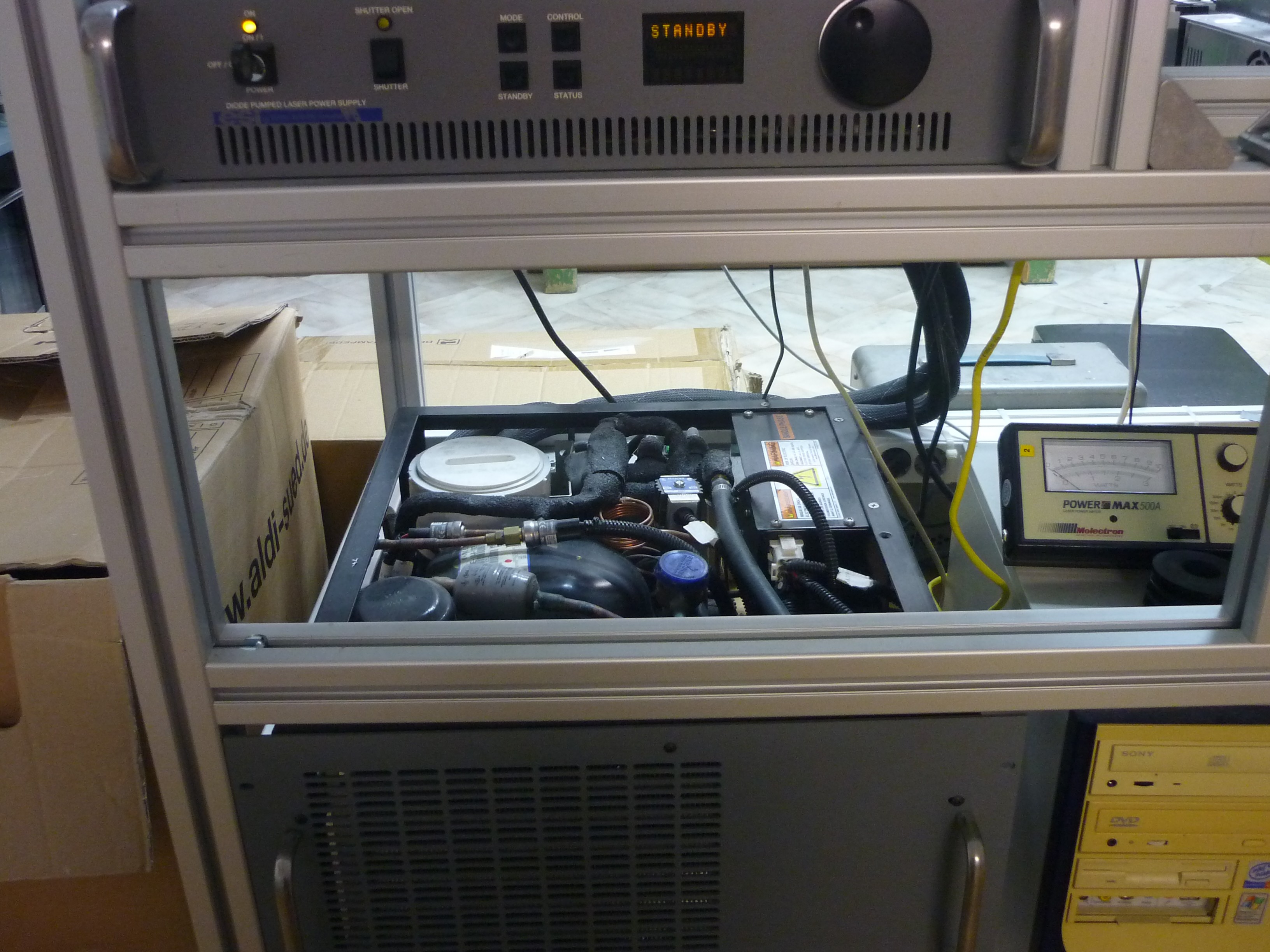

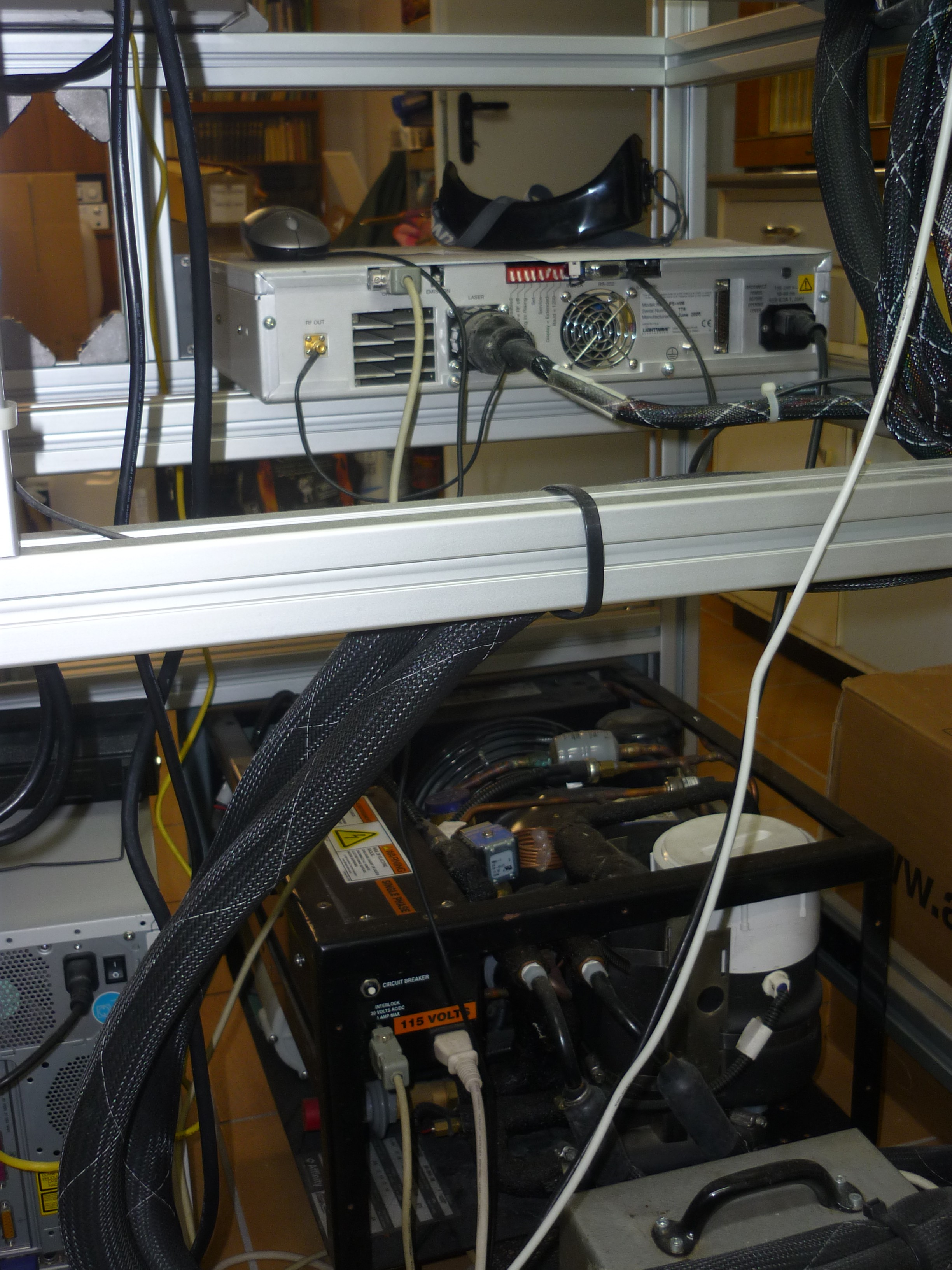

laser power supply and water chiller

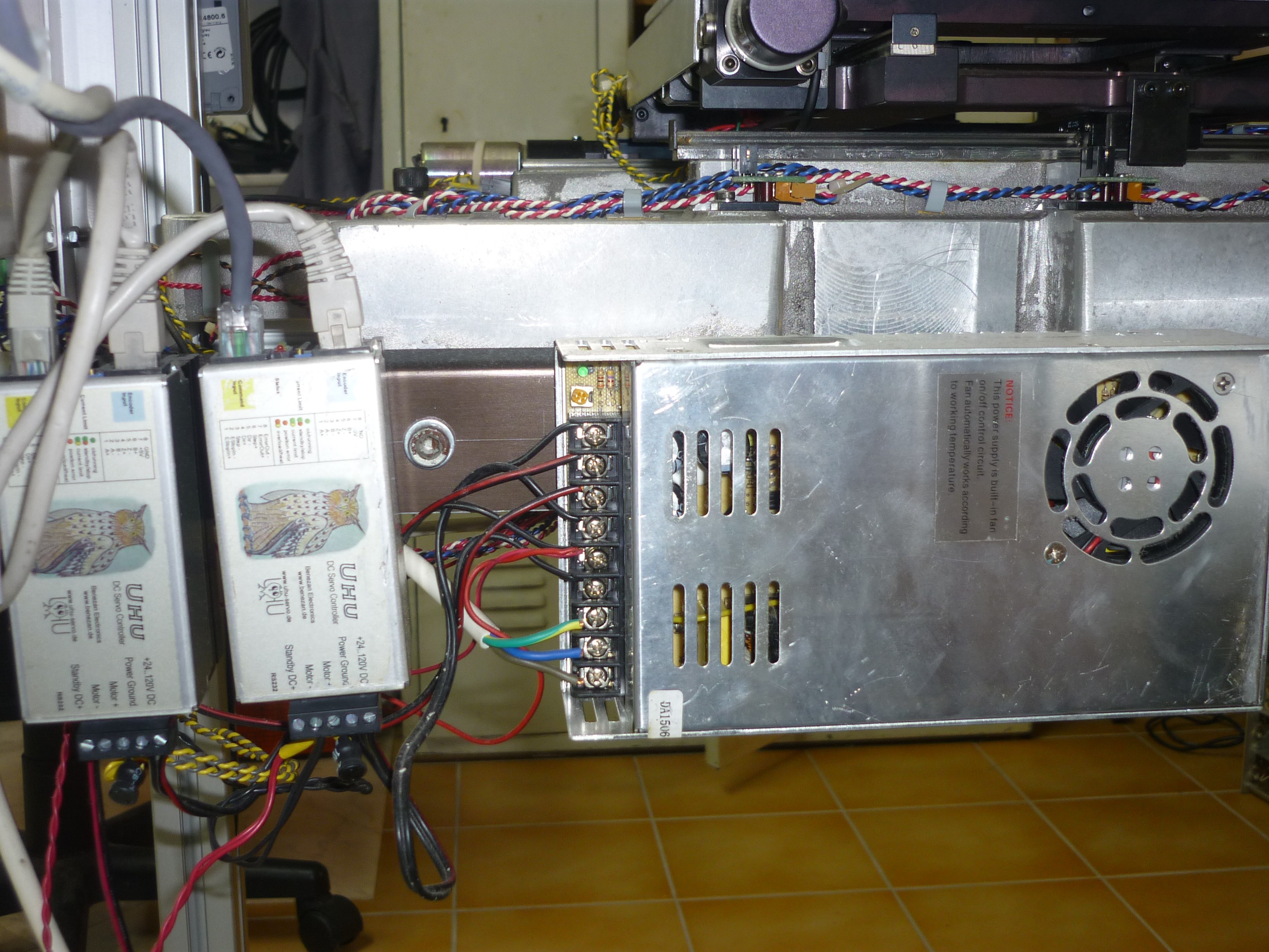

servo controllers with power supply
