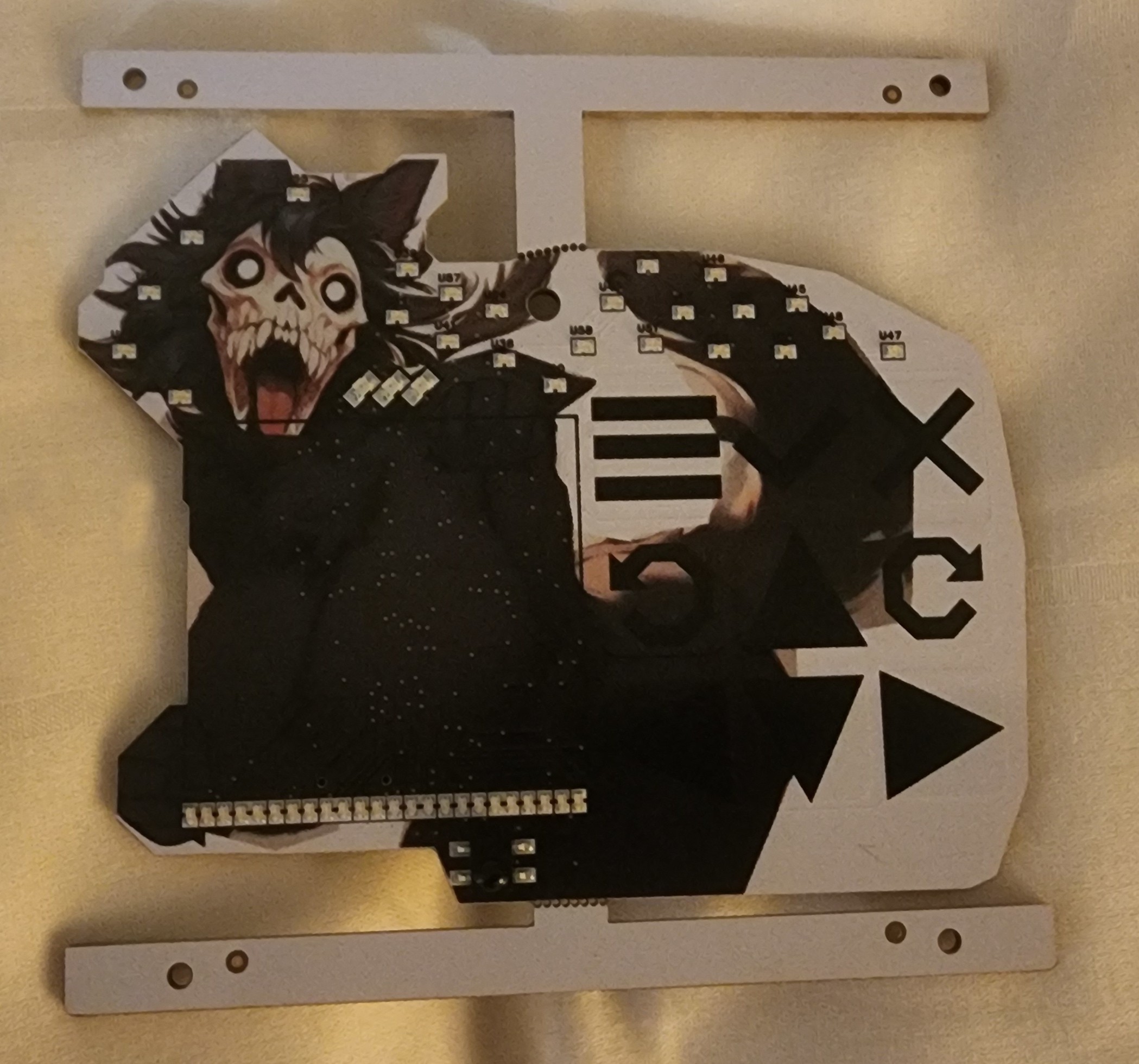

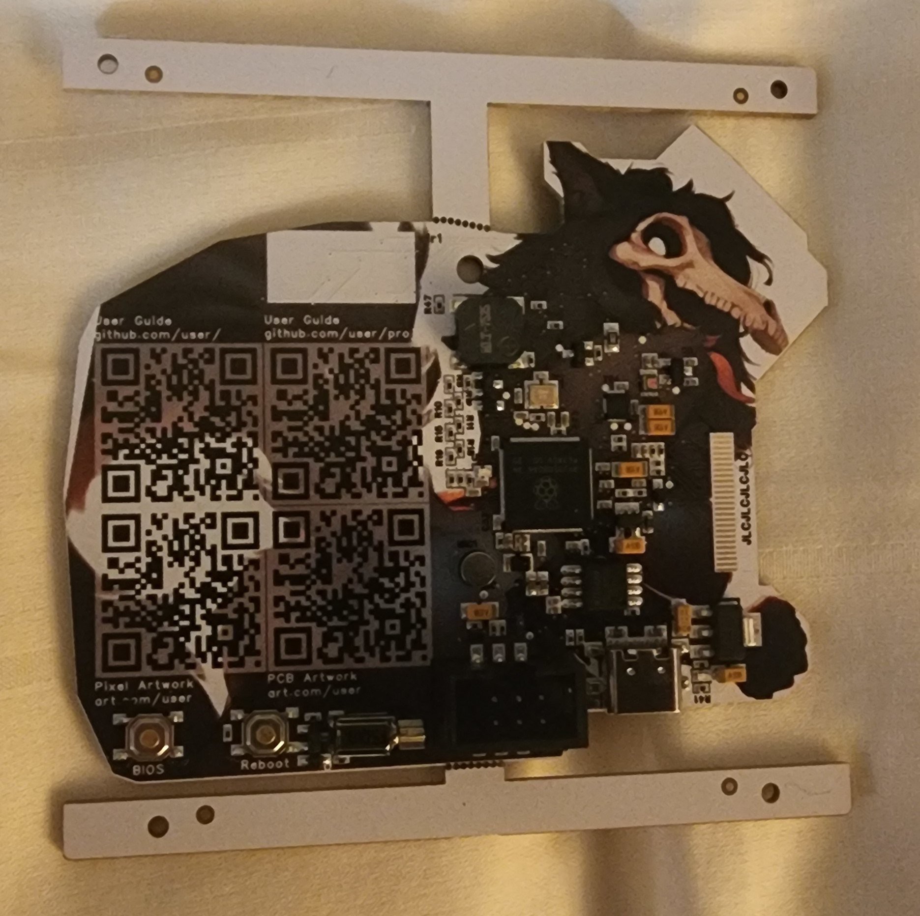

    First action when receiving new boards is to photograph them:
    One detail that irks me is the small white pull-back around every pad.  That's a property of the color silkscreen technology, but it's not something you see in the CAD render and does hide/obscure the artwork a little.
    I didn't take any effort to remove the black silkscreen, so you can see the reference designators around the entire back side, particularly over the white background
    A small note: the fab house has a minimum order of 5 PCBs, but I chose to only have 4 populated with parts - that gives me a clean copy of just the PCB itself that I can check continuity on the traces (workmanship) independent of the parts themselves (ex, a chip may internally close the connection between two VCC pads, where the PCB may have otherwise treated them independently).
    First power-ON is the most nerve-racking part of the process in my experience: either the board works fully or it doesn't - it's a very binary fork in the road.  It's normally worth taking this step very slowly - I have spare populated prototypes, yes, but those are really for backup/experiments during development).
    - Did a resistance check between power (3v3) and ground.  Got 600 ohms.  Not terribly insightful aside from there at least shouldn't be a dead short between power and ground, so that's good enough to proceed.
    - Observed that there is a mechanical interference between the screen and the edge of the PCB (her hand holding the screen).  I had specifically planned around this, but still ended up with interference - turns out misread the screen mechanical drawing and though the cable was much longer than it ended up being, so definitely a fix for the next prototype... I later used a dremmel to shave off that part of the PCB so I could assemble the screen properly.
    - I applied 3.3V with a 100 mA OCP limit on my power supply, with the thought that if this design was defective, it should hopefully not draw so much power that it destroys itself- trying to preserve the prototypes as long as I can
    - The 3.3V power indicator LED came ON (much brighter than I expected, will be decreasing the 1~5mA current draw notably on that LED in the next prototype). Power draw is around 100 mA, where is all that power going...
    - Poking my finger around on the PCB to try to find the hot spot, I misdiagnosed the problem as coming from the crystal, and I went down a rabbit hole trying to debug that.  In the coming weeks, I would determine it was the neighboring IMU where I swapped the interrupt and VCC pins, putting it in a half-driven configuration that loosely shorted power to ground and drawing excessive power.  There is an option to de-solder one part and observe the impact on the power draw that way to definitely prove where the issue is coming from, but I didn't pursue that path here, in part because this is a 2-sided PCB design and makes it hard to rest the board on a hot plate and not inadvertently remove part from both side of the PCB.
    - But pushing forward, can it be programmed despite the high power draw?  Plugging in via USB in BOOTSEL mode and it successfully manifests as a USB drive just like the pico2 (I was using this for software development up to this point), so far so good.  Uploaded a simple blink sketch (driving the debug LEDs), and nothing...
    - However, adding in Serial printout works normally, so the chip is running the bit file, but not driving the LEDs... issue was the pico2 is a RP2350A chip, and in order to program the larger (more pins) chip, you need one that enables the extra GPIOs.  When I set the Arduino IDE to MyMakers RP2350B, that enabled the extra pins, including the LEDs on the upper bank, and the debug LED blinked.

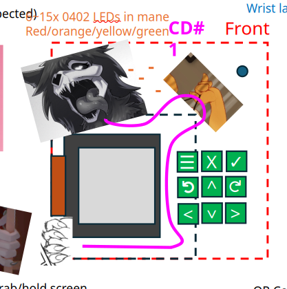

    First concept layout
    - I had early notions of a leash of LEDs going from her neck all the way around the screen.  Later, when I laid this out to scale, the cap touch buttons needed to be so large, there wasn't good clearance between the touch pads on the right and the screen on the left (plus I has EMI/EMC concerns between the sensitive cap touch pads and the high frequency charlieplexed LEDs), so I ultimately broke this string of LEDs into two banks: one in her hair, and one as a kind of status/scroll bar below the screen - giving the cap touch pads a clan shot directly into the processor (where I'm trying to measure capacitance changes on the order of 10s of pF).
    - I opted for red-green LEDs, on the premise the primary color of SCP content is a shade of orange (mix of green and red).  Chareliplexing N pins allows control of N*(N-1) LEDs - ex for 8 pins that's 56 LED elements.  The width of the screen fit around 24 LEDs (24 red-green LEDs is 48 LED elements).  So I moved forward with a lower bank of 24 red-green LEDs below the screen, and an upper bank of also 24 LEDs.  This allowed me to recycle the same PIO/code interface between the LED banks.
    - I considered WS2812 LEDs to get full RGB support (also called "NeoPixel"s by Adafruit).  The SAO standard stipulates 3.3V input, and I disliked the idea of needing to add a 5V step-up converter required by the WS2812s.  I wanted to keep the BOM cost reasonable, so opted for dumb LEDs (with a 1.8~2.3V forward voltage) with a plan to Charlieplex them (requires floating most of the GPIO pins in a bank, and then driving one pin high, one pin low, holding that for a tiny fraction of a second, then moving on to the next pairing).  The RP2350 supports floating the pins through PIO, where the prior generation chip did not.  The impact of chareliplexing LEDs vs a serial string of WS2812 is that it notably complicates PCB layout since there is now a direct electrical connection from LED directly to the processor (vs just a chain connection to each LED's neighbor in WS2812).
    - Those reviewing this closely will note the processor runs at nominally 3.3V (per the SAO standard), but the green LEDs wants ~2.9V and the red ~2.1V.  There is a dirty trick where high current draw (~20mA) through the processor will actually drop the drive voltage a bit, so I actually drive the green LEDs straight off the RP2350 GPIO pins.  For the red, I did include a resistor dropper, but I kept it to only 3 resistors total across the entire bank of 8 GPIO pins.  I did this by carefully selecting grouping of red LEDs to all share a common pin and routed the red connections through the resistor before reaching that gpio pin.
    - All this work was done before the DEFCON34 MICD was released.  At this stage, I was very concerned about overall size and keep-out zones....
