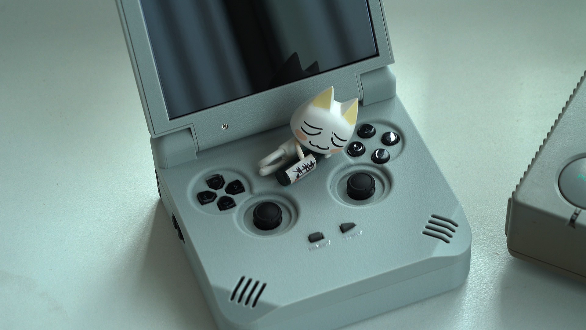

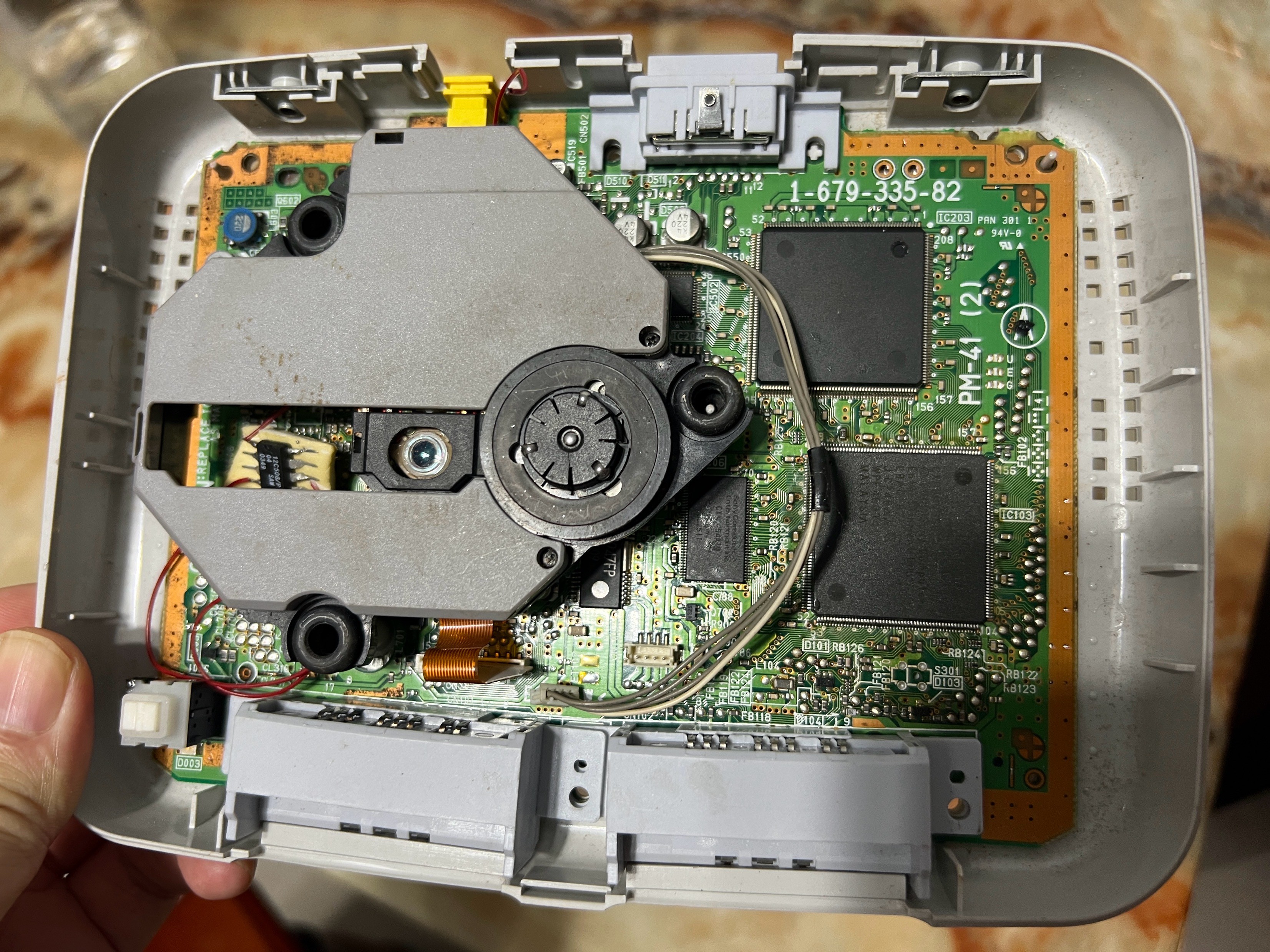

I turned a PlayStation 1 into a handheld console. Instead of using an emulator, I disassembled the PlayStation's components and reassembled them to deliver an authentic gaming experience. I adopted the classic flip design, featuring a large 5.7-inch screen.
I used a simplified version of the PS One console.

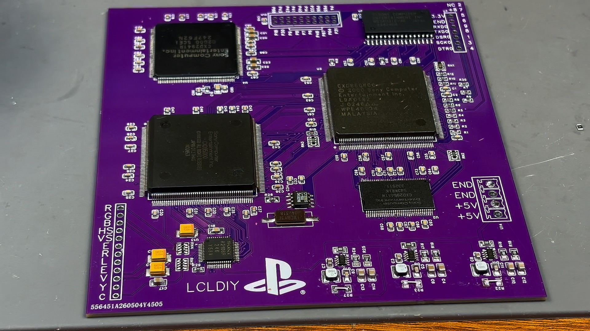

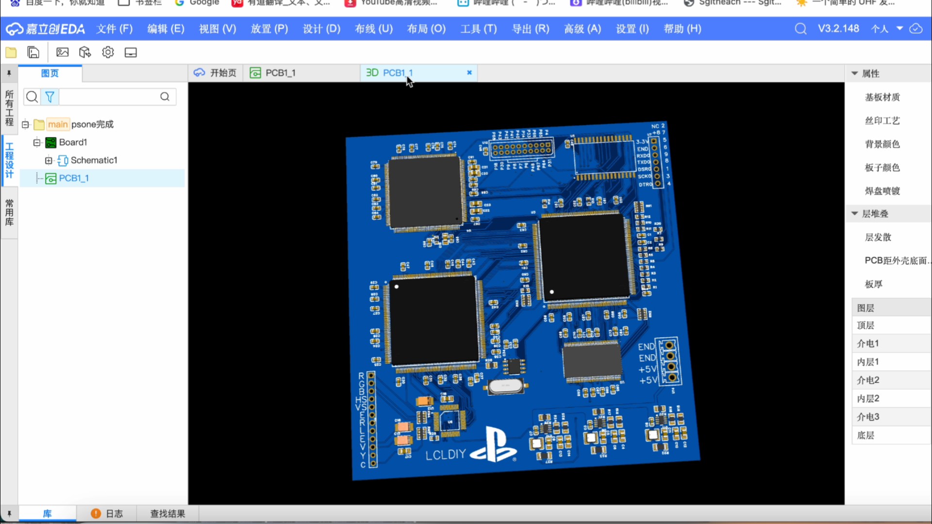

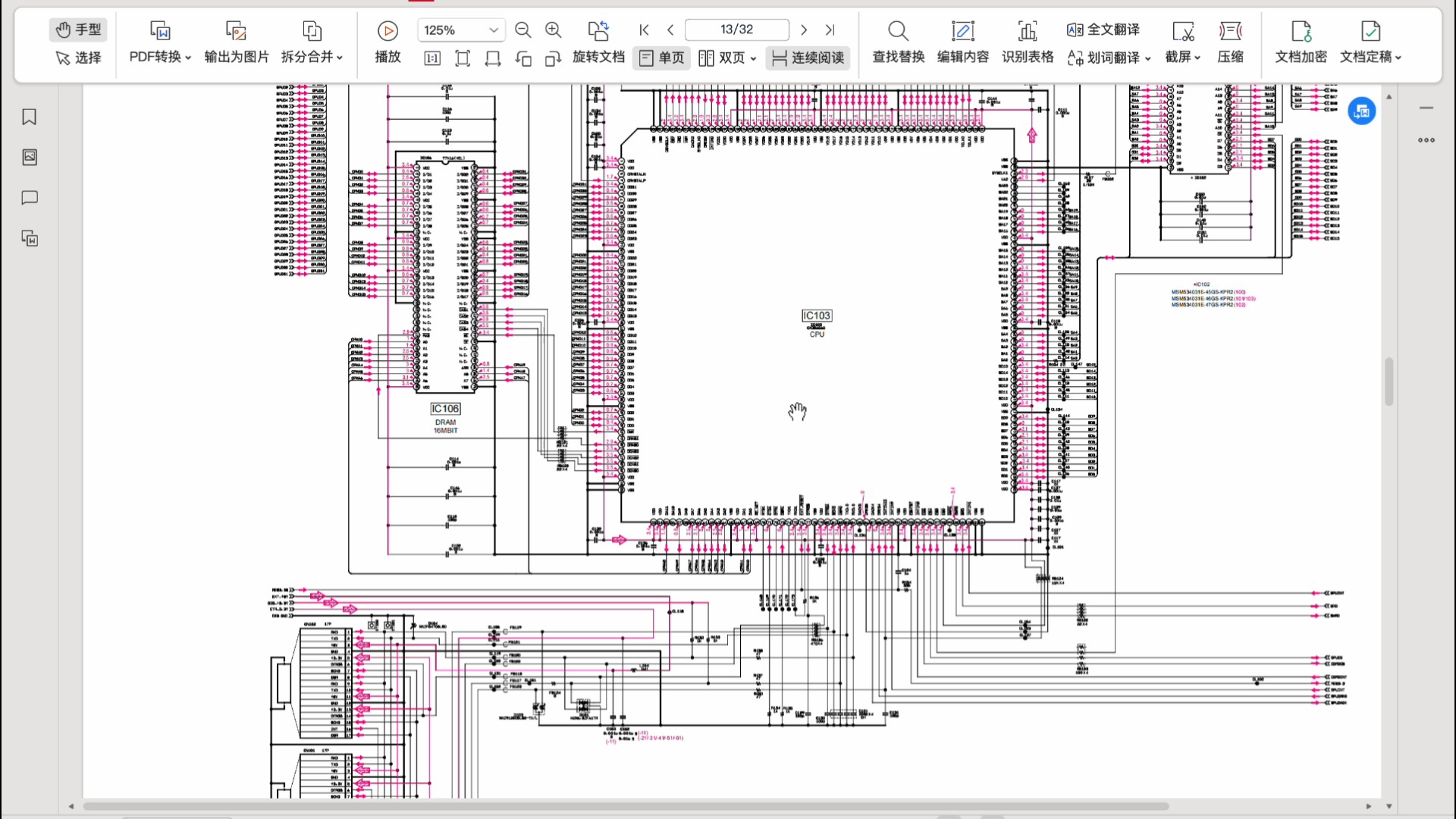

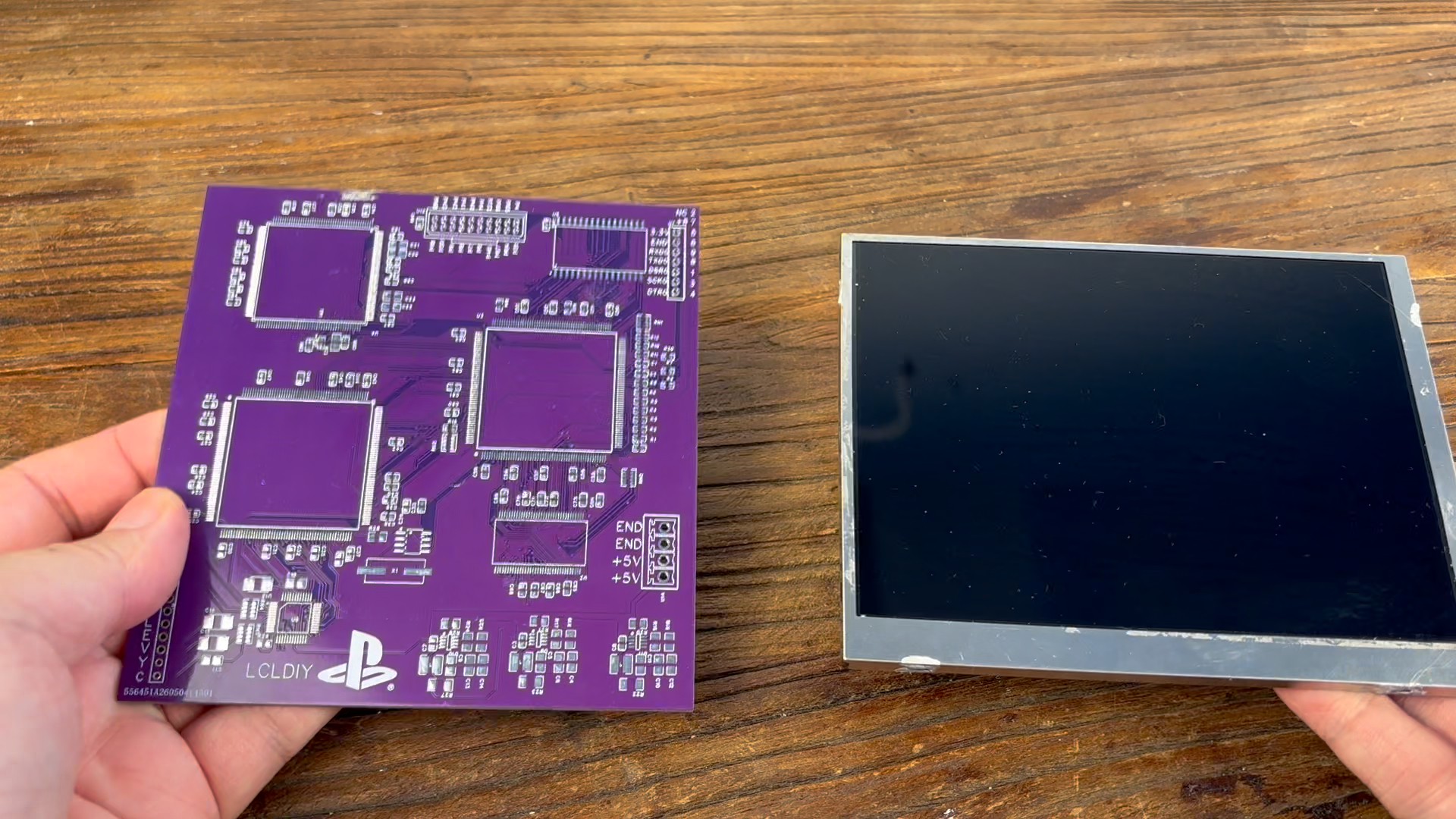

Redesigned PCB and 6-inch LCD screen

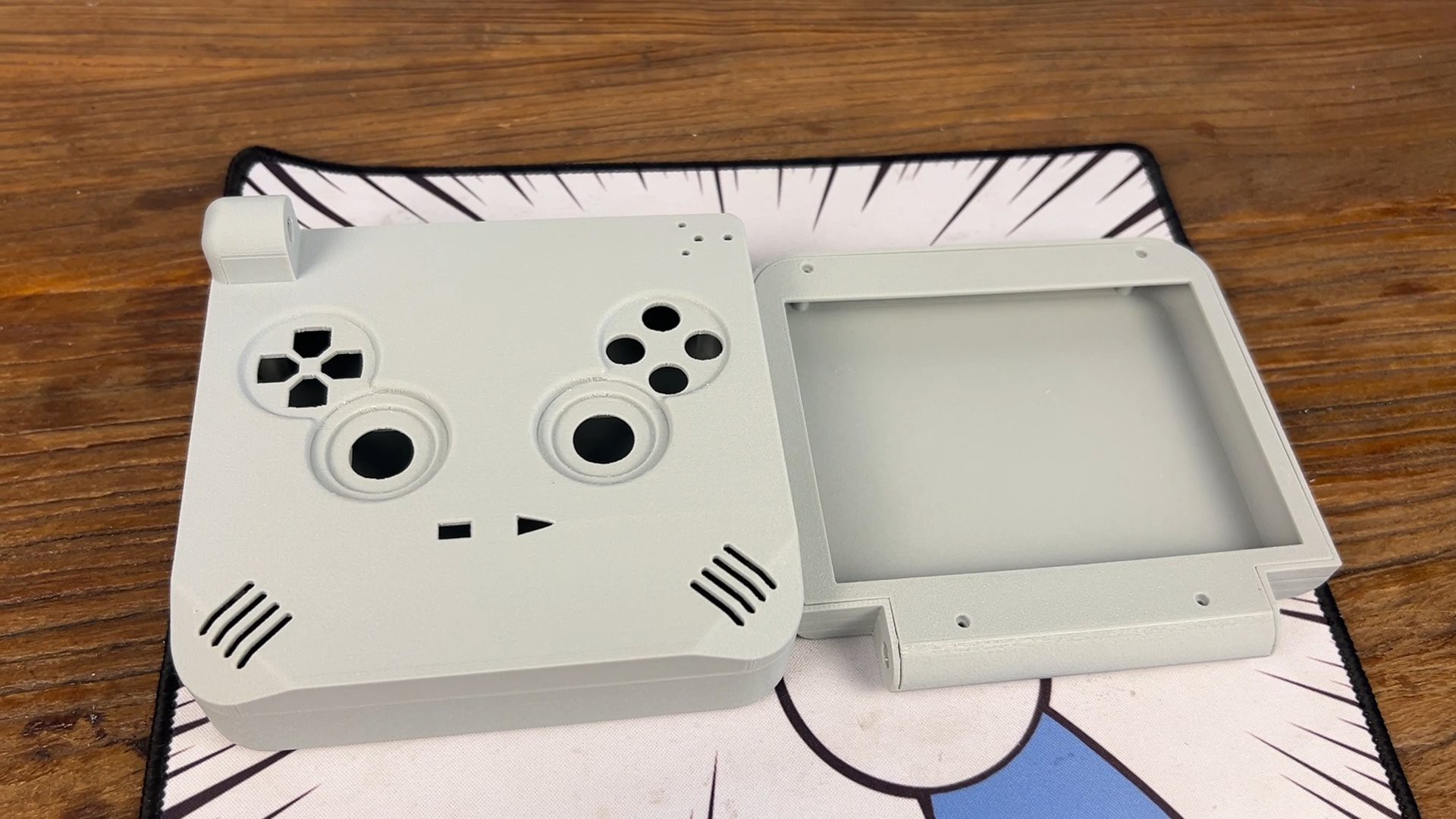

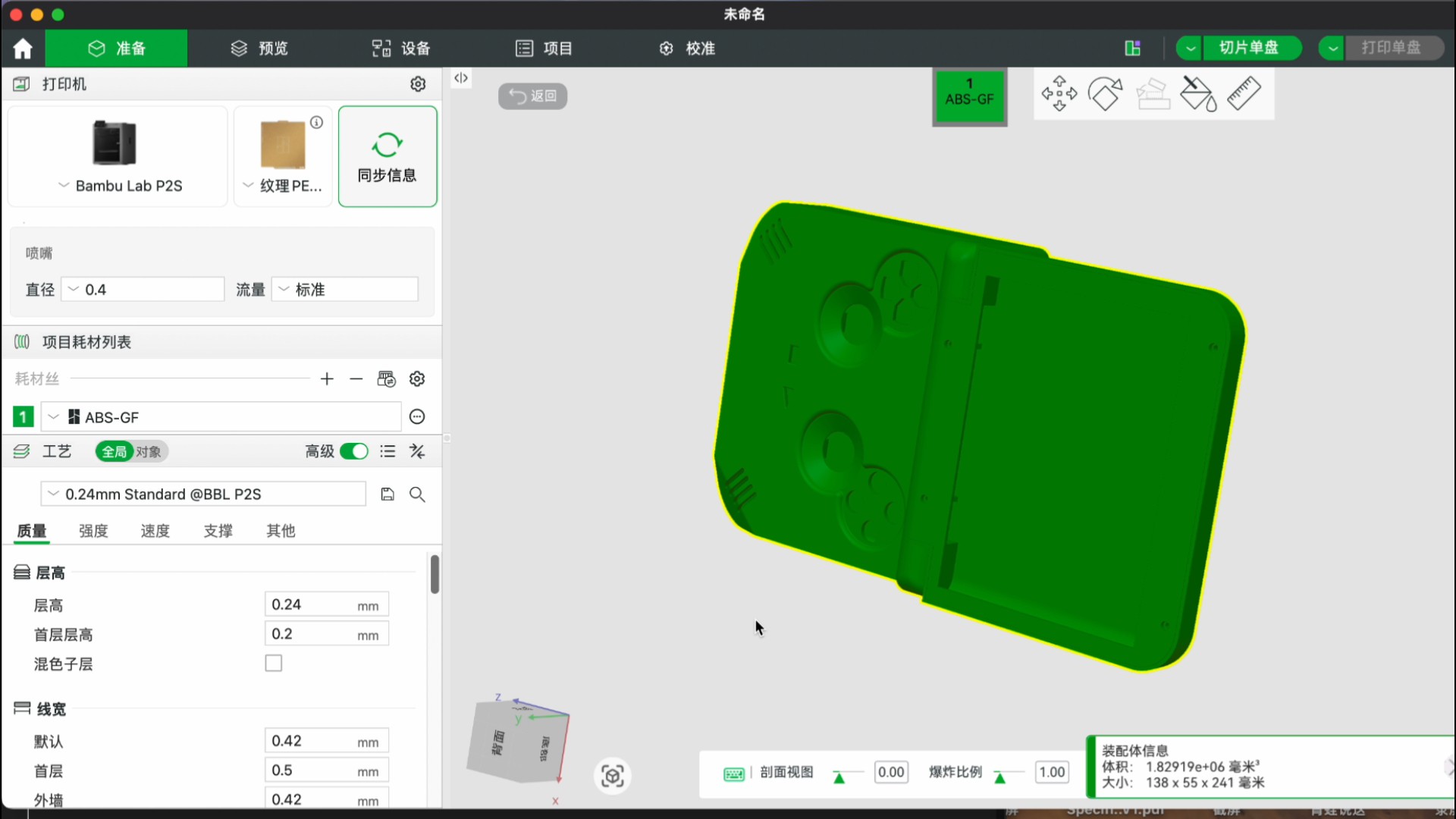

3D modeling and printing the casing
The circuit still has some issues and isn't very stable. I'm trying to find the cause.
I'll first open-source the circuit diagram and the enclosure.
