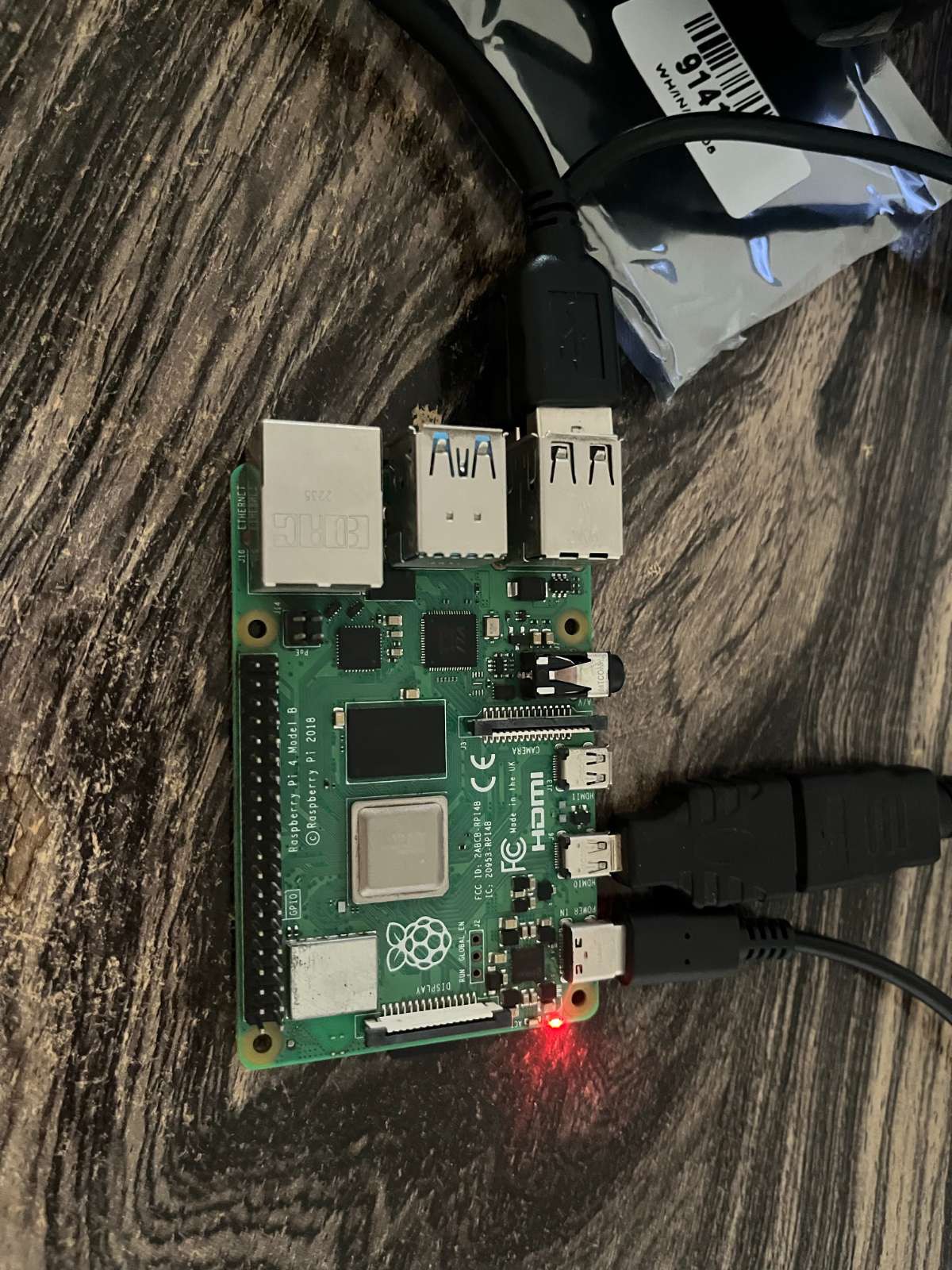

    Prepare the Hardware
    Gather all required components:
    • Raspberry Pi 4
    • MicroSD Card with Raspberry Pi OS
    • Camera Module
    • Electronic Solenoid Lock
    • Relay Module
    • Power Supply
    • Jumper Wires
    • Locker Enclosure
    Install Raspberry Pi OS on the microSD card and complete the initial setup.

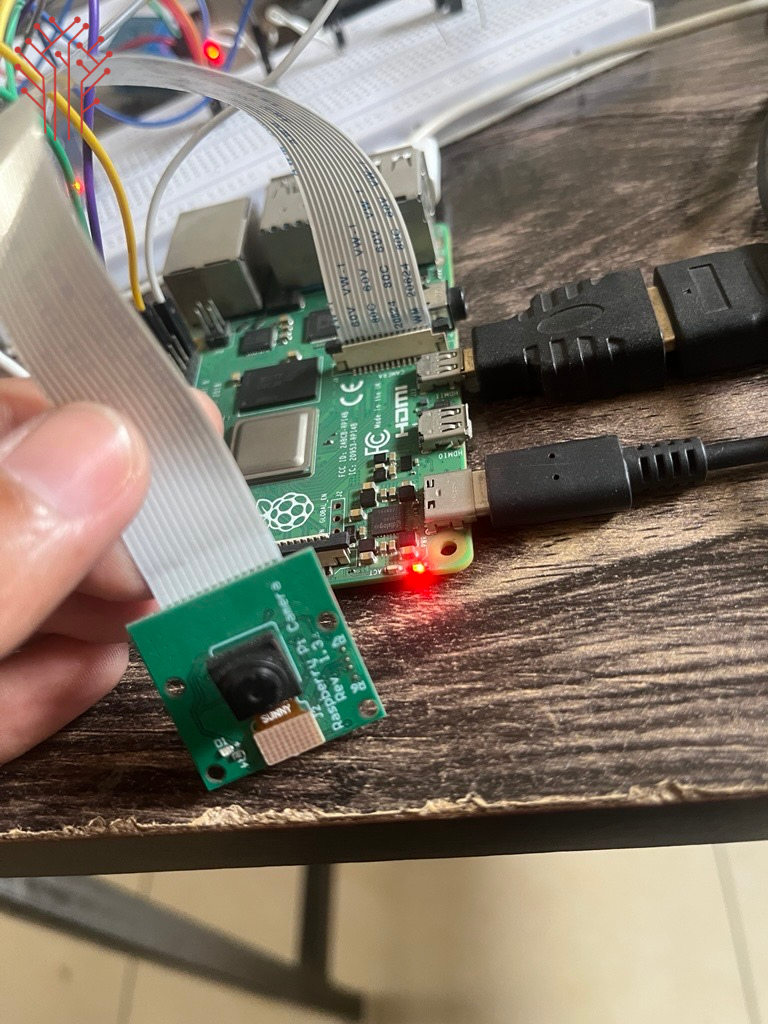

    Connect the Camera Module
    Power off the Raspberry Pi and connect the camera module using the CSI ribbon cable.
    Enable the camera interface:
    sudo raspi-config
    Navigate to:
    Interface Options → Camera → Enable
    Reboot the Raspberry Pi.
