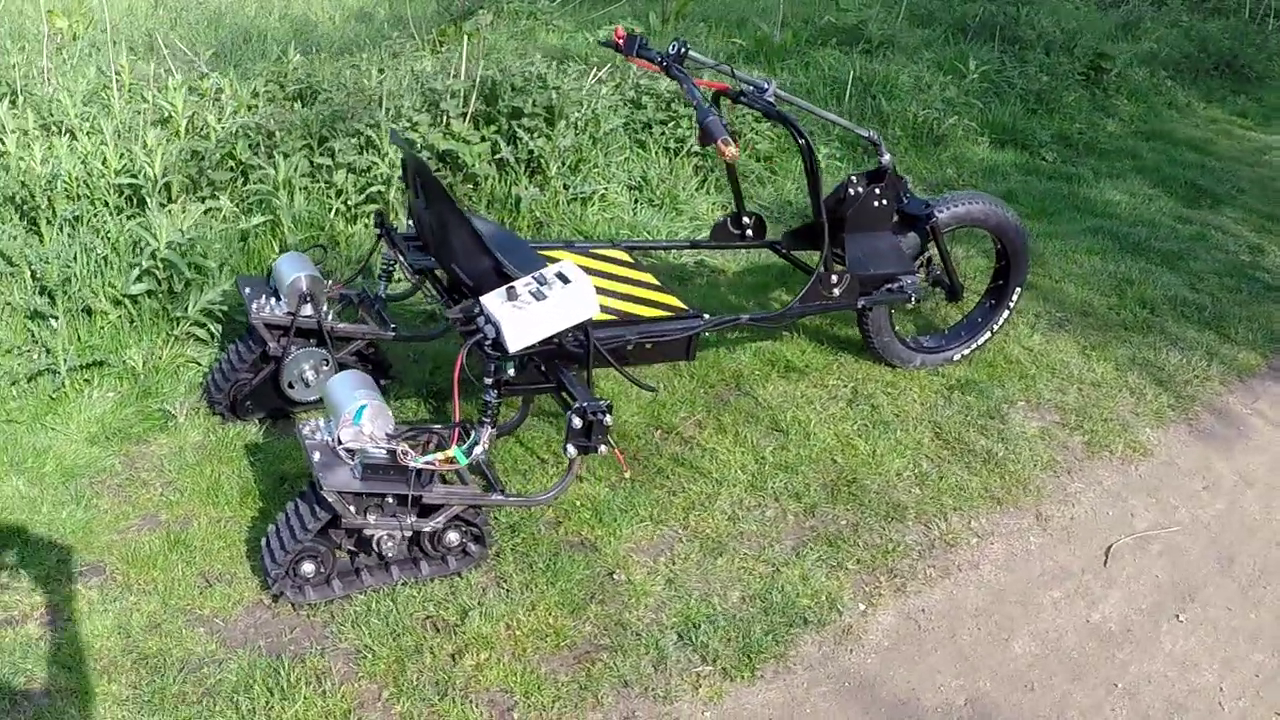

This is TrakTrike. An electriclly powered, dual track driven trike I created fpr EMF camp 2022. But it has a problem. The VSEC75100 clone electronic speed controllers I chose keep dying. I've destroyed 2 pairs since I started this project and at ~£80 each it's a bit expensive.

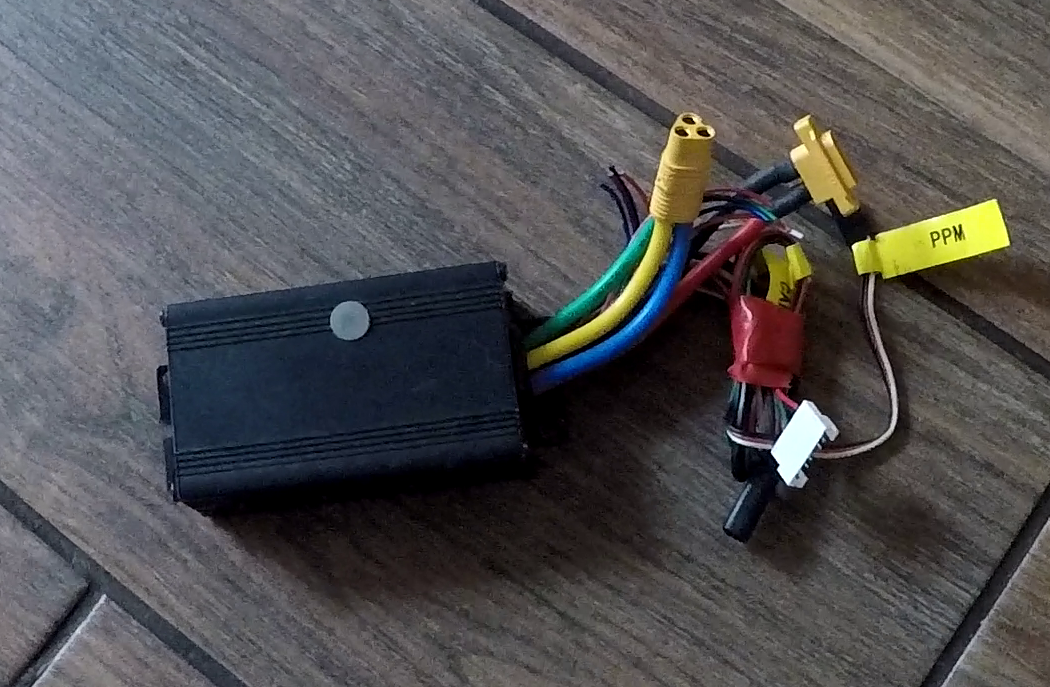

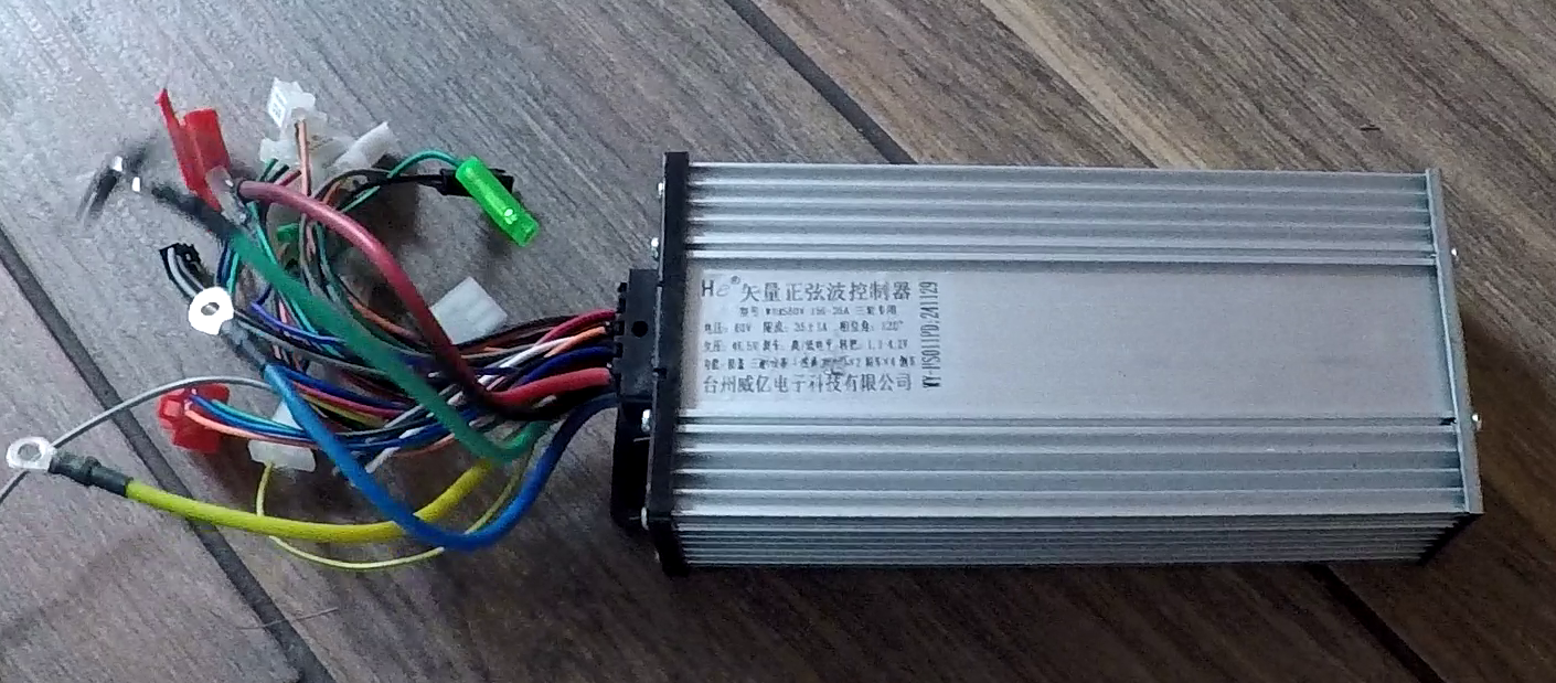

I took their advice and got these:
A cheap BLDC motor controller
But I discovered a couple of problems. First, the low-speed control was terrible. Small throttle movements produced no response, followed by an abrupt surge once the motors finally overcame static friction. Precise manoeuvring became difficult and sometimes unsafe.
Second, I split the throttle to connect to both controllers. Since each controller has slightly different throttle characteristics, identical throttle voltages don't produce identical motor speeds. The result is the vehicle constantly pulling to one side.
These controllers are not really designed for dual motor systems.......
So I decided to try and fix it....

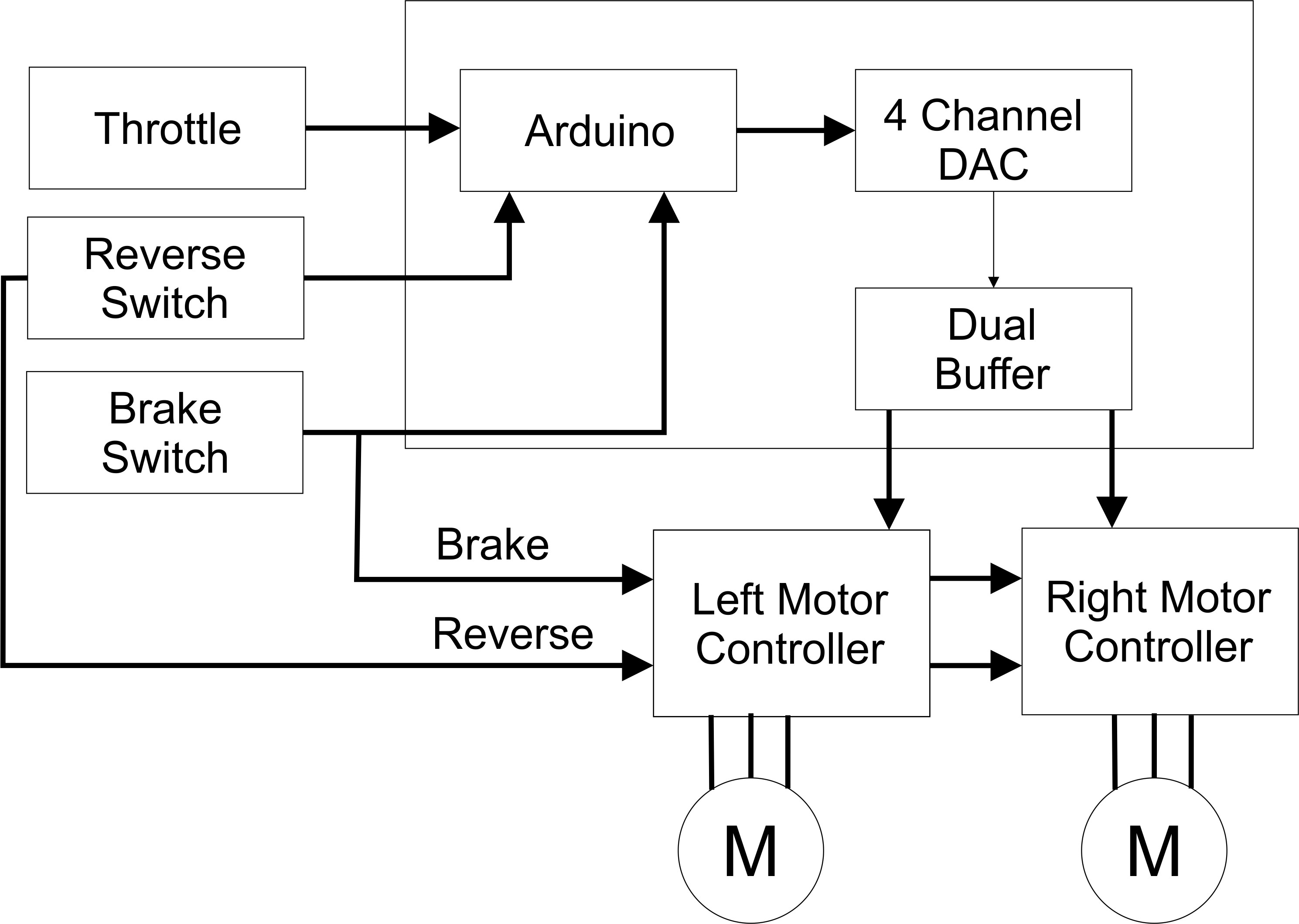

I wanted to place a throttle profiler inbetween the twist throttle and the motor controllers. I will dictate in software what the motor controller throttle inputs see!
The architecture is:

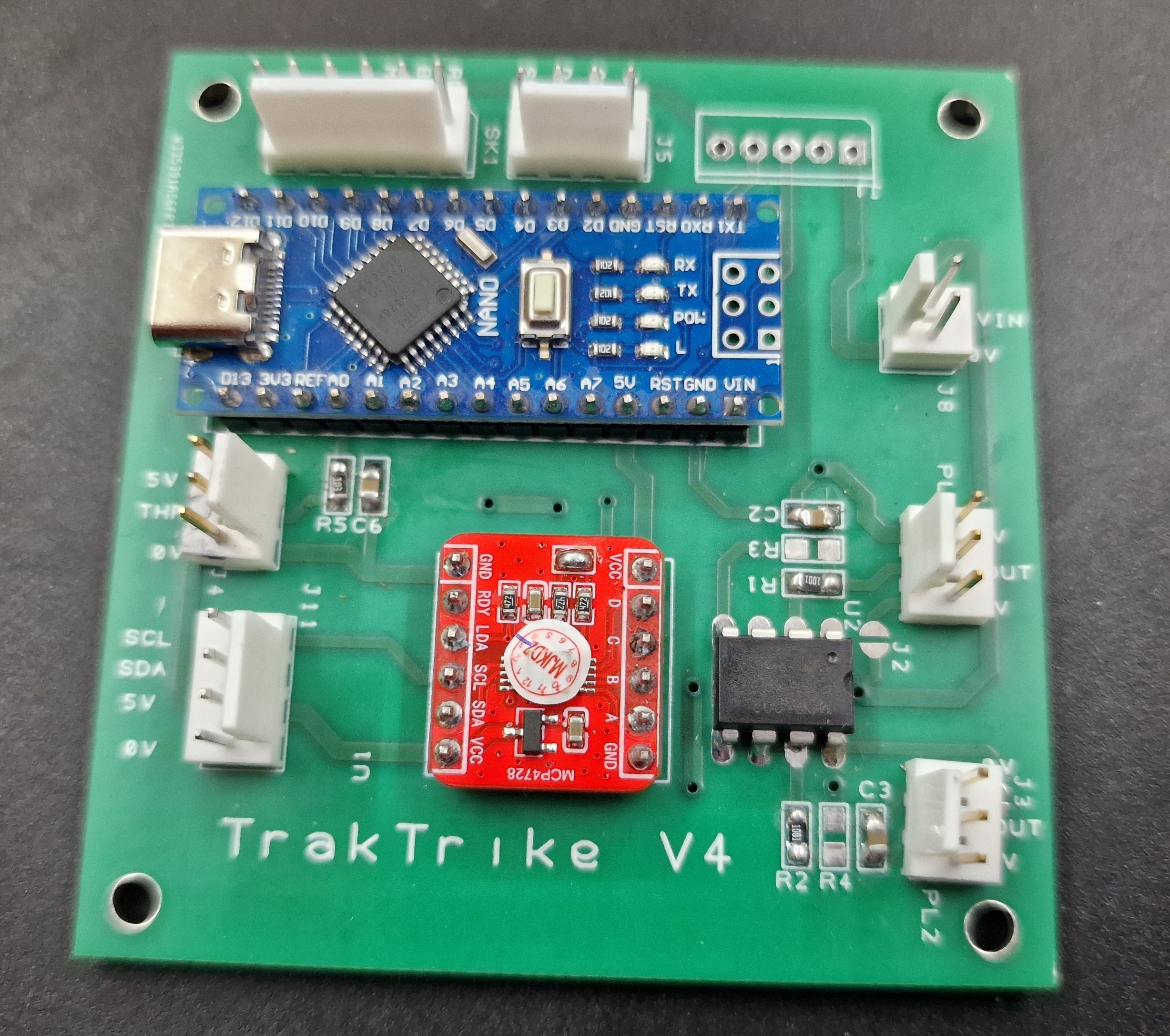

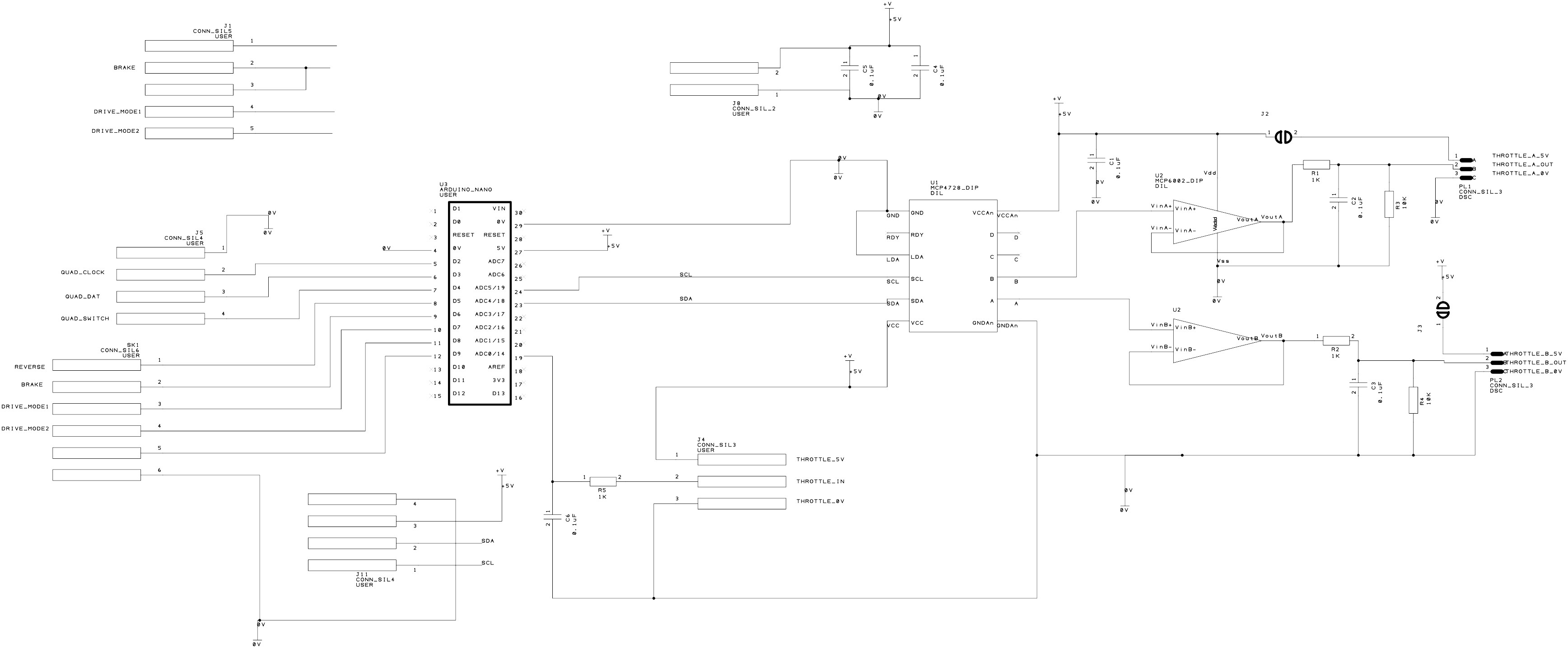

The control circuit has the following components
Arduino Nano. There is a bit of floating point math, but nothing the nano can't handle
A MCP4728 12 bit DAC module. This is readily available from Aliexpress and comes in a DIP package
A MCP6002 op-amp. This works as a rail to rail voltage follower to isolate the DAC from odd input impedances of the controller.
A I2C LCD display.
Ports for brake and reverse switches
A simple mode change button.
The schematic is:

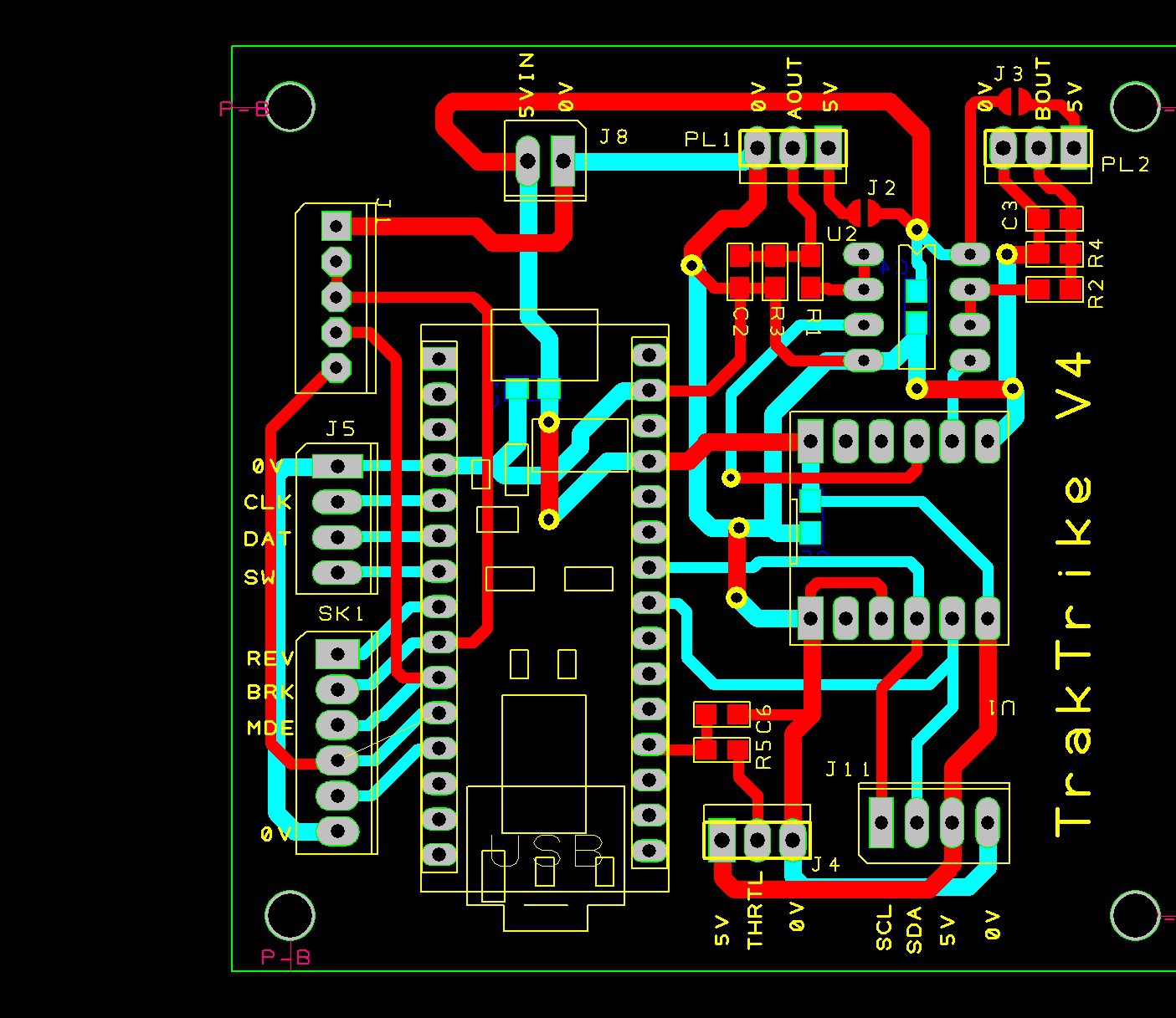

And the PCB design:

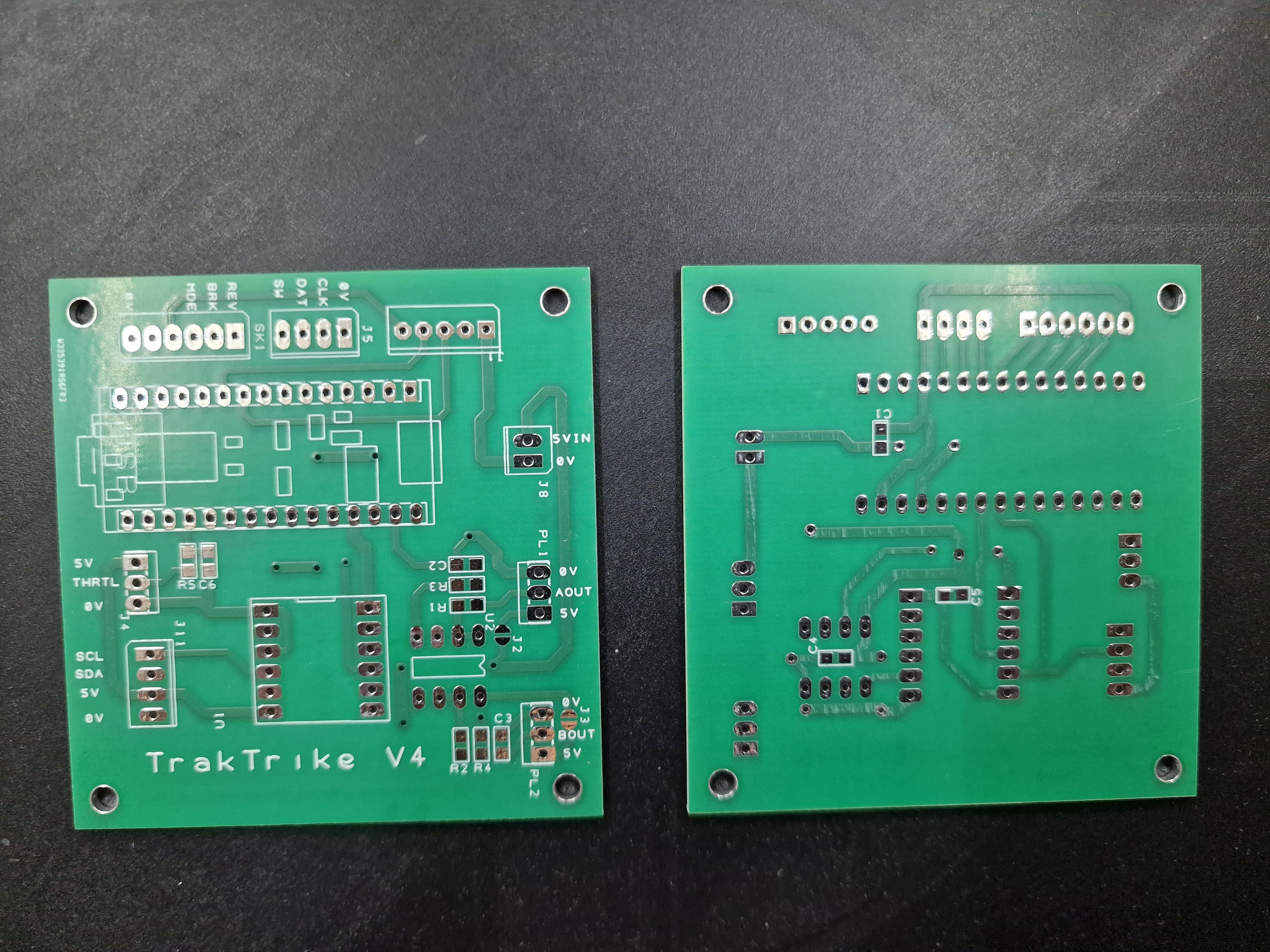

I normally CNC route my PCBs, but PCBWay kindly offered to sponsor its manufacture. The PCBs arrived within about a week of ordering and I was really pleased with the quality of the boards. The fact that the order contains 5 copies means that I can use IC sockets for the protoype and solder the ICs in for the produciton boards and have a few spares. Thanks to PCB way for sponsoring these!
If you want to get a copy oif these the files are at PCBWay.
Really happy with the PCBs.
A populated production board
