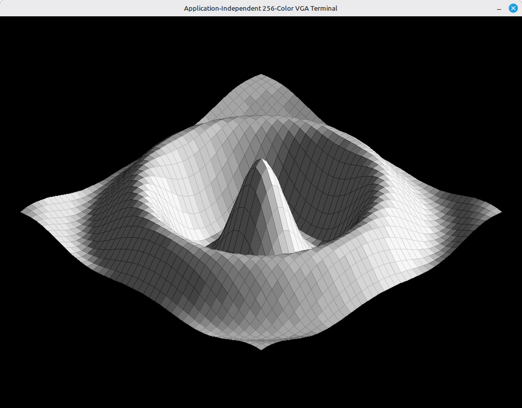

Using Python 3 with the pygame and pyserial libraries, you can completely bypass X11 complexity on Linux Mint. Pygame acts as a lightweight wrapper over X-Windows, handling all the frustrating OS window management in the background. This approach gives you total freedom to emulate the classic Tektronix !INK, !VEC, and !GRA codes, while making it easy to add your own custom extensions (like !SPRITE or !SOUND).
I asked Google AI to write me code to demonstrate all this. And like my X-Windows exploration project, have a program sending graphics commands to draw a 3-d surface with hidden-face removal and brightness controlled by the angle of an illumination source. This is known as 'the sun vector normal'. The commands are sent through virtual communications links.

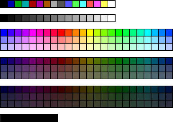

As usual, AI needed cajoling into providing what I wanted. The first attempt used an EGA/CGA font of 16 colours, which is 8 colours in light and dark. EGA and CGA were short lived standards, quickly replaced by VGA. The VGA's programmable palette has 256 entries, with a default palette that looks like this:
The program then ran with a limited number of colours and brightness, because it was difficult to translate colour and brightness onto a limited palette like this. So I asked for just a grey-scale rendering, with a minimum dark level to avoid unlit facets disappearing into the black background. Here is the result.
I feel this is a satisfactory proof of concept.
