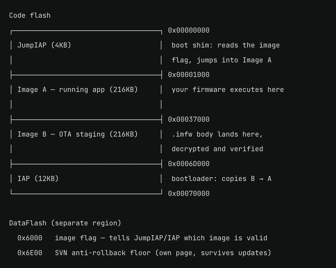

The push protocol is a short command sequence over an authenticated GATT session: an info handshake, an erase of the staging image, the header, a stream of 240-byte data chunks, and an end command. The device uses an A/B flash layout — the running firmware (Image A, 216KB) is never touched during transfer; everything lands in Image B.
The ordering of checks is deliberate:
The header is judged first, before a single firmware byte is transferred. Format version, hardware ID, ECDSA signature, and the SVN against the device’s persisted floor. A forged, mismatched, or rollback package dies in the first second, not after a two-minute transfer. Each failure returns a distinct error code — signature invalid, version rollback, bad format, low battery — because “update failed” with no reason is how you end up unable to debug field reports.
The body is decrypted and hashed in flight. The device streams AES-CTR decryption and a running SHA-256 as chunks arrive, writing plaintext to Image B as it goes. There’s no “download, then verify” phase for a simple reason: the image is 216KB and the chip has 26KB of RAM. Everything on this device is streaming or it doesn’t happen.
The end command verifies what’s actually in flash. Not the bytes we received — the bytes that landed. The device reads Image B back and compares the SHA-256 against the header’s value, catching flash write errors as well as transfer corruption. Only after that match does it set the image flag that tells the bootloader to copy B over A on the next boot.
An interrupted or failed update at any stage leaves Image A untouched and the flag unset. The worst case of a botched OTA is a wasted minute and roughly 0.2% of the battery — not a bricked key. The device also hard-refuses to start an update below 5% battery, independent of the app’s own softer 30% gate: the app gate is UX, the firmware gate is the safety boundary.

The board exposes serial flashing test points. Over those you can write your own firmware image directly — including your own OTA public key, generated with the same generate_ota_keys.py tooling we use. From that point on the official companion apps will happily push .imfw packages you built and signed: the device verifies them against your key instead of ours, and the whole pipeline — header checks, streaming decrypt, SVN floor, flash readback — works exactly as described above, just under your ownership.
For anyone going down that road, here’s the flash map your firmware has to live in:
A sealed update path and a hackable device are not in conflict. The signature check keeps firmware we didn’t sign from arriving silently over the air; the test points keep the hardware yours.
