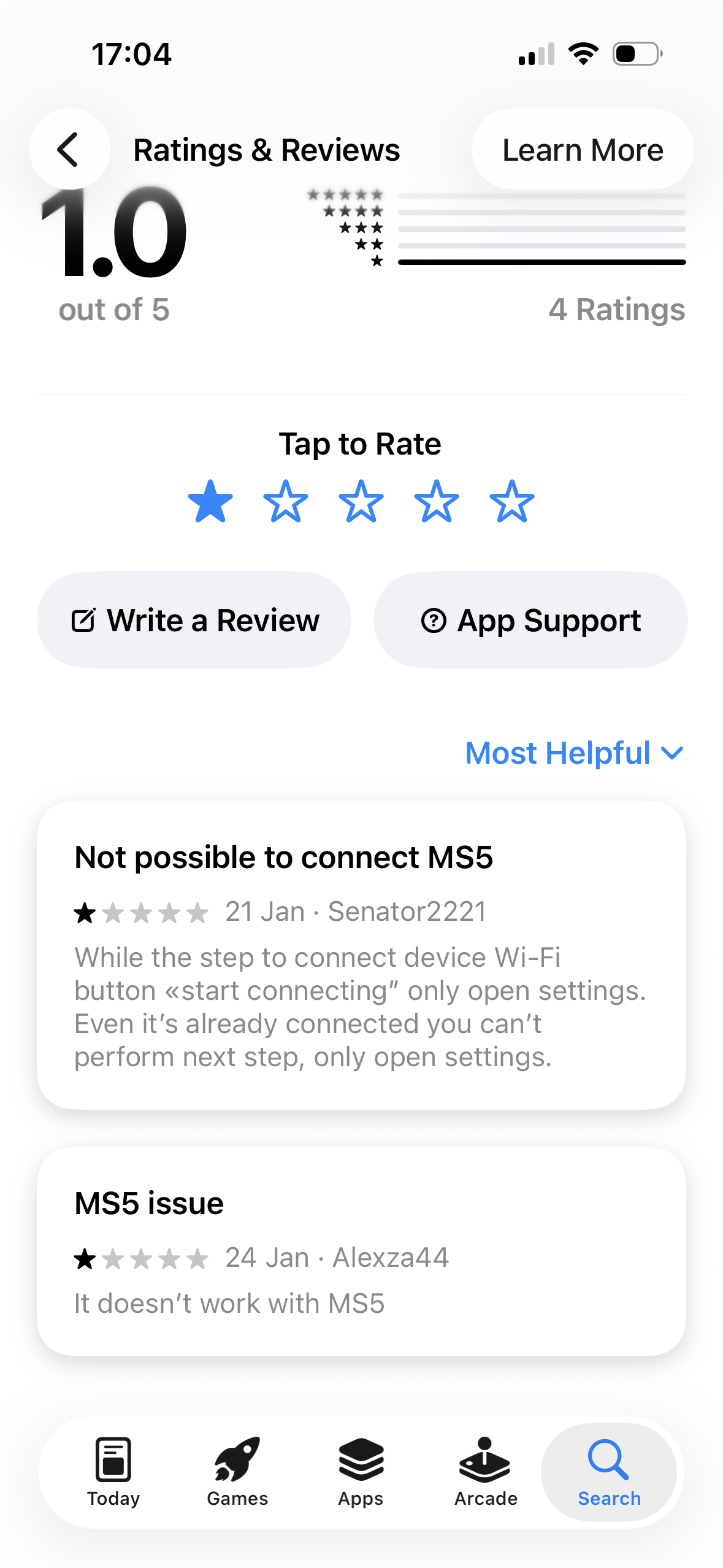

The official DLscope app for the MS5 WiFi microscope worked fine when I bought it — then a vendor
update broke it so badly it can't even detect the camera's WiFi anymore, confirmed by a wave of
1-star App Store reviews. Instead of waiting on a fix that might never come, I reverse-engineered

I'm on iOS, and when I first bought the camera, the official app — DLscope — actually worked. At
some point since then, an update broke it completely. Not "slow," not "laggy" — it doesn't even
see the camera anymore.
 You join the microscope's WiFi network, open the app, and it just sits
there as if nothing is connected. Check the App Store listing today and it's sitting at 1 star,
with reviews saying exactly that: the app doesn't detect the camera's WiFi at all anymore. So this
wasn't a fringe problem on my one unit — the vendor shipped an update that broke the product for
everyone still using it.

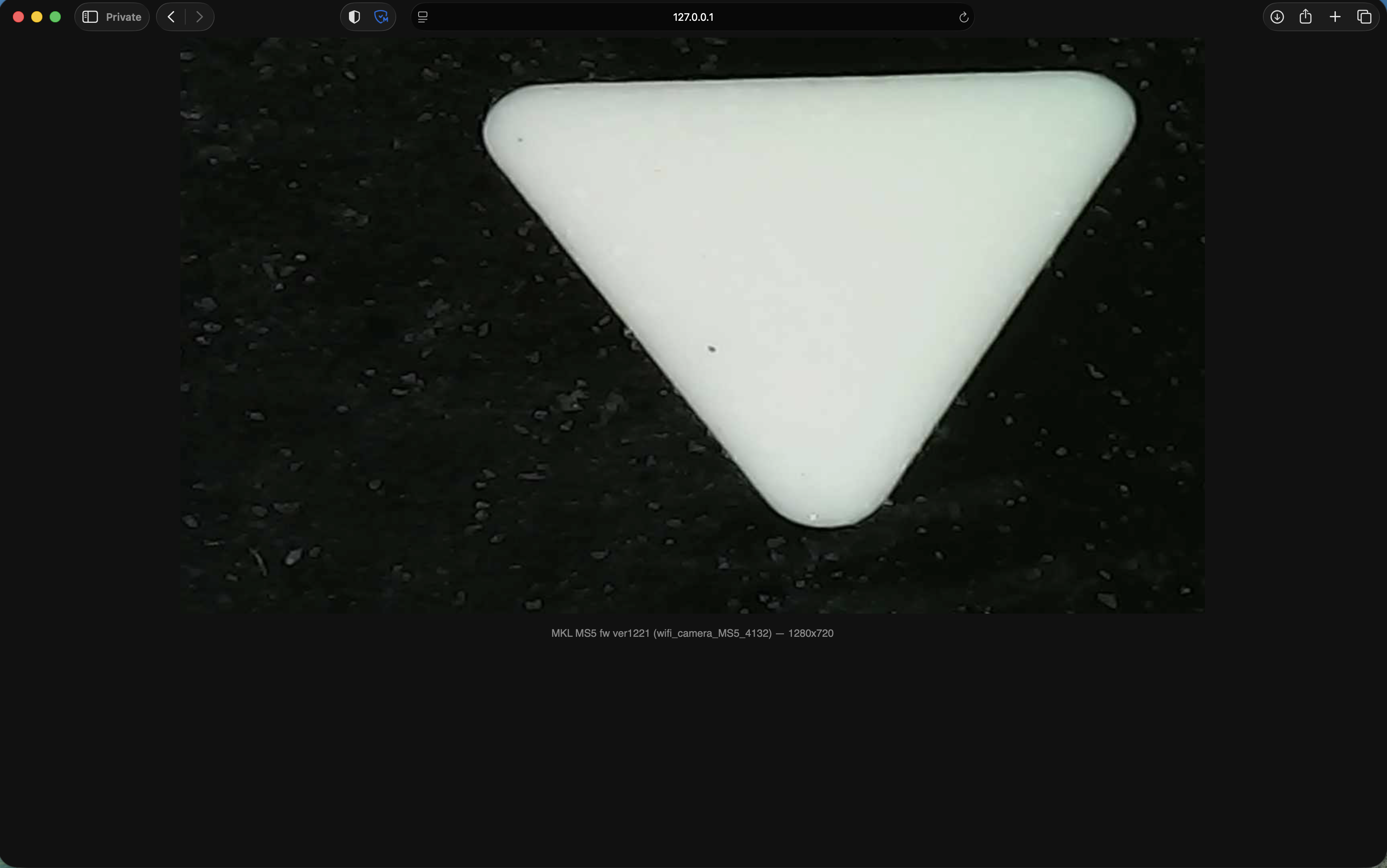

    With frames flowing, the rest came together as ms5_viewer.py: a small pure-Python-stdlib server
    that does the WiFi handshake, reassembles the JPEG stream, and re-serves it over HTTP so any
    browser, VLC, ffplay, or OBS can watch it. No installs, no dependencies, fully offline. Result:
    1280×720 at ~25–30 fps — roughly 10× the official app, on the exact same hardware.

    First proof it applied to the MS5: sending a raw GetDeviceInfo request to UDP :10005 got a real
    reply, identifying the camera as vendor MKL, product MS5, firmware ver1221. The camera was
    alive and speaking this exact protocol — the earlier "dead device" reading from the bad pcap was
    simply wrong.

    The answer came from disassembling proOpenVideo itself (arm64) inside libWifiCamera.so: the
    client is expected to announce its own UDP receive port inside the OpenVideo request — bind an
    ephemeral port, read it back, and send those two bytes as the payload. Skip that step and the
    camera acks happily and then has, quite literally, nowhere to send the video. It's not documented
    anywhere; it only shows up by reading the code that builds the request. That one detail is what the
    whole project hinged on.
    Sending OpenVideo with the port produced an immediate 1280×720 MJPEG stream. The first reassembler
    had a bug — it grouped chunks by the wrong byte — but once frames were grouped correctly, whole
    valid JPEGs came out the other end.
