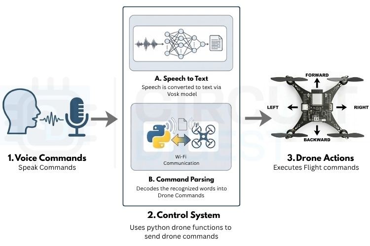

System Architecture
The overall workflow is straightforward:
- A microphone captures the user's speech.
- The ESP32 preprocesses the incoming audio.
- LiteWing performs keyword recognition locally.
- The recognized command is mapped to a flight action.
- The command is transmitted to the flight controller.
- The drone executes the requested maneuver.
Because inference runs entirely on the ESP32, there is no dependency on cloud APIs or external AI services.

Voice Recognition Pipeline
Audio captured by the microphone is processed in several stages before inference.
The incoming signal is sampled, filtered to reduce background noise, and converted into features suitable for machine-learning inference. LiteWing compares these features with its trained keyword model and outputs the most likely command.
Confidence thresholds help reduce false detections caused by ambient noise.
Running the model directly on the ESP32 minimizes latency while preserving user privacy because audio never leaves the device.

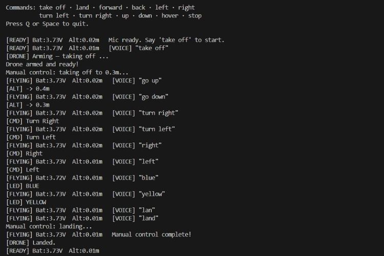

Testing
Testing began on the workbench using serial output to verify that spoken commands were recognized correctly.
After confidence levels were acceptable, command transmission to the flight controller was validated without spinning the motors.
Only after software verification was complete were low-altitude flight tests performed in a controlled environment.
Incremental testing significantly reduced debugging time and improved overall reliability.
