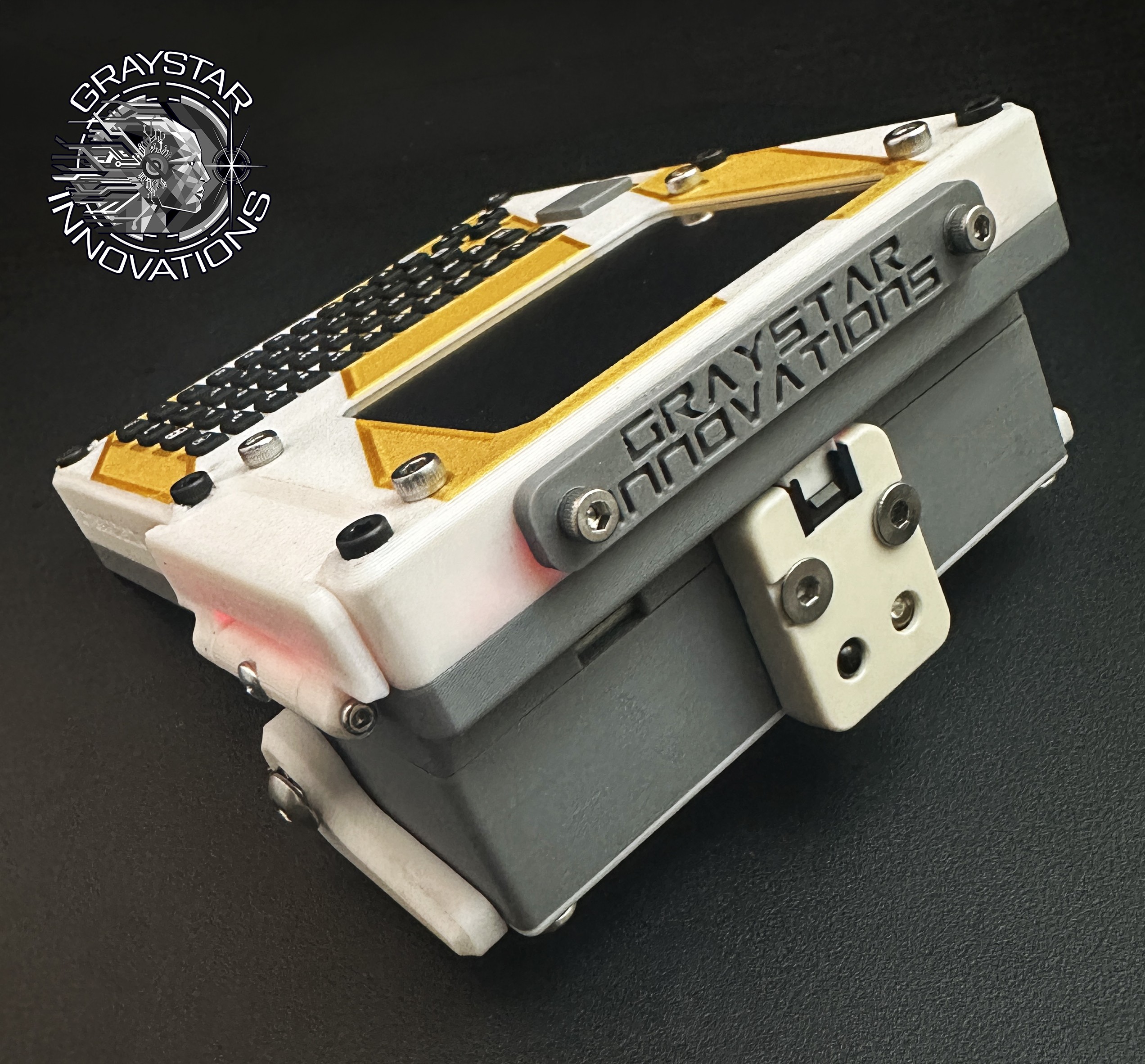

GSI.Cyberdeck//V1(Lite)
Multifunctional ESP32 Cyberdeck
This is a project I've been wanting to finish for a while, a fully customizable cyberdeck I can offer as a DIY tutorial for my youtube page you can build yourself using off-the-shelf components! Based on the ESP32 microcontrollers and programed in arduino.
Features:
-Digital clock with NTP time sync — automatic on WiFi connect
-Speed Test: Measures upload and download speeds via wifi
-SD Card Browser -Notes / Data log: Write and save notes to SD card
-WiFi Scanner — Scan of nearby networks showing SSID
-BLE Scanner — Scans for nearby bluetooth devices
-Serial Terminal — full-duplex UART terminal Games:
-Snake -Game of Life (Conway's cellular automaton)
-Dice Roller (d4, d6, d8, d10, d12, d20 with animated roll)
-Tetris
Tools:
-BT Keyboard: turns the cyberdeck into a Bluetooth keyboard, can control any bluetooth enabled device
-Calculator -Unit Converter: convert between common measurement units
-QR Generator: text or WiFi credentials as a QR code on screen
-Compass: live magnetometer compass with animated analog display
-Radar — WiFi motion detector radar, uses wifi connection to detect nearby movement
-Password Vault: encrypted password storage
Stopwatch
-IR Blaster/Receiver — capture IR remote codes and use the cyberdeck as a universal remote for IR devices (such as televisions)
-Calendar/Agenda
-Altitude Tracker
-Waypoint Navigator — enter latitude and longitude coordinates, compass will point to the destination, no GPS needed
-Environmental/weather status page - uses built in sensors to display local temperature, altitude, air pressure, etc
-customizable color theme editor
- Multiple cyberpunk-themed Screensavers (5 styles)
This is the first prototype, so there may be some slight changes to the final version shown in the tutorial.
The tutorial will go up on www.youtube.com/@graystarinnovations soon! See less

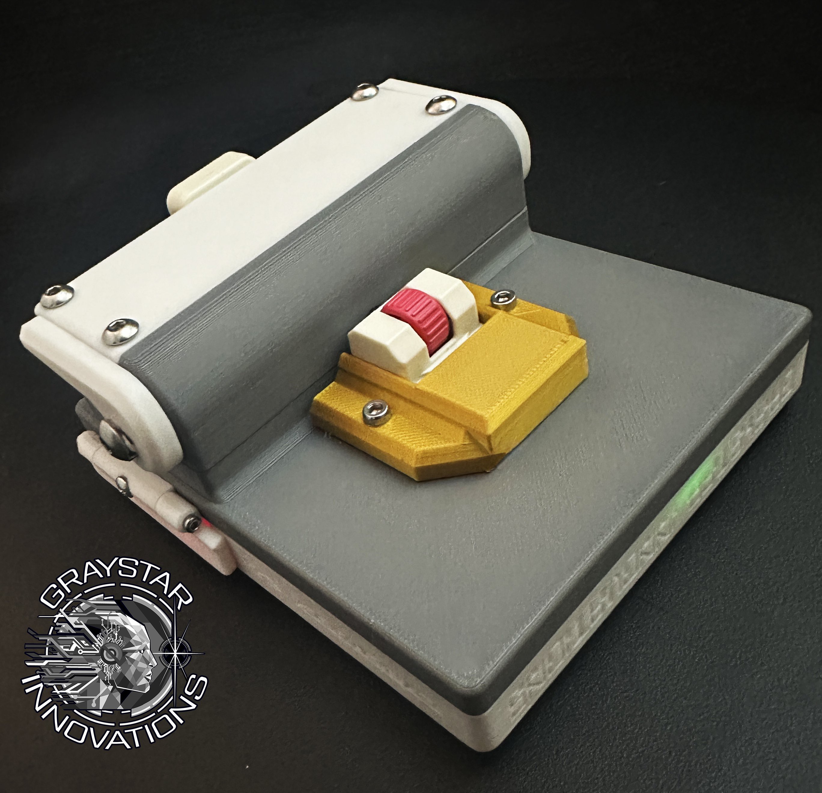

  • Multiple faceplate styles!
    Ian Maday • 07/28/2026 at 00:14 • 0 comments
    More faceplate designs have been added, so 3 designs + 1 regular/plain with
    'no design" for 4 different options for aesthetic.

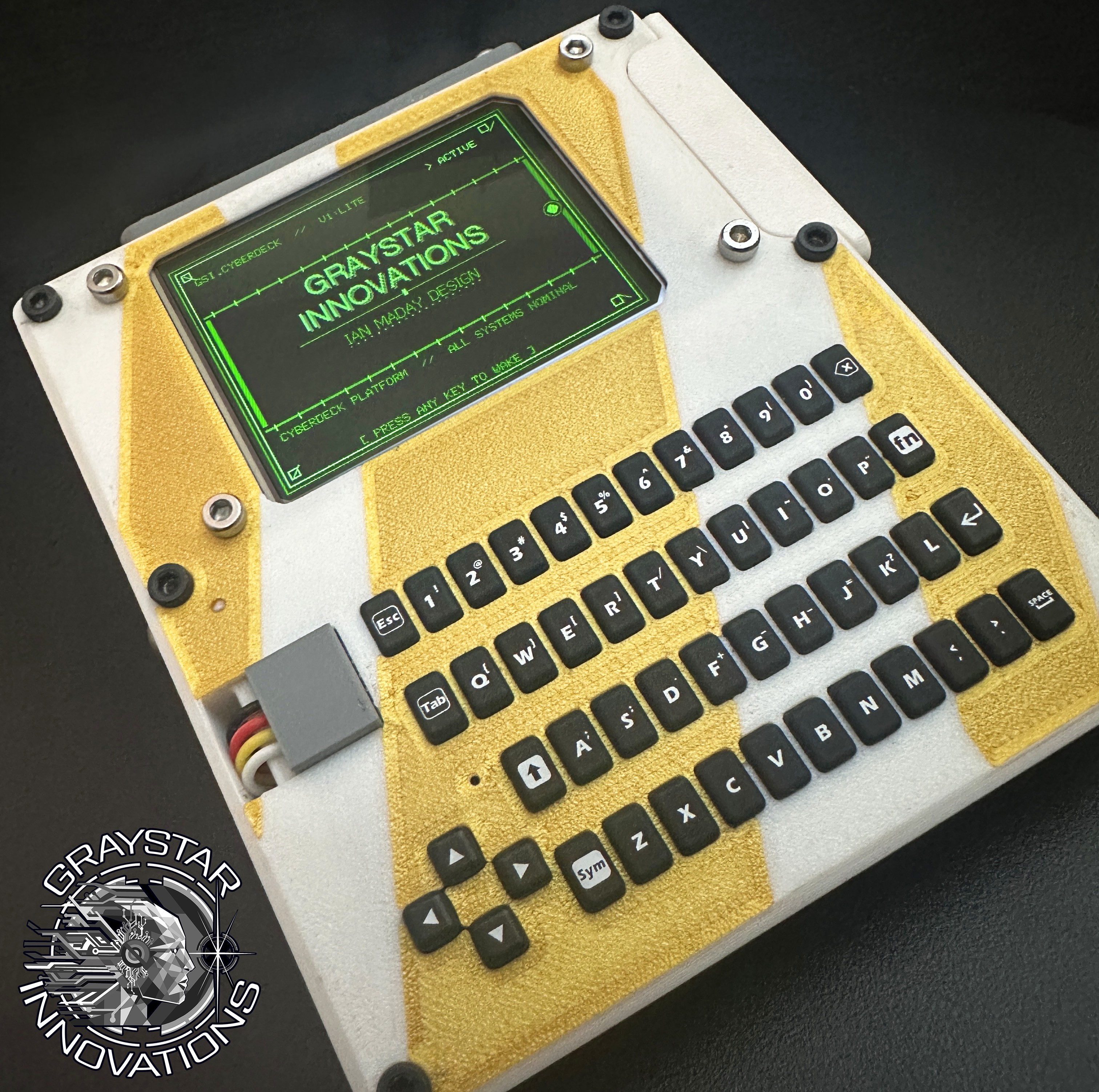

  • A few minor tweaks and additions to the cyberdeck
    Ian Maday • 07/25/2026 at 21:01 • 0 comments
    Added a lot more features and tools, and finalized the design a little more! Full feature list:

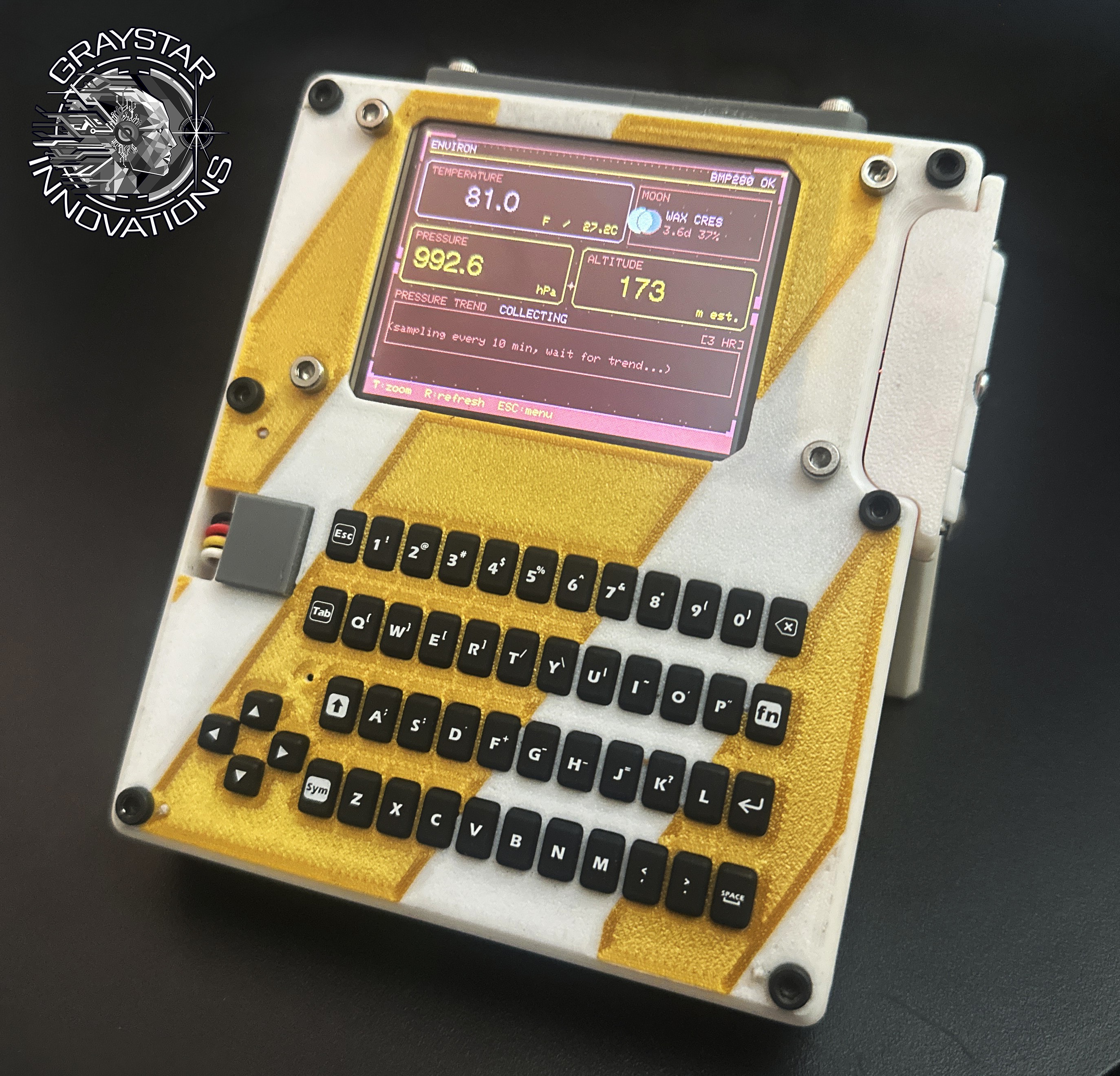

    Environment
    - Temperature & Pressure Monitor — live BMP280 sensor readings
    - Pressure Trend Chart — 1hr / 3hr / 24hr barometric history
    - Weather & 5-Day Forecast — OpenWeatherMap integration

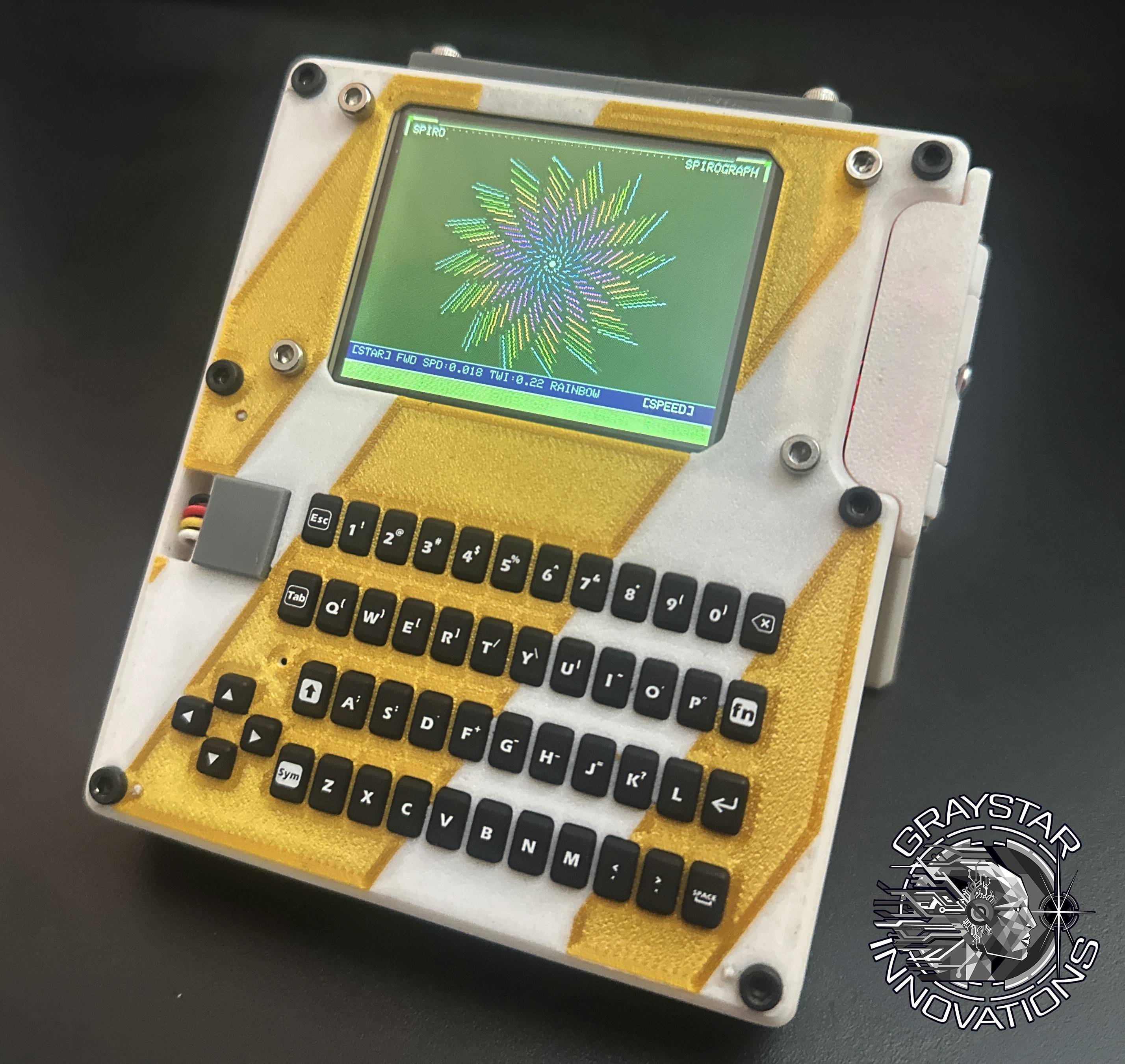

    Creative
    - Spirograph — 13 pattern modes with adjustable geometry and colour
    - Lava Lamp — real-time metaball simulation with physics controls
    - Pixel Art Canvas — 40×26 grid with 8-colour palette, saves to flash
