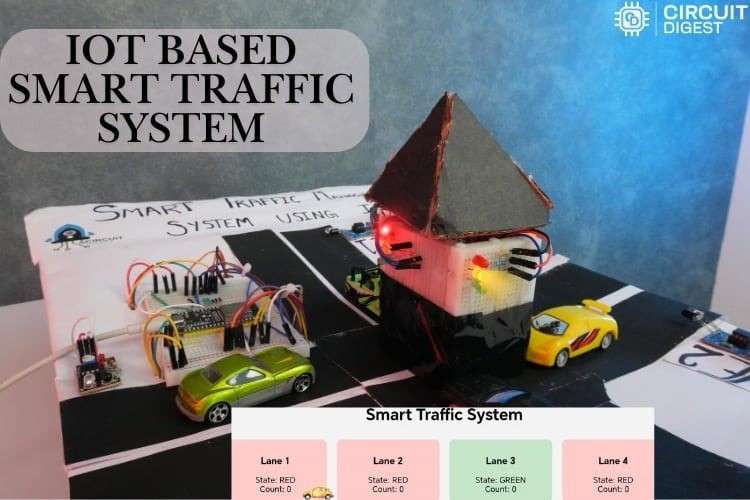

Urban intersections still rely heavily on fixed-cycle traffic lights—simple timers that rarely match real traffic demand. They waste fuel, worsen congestion, and sometimes create unsafe conditions when queues grow unexpectedly. This project replaces that old logic with an ESP32-powered adaptive traffic controller capable of real-time vehicle detection, dynamic signal control, and a built-in web dashboard for live monitoring.
This build uses four lanes, each equipped with IR vehicle-detection sensors and a set of Red/Yellow/Green LEDs acting as the signal heads. An ESP32 reads every sensor, decides which lane should receive priority, and exposes all activity on a browser-based dashboard hosted directly on the microcontroller.
Project Overview
The goal was to create a self-contained, IoT-enabled traffic management system that reacts to actual traffic density instead of rigid preset timing. By using inexpensive IR modules and a Wi-Fi-enabled ESP32, the system demonstrates how adaptive traffic logic can be achieved with very basic hardware.
Key Outcomes
✔ Real-time vehicle detection on all four lanes
✔ Dynamic signal timing based on lane congestion
✔ Preemption mode for giving priority to highly congested lanes
✔ Local web dashboard showing vehicle counts + current signal states
✔ Fully automated state cycling with safety delays and debouncing

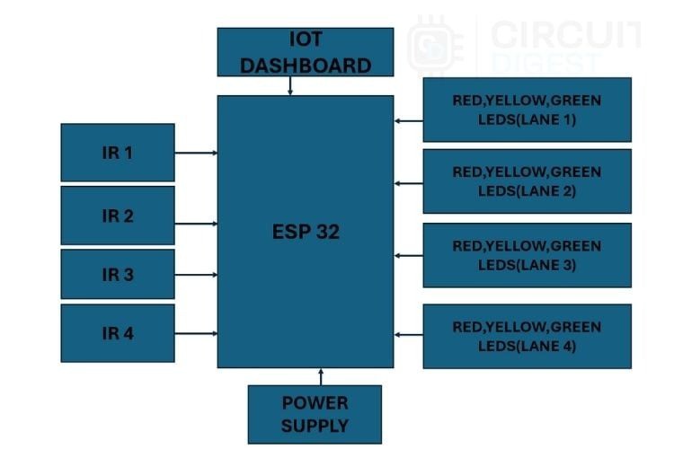

System Architecture
The ESP32 acts as a centralised controller for all sensing and actuation:
  1. Reads the IR sensor input from each lane.
  2. Counts vehicles only when a lane is red.
  3. Determines priority based on defined thresholds (e.g., ≥2 vehicles).
  4. Controls the LEDs for each lane’s signal state.
  5. Hosts a web interface showing:
    • Current signal colours
    • Vehicle counts per lane
    • Preemption/normal cycle mode
If no lane is congested, the controller cycles through the lights in a conventional round-robin pattern. Once congestion is detected, the controller triggers a safety delay and assigns green to the heavy lane.
