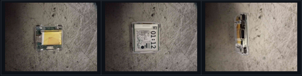

The next thing to think about were the buttons and the usb port. Based on the watchy experience I knew one thing: THT or it will break off. Maybe after a year, maybe after 5, but that was the only solution. I decided for a PCB of height 1mm, so that was also a limitation.
I ended up with Panasonic EVP-AKE31A, small buttons, not so loud as the watchy ones but most importantly, THT and the button body is fully enclosed. After soldering the a few times, overheating them, leaking flux into them and bathing them in acetone (Yes, it's not ABS I guess) they still work, less clicky, but survived everything, even my book reading or aggressive tetris/towerfall playthroughs :D
The USBC was harder (Yes, we need to switch to USBC for this, micro usb is not acceptable in this era), The only one was USB4730-GF-A-KIT with an acceptable height of the THT pins. It's on the bigger size, but that's a problem for the future me designing a case. There were already people switching it for another models, but I can't get myself to that, I only trust THT to survive.
A modified yatchy with another usbc port, that the THT pins needed to be cut off manually. The esp is without an integrated antenna because of the chip shortage. Credits go to Lukas from the DC server

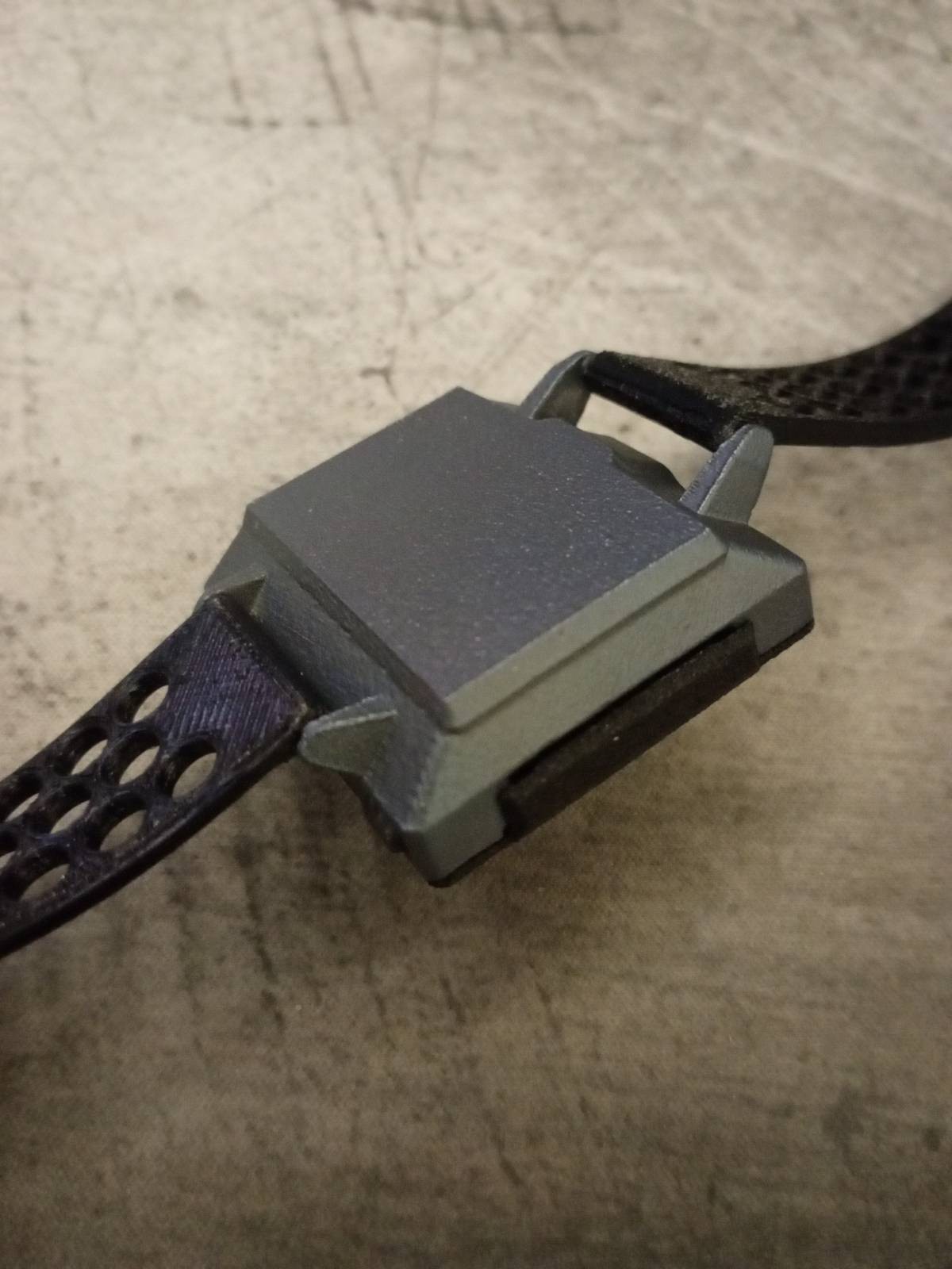

Cases
Yatchy is not a commercial product, so obviously 3D printing is the only option for a case. At this point, there are a lot of cases to choose from, they are listed here. Personally I ended up with the rotated case, because it's easier to plug in the cable for reprogramming the watch while it's on my hand.
After a lot of colors, different filaments I ended up ordering some cases online in various technologies. The review is here. I think I finally settled on the anodized titanium case with the nylon front. I also use a TPU 3D printed wrist strap.
Off topic: If you plan to anodize titanium, learn the chemistry safety rules and just do it with try and error, starting with low voltages. The few guides online can be more confusing then they are worth.
The transparent case is also something to look for, sadly it gets yellow after some time
