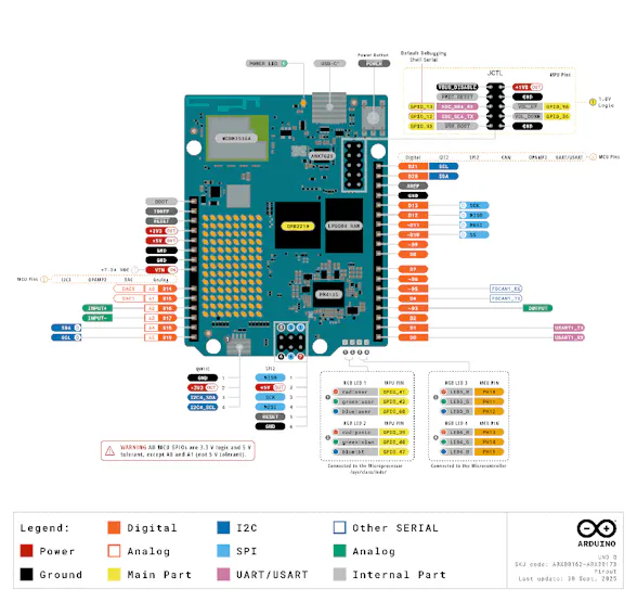

    First, I collected the electrical components I needed to achieve the mini-figurine cataloger rig features I envisioned and defined the UNO Q-component pin connections. Since UNO Q has the exact same pinout as the usual Arduino Uno, declaring pin connections was quite straightforward.

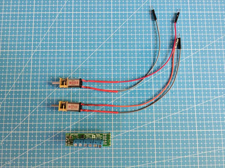

    I specifically selected the Pololu DRV8835 dual motor driver shield to control two micro metal gearmotors (also from Pololu) since this shield is tailored to the Arduino Uno.
    // Connections
    // Arduino UNO Q :
    //                                Pololu DRV8835 Dual Motor Driver Shield
    // D9      ------------------------ Motor_1 [Speed]
    // D7      ------------------------ Motor_1 [Direction]
    // D10     ------------------------ Motor_2 [Speed]
    // D8      ------------------------ Motor_2 [Direction]
    //                                TCRT5000 Infrared Sensor Module [First]
    // GND     ------------------------ GND
    // 5V      ------------------------ VCC
    // A2      ------------------------ OUT
    //                                TCRT5000 Infrared Sensor Module [Second]
    // A3      ------------------------ OUT
    //                                Grove - Electromagnet (5V)
    // D12     ------------------------ SIG
    //                                Grove - WS2813 RGB LED Strip (Waterproof - 60 LED)
    // D11     ------------------------ Data
    //                                Analog Joystick
    // 5V      ------------------------ +5V
    // A4      ------------------------ VRX
    // A5      ------------------------ VRY
    // D2      ------------------------ SW
    //                                Control Button (A)
    // D3      ------------------------ +
    //                                Control Button (B)
    // D4      ------------------------ +
    //                                Control Button (C)
    // D5      ------------------------ +
    //                                Micro Switch with Pulley (KW10-Z5P)
    // D13     ------------------------ +

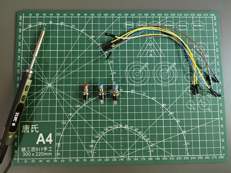

    #️⃣ Since the Pololu DRV8835 motor driver shield comes disassembled, I soldered its components to complete the PCB via my TS100 soldering iron. Also, I soldered male jumper wires to the Pololu micro gearmotors to be able to connect them easily to the dedicated screw terminal blocks on the shield.

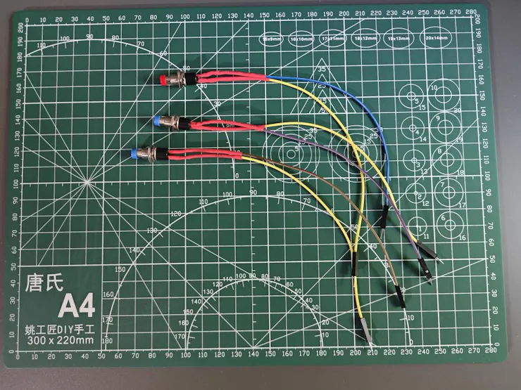

    #️⃣ To connect the IC-177 push buttons to the UNO Q, I also soldered male jumper wires. To insulate all wire connections, I utilized heat-shrink tubing.
    #️⃣ To provide stable 5V to gearmotors through the driver shield, the Grove electromagnet, and the Grove WS2813 RGB LED strip, I employed an external 5V / 4.0A switching power supply with a DC jack. To make this external power supply breadboard-friendly, I utilized a female DC-barrel-to-wire jack, splitting positive (5V) and ground (GND) wire lines.

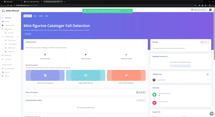

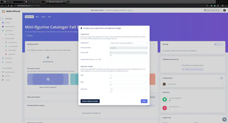

    #️⃣ First, I signed in to my Arduino account on the Arduino App Lab, which is required to deploy and run EI models on the App Lab through the provided Bricks, in this case, the Audio Classification Brick.
    #️⃣ Then, I created a new project on my Edge Impulse Enterprise account and selected the target development board as Arduino UNO Q.

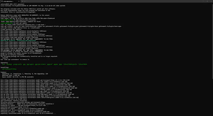

    #️⃣ Although there is a built-in pipeline to obtain trained Edge Impulse models, the App Lab does not let the user collect samples directly from Arduino UNO Q yet. Thus, I set up the Edge Impulse CLI on the UNO Q via the built-in App Lab terminal to be able to access video and audio streams produced by the Brio webcam on the Edge Impulse Studio.
    sudo apt updatecurl -sL https://deb.nodesource.com/setup_20.x | sudo bash -sudo apt install -y gcc g++ make build-essential nodejs sox gstreamer1.0-tools gstreamer1.0-plugins-good gstreamer1.0-plugins-base gstreamer1.0-plugins-base-appssudo npm install edge-impulse-linux -g --unsafe-per
    #️⃣ After setting up the Edge Impulse CLI, I connected to my Edge Impulse account, selected the associated project, assigned the Logitech Brio webcam's built-in microphone as the primary audio source, and name the device.
    edge-impulse-linux

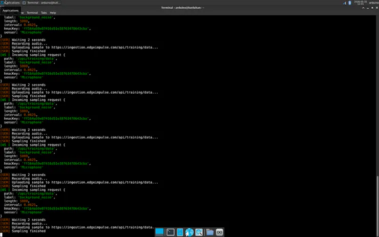

    #️⃣ Nonetheless, as I was trying to collect audio samples on the built-in App Lab terminal, I encountered some connection issues. Thus, I resumed collecting audio samples on the native terminal in the SBC mode.

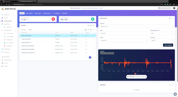

    #️⃣ After moving to the SBC mode, I was able to see the UNO Q on the Edge Impulse Studio without any connection errors and start collecting audio samples while providing labels and sample durations.

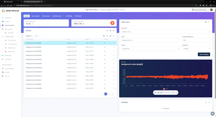

    #️⃣ Since the gearmotors driving the worm gear and the custom GT2 pulley work continuously while cataloging the target mini-figurines, I collected audio of gearmotors turning as the background noise (normal) samples. I chose the background noise sample duration as 5 seconds, as this state should be the norm for the neural network model.

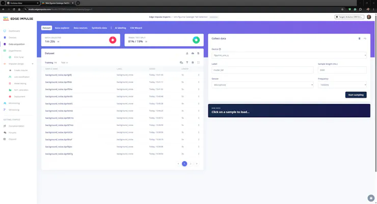

    #️⃣ Then, I collected audio of figurines falling at different angles and heights to construct an extensive dataset. I selected the sample duration as 2 seconds since the falling happens abruptly without many repetitions.
    After collecting training and testing audio samples for both labels, I completed my dataset for detecting figurine falls.

    To utilize the advanced AI tools provided by Edge Impulse, you can register here.
    For further information, you can inspect this audio classification model on Edge Impulse as a public project.
