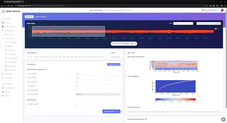

#️⃣ To modify the raw audio features in the applicable format, I navigated to the Impulse design ➡ MFE section and clicked Save parameters to apply default settings.
#️⃣ Then, I proceeded to click Generate features to extract the required features for training by applying the MFE signal processing block.

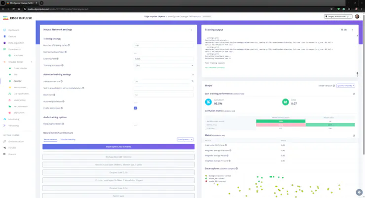

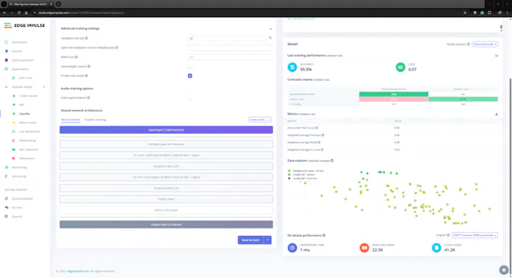

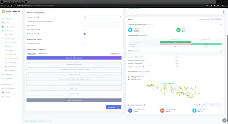

#️⃣ After extracting features successfully, I navigated to the Impulse design ➡ Classifier section and applied the default neural network settings and architecture to achieve reliable accuracy and validity.
#️⃣ After training the audio classification model, Edge Impulse evaluated the accuracy as 95.5%. This precision score, although really close to the final testing results, should be viewed as a narrow estimation due to the modest validation set.

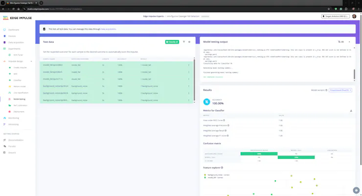

#️⃣ First, to obtain the validation score of the trained model based on the provided testing samples, I navigated to the Impulse design ➡ Model testing section and clicked Classify all.
#️⃣ After applying the trained model to the testing samples, Edge Impulse evaluated the model accuracy as 100.00%.

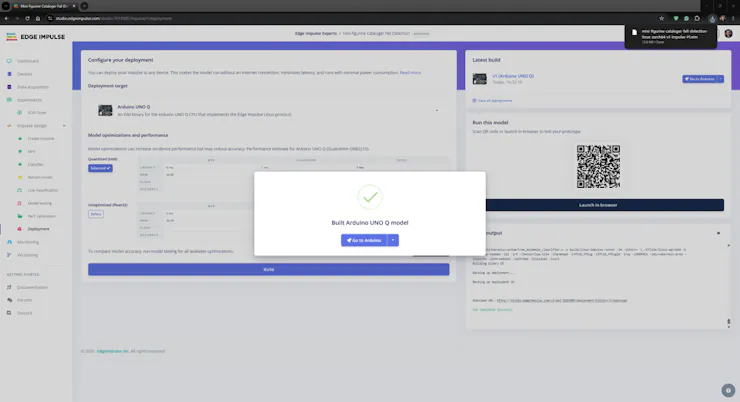

#️⃣ To deploy the validated model optimized for my hardware, I navigated to the Impulse design ➡ Deployment section and searched for UNO Q.
#️⃣ I chose the Quantized (int8) model variant (optimization) to achieve the optimal performance while running the deployed model.
#️⃣ Finally, I clicked Build to deploy the model. However, contrary to the usual deployment procedure, I did not utilize the downloaded EIM binary since the Arduino App Lab provides a pipeline to link Edge Impulse projects to import deployed models directly.
#️⃣ As mentioned in the previous steps, I had already signed in to my Arduino account on the Arduino App Lab. Thus, I only needed to click Go to Arduino and open the App Lab to link this Edge Impulse project to my Arduino account via the built-in pipeline.
#️⃣ After linking the project, I navigated to the Audio Classification Brick configurations, installed my audio classification model for detecting figurine falls, and selected it as the primary Brick model.
