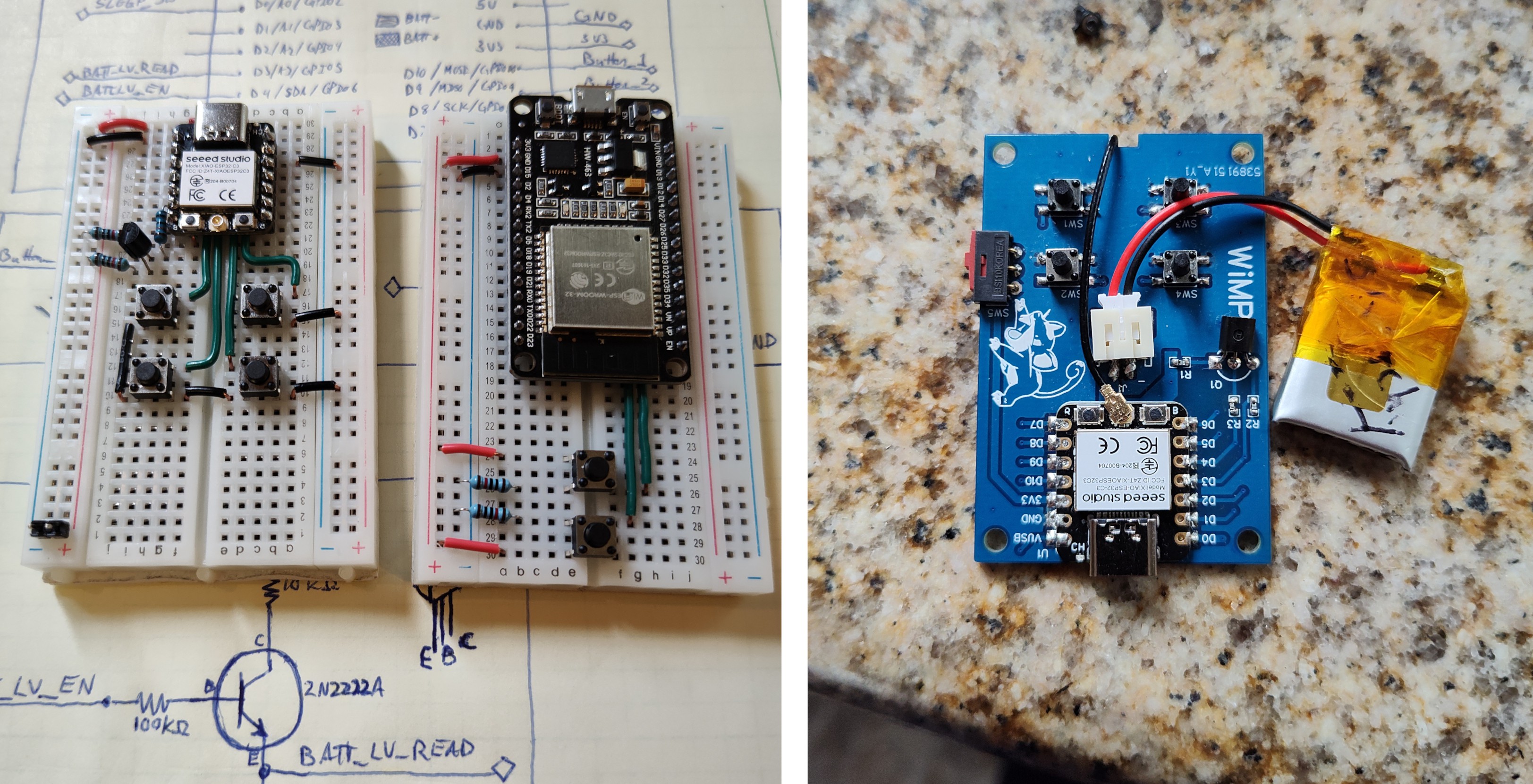

I found an inexpensive ESP32 dev board that seemed like a good fit.  I was able to get it running a Bluetooth server and updating a characteristic on button press, which was enough of a proof of concept to keep going.  At the time, I hadn't written any Bluetooth code in the apps yet, so I was relying on the nRF Connect app to see that my ESP32 code was working.
At this point I was able to move on to getting Bluetooth working on the Android app, completing the first functional prototype.  I also found the much smaller XIAO ESP32C3 and built a second prototype using that, and even put it on a PCB.
First Prototype
Original name idea was WiMP (Where is My Phone)
It functioned well enough, and I was thrilled to get something working, but it just wasn't good enough.  For starters, it used way too much power, even in sleep mode.  And I didn't like the idea of having to use a rechargeable battery.  Another issue was that it took far too long to wake up from sleep, causing it to feel unresponsive.  So I started looking for something more suited to my needs and came across Nordic's nRF52 series of chips.

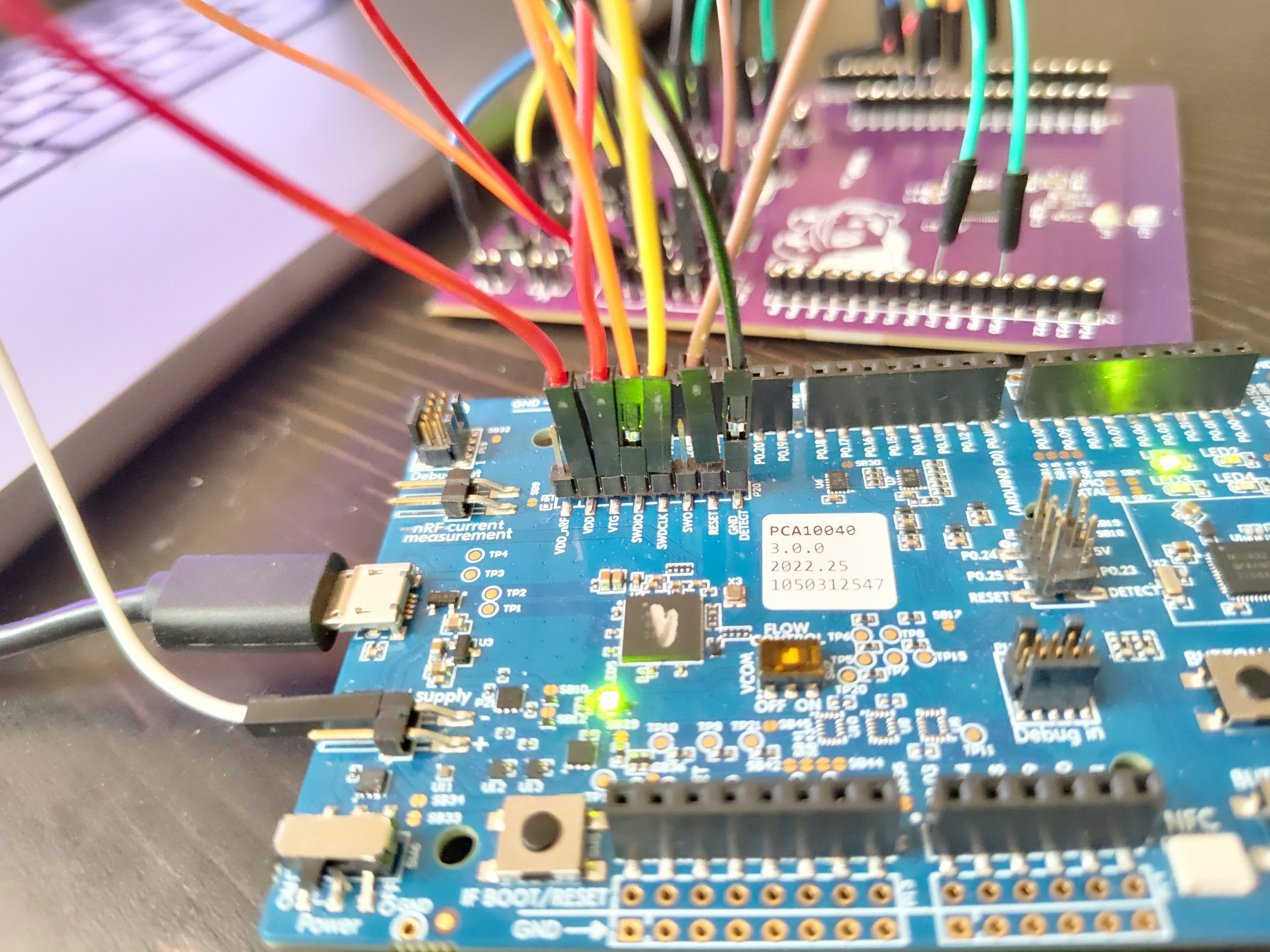

I decided on the nRF52810.  It solved all the issues I had with the previous design, including being able to run on a coin cell battery.  I ordered a new PCB for testing and got to work.  In order to program this new chip, I had to use the SEGGER IDE and wire it up to the nRF52 Dev Kit.  It was a bit of a pain learning all the new things that were required, but with some perseverance I was able to determine that it was the right choice.

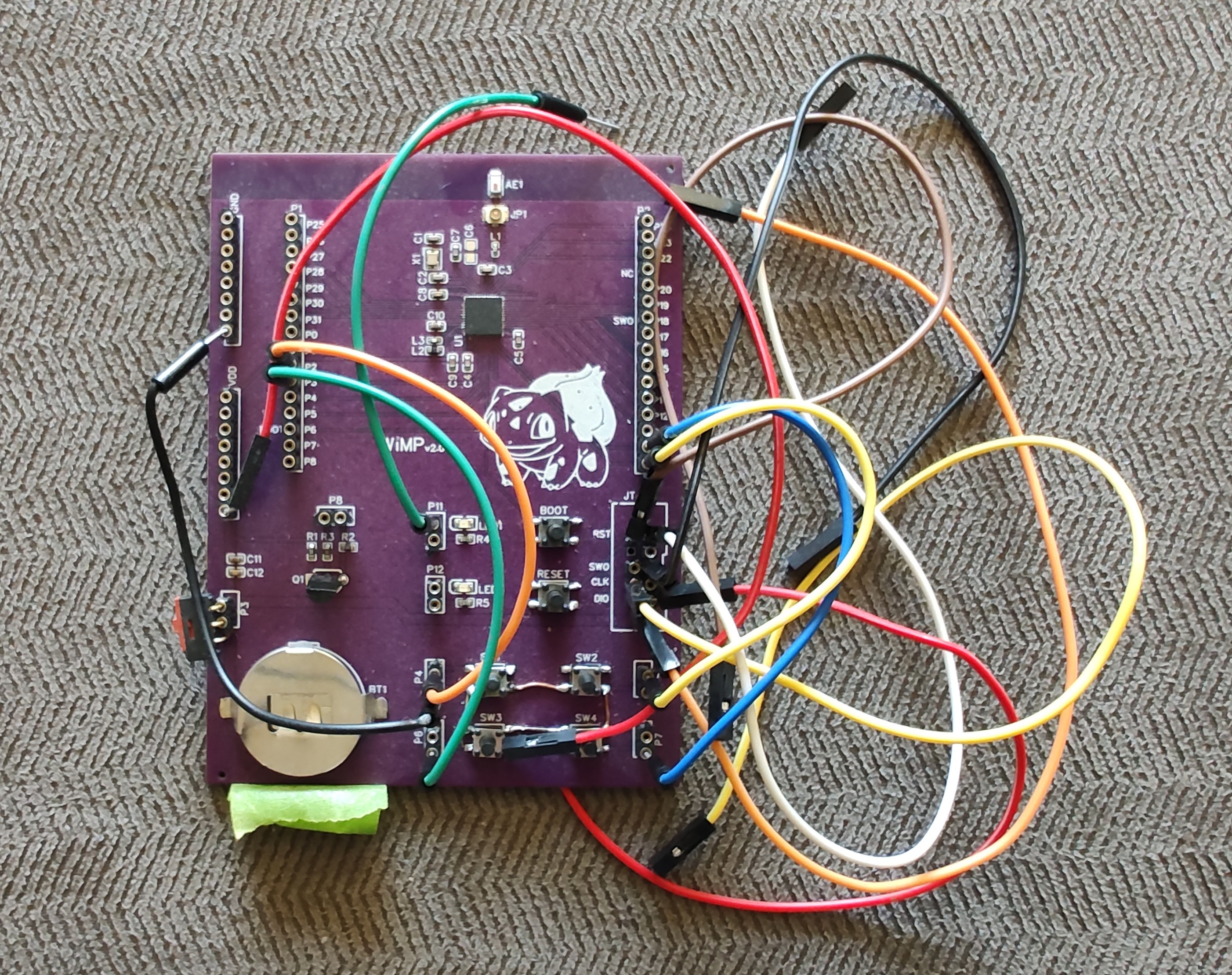

Big messy nRF52 dev board
I made this as more of a dev board than a prototype, for easy modification
nRF52 DK connected to my dev board
Up close shot of the nRF52 DK and wiring
