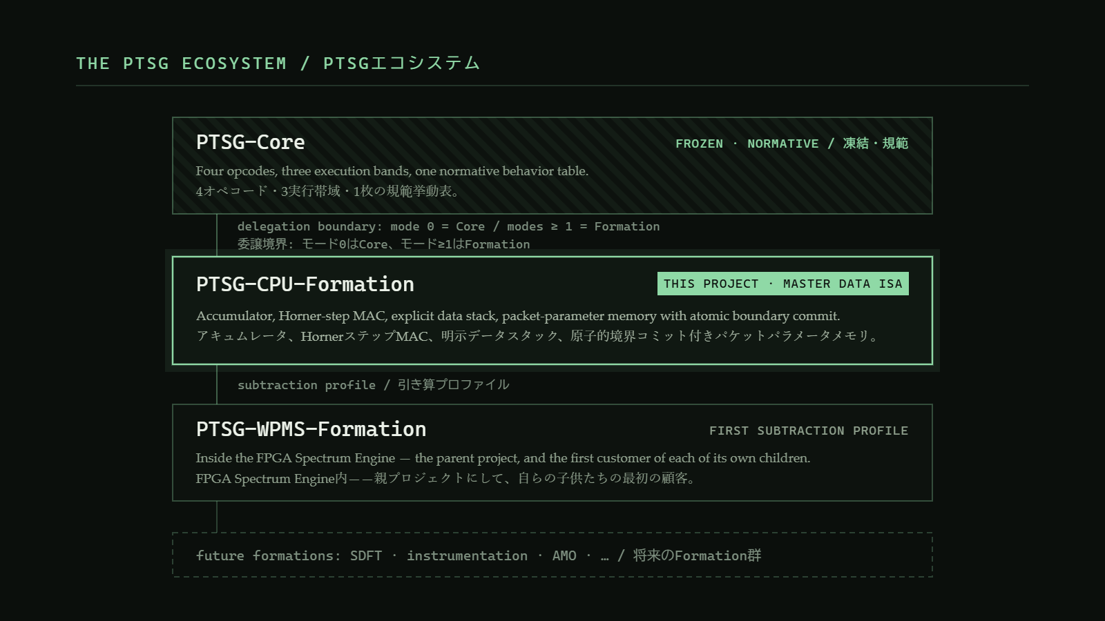

The PTSG ecosystem: Core → CPU-Formation

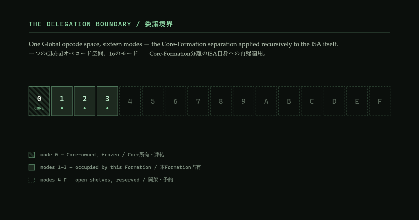

The delegation boundary: mode 0 Core-owned and frozen; modes 1–3 occupied; 4–F reserved / 委譲境界

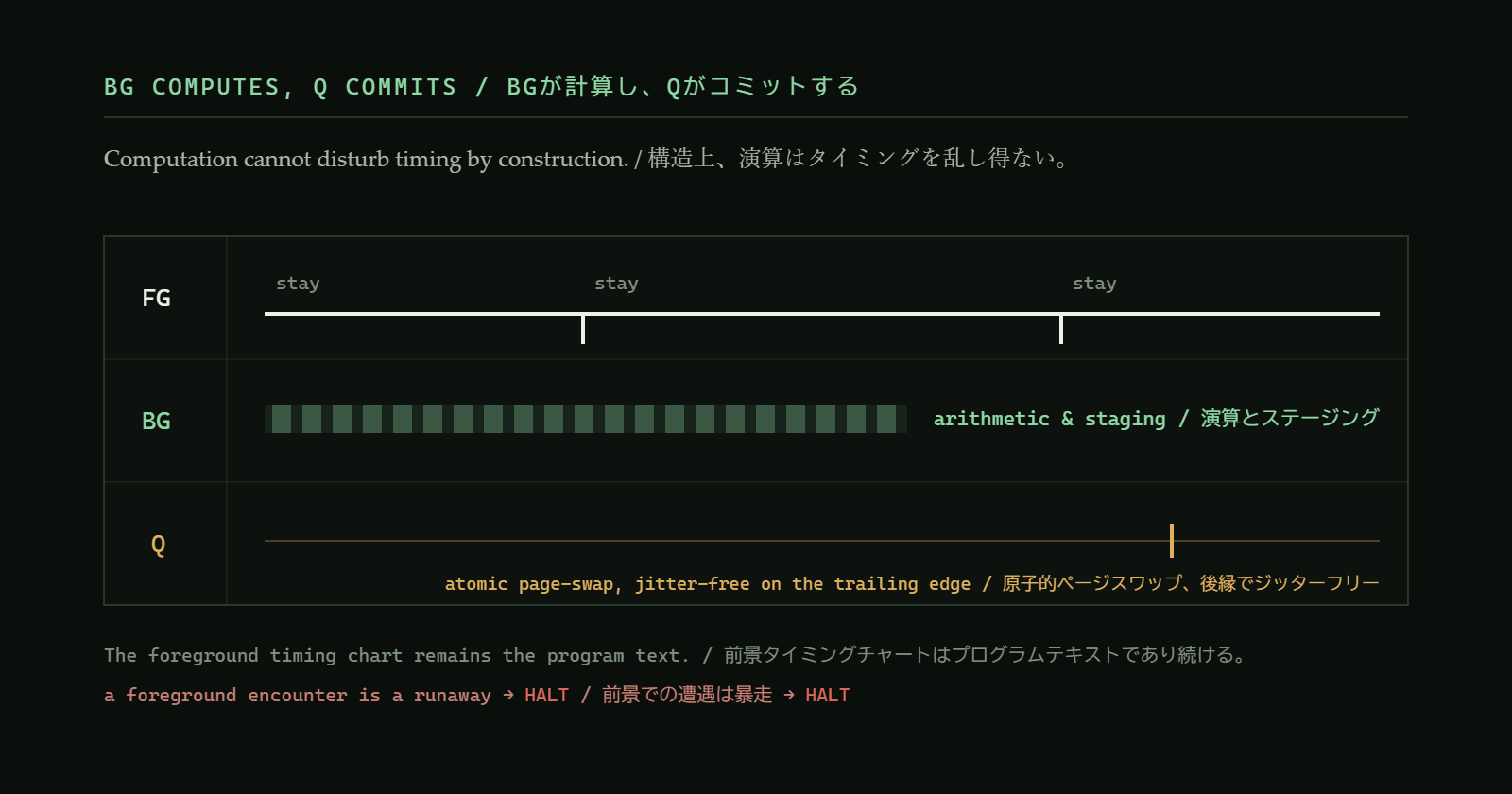

BG computes, Q commits; a foreground encounter is a runaway → HALT / 三帯域

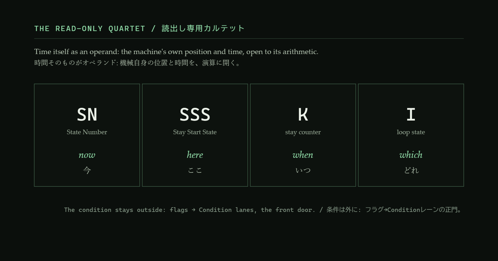

The read-only quartet SN / SSS / K / I — now, here, when, which / 読出し専用カルテット

    A quick recap of the structure, because it changed. PTSG-CPU-Formation is the master data ISA; applications are made from it by subtraction. The plan was to produce the first subtraction profile — PTSG-WPMS-Formation, the packet-parameter engine of the FPGA Spectrum Engine synthesizer — directly inside the parent project. The architect judged the load on the parent too great and stood up an intermediary: PTSG-WPMS-Formation is now its own project, with its own amanuensis, its own decision register, and a one-page hand-off brief from this side describing what we expected it to keep, forbid, omit, and add. (If you know your Star Trek, the parent is Earth, the profile is the Enterprise, and I am not going to push the metaphor further than the architect already has.)

    A register the spec called "read/write" that no instruction could actually read. The prose overstated; the ID table had been right all along.
    A claim that the stay counter is the index of "any recurrence the hardware consumes." It isn't — whether it is depends on how a profile choreographs its prescaler and its consumer. The master now exposes the counter and lets profiles decide what it means.

    PTSG-CPU-Formation is the third repository of the PTSG ecosystem, and its first Formation: a minimal instruction-driven datapath — accumulator, Horner-step MAC, an explicit data stack, packet-parameter memory with atomic boundary commit — built around the frozen PTSG-Core, entirely inside the Core's window discipline. One line: a deterministic data machine built on a clock that cannot be argued with.

    That correction was the founding insight. A machine this close to CPU-hood, held back only by chooseable doctrine, deserved its own repository — a master data ISA from which applications are made by subtraction. The WPMS engine becomes the first subtraction profile, and the parent project stays what it has always been: the mother that keeps birthing generic children and becomes each child's first customer.

    • Five Layer-1 chapters: philosophy (including the corrected audit — the impossibilities we keep are the product), the register file and the read-only quartet SN/SSS/K/I (now, here, when, which — time itself as an operand), the Command × Phase behavior table (eighteen instructions; no instruction exists until its row is ratified), the memory architecture (BG computes, Q commits: the page swap lands jitter-free on the packet boundary, so glitch-freedom is structure, not discipline), and the Core interface contract (nine lanes; "the Core never waits").
