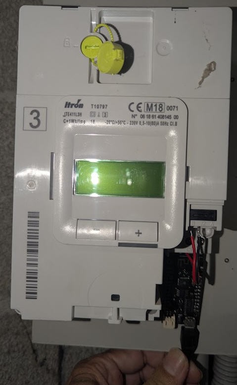

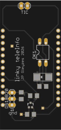

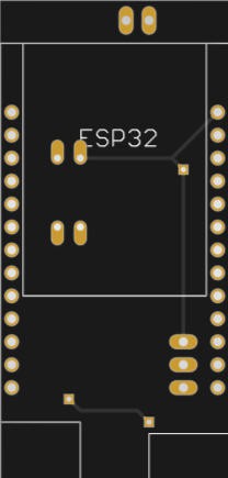

PCB
The PCB was designed to enter into the linky (under the green cover) and with only the USB plug accessible below it. The system will thus be totally hidden under the cover, but you can plug a USB phone charger to power it !
The ESP32 goes on the top side, while all the other components go to the bottom side.
PCB can be bought at PCBWay directly from this project page.
It is "tiny" but not compact, so that soldering is easy.
The PCB was kindly sponsored by PCBWay and is as usual of excellent quality.
PCBWay is a well-established company. They are even celebrating their 12th anniversary. It's a good occasion to earn coupons !
and if you are new to PCBWay please use this affiliated link : https://pcbway.com/g/o35z4O

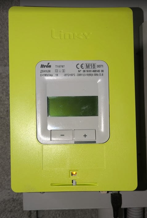

Result is a clean and compact setup which can be hidden into the linky
And when closed you can just power the board !

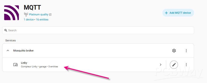

MQTT integration
This is much more interesting ! Our Linky will be automatically...
