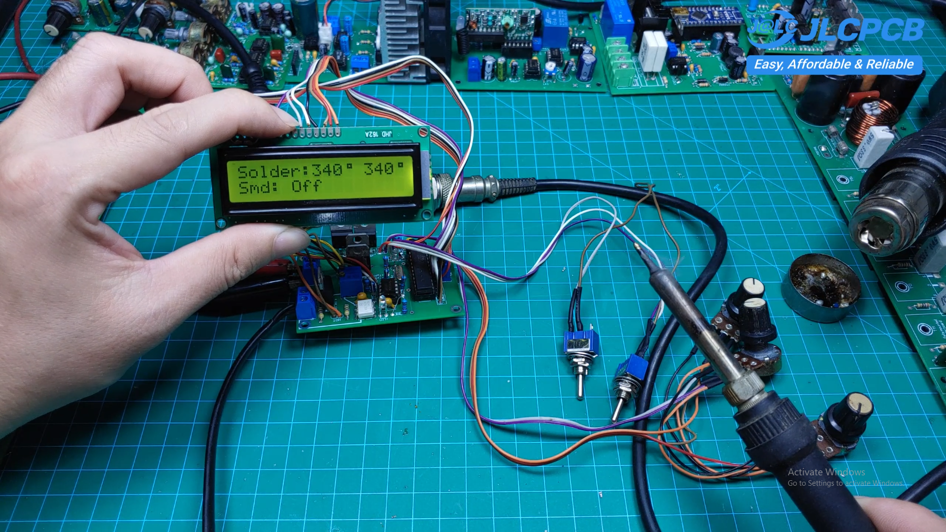

After using several commercial soldering stations over the years, I decided to build my own integrated soldering station and hot air rework station. The main objective was to create a reliable, feature-rich, and affordable tool suitable for electronics repair, PCB assembly, and everyday bench work. The PCB order from JLCPCB
The entire system is built around an ATmega microcontroller, which manages temperature control, the user interface, safety features, and system monitoring. Instead of designing two separate controllers, both the soldering iron and hot air station are integrated into a single unit with a common interface.
The project has been tested extensively during real repair work and has proven to be stable, accurate, and easy to use.

4Hardware
The controller consists of several functional blocks:
- ATmega microcontroller
- LCD display
- Rotary encoder
- Temperature amplifier circuit
- Heater driver circuit
- Fan control circuit
- Power supply
- Buzzer
- Power management circuitry
Care was taken to minimize electrical noise around the temperature sensing circuits to improve measurement accuracy and overall control stability.

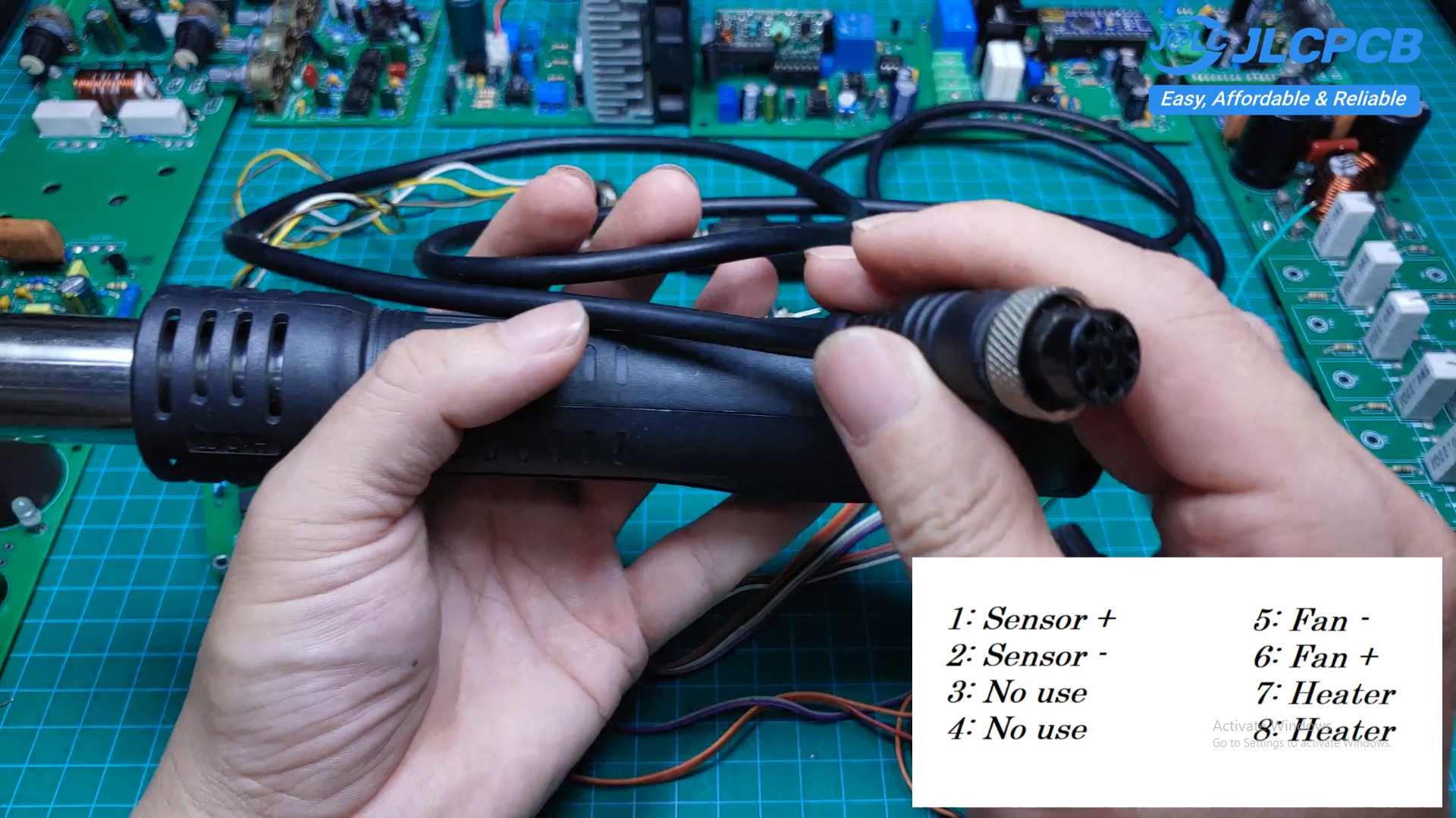

7Hot Air Station
The hot air section includes several safety features.
When the handle is returned to its holder, the heater is automatically turned off while the fan continues running to cool the heating element. This significantly extends the heater's lifespan and improves operational safety
8User Interface
The LCD and rotary encoder provide a simple but effective interface.
Users can easily:
- Adjust soldering temperature
- Adjust hot air temperature
- Configure sleep timeout
- Calibrate temperature readings
- Save settings to EEPROM
All settings are retained after power loss.
